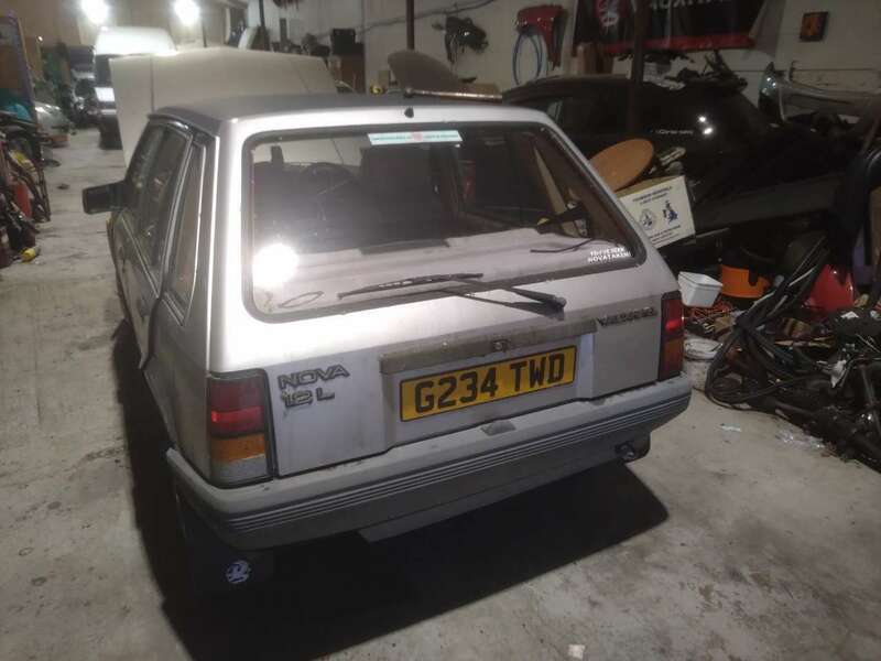

Been a bit quiet on the car front.
Then found something on an FB Nova group. It was cheap and local.
Looks ok in the photos, but it's properly ripe. We manged to rip the rear towing eye out by hand! Just about every area is badly rotted, hell even the roof was rusty. Some one had covered it with vinyl to hide a dodgy repair that in turn caused damp to sit and cause patches of rust to form.
It'll provide parts for the three door and I might chuck up an advert just in case anyone has a want for any parts.
Laughed at the sticker too. Because it doesn't run worth a fuck with no choke!

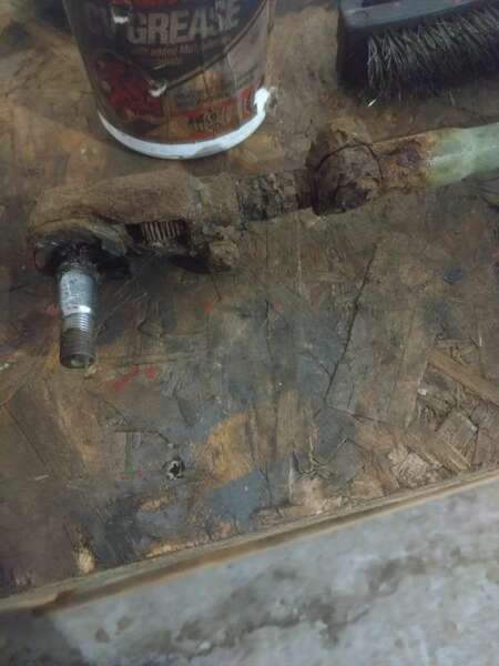

Made time today to sort the track rod ends in the Cavvy. Easy, right?
Except it's an auld Cavvy...
Forgotten they are a swine to do! The steering arms are a dog shit design. The threaded bit is in perfect bit to get washed with the road crap.
Getting them out of the strut is a fucker too. Hitting the strut to break the taper doesn't work. Pressed steel arms that squish and you still can't get them out. Various spitters and a four pound hammer were deployed.
Got the passenger side one built. From another spare arm I had laying about. The adjuster thread in the original would not budge at all.
I like to have the adjusters freed off so it's less hassle to get it tracked. Remember being told years ago folk will not touch one unless it's been apart and free to move.
Gave up in the drivers side (that was the rotten one pictured above), saved the arm but the adjuster was fucked. The hex in the middle was all about gone.
Lucky for me, a pal who is also into these shitty Vauxhalls had hoarded a few steering arms and has a clean drivers one in stock. I'll strip it down and make sure it's free to move.
Looking back I should of just built a pair of spare arms to just swap over. It'd of been less hassle.
