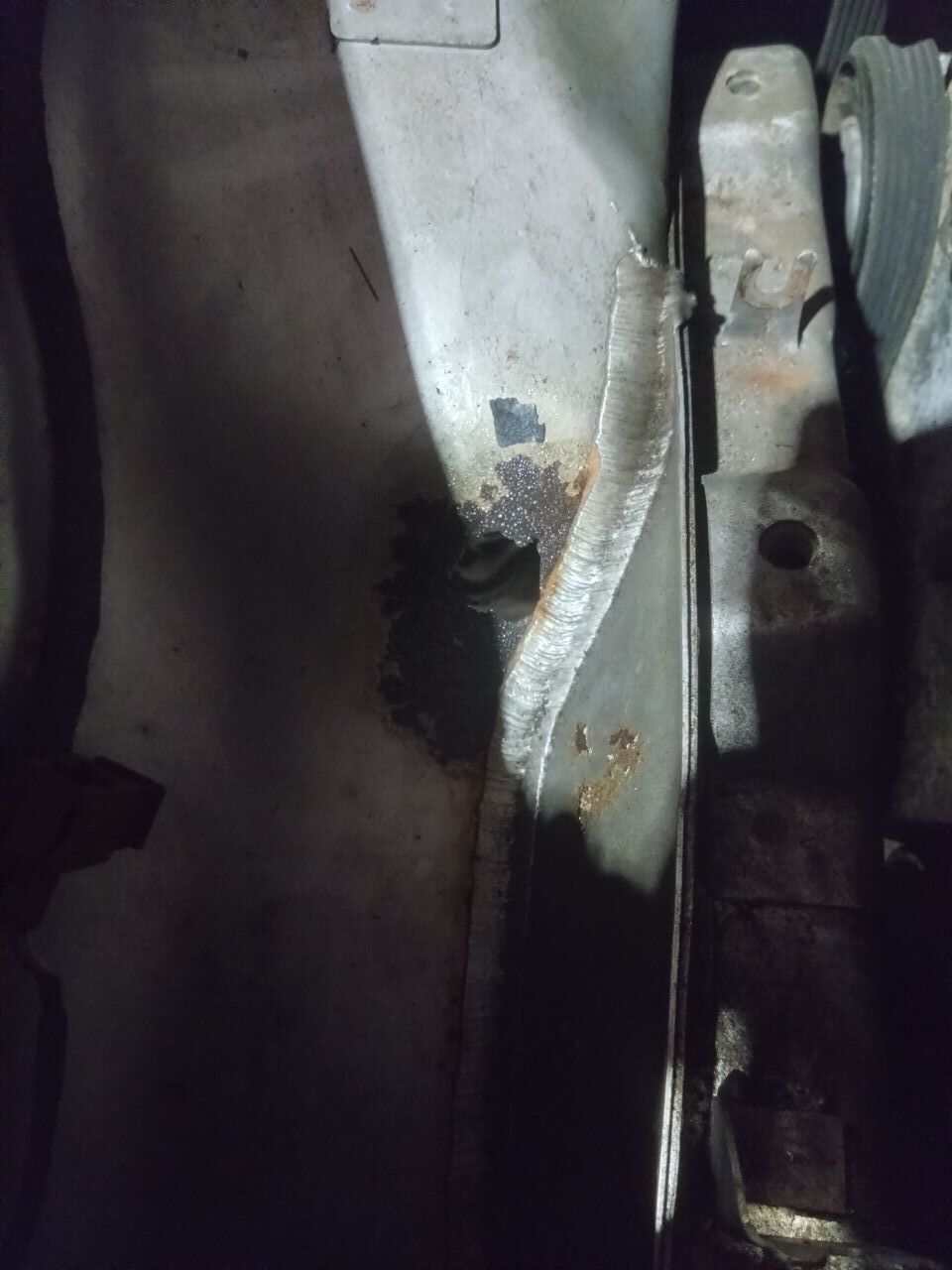

Today's job. Sort that hole in the inner wing.
Die grinder worked a treat to remove the rotten metal.
Patch made.
Had to turn the welder down to zap it in. Welds tidied up after.
Splashed some red oxide on all the welded areas.
Job jobbed!

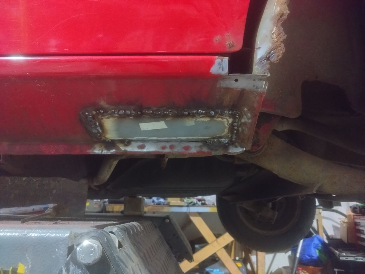

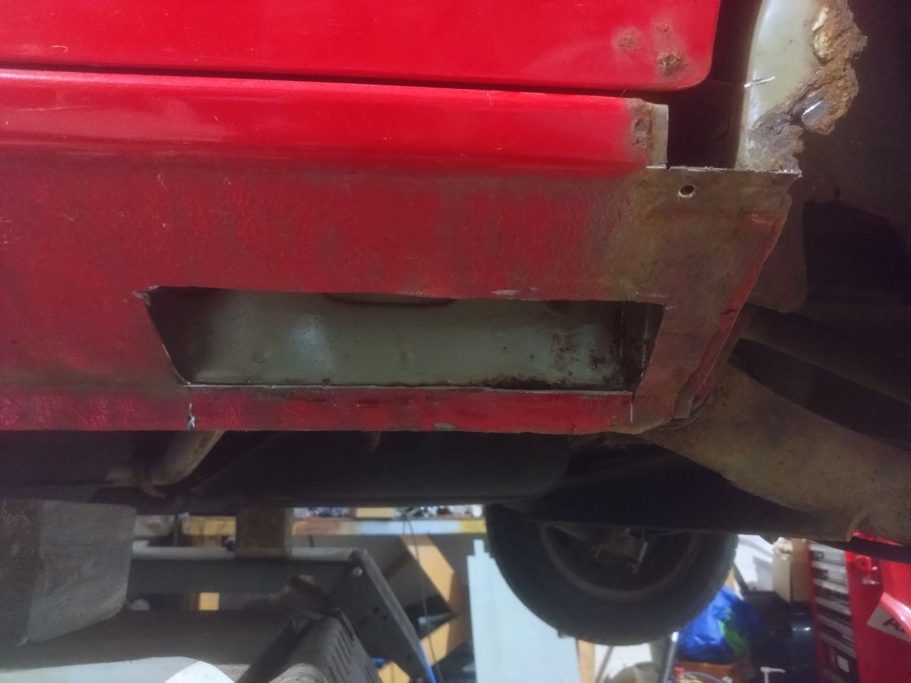

Started to chop a little more arch out. Then vacuumed out the sill void.
Oooh errr. Looks crispy in there. Ah, looks like I'm patching the sill too.
Luckily it wasn't too large of a hole that had to be cut out.
Fresh patch made. Mostly welded in at this point.
The welds will be dressed down and any missed gaps filled with more weld tomorrow. With the back side of the patch being drowned in red oxide to protect it.
Puts me back to where I was going to fix first. That inner arch lip.
I still think it could have been MUCH worse. Although the drivers side might be hiding more horrors than first thought.

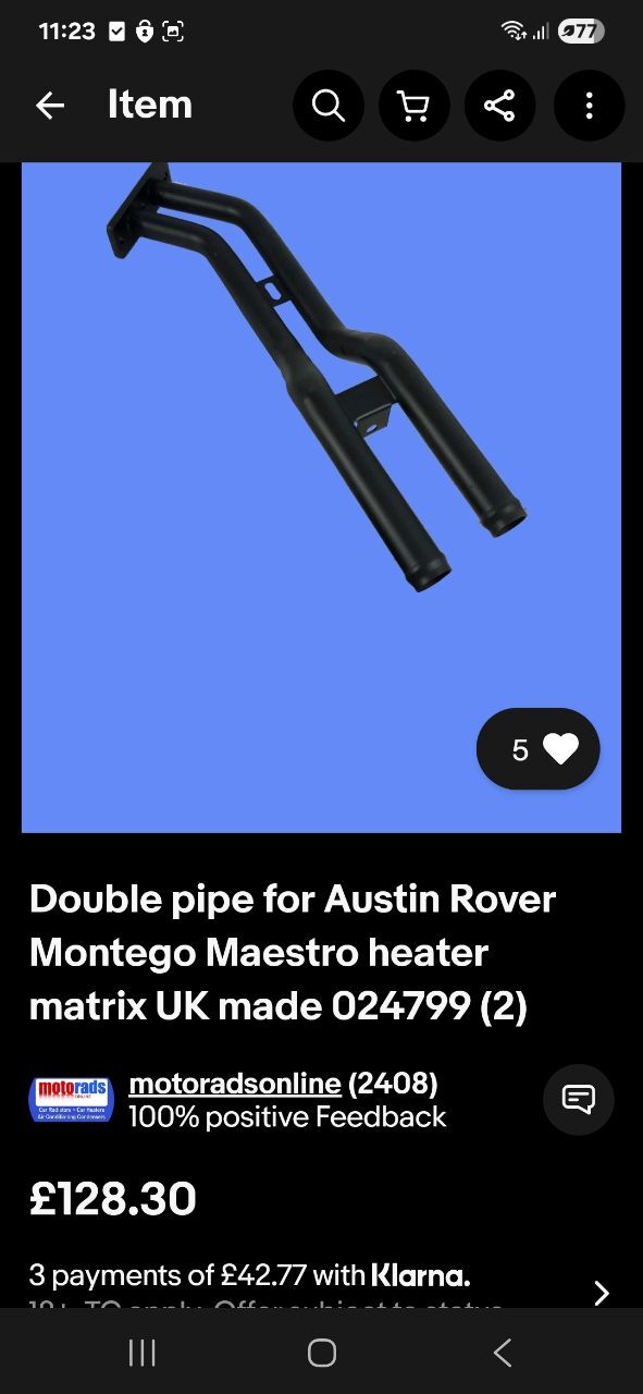

I can't remember properly, but did @JMotor repair the Maestro heater pipes?
Saw this, but the price means most people would probably still do the same and repair what they've already got.
Yeah I pretty much iced them like a cake with chemy metal 😆.
I'm tempted to buy those. Then that job is just done.
Aye I could make or repair some. Is it worth the time and aggro?

Do it once, use good quality anti freeze and change it every so often. Bit of wax oil on the outside and jobs done for life.
  • Agree 3
Sounds like a plan.
The amount of leaks I've had from those sodding pipes has made sure the antifreeze is replaced regularly 😆
Can see an order for those pipes going in this week.

https://thecarheatershop.co.uk/shop/double-pipe-for-austin-montego-maestro-heater-matrix/
Smidge cheaper potentially?
31 minutes ago, jim89 said:
As a self confessed penny pincher.
I naturally went for that one 😆.
Nearly sure that's the firm who sold me the heater matrix for my car. It was very nicely made.
Thank you for the tip off for that one 🙂.
Checked the description. They make these ones out of brass. So hopefully it's a fit and forget job. I'll report when it arrives.
Ordered these off that link @jim89 gave.
Next day delivery. Comes with new rubber gasket to matrix. Look very nicely made.
Aye, not cheap. On the other hand. They are million times better than what I have. Be nice to fit these and that be the end of the problem.
