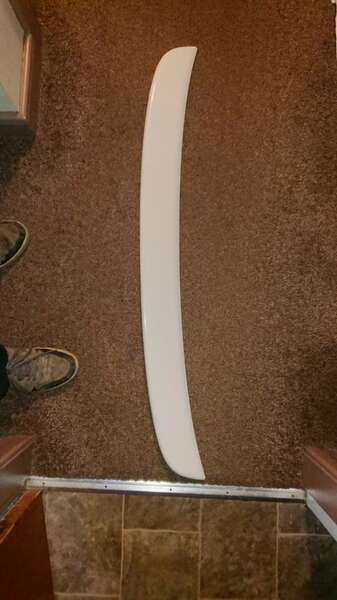

That is a boot spoiler from an Altezza Qualitat. A special edition model. Mostly a styling and interior job.
The kit is a bit how ya goin' for me. But I do like that boot spoiler. It's a subtle looking one.
Didn't want a carbon copy of all the other IS200/Altezzas you see on the web. Same TRD Sports kits, same rear spoilers even the SAME TRD stickers on the rear doors!
Naw. I want OE plus with period correct parts! Something like what a person in Japan would do.

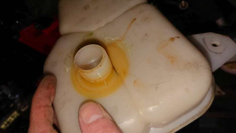

This thing has always had a very slow water leak.
Could I find it. Could I heck! Kept topping up the coolant anyway. Doing basic fluid checks regularly can make a difference.
So checked all the usual suspects. Rad had a small leak as reported earlier.
Took the lower dash out, just to check the heater matrix.
This was a doddle compared to doing the matrix on the 306 I had. That was pain and suffering. Whole dash out job on that.
Matrix was leak free. Phew!
Getting an eBay pressure tester helped massively.
Whipped the spark plugs out too, just in case there was any dampness on the pistons. Just in case the head gasket was gone. All dry. Yes, it's not an ideal way of checking a borked gasket.
It was a really weird leak, as there was no drops of coolant on the floor at all. Until today. While checking any potential leak spots again. I clocked a tiny drip from the passenger side. Ah Ha!!
Whipped the expansion tank out and found a small split in the locating peg/thingy.
I'll head back to eBay for a new tank. Yes it took a while to find, but I wanted to eliminate all possible areas first.

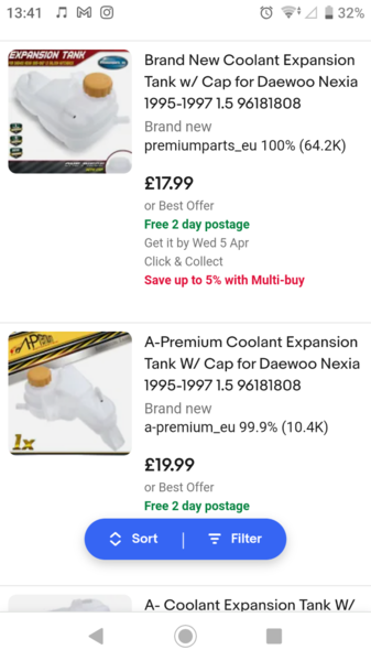

Nexia has been laid up for a wee while.
Thanks to the coolant tank.
That'll be a RHD (with ABS) specific one you see.
One off eBay is a LHD (with ABS) tank.
Doesn't fit due to the heater motor. Oh bother.
Thanks to a suggestion from the FB Nexia and Espero page. It's getting mounted here. Well that's a rough mock up.
This is actually mounted.
Not pretty, but it works. I did try to plastic weld the old tank. I wasn't happy with it. So gotta make do with what ya got to hand.

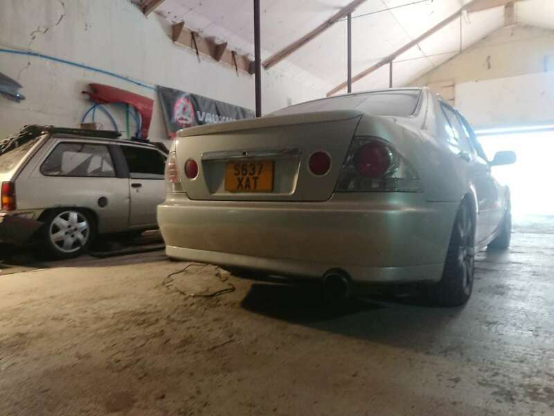

Not much happening on the car front.
Last weekend I got a tracker fitted on the 'Tezza.
While that was happening, I gave the car a hoover and trial fitted the spoiler.
Suits it I thought?
Must get it and other bits of bodywork done. Looks crap with the clear coat missing in places.

Yep keep that spoiler. Suits it 👌
Thanks man 😎
Yeah it's definitely staying. Will be great to see it the same colour as the car.

Spent today fannying about in the shed.
Sorry Gerry @GMcDbut the cherry bomb had to go. I got the stock system on, a pal had a standard hatch tailbox sat in his stock pile. Strangly enjoying the car more now it's quite a bit quieter now.
I'll maybe ruin that a later date 😂
