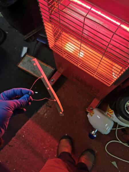

Working a small job on the sofa tonight - the VIN plate is pretty pitted and grotty, so a bit of time with a spare electric toothbrush and some metal polish might yield some results.
IMG_20240226_202213_edit_175084822204533.thumb.jpg.dc95c97ed2f250dee27cb4db551da4d3.jpg
It's not the fastest process, but there is a slight improvement. I'll keep working on it when I'm not in the garage. Still waiting on loads of bits to arrive in the post.

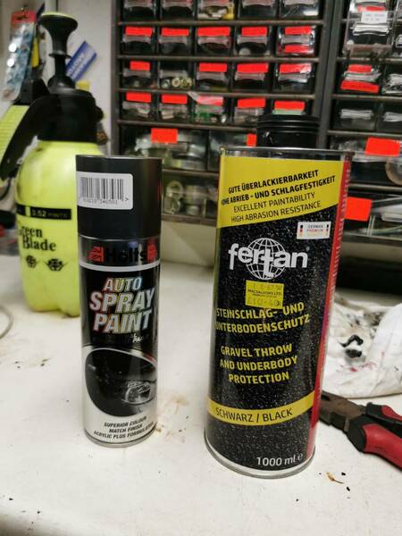

Fertan as a brand is highly rated as a rust converter so I'm hoping the stone chip follows in the same vein.
Masked the important bits:
And cracked on -Fertan on the underside, paint on the inner wing and the arch.
Ended up doing two coats of each. Popped the IR light on to help speed up the curing time between coats, but it'll dry naturally now till tomorrow.

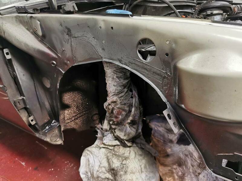

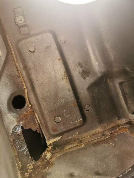

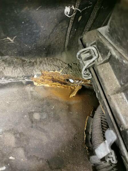

With that done, it was time to focus my attention on this - this patch had been hurriedly applied the last time the car failed the MOT back in 2020.
Halfway through and it was putting up a fight!

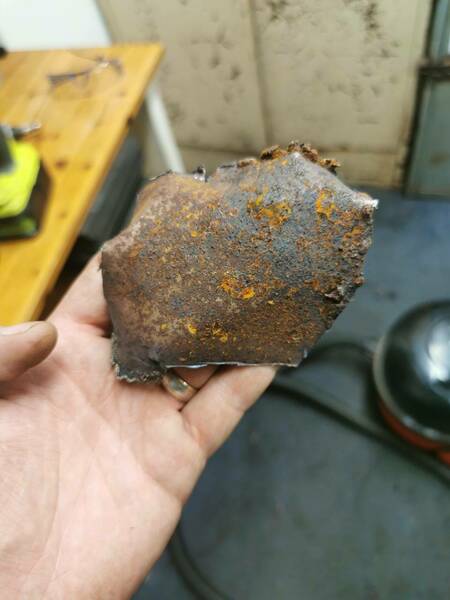

Eventually though, I removed the patch to expose the horrific situation underneath, which also highlighted the lack of paint to the other side of the repair patch.
The screen wash bottle was removed to look at the both sides of the repair, which surprisingly didn't look any better from that angle either.
Clearly though, some more room was required to work in the area. The resting wiper position was marked on the screen:
And the scuttle, wiper arm, heater blower motor and bonnet were removed to aid access.
Final job for the night was removing all traces of the previous patch attempt.

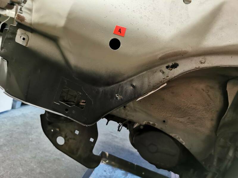

Chopped the rest of the grot out, what remains is crusty but saveable. When taking the remains of the initial rusty bit out, it was evident that the vertical inner wing skin that it welds onto was heavily deteriorated under the seam sealer. Seeing as there was another adjacent grotty bit within that section, I drilled out a few spot welds and removed it as one large section.
This left me with three sections removed in total, although a fourth one will have to be made to cover the original hole - there was simply nothing left to make a template with. Three of them will be made with 1mm steel, the remaining one is part of the suspension turret plate and will be made in 1.8mm steel. The removed section (the bit at the top of the photo) is only a mounting surface for the 1mm bridging plate on the arch and has no structural implications at this point.

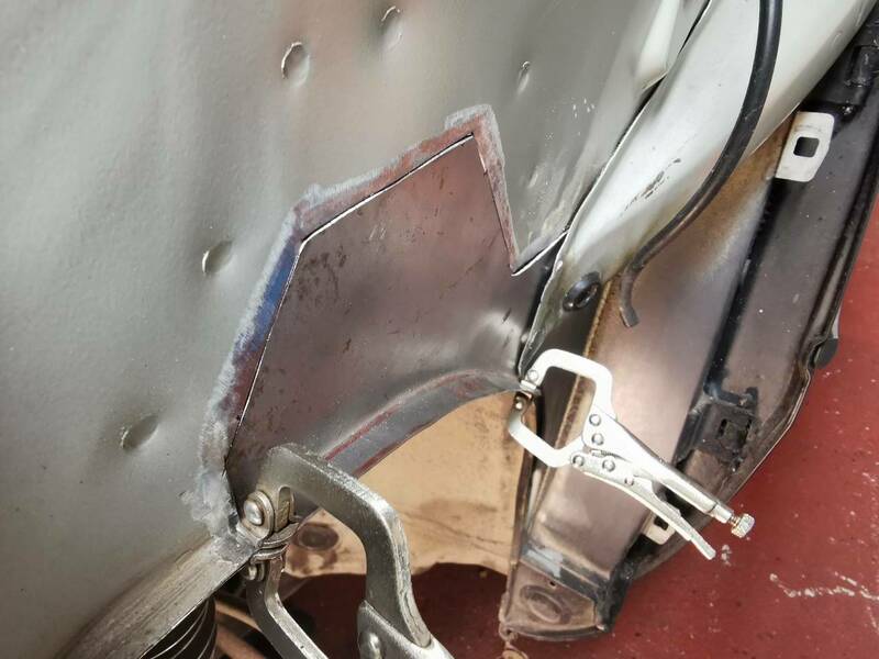

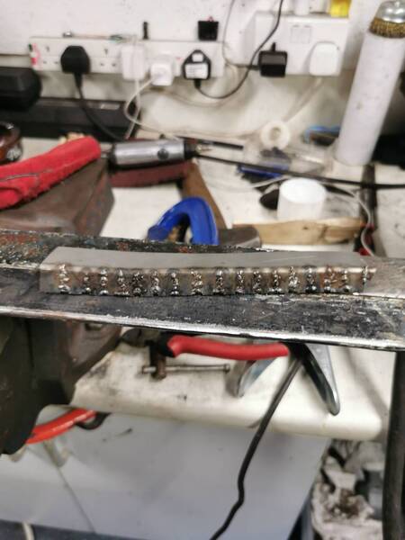

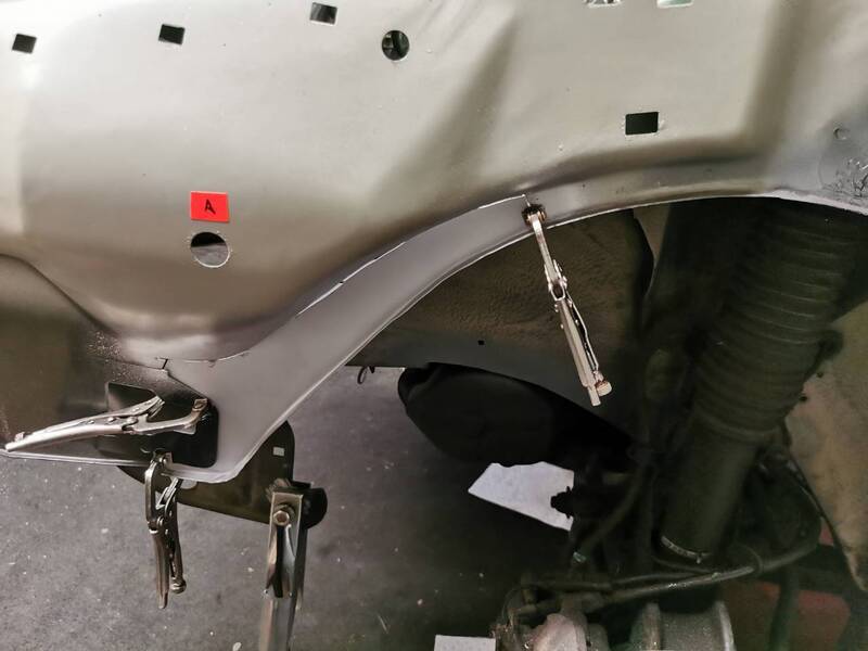

Metalwork cleaned up for welding. The patch near the suspension turret cleaned up with a light sanding and proved to be solid, thankfully. It'll be given a further wirebrushing, before Kurust and primer.

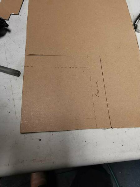

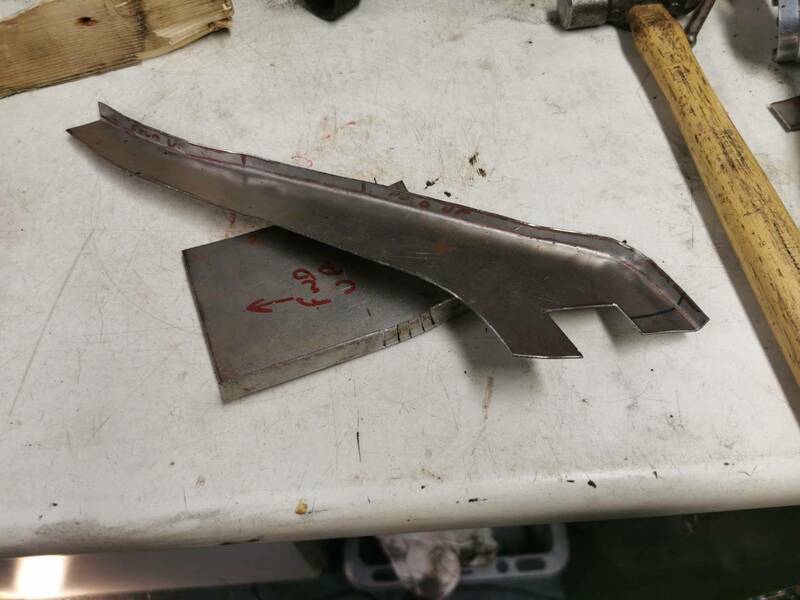

First panel knocked up. Still needs a little bit of a fettle to make it perfect, but it's a start.
Called it a night after that. The next two patches to make are simple strips, the final one can't be measured/cut out until the others are welded in.

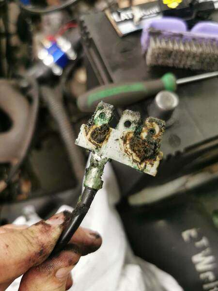

This had a replacement battery last week so we knew that was grand. Eventually tracked the fault to be with the charger itself. Would show 6v output on the multimeter for a few seconds, then would start dwindling down slowly.

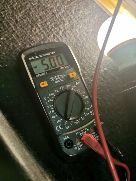

Not fancying buying another charger, I started looking for alternative power sources in the garage. Tried my first stupid idea:
Which reminded me why the battery was removed from the MX5 in the first place - it was almost unable to turn the tiny motor. The 18V Ryobi knockoff was hung in place and immediately discounted as it would be much too quick for my little one without setting up a potentiometer.

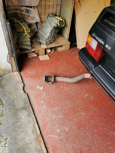

A closer look at the cause.
Unfortunately, I didn't get many photos of this, as I was in a hurry to get this done - the Laguna was needed to do the school run in a couple of hours.
Luckily, I already had the replacement pipe in the garage, I just never found the time to replace it as I was focused on the BX. As the Citroen was in the garage on stands, it meant I had to work on the Laguna outside in the pissing rain.
After much swearing and skinned knuckles, the old pipe was out and I could see the cause of the failure was not the item snapping due to corrosion, but the flange welds cracking and eventually failing, allowing the downpipe to slide out of its own flange (oo-er).
As I was in a massive rush, I didn't change the studs over on the exhaust manifold, just wire brushed the threads and copper greased it. The new pipe had been a pain to source but was reasonably priced, although the fitting kit was extra, and also a waste of bloody time.
With more haste than before, I got the new pipe bolted in, the car came off the ramps and I made it just in time for the school run.
I'm going to have to re-visit this one at some point, the manifold to downpipe joint isn't 100% gastight, and the crushable wire style gasket isn't sitting flush. That being said, it's a lot better than it was, and it highlighted issues with the exhaust system closer to the tail pipe.

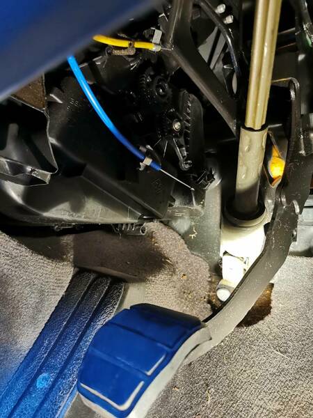

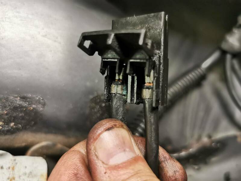

On the way home, I noticed that the heater temperature control knob wasn't free to rotate like usual, it was sticking in and sprinting back to one position.
Good job I know how to gain access.
Eventually, we found an issue with the heater control cable itself - for some reason, it had developed a kink and was jamming inside the run. Annoyingly I've been unable to resolve this, at this time, so I've disconnected the cable, and left the heater flap in the fully hot position.
Trying to source a new set of heater control cables was a nightmare in itself, but I managed to find a NOS set of cables for a RHD Behr-equipped car in Holland, of all places. Luckily, my brother lives in Holland too, so it's getting delivered to his house for when we get there at the end of the month.

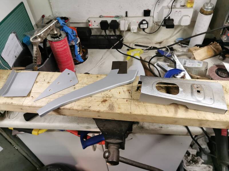

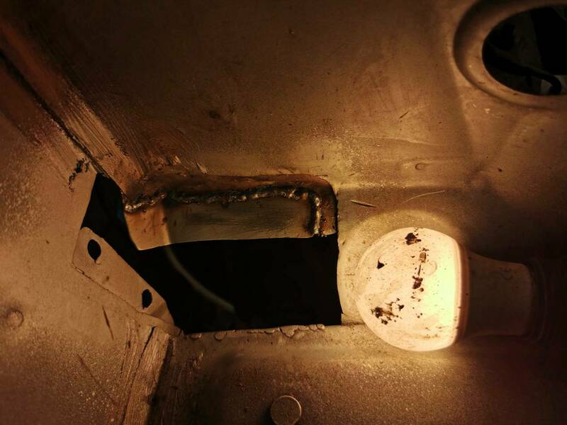

I made the last of the repair sections for this first stage, and coated them with zinc primer.
Gave the other side a coat too (excuse potato camera)

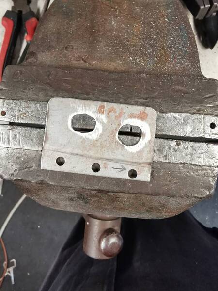

Then I thought I'd do the small, three holed panel first. This was an absolute pain to do, first the leading edge kept blowing holes in it, then when it came to do the plug welds on the holes, the metal melted through and caused a small fire to the soundproofing behind the dashboard!
Naturally, I panicked and grabbed whatever was closest to me and squeezed hard, 'aiming' it towards the hole with a flame in it.
Which thankfully extinguished the fire. I've pulled out the carpet and had a look as far as I can, and I think I've gotten away with it.

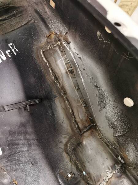

Welded in another portion of the arch repair.
Ground the welds and applied weld through primer.

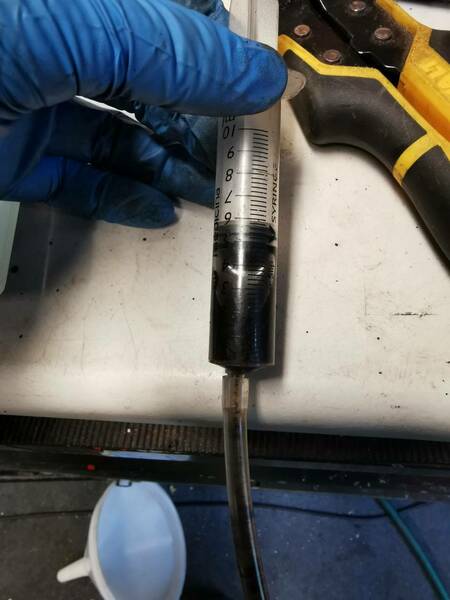

Whilst this was ongoing, I decided to try and resolve the burning oil issue with some snake oil.
The car had been running fine when in use, but started blowing blue smoke when accelerating the engine. I'm rolling a lot of dice on gummed up piston rings.
Luckily, the internet has given a pretty glowing recommendation to this product:
I spent a few hours searching around the internet, and it seems to be good for solving oil consumption issues. Decided to try a piston soak, using the procedure recommended by Berryman.
Used two bottles, poured them into each spark plug hole, put the plugs back in hand tight and agitated the engine by rotating the crankshaft pulley back and forth every half an hour. Every hour, I took the plugs out and checked the fluid by sucking some out with a syringe.
The fluid was clear when poured in.
This was the best one a couple of hours in - you can see the carbon deposits in the bottom of the syringe.
This was one of the worst ones:
Pure black in there, there was another cylinder like this too.
I used two bottles in total (it eventually drains into the crankcase) and five hours later, all bar one of the piston crowns was dry - a quick blast of compressed air into the spark plug hole freed it up.
The remaining cylinder fluid was pulled out via the syringe, and fired into an old rag, to see how many deposits were in it. This was a 10ml sample.

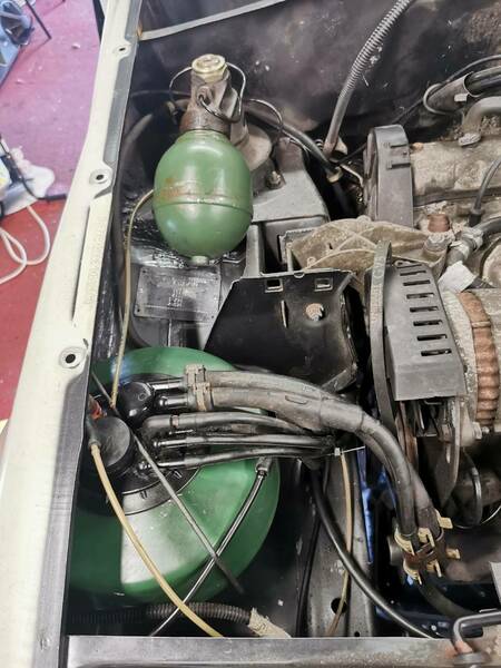

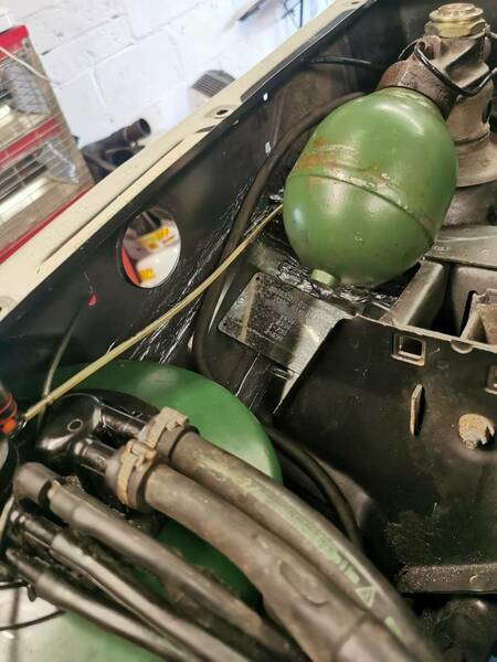

With that done, I started looking at the LHM system, which was still untested because of this doozy:

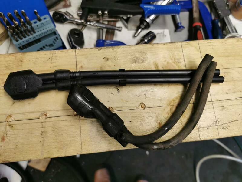

Luckily, these are really simple to change, just prize the clip off, and pop the pipes off.
The pipeline's were heavily perished and cracked everywhere, so this was definitely worth changing.
Onwards then, to the next part - building up the LHM tank. First off, I needed to take the filters out and give them a good clean.

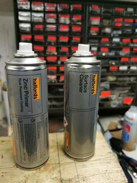

Here's where I made major fuck up of the day.
Notice how similar these two cans are?
...yeah. It took me a couple of seconds to realise the cleaner wasn't just clearing loads of sludge out. Thankfully, using the right can cleaned all the traces of primer out!

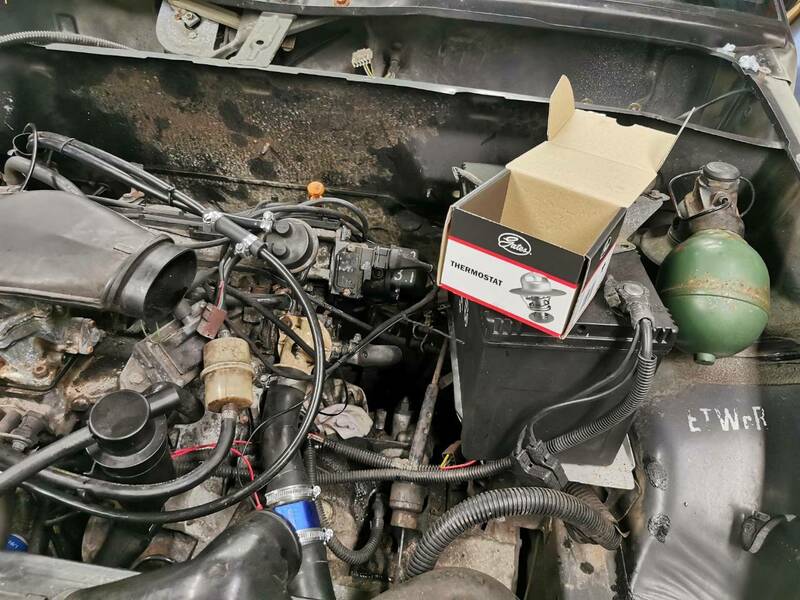

As I was planning on priming the LHM system, I needed the cooling system to work, so I ended up changing the thermostat. Was going to do it at the same time as the timing belt, but there you go.
The LHM belt was reattached to the pulleys and the HP pump supply line was disconnected and primed.

And after a few minutes, success! The car was suspended on LHM for the first time in nearly a year.
Early indications are promising for the engine smoke too, there seemed to be a lot less clouds on acceleration. Once the engine got warm and the levels were re-established, I started exercising the suspension by alternating between max and minimum extension. The struts are a little bit sticky and creaky but nothing too unexpected for a car that's been sat a while.

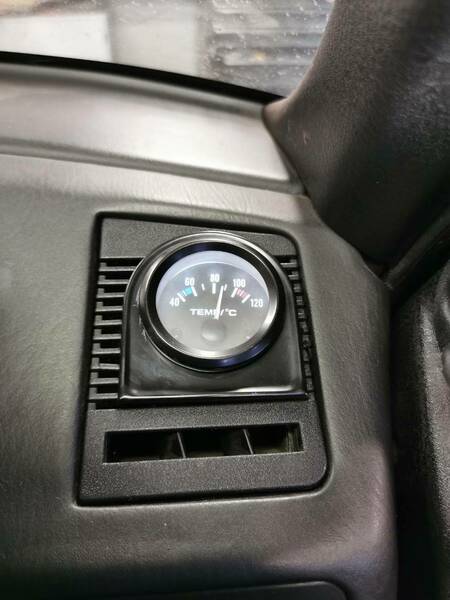

I bled the cooling system of all air and was dismayed to notice the temperature gauge still wasn't giving a reading, despite the new thermostat proving serviceable and the top hose getting hot. I shut the engine down and suddenly:
Ah, everything IS working fine, it's just me being the idiot. I've had a prod with the multimeter and found the 'earth' terminal I was connecting to is a perfect earth in Key position 1, but 12v comes through when set to ignition.
Luckily, I added plenty of spare wire to the earth wire so I can simply connect it to a proper earth point instead of being lazy.
Anyway, seeing as it's mother's day, I'm knocking it on the head tonight to enjoy some time with MrsH. I'll pop in tonight to put a final coat of paint on the welding repairs before moving onto the next section.
Last thing I did was place four clean rags at each corner to check for static LHM leaks. Hopefully they'll still be clean tomorrow!
I'm currently debating whether it is even worth doing the head gasket any more. Any advice?

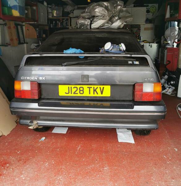

Commute to work this morning in the Rover, sat queuing at a roundabout.
Suddenly, enormously loud explosion heard - thought it was a gunshot.
Suddenly, Rover has plenty of power and it is running lovely - I'd been suspecting a boost leak somewhere for a while.
Guessing the exhaust had a restriction somewhere, but I've not seen anything come out the tailpipe.

I've also moved the temperature gauge earth return to a proper earth point and ran the engine up to temperature - this time the gauge worked, so that job can be ticked off.
Check your knickers for evidence.

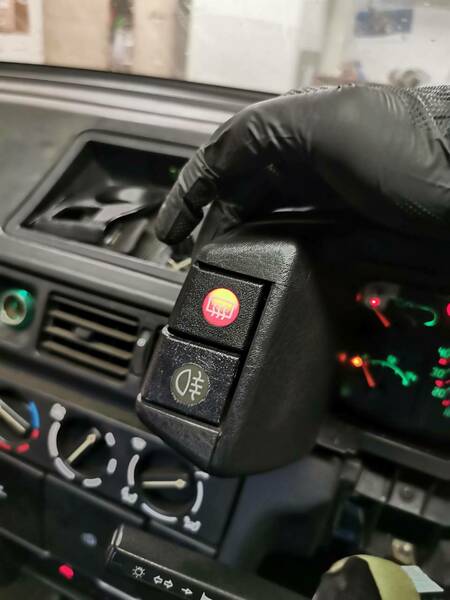

Christ, yesterday was a bit of a ballache.
Started off innocently enough, removing the seam sealer from the next area requiring repairs.
Whilst in the area, I noticed the horn was there and realised I hadn't tested it in years.
Popped the battery back on, pressed the button...
And nothing. Balls.
First things first, check for voltage at the connector using a test lamp - no lighty no likey.
Next job was to check the horn switch as they're prone to failing. This was working as advertised, but it was only showing 5V at the connector.
The heated rear screen operates on that circuit as well - and wasn't lighting up.
Oh boy, here we go...

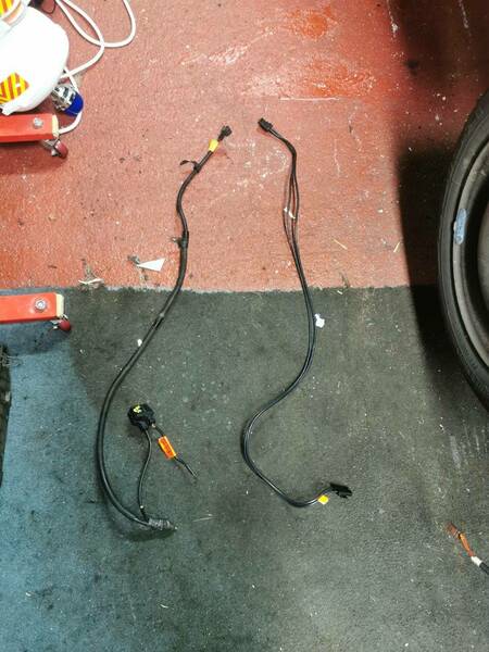

With the fuse out and the multimeter inserted into the 'hot' side, it still wasn't looking promising.
The battery voltage was checked and found to be fine. This is a permanent live circuit and the power feed goes from battery -> fusebox -> fuse, so I figured it was worth checking from the battery onwards.
Found this manky mess hiding under the plastic covers, just after the battery positive terminal:
And hidden amongst the grim was this little fella:
Luckily, Citroen have a dual redundancy here - the twin-spade connector has two positions that it can connect to on the block, as all the other positions are unused. Because that feed wire was corroded, I could simply use the other side which was in much better condition.
You know.... underneath all that gunk and dirt. I'm guessing the connector was slathered in something in an attempt to protect it.
These all cleaned up all right though.
The other side of the connector had mild verdigris and cleaned up okay as well.
And the connector re-assembled, and connected in the new, non-chafed position.
I tested the voltage at the terminals at the back of the battery end of this loom (which I think is the main feed  loom for the fusebox) and found battery voltage.
The other end?
5V once again. Resistance checks were carried out end-to-end and found to be 0.1ohms, so that's fine. The wiring diagrams are pretty unhelpful in the Haynes manual but I think there's a fly lead attached to this loom somewhere that may be causing issues.
Has anyone else had something like this? I've currently got loads of electrical components disconnected on the car, so I may just reattach everything too and try again. I only had a couple of hours to look into it last night.
Cheers
You need to test the voltages with a test lamp that puts some load on the circuit. A meter will often give a misleading result because it only uses a tiny current.

So, on with the fault diagnosis. Reinstalled the cabin fan and headlights to aid the digging. Decided the fuse box needed to come out for a clean up, so all the connectors were marked up and disconnected
And eventually the fuse box was on the bench, given a stiff bristle brush and some contact cleaner before being blow-dried from the compressor and left on the dehumidifier to dry fully.
Yesterday, I came to the conclusion that the fuse feed box and battery positive lead were in need of changing, so more faffing occured and eventually the leads were on the floor.
Annoyingly, I had a niggly little voice in the back of my head to check this lead further, as it dawned on me that I hadn't fully tested it in isolation as the alternator and starter had still been connected to the supply. Figured it would be best due diligence to check It with all items out of the circuit,
Connected it to the battery, and in all the imaginable combinations of test, they all came back with battery voltage, inexplicably.
This meant that everything had to get refitted, which I did not enjoy. The highlight was getting the cables back through the grommet into the cabin, made easier with a bit of steel wire and some tape;
Eventually it was all rebullt and the test carried out again...
5V.
I had a bit of a tantrum about this, but eventually found out the entire thing was my fault, mainly because I had gone for the 'Use a clean shiny big patch of metal as an earth' and it turned out to be pretty crap as an earth - testing the circuit and using a proper earthing point made all the difference and proves that we were getting battery voltage, but using the crap earth, we were getting just 5v which was a lie.
Next fuck up wasn't really my fault - the heated rear window WAS working the entire time - it transpired that a bulb had blown in the switch so I was never going to tell if it was on (EDIT: this turned out to be bollocks, see my next post). Seeing that the horn was still working, I rigged it to the battery which worked.
Checked the stalk connector again for power and it was negligible, so it's getting closer. I've now got a BX factory electrical manual and read up on the fuse box, which I reckon is the culprit (again,)
Sorry if the spelling is terrible, I'm absolutely exhausted and been doing the ol' nodding dog here which isn't helping so I'm off to bed.
Cheers
Edited by fatharris
Because I was talking bollocks
Quite an amazing pace of work going on with this and very detailed write ups.
It will all come together in the end with the way you are working.
Well bugger me sideways, I've only gone and done it.
It's remarkable just how easy it is when you have the correct information to hand - this came in the form of OEM wiring diagrams for the fuse board itself.
With that, I tracked the lines and worked out which continuity checks needed doing. Was surprised to note that the fuse board connectors went in reverse order (6,5,4,3,2,1) as you view it.
It became evident that the very first continuity check was open circuit which was promising.
This meant it had to come out (again)
With the board on the bench, it was a lot easier to repeat all the required continuity checks, and we finally had the fault pinpointed.
There was an open circuit from the 'cold' side of the fuse socket, to the first junction of the horn/heated screen circuit, namely the high power input for the heated screen relay (this then carries on to the horn side of the circuit)
Unfortunately, it's a double-layered board and I was unable to access the actual board. Luckily, I had a surplus piggyback fuse with a flylead, so I elected to add a flylead to the relay terminal. Ended up using solid core wire on the board half as it's quite a high amperage circuit.
With that all assembled, the board was re-tested and continuity was restored. The board was reconnected to the car and the horn now works!
Also, billy bonus, the HRW works and the switch illuminates, so I must have been talking bollocks about it working beforehand.
With that all confirmed to work, the interior was rebuilt (glovebox light fixed)
As an aside, I noticed the oil level gauge wasn't working any more - this was traced to the sensor plug coming off for some reason so that's an easy win.

Not much of an update today, it's the slow, boring bits at the moment.
Chopping out the afflicted metal is a dull task, with spot welds everywhere that needs drilling out.
This bracket was covering some weak metal directly above it.
So it was removed. The uppermost mating face is heavily corroded in places too, so that'll need changing.
This was hiding behind an equally grotty panel, however it is substantial enough and has survived a wire bush so it'll get cleaned up further.
Eventually, I had what I was hoping to be the last grotty bits chopped out of the car.
This had left quite a complex hole behind.
And I had to be extra careful as I was at the end of this sheet of steel - I bought this back in 2015 to restore the Mini, but that never ended up happening!
I got two panels roughly bent into shape before I decided to call it a night - they were the trickiest two to do so I just wanted them to be out of the way.
Tomorrow, I'll prep the surfaces for welding and make the last of the repair patches, with ambitions to weld a couple in on Saturday evening.
Cheers!
So, onto today's activities then.
First off, I lopped off the rotten upper section of the reinforcing bracket between the inner wing and chassis leg. New on was measured up and filed down a bit to make it match.
Got the welder set up and cracked on -
Ground the welds back and it looked pretty okay after that.
With that done, the repair sections were given a coating of weld through primer:
And the first panel clamped in place.
This one turned out to be a bit of a faff as there were loads of curves that I wasn't immediately aware of, but the hammer got everything in the right place for the welding to happen. Ground down, it even looked all right.
With that done, it was onto the next section.
Unfortunately, this turned out to be a proper pain in the arse as my CO2 bottle ran out at 9pm. Not a problem as I had an Argon/CO2 bottle that I used for a couple of minutes in the cupboard.
What an arseache that ended up being. Not sure if it was the gas making a difference, but the welds weren't going down right and I was blowing holes every other time.
Aaaaand annoyingly, the replacement bottle ran out, less than five minutes into the job so I called it a night after grinding down what I could. Looking forward to moving on from the welding!

Not gonna lie, I was up early this morning (for a Saturday) to get some welding gas. Halfords turned out to be the cheapest for CO2 at under £14.
Got this panel in nice and quick:
As I wanted to get onto the remaining complicated panel.
This is the last of the wheel arch repair sections, so it needed to follow the curvature of the  arch itself. Typically, this requires a stretcher tool if you need a 90 degree lip, but I didn't have a stretcher tool, I had an angle grinder.
This kept going back and forth in place to get the curvature right - the more lines chopped into the lip, the finer tweaks you can make to the bends.
Eventually, I got it following the existing curve pretty nicely.
So it was a case of firing up the welder:
And very carefully welding them up - this requires a lot of time to cool in between welding the lines, as rushing it could distortion the gaps and give a different curve to the panel.
This bit isn't pretty, because it's welding to fill the gaps of already thin metal, so naturally it blows holes every five seconds.
It does grind down pretty nicely to make a solid panel.

Whilst working this panel, it made sense to prepare the last panel needed for the arch, so I got that sorted too. Doesn't need to be pretty because it's out of sight.
Both items got a coat of zinc primer and a blast by the IR heater - this dropped the drying time considerably, and justified the purchase price 😅
Once dry (and cooled down!), it was magnetted into position:

As I was popping hoses off, it was a reminder that hoses are lifetime components, and sometimes the damage can be hidden.
Fuel hose from pump to filter. This looked fine from the outside.
Coolant hoses to and from the carburettor - the split occured during removal, but the cracking rubber has been on my radar whilst I've been working on it.
Eventually, I called it a day. Bit miffed at the Haynes manual, it makes no mention of removing the exhaust manifold or inlet, or any of the components attached to them, but most of this is rocket science.

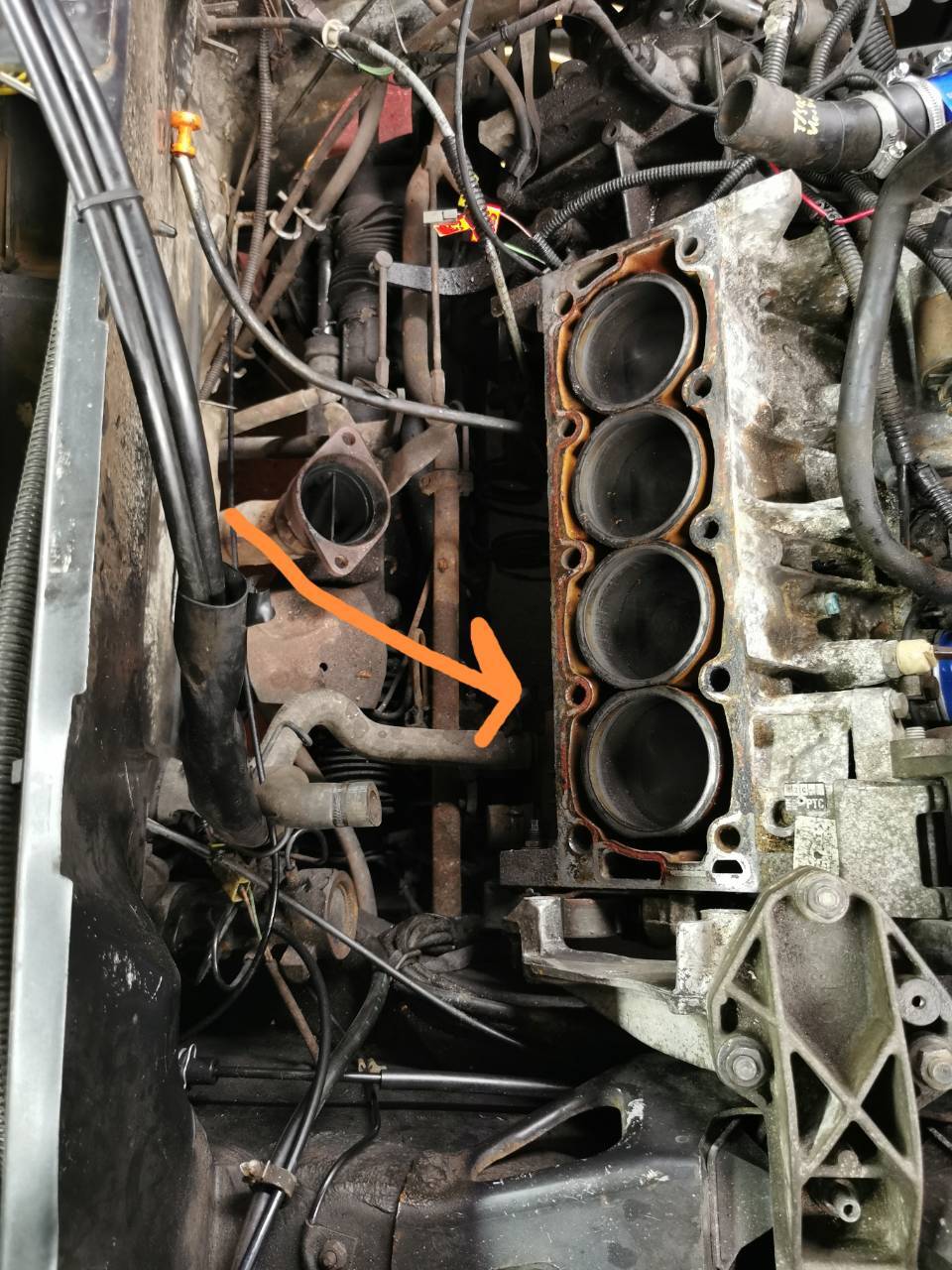

Started off strong, with whipping off the inlet manifold and exhaust manifold after a bit of twatting with mallets.
After that, I took the OS engine mount off, to get access to the two bolts that screw directly into the head. I refitted the mount after that so I could remove the jack from underneath.
Finally, the big moment came to undo the head bolts. Was feeling pretty damn good at the halfway point, until bolt number 6.
BOLLOCKS.
I cracked on anyway and mercifully the rest of the bolts came out without incident.
The head definitely needed to come off based on the state of that gasket, it crumbled away into nothing!
Gave me a chance to further survey the issue at hand.
The 2" of bolt thread and shank is stuck somewhere in that shitshow - it's very evident that someone has been running this cooling system on just water. I've just left it drowning in GT85 for now.

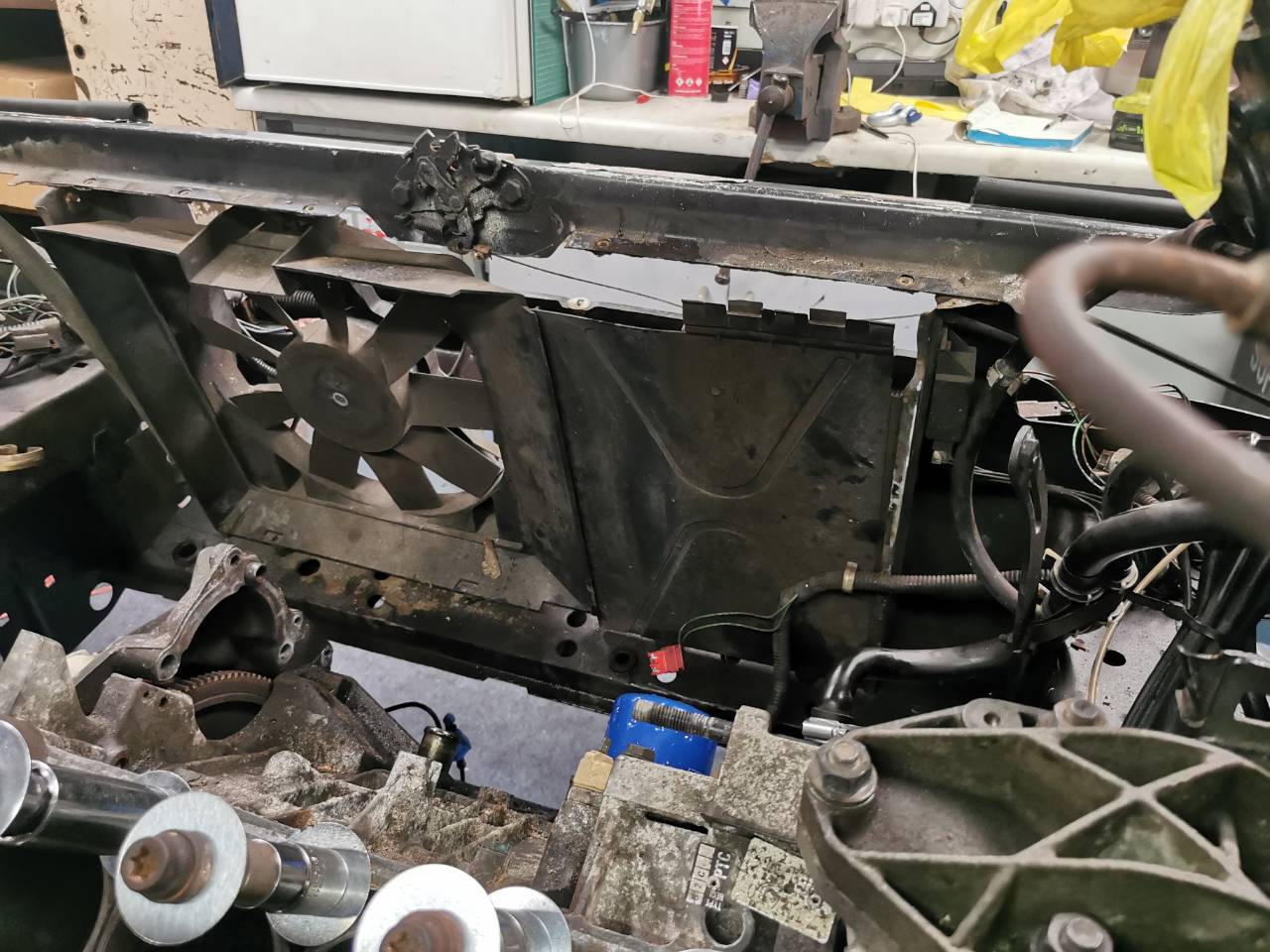

I removed the radiator to remove the risk of damaging it in the ensuing mayhem:
And started loosening bolts for the bellhousing, bonus was freeing up a pair of wires that had been trapped in the join of the bellhousing and block since I bought the car! These will get a solder sleeves repair in due course.
I roped the father in law to act as safety rating and operate the crane whilst I jiggled the 'box free, and eventually we got our first reward:
It's actually light enough to lift myself using the strop so that'll be my method when it comes to lifting it in.
Anyway, onto the main event. There was a bit of a faff to get the car to a lower position on the axle stands, exacerbated by the need to support the engine at the same time. There was a bit of an issue with access at times but otherwise it was okay.
Both remaining mounts were unbolted and the engine was free to be lifted.
And now resting on the deck.
Now the awkward jobs begin - stripping the block is going to be a bit of a pain without an engine stand, but hopefully do-able.
