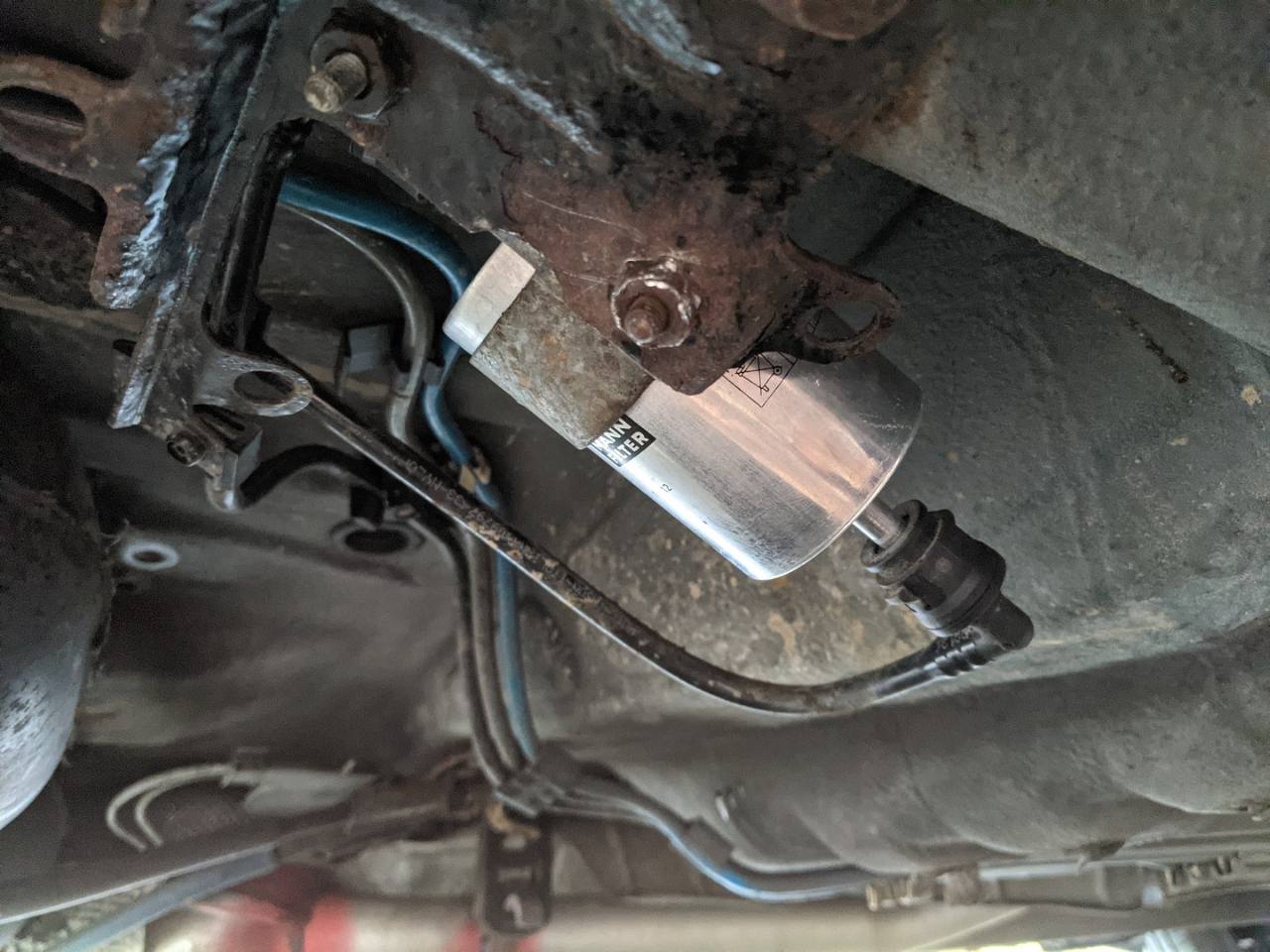

I actually ended up driving home as the recovery place kept extending the ETA and I got bored. Cut out once and was a bit down on power but got there fine. I assume it was the system pressuring to a certain pressure then the fuel pump cutting off, as when I let it sit for a bit it seemed to be happy to start, run for a bit then die again.
Old Fram filter:
Looked old - no idea how old but....old I guess.
New Mann one fitted:
Seems to run fine on the short trips I've done since fitting it, idles good, runs up to temp, doesn't stall, smooth power.
Never fitted a fuel filter before and finding the fuel pump fuse was a bit of an arse but we got there in the end. Nice to learn.
