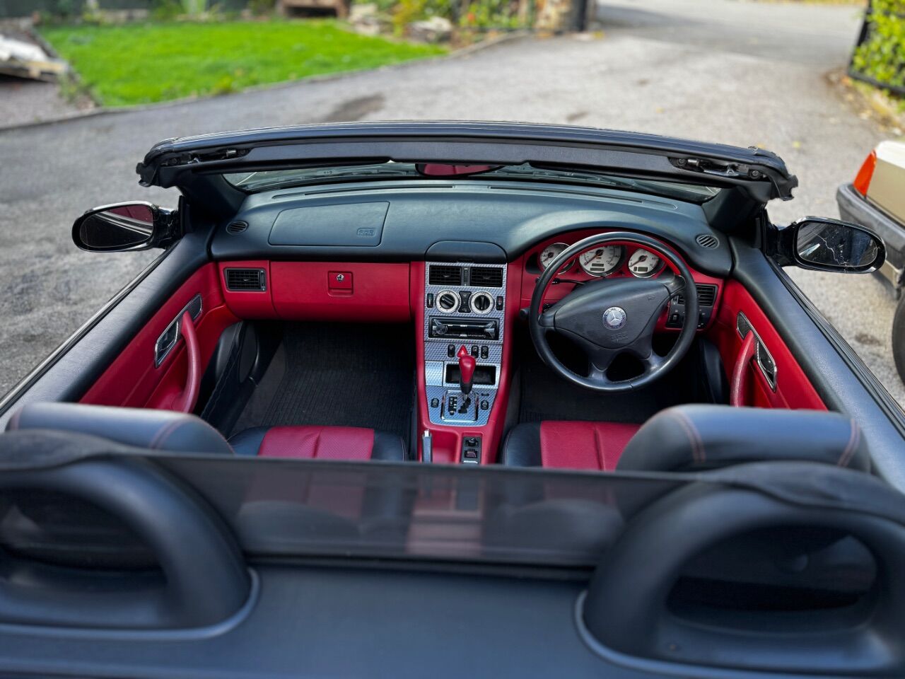

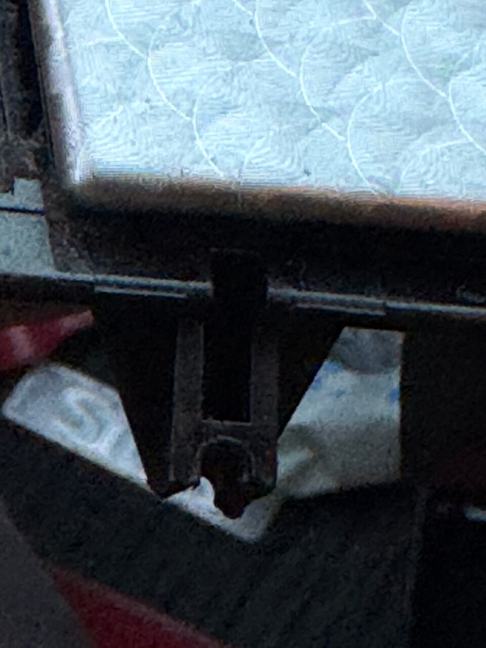

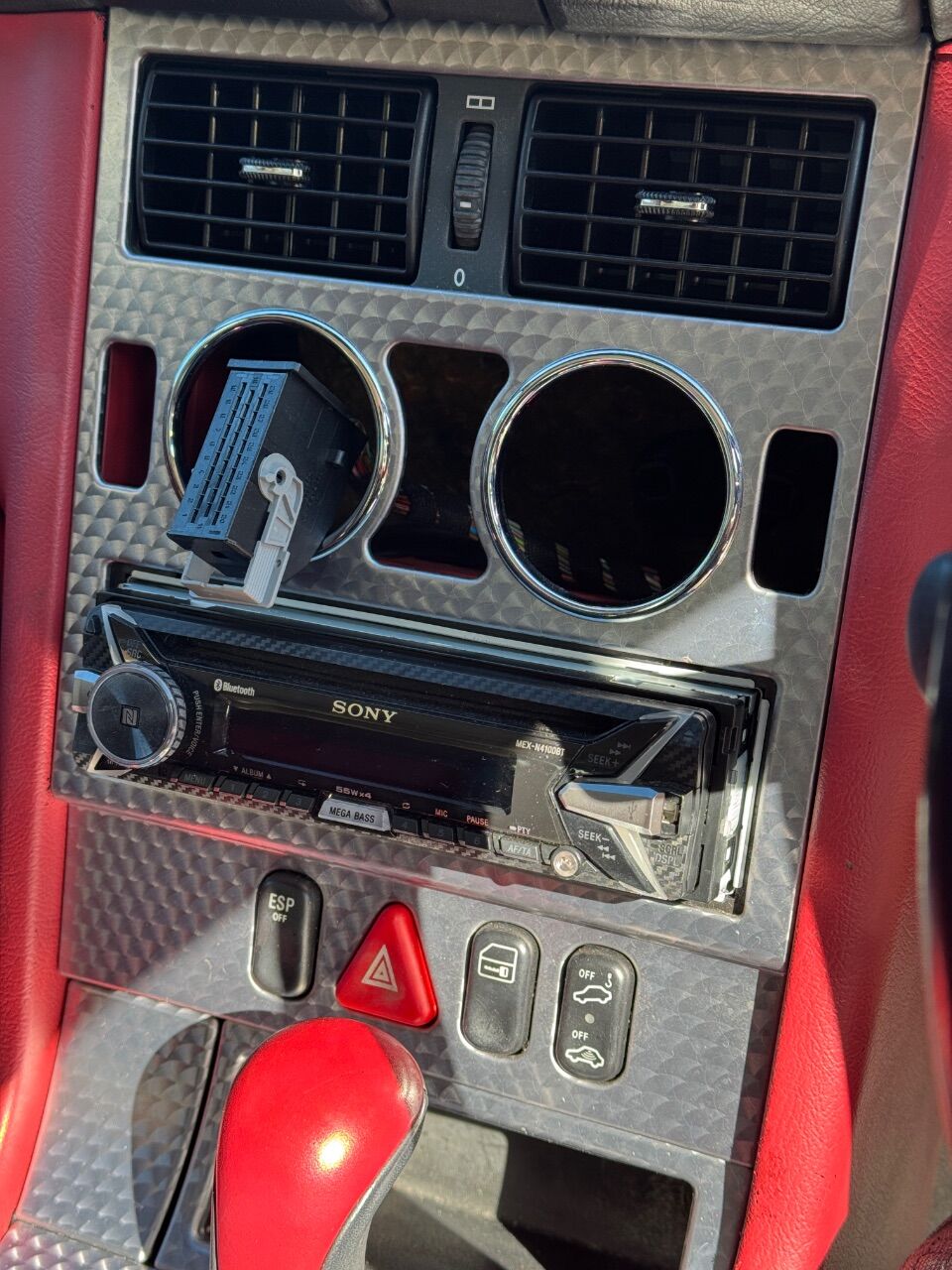

Wonky coin thingy and cubbyhole was trying to retreat into the dash.

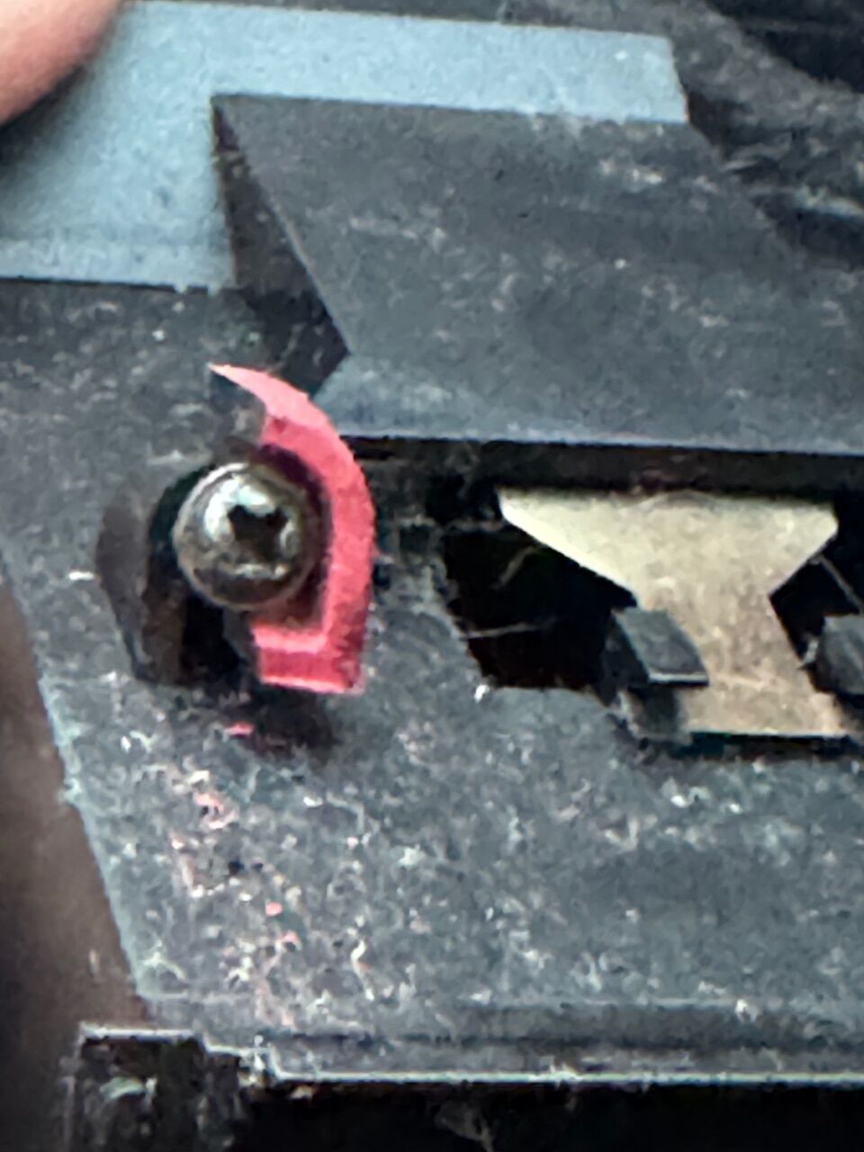

Couple of broken tabs
It looks nicer now! The red and aluminium is really quite good looking IMO.

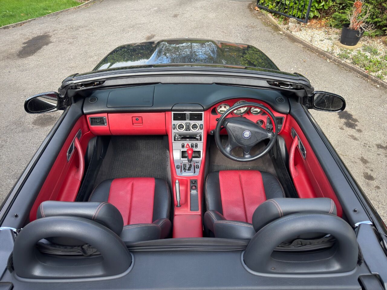

Is this the best interior on a cheap banger ever, or what?
The Sony MEX-4100 radio is bluetooth and has hands free, it also has an App mode and you can do things like selecting the phone's Spotify from the head unit. Neat! I was going to change it for single-DIN carplay but I won't yet.

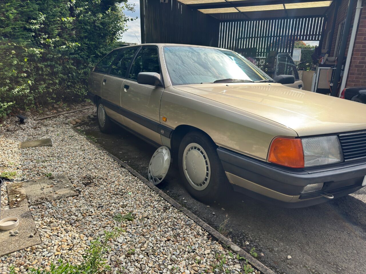

And some love for the Audi too!
Maybe auction that random odd wheeltrim it was wearing.

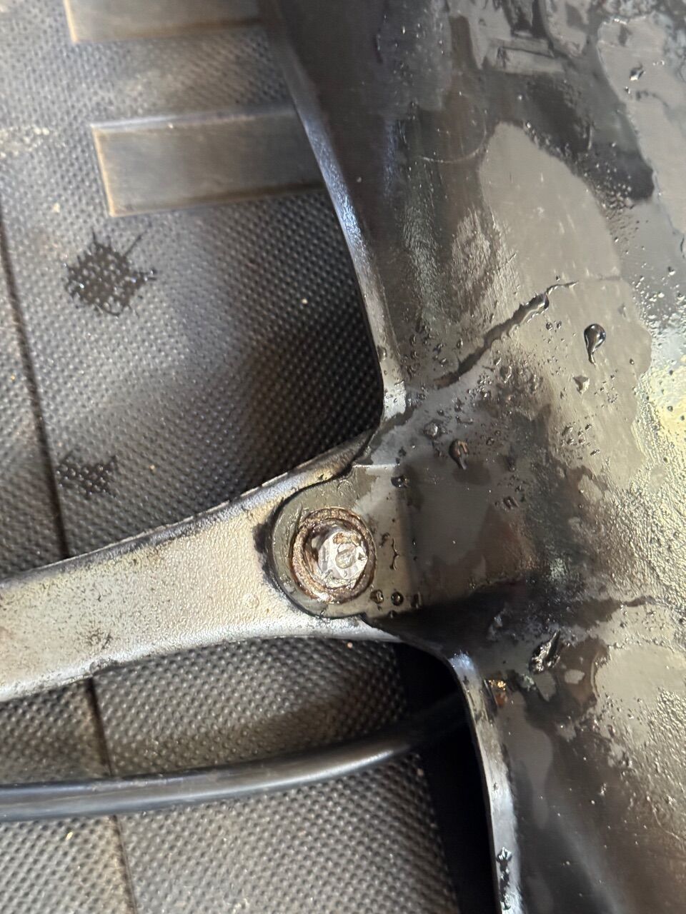

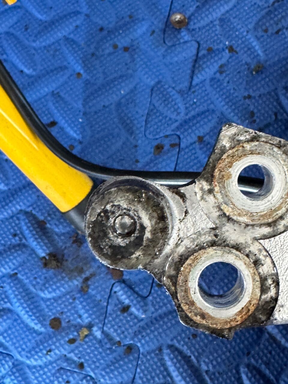

This, is a little bastard. It has defeated every bolt extraction technique I know and am happy to use near a leaking fuel line and plastic part I want to remove without breaking.
Including "broken bolt extractor number 3" and "angry chisel".
Going to grind the bolt head off to save the plastic part, then remove the bracket to get the thread bit out on the bench.
What a pain, though, the other bolts came out easy and this plastic shield is preventing me getting to the fuel pipes to replace the group over the subframe and fix the leak.

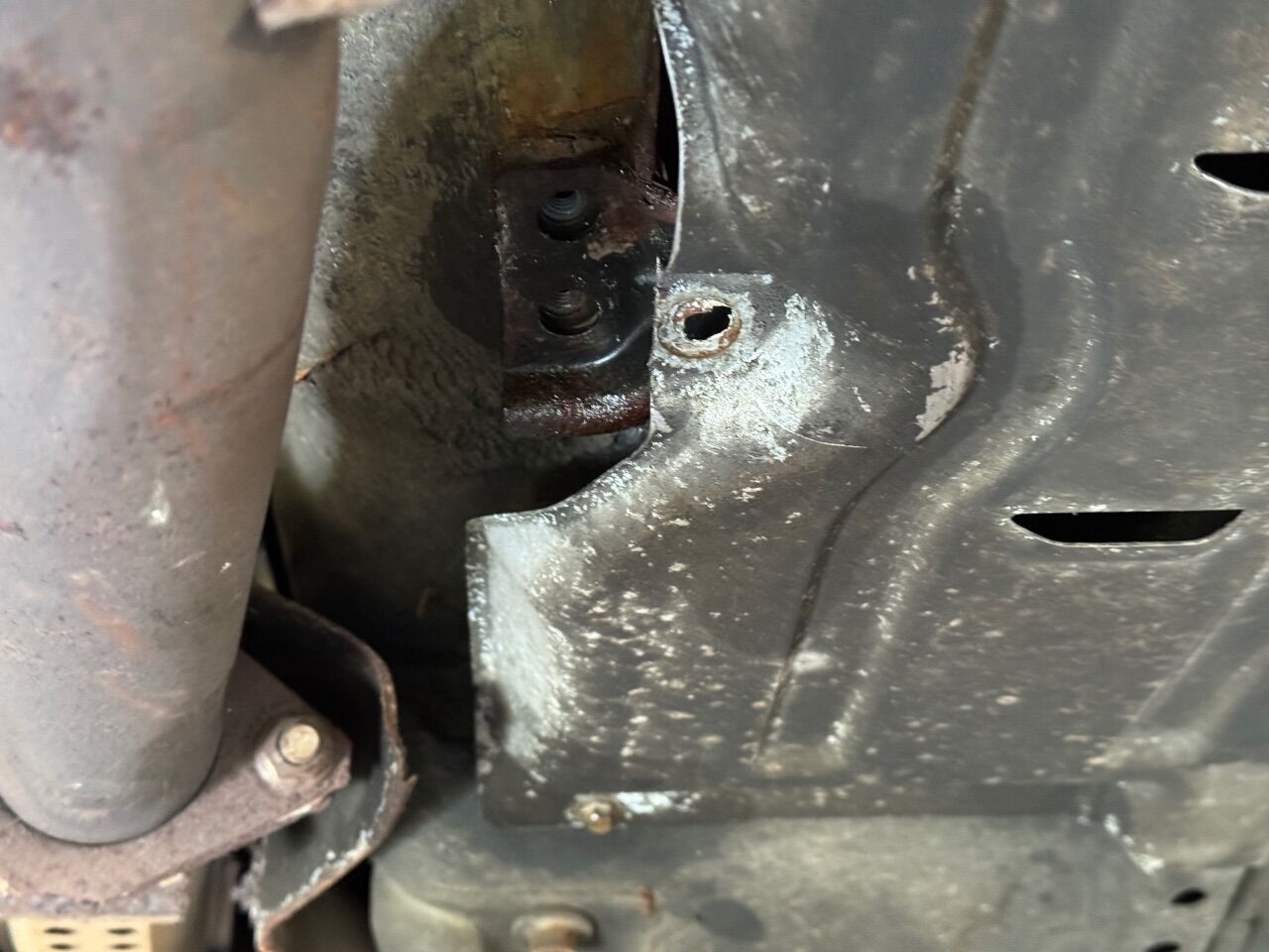

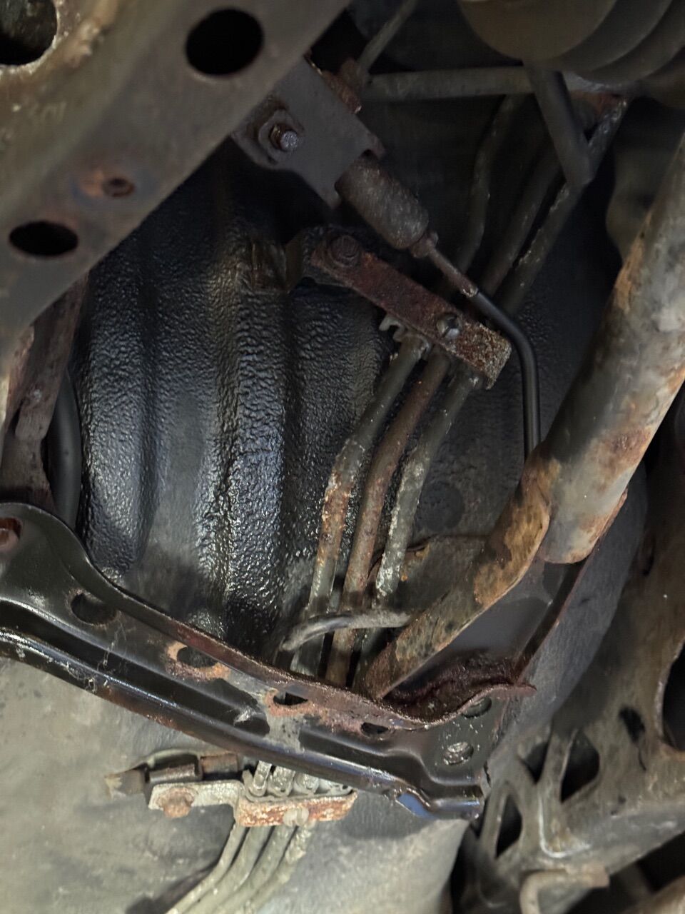

Failed at removing the bolt head. The opposite side undertray bolt at least had the decency to shear off.
So then the nerve-testing task of four 12mm bolts going into the car floor.
Then try and wrangle the weird bar thing though a hole in the power frame thingy to the diff, past the prop and floor.
And the reward? Still can't reach the fuel filter, and damn, I need to replace front to back as well.
4 minutes ago, Wibble said:

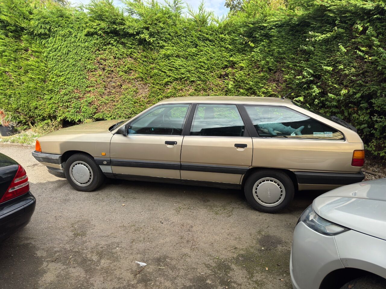

Just spotted your Audi whilst watching Bangers & Cash.
What? That must have been filmed when it was offered at Matthewson's I guess almost a year ago.
Which ep was it?
Just now, High Jetter said:
Which ep was it?
*slaps wrist*
Which episode was it?

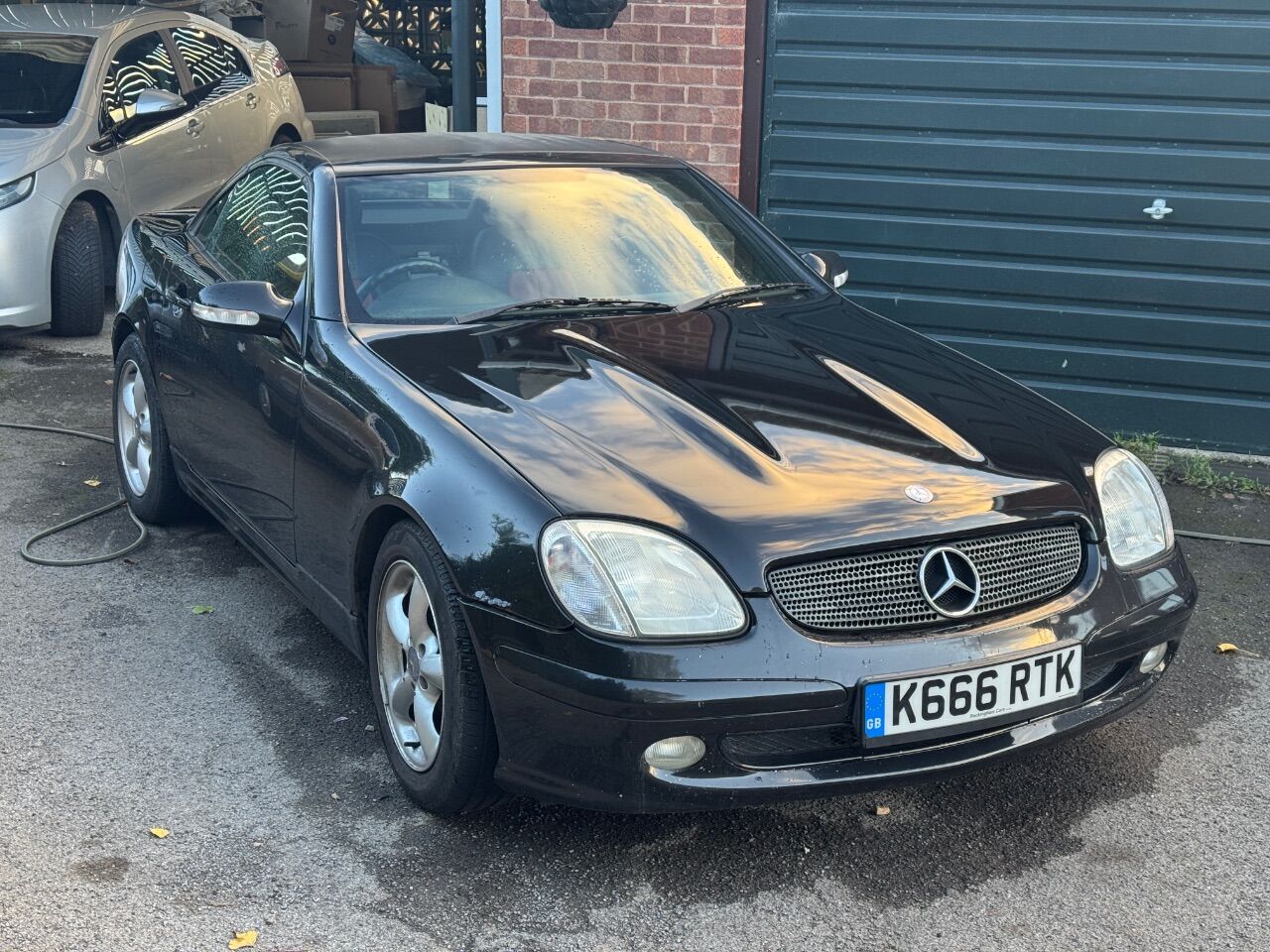

Will polish help?
Not unless it has structural qualities.
Actually it's not bad at all but need to tidy the bumper/wing mount.
The key with polish is to do the driver's side REALLY well, and the bonnet then you'll look at those as you walk past the car to get into it, the not see any of it from inside 👌 Bar the bonnet, that wants to be shiny and beading as you see it when driving but the rest, fuck it
Sheet of cheap vinyl wrap for the roof? Or blackboard paint 🤔
Blackboard paint is tempting. I'm thinking "just looks like a targa panel" if it's not glossy. Crackle paint like an X1/9 crossed my mind!

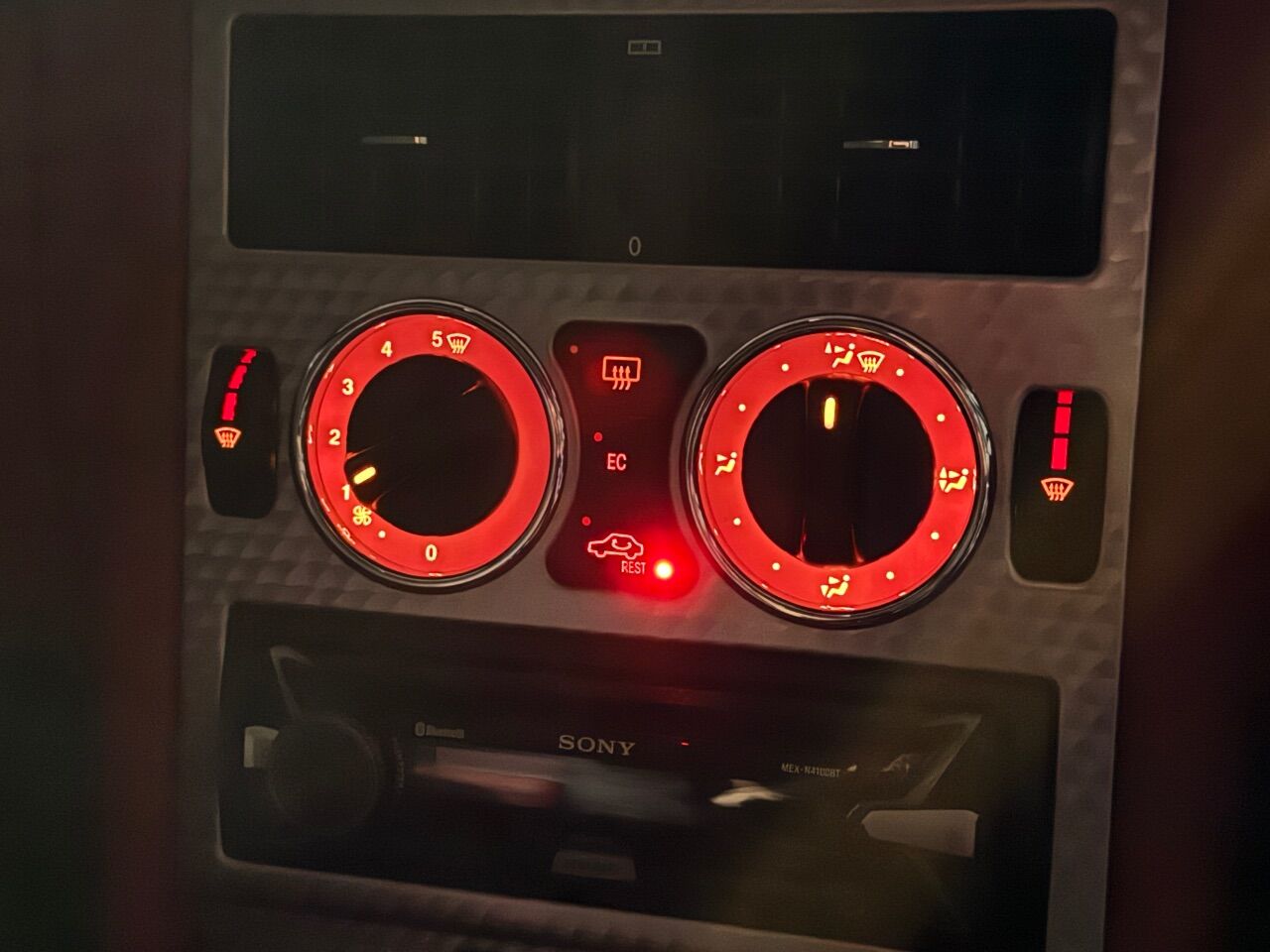

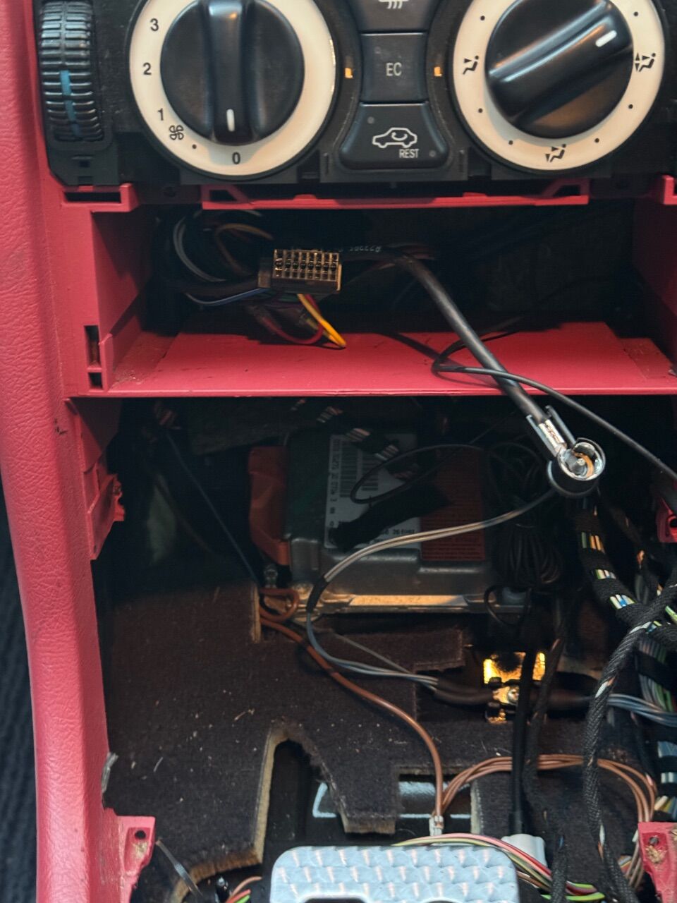

Pulling the underbonnet fuse to stop the fan running was getting annoying.
Much better. Just plug in the controls when I need to demist.
(Ordered a secondhand heater panel as everything I can see on the wiring and diagnostic manuals says this is the most likely culprit - particularly as the fan and the duovalve are waking up, and the rest mode can be activated when the car hasn't been touched or running when it should be disabled after 30 minutes).

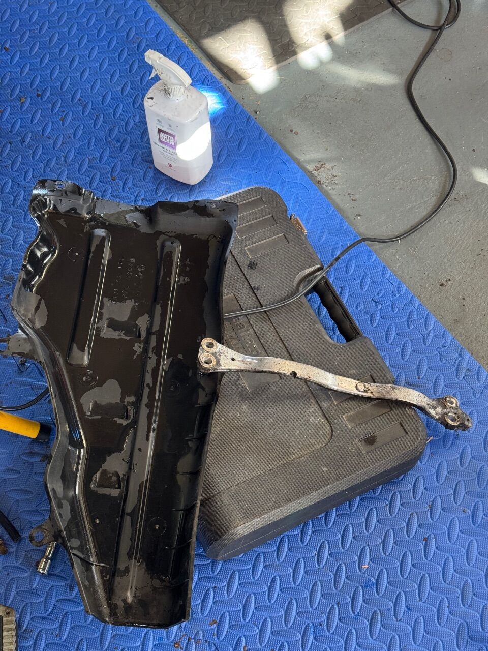

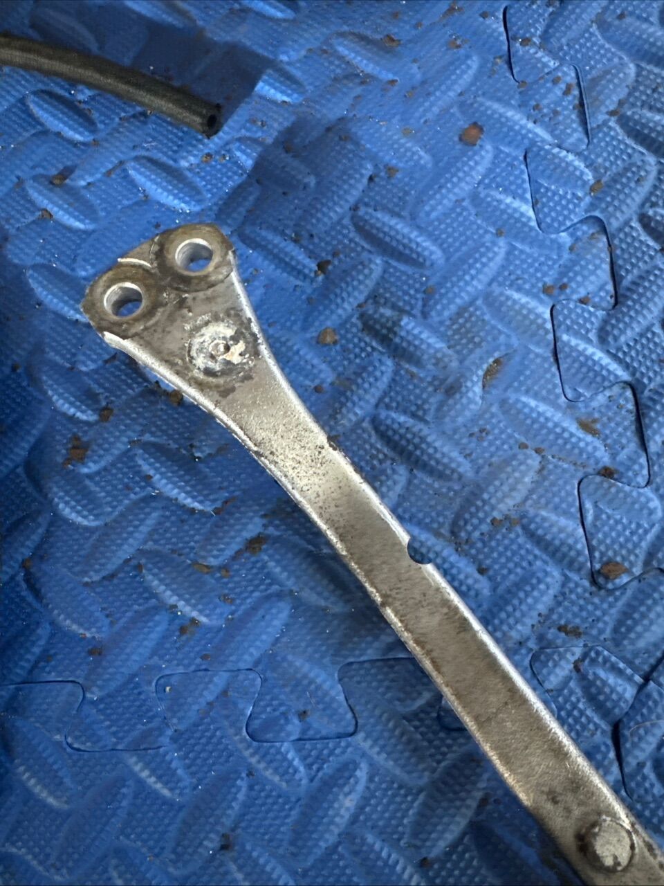

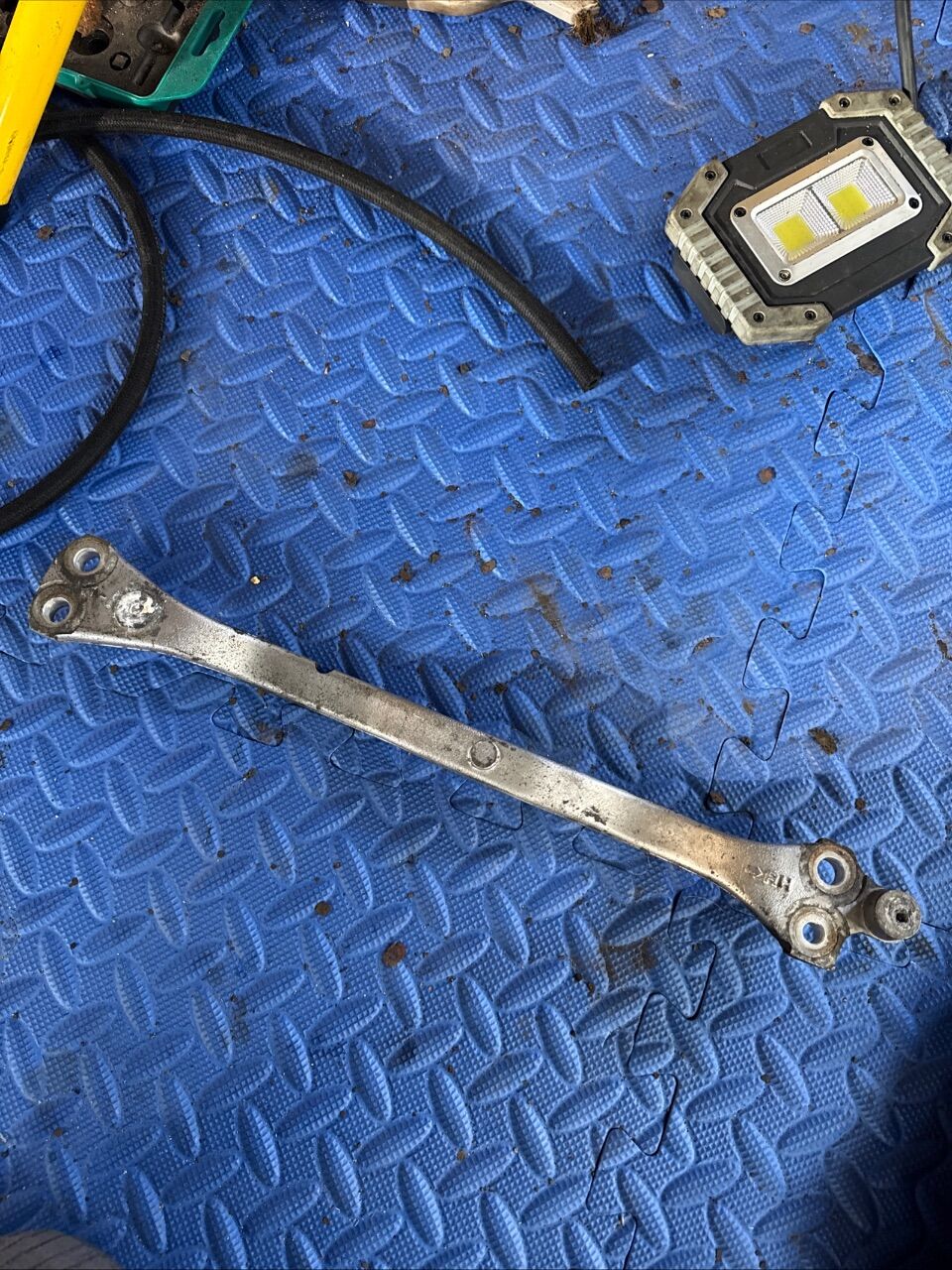

I have defeated the bolt holding part of the RX-7 undertray
Sort of.
It's still in there but the end finally succumbed to the fourth drill and extract attempt.
One of these without broken bolt ends stuck in it is £30 so bugger fighting it, I'll get a replacement - I think my drilling attempts hit the thread part anyway.
Managed to undo the fuel pipe bolt above the subframe as well, but the more I look the more little bits of rust-in-waiting I find and think the subframe needs to come off to properly treat the RX-7 shell.

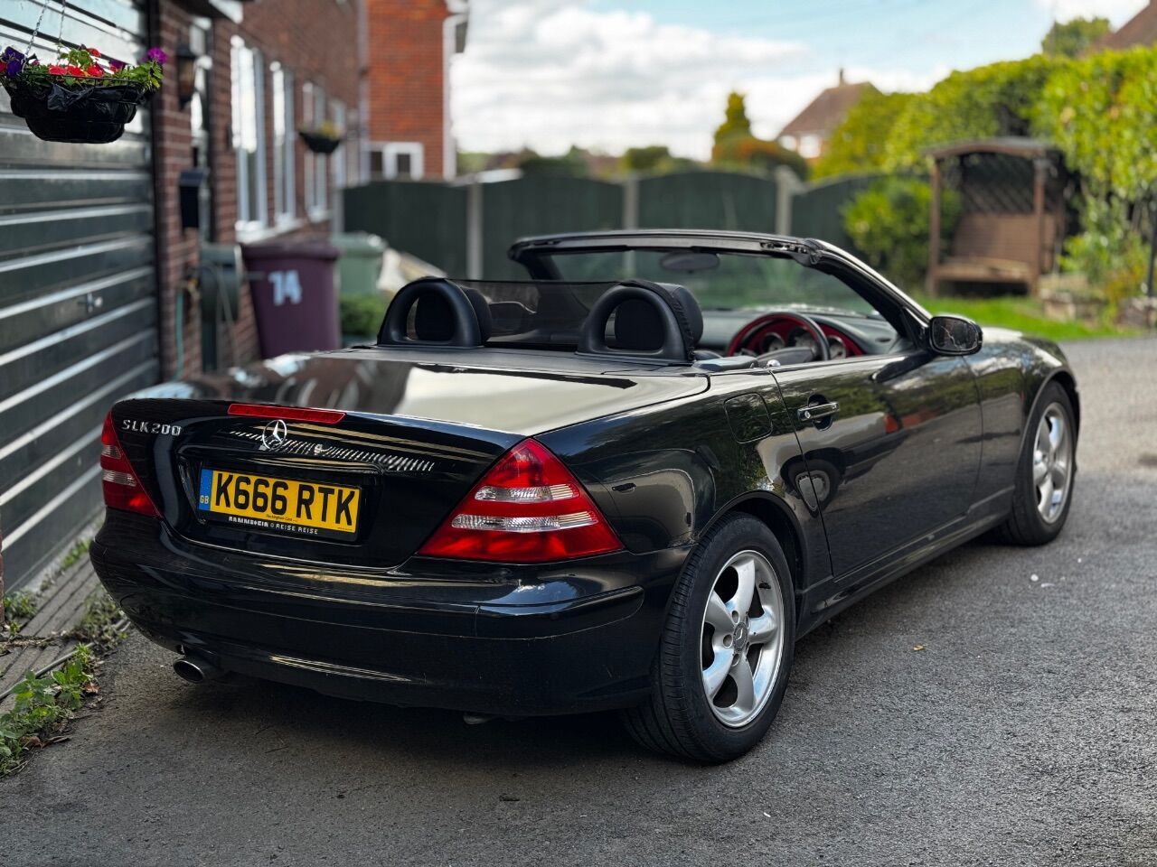

So much style for pennies
Roof down can't see the worst bit
And sitting in it, can see the best
V5 arrived so number is done, and a box with a £20 heater control panel.
So far I think the climate control fan issue has not happened since I fitted it and went for a drive... fingers crossed.
(Fongers still crossed - cold duovalve, no ticking, no fan sound... several hours later)

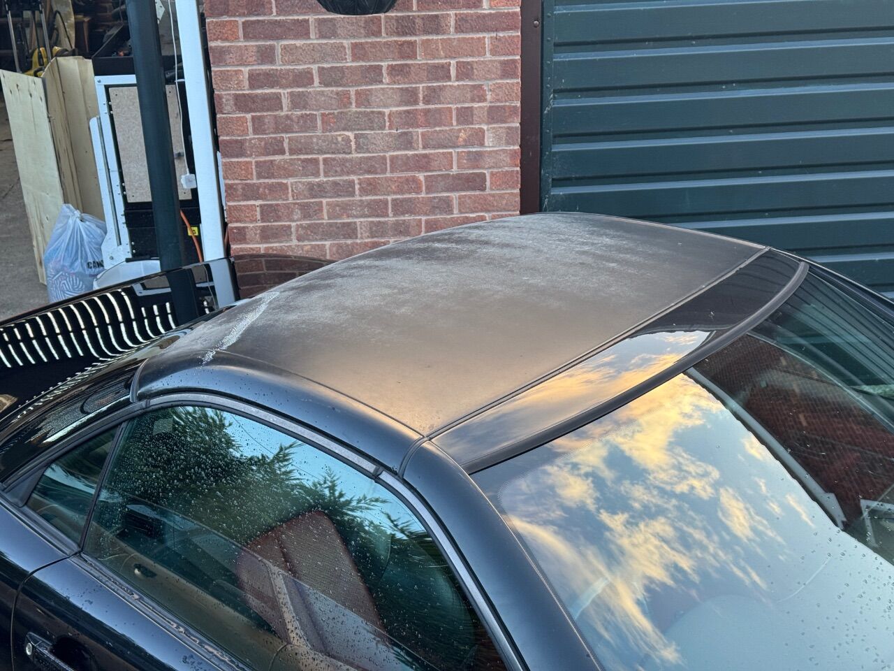

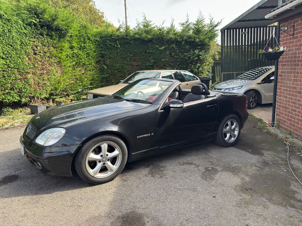

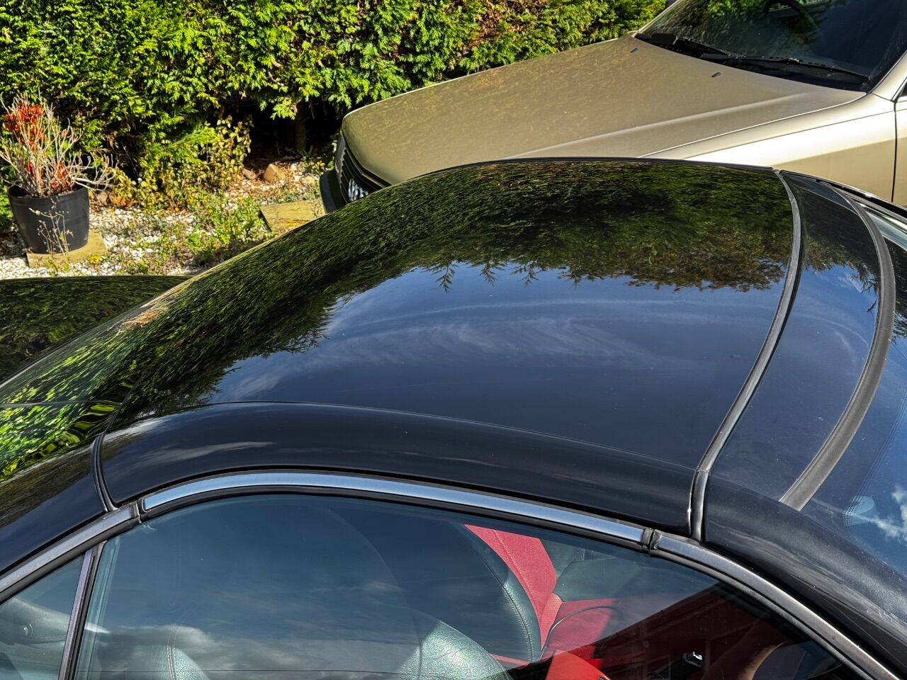

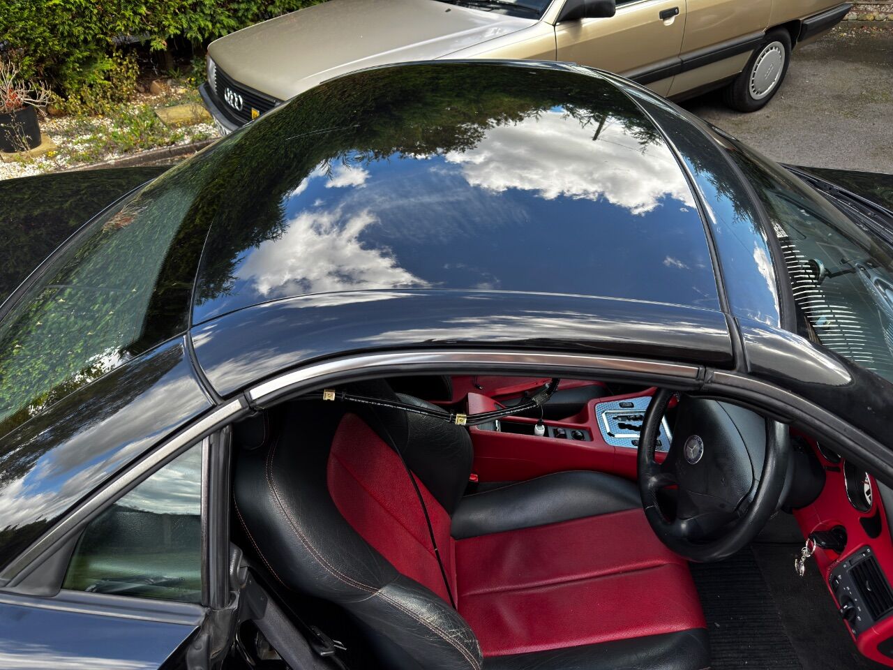

How it started:
How it's going:
How it got there:
Nearly done, I think I could do it in an hour if I had tea made and behaving ADHD.

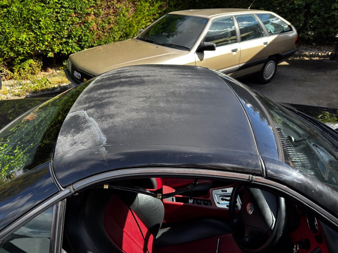

  • Bear changed the title to Bear's bangers: one batch of secondhand paint for the SLK

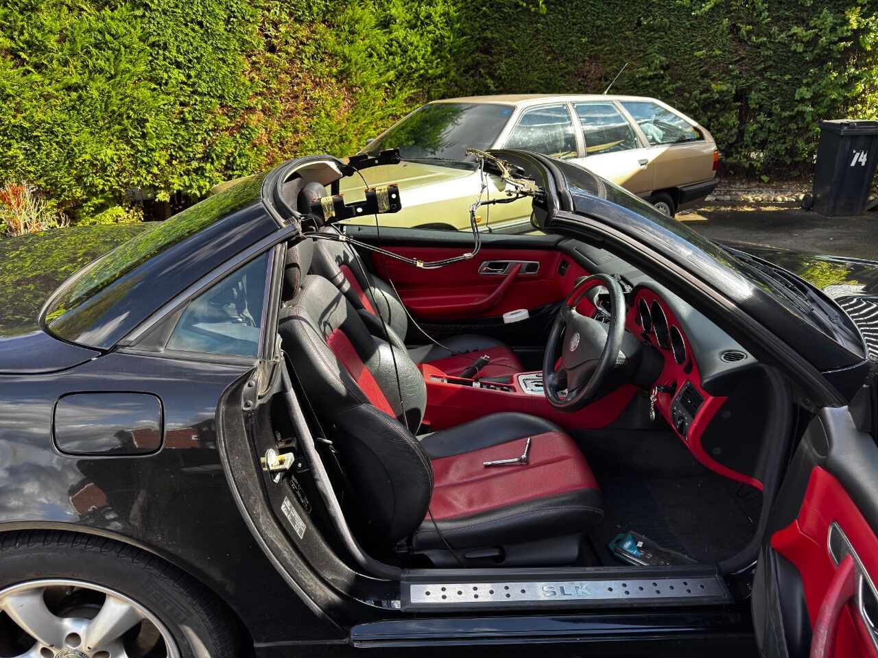

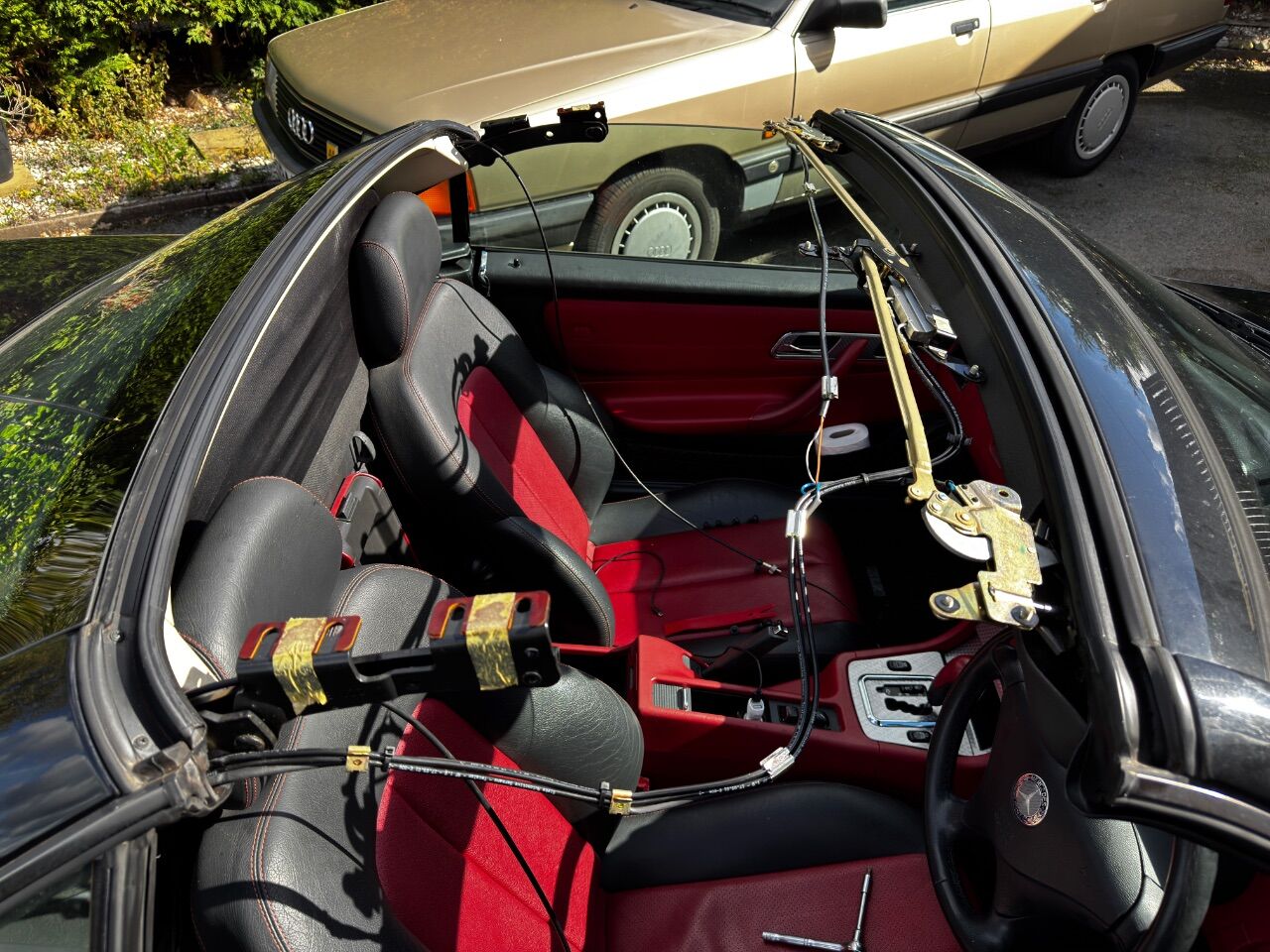

So, for anyone thinking of doing this:
Stage 1: Remove the headlining and side trims.
  1. Open the roof half way
  2. Undo the three screws per side that hold the side trims on
  3. Yes, there are three
  4. The other one is near the hinge
  5. Yes. That one. Don't break it like the person I got my roof from did
  6. They are held by a grabby metal clip as well, but it's not fierce
  7. Remove the three screws at the front of the roof headlining. Don't lose the cup washers
  8. Unclip five spring clips at the back inside the plastic edge trim
  9. Notice four have unclipped and the other fell off
  10. That's the rattling sound traced then
This is a metal guide for the bowden cables
Stage 2: Remove the roof panel
  1. Close the roof
  2. Yes, close it
  3. You need two torx bits, the smaller one does the fittings, the bigger one holds the roof to the arms

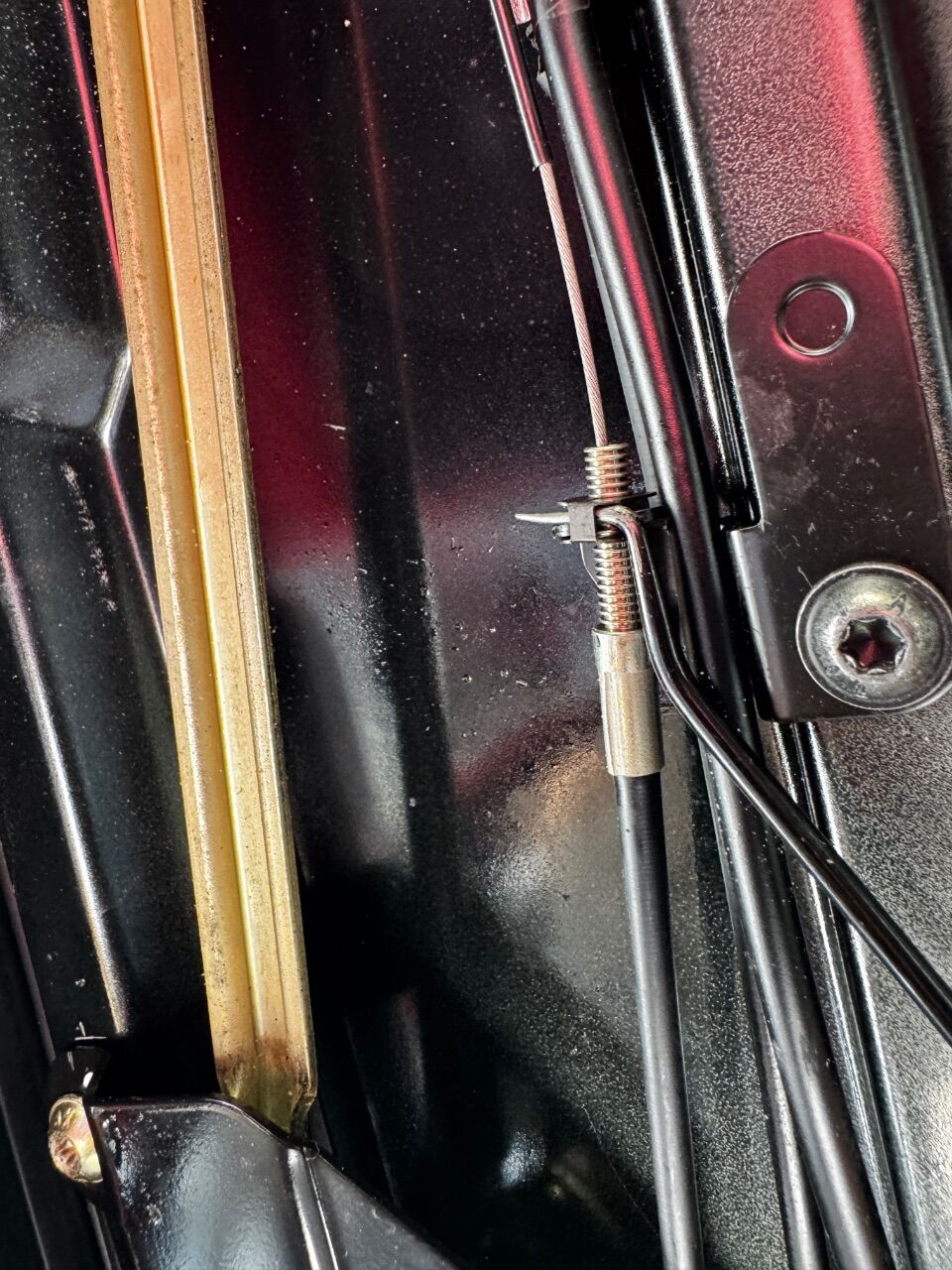

  4. Unclip the bowden cables from the roof latches
  5. Note the number of threads they are secured at on each metal bracket
  6. Release the clip and withdraw them, detaching the metal spring clips from the roof and then removing the bowden cable from the clips
  7. Remove the metal guides (black metal bracket with eye for the bowden cable)
  8. Feed the bowden cables past the latches and out of the roof skin
  9. Disconnect the guides from the roof mounted clips that hold them near the hinges
  10. Get the bigger torx bit
  11. Undo the four bolts per side holding the roof to the arms
  12. Look out for the shim plates that adjust clearance
  13. Detach the spring clips and cable guides holding the wires and hydraulic lines to the roof skin
  14. Undo the three torx bits holding the hydraulic cylinder and latch mechanism in the centre of the roof
  15. It won't fall or move
  16. Undo three screws per latch. A couple are captive, the ones near the switches have metal shields on
  17. Assuming all 9 front components screws, all 8 roof to arm screws, and any associated clips have been detached and you fed the bowden cables out, the roof skin should just lift up and off the car
  18. Admire the targa-top SLK with roof latches, pipes and wires hanging in mid-air from the header rail
  19. Take the rubber buffers and any stray metal clips off the old roof and transfer them to the new roof
  20. Those metal clips halfway up the frame at the back of the roof hold the cant rail trims, you want them
Stage 3: Fit the new roof panel
  1. Sneak up on the car in case it tries running away
  2. Drop the new roof panel over the gap between the front and back windows
  3. Ideally with the shiny side up
  4. And really, with the bolt holes for the roof arms at the back
  5. That's it. Now loosely fit the 8 screws holding the roof to the arms
  6. Don't forget about those shim plates
  7. Put the bowden cables back through the roof skin, clip then in as before, refit the brackets and make sure the bowden cable adjustment is the same as it was before
  8. Yes, the bowden cables go to the opposite side latches
  9. Wiggle the roof panel if needed to line up the latch screws
  10. Refit the latch screws loosely
  11. Secure the mechanism in the middle, securely
  12. Clip the metal carriers for the switch wires and hydraulic lines back on the roof
  13. Does the roof look like it is sitting right? Chances are it is
  14. Tighten the rear screws up
  15. Did you remember the shim plates?
  16. Double check the sensors, wires and bowden cables are routed correctly and clipped correctly.
  17. Tighten the latch screws a bit then open the roof
  18. Nothing went bang? Excellent
  19. Start closing it, stop before it fully shuts
  20. Tighten the latch screws
  21. Fully close the roof
  22. Nothing went bang? How does it look?
  23. At the back of the roof does the rear side window engage with the cant rail seal on the roof panel?
  24. Does the front edge look snug?
  25. Does the back end look like the gap is even?
  26. Everything tight?
  27. Too tight? Did you remember the shims?
  28. Operate the roof fully listening for snags, horrid noises or other worrying things
  29. Switch off Radio 4 News
  30. Still hearing worrying things? Check you did everything up
  31. Roof not moving? Did you reattach the bowden cables properly?
  32. All working? Tighten things properly (ideally should have loctite), I don't have torque specs but common sense applies
  33. Try it again, if it all opens and closes as it should it's time to run a tap
  34. Yes. A cup of tea is a good idea
  35. Afterwards, spray a hose and look to see if water gets in
  36. More than usual
  37. Stop powerwashing the A-pillars
  38. Okay, it's dry. Open the roof half way again
  39. Refit the centre screw of the headlining, then clip the five clips (four and broken bit of trim) in to hold it
  40. Now refit the side trims. Start by carefully lining up and sliding the tab for the rear bow into the edge
  41. Now align the headliner edge with the guides
  42. Fit the plastic trim fully, remembering to feed the seal
  43. Once the aquatic mammal is fed, also put the cant rail seal over the plastic
  44. If there's a gap make sure the rear floating piece goes between the roof and the hinge, not in the middle of the hinge
  45. If there's a bulge make sure the floating guide is in the metal clip that holds it against the roof edge
  46. You did remember to swap the clip, right?
  47. Now do up the screws holding the side trim
  48. Now do the last two screws on the headlining front edge
  49. What's that on the passenger seat?
  50. Is it a roof shim?
Congratulations, you have swapped an SLK roof.
There are some adjustment points and on mine the roof is now a snug fit with better alignment of the window surround trim, but the passenger window looks like it might need tilting in slightly to seal properly.
Looks very good!
What is the plan for the old panel, paint it up as a spare, or just leave it to consider its own poor cosmetic condition in the corner?
