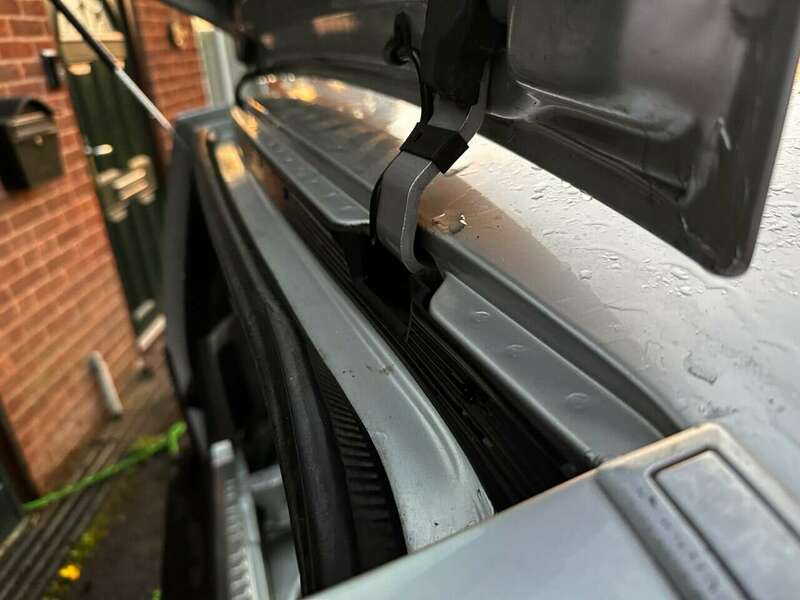

I found the MG's boot leak!

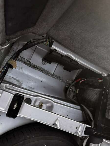

Holy crap they just chucked these last ones together. It's the panel below the back window on the passenger side, the seam just isn't very well sealed. Going to fix that. I guess over time the paint gives up so the leak shows up later in the car's life. Small amount of surface rust gave it away.
That and it dripped on me while I was fitting a boot strut.

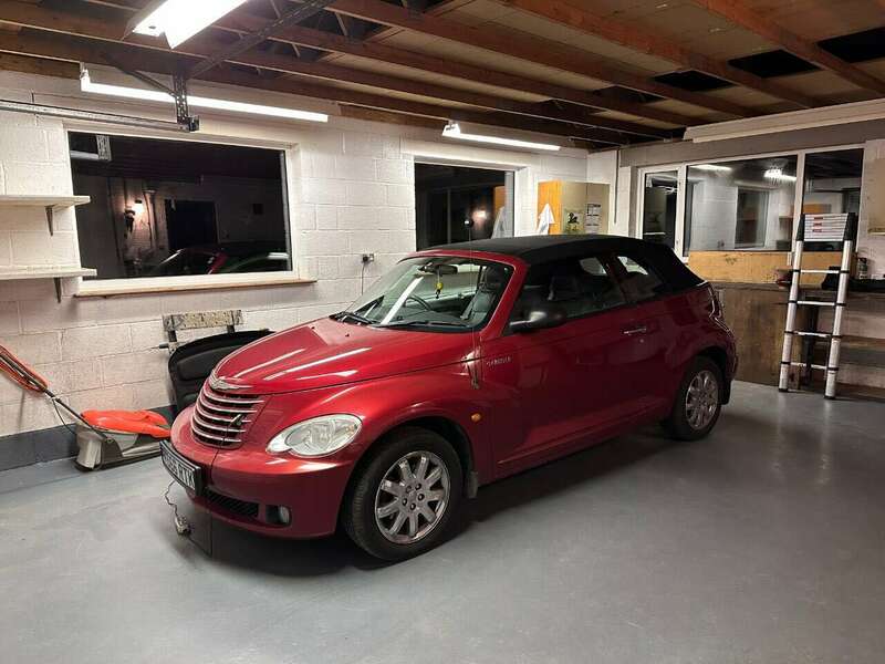

Lilith approves;
Traditional ‘no furniture takeaway on floor’ but WITH FRIENDS WHO LIVE NEARBY!
Posh git - not a garage for your car, oh no - it's got it's own room!

To be fair this is basically the second reason for this house after "near awesome friends"

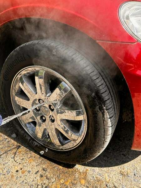

Roads to Boroughbridge messed up so went through loads of hilly villages. A horribly familiar pulling on the steering/hangy feeling.
Got to consecrated ground and chucked holy water on the wheel.
FFS. 14,000 miles and not driven in salt. I /hate/ cheap floating calipers.

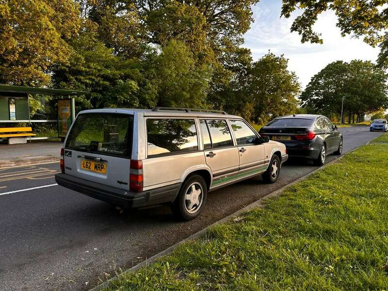

Volvo 940 Has Entered The Chat:

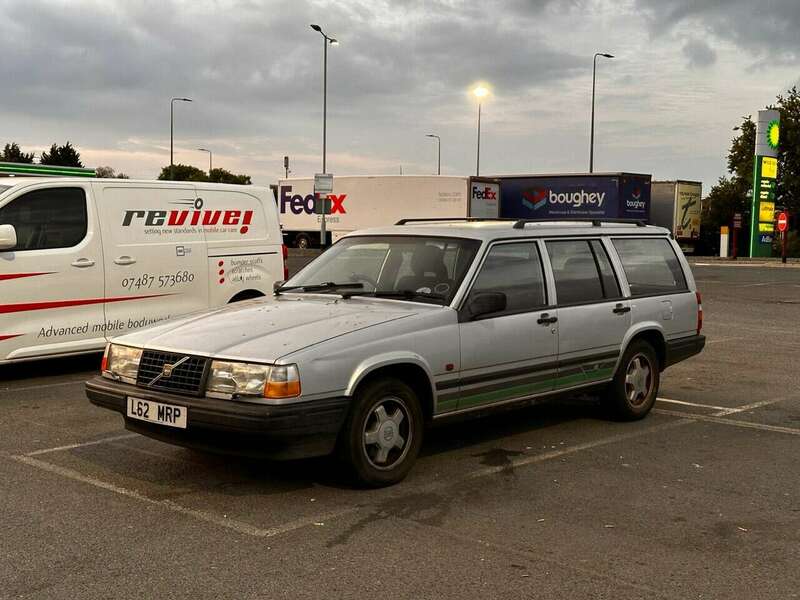

@Kade dropped it at Peterborough after work - I was going to leave it there but decided to do the return run and then go home in the Volvo. Which means this car happily did 5 hours of motorway driving yesterday...

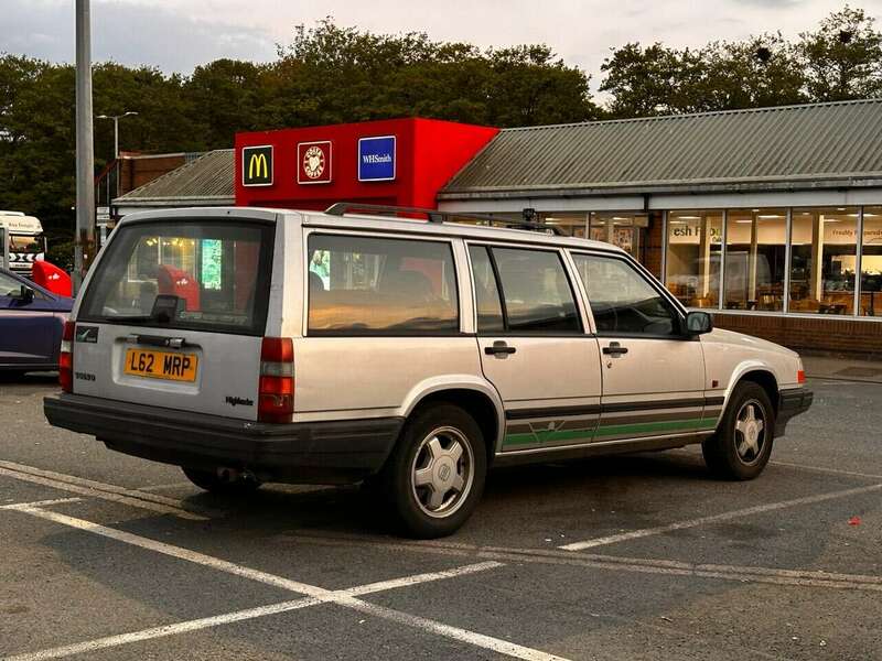

Watford Gap after 3 hours of A1, wiggly road to M1 and M1
Need to make sure no-one steals that H
Home.

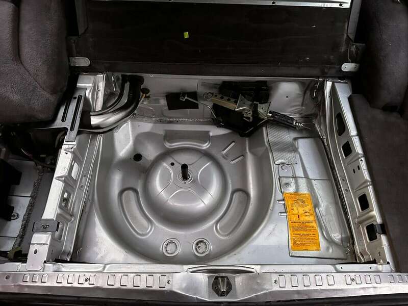

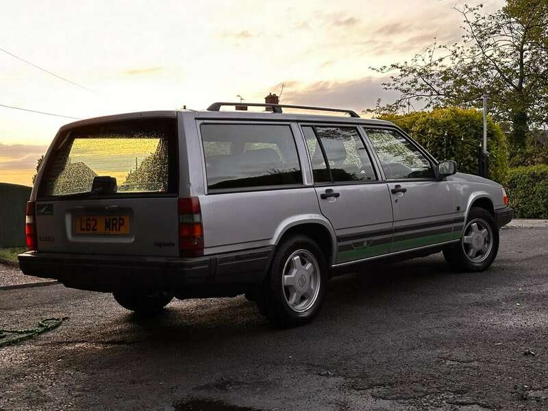

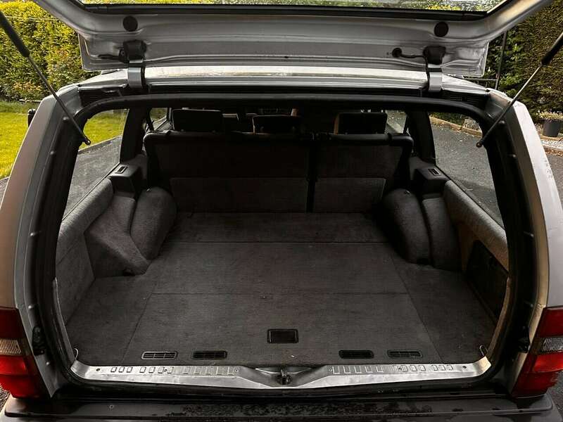

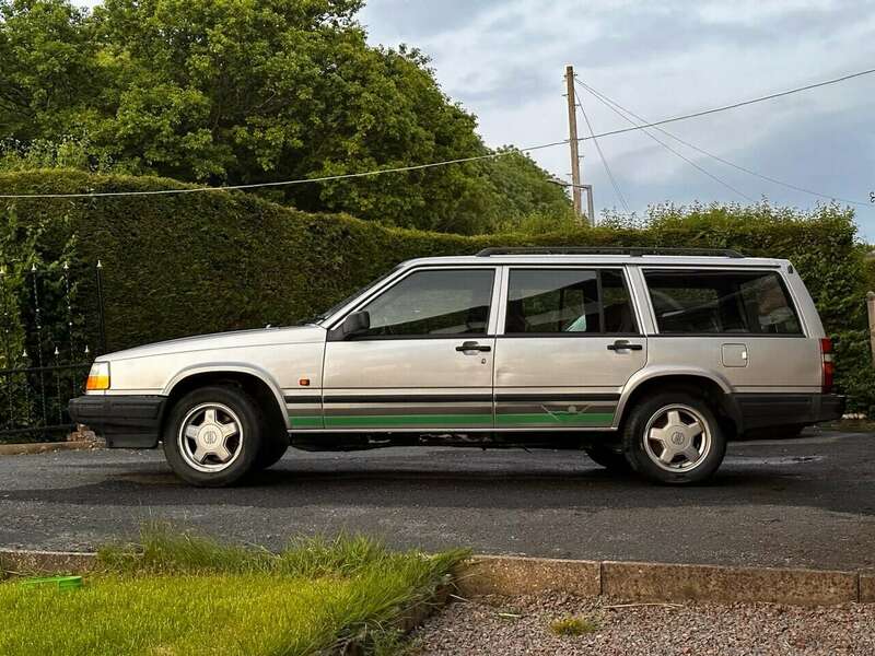

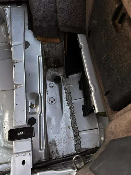

Looks like about 150K, drives well, didn't notice clutch slip or issues, temp rock solid. Heater hot not connected - suspect a broken cable or thing - but fan works. Windows work. Needs dashboard sorting.
Brakes excellent, no untoward noises. Aside from a clean patch near the battery, no welding that I could see.

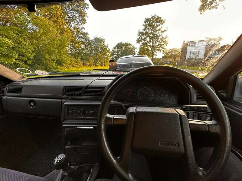

And the view out is lovely. Why did cars have to lose low windows and visibility 😕

No idea tbh - took our 'new' 1998 940 down to the West Country for its first long range trip and my father in law was 1000% delighted to have a tour around the local giffer places (recycling tip, garden centre - the usual).  The window ledge is perfect to rest an elbow on and the view out is tremendous all round. Long bonnet is a consideration but nothing worse than my old Outback (counter balanced by the fact that a cambelt change is appropriately easier).
Only complaint is that the driver's seat needs restuffing under the butt and lumbar area as it kinks your neck a bit on the headrest.

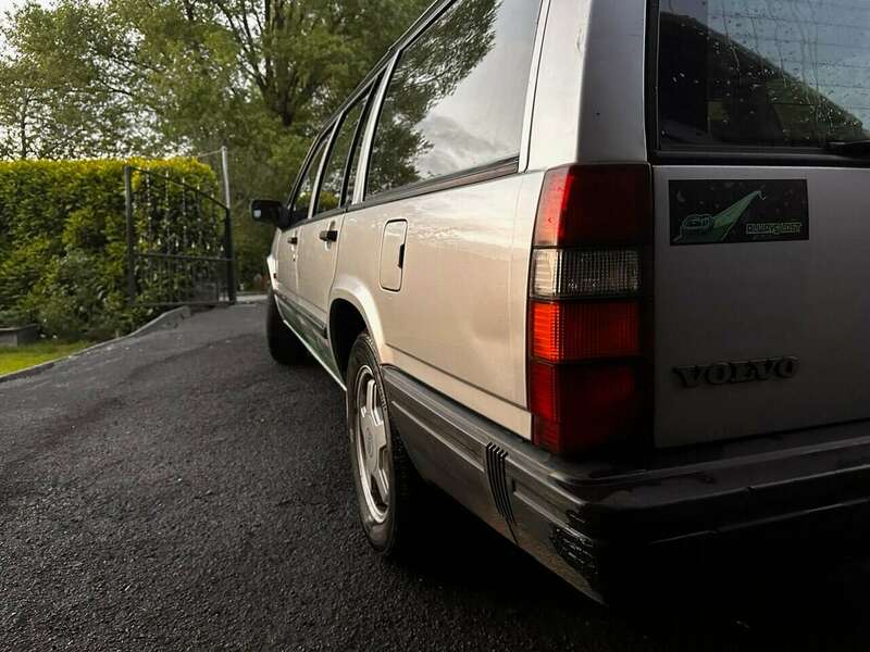

The wheels

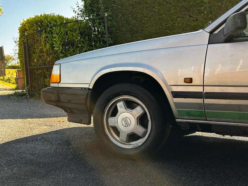

The stripes

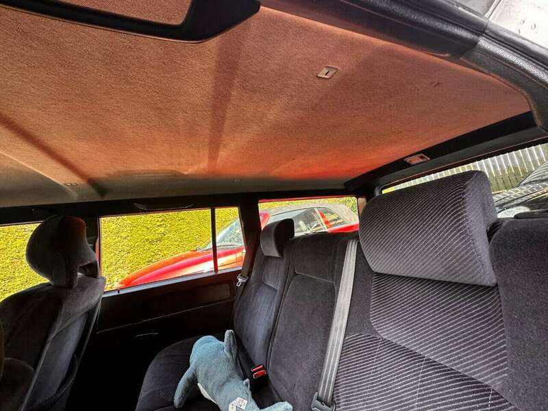

The interior
Oh, my. 🤤

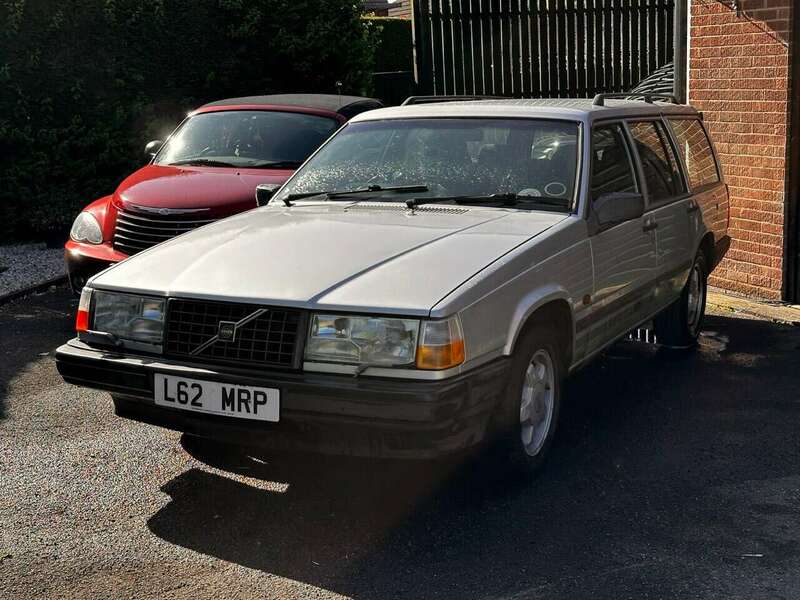

So, I am making a start:

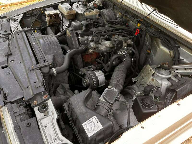

First - it had a wee misfire on the M1, enough to notice, not enough to worry, so "open wide"!
Look at wires...
Oops!
Well that'd do it. New Bosch leads ordered.

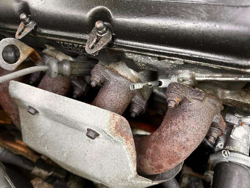

Also assuming this was once electric which may be an error, have ordered a new antenna core.

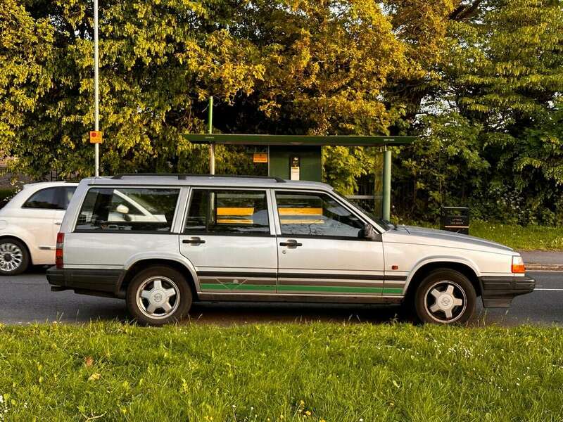

10 minutes ago, hairnet said:

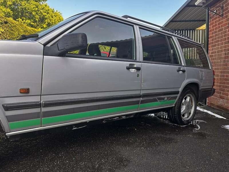

that green stripe needs to die by hairdryer
That green stripe is going to be colour-matched and replaced if I keep this car :D

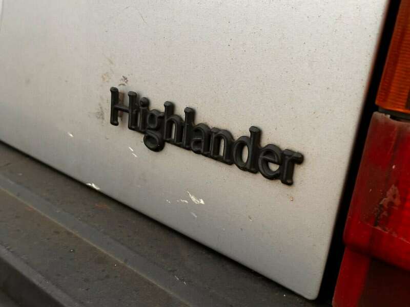

but then it wouldn't be a Highlander and would presumably be less economical and skilled at crofting

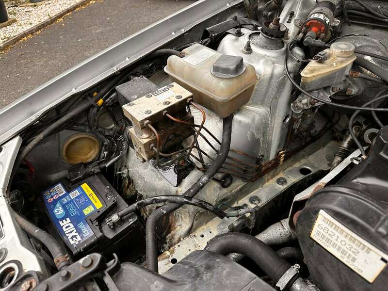

Waiting for new HT leads and a bike to be delivered, so I thought I'd prep MacLeod for some good old-fashioned waxoyl abuse.
Realised the ill-fitting washer jet has migrated from the tailgate, so obtaining a replacement bonnet one and restoring the washer pipes to their proper places!
Engine parts I tend to go for the dry bike chain wax. Good way to protect things that move, and easy to apply, it also goes on exposed bolts and things.
Distributor cap and points tend to get ignored by previous owners because they are such a faff to get at.
They are on the list but Bosch cap is expensive. No points, surely, on this?!
I had one can of Waxoyl left!
Hairdryer deployed, that chassis leg is /full/ of hot clear waxoyl now. And I will be getting more done on the other side of the inner wing.
This thing is an absolute delight to work on, space-wise.
