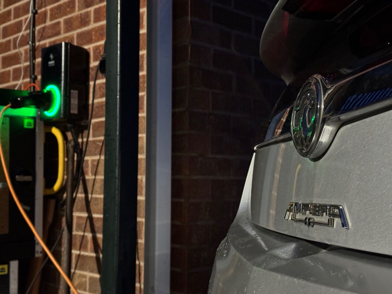

Charger switched on again after well over a year unused.
Yeay!
I need to fix the online connection for the charger.

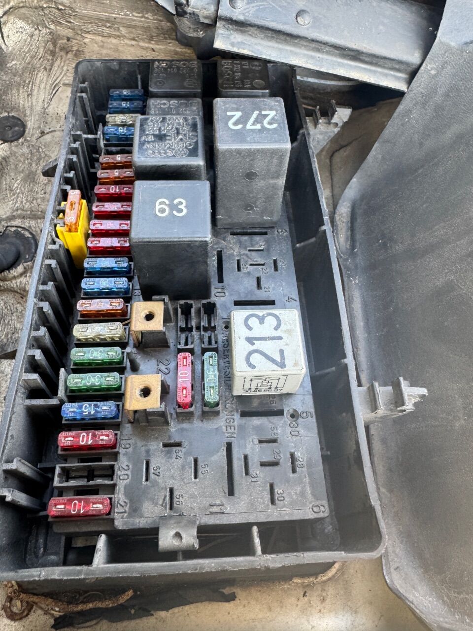

check the relays and while we're here...

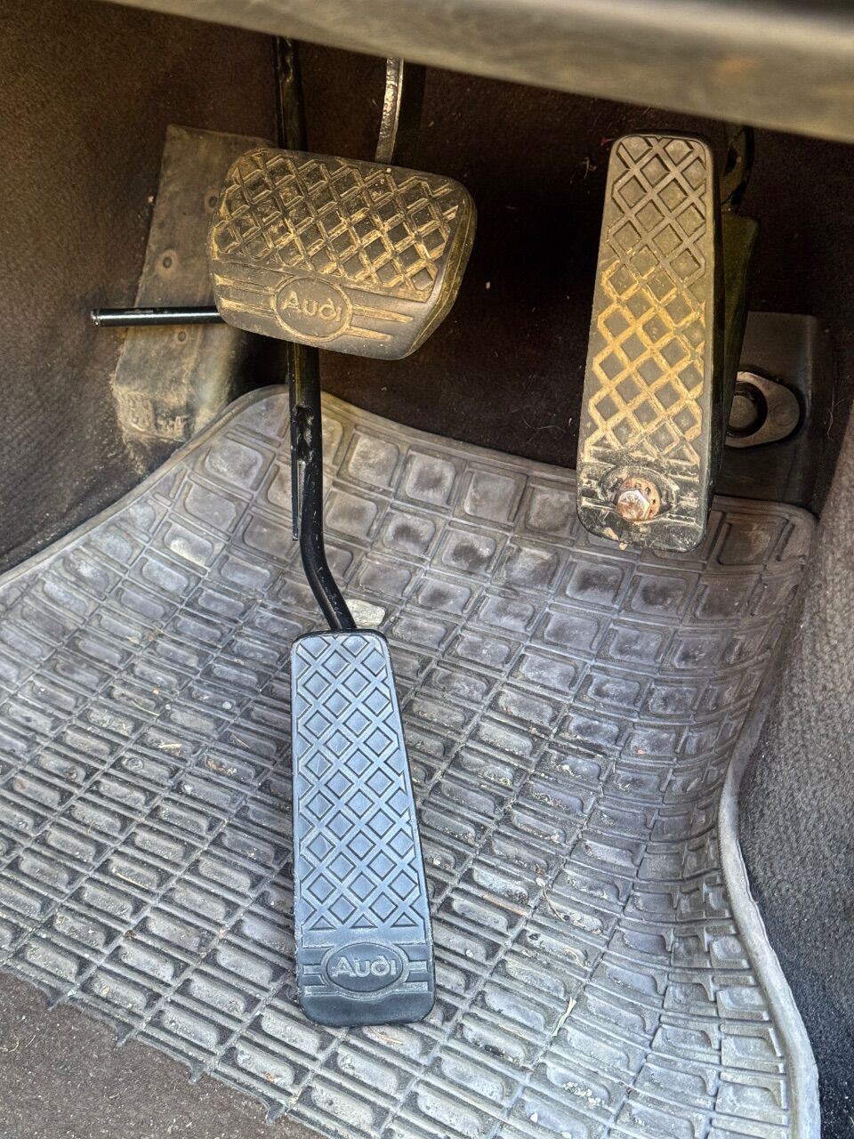

If anyone missed my last 50 birthdays and feels bad, a new brake pedal cover is £25 and I just can't bring myself to spend that much on a piece that is functioning fine but it would look great with both pedals "new" 😂

More relays. They do appear to be correct so I think I need to check the autocheck board for problems.
The rev counter jumping to a fixed reading and not moving, plus the oil pressure warnings, are probably related and I bet there's a bad capacitor or something on the autocheck board.

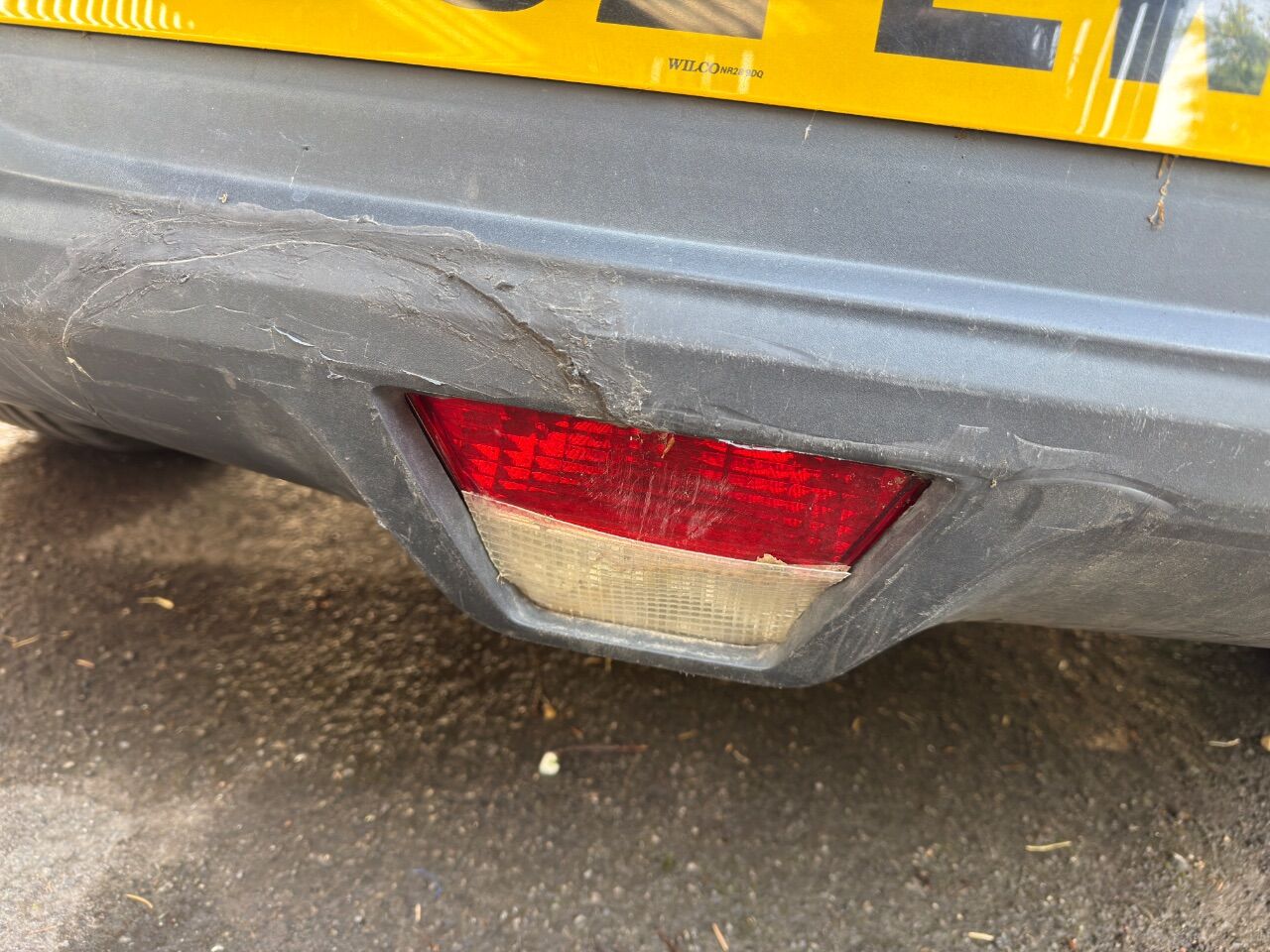

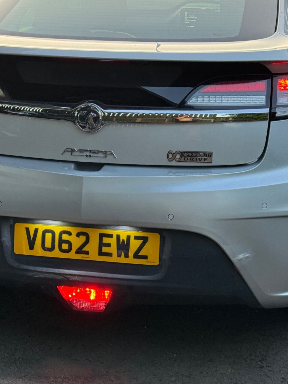

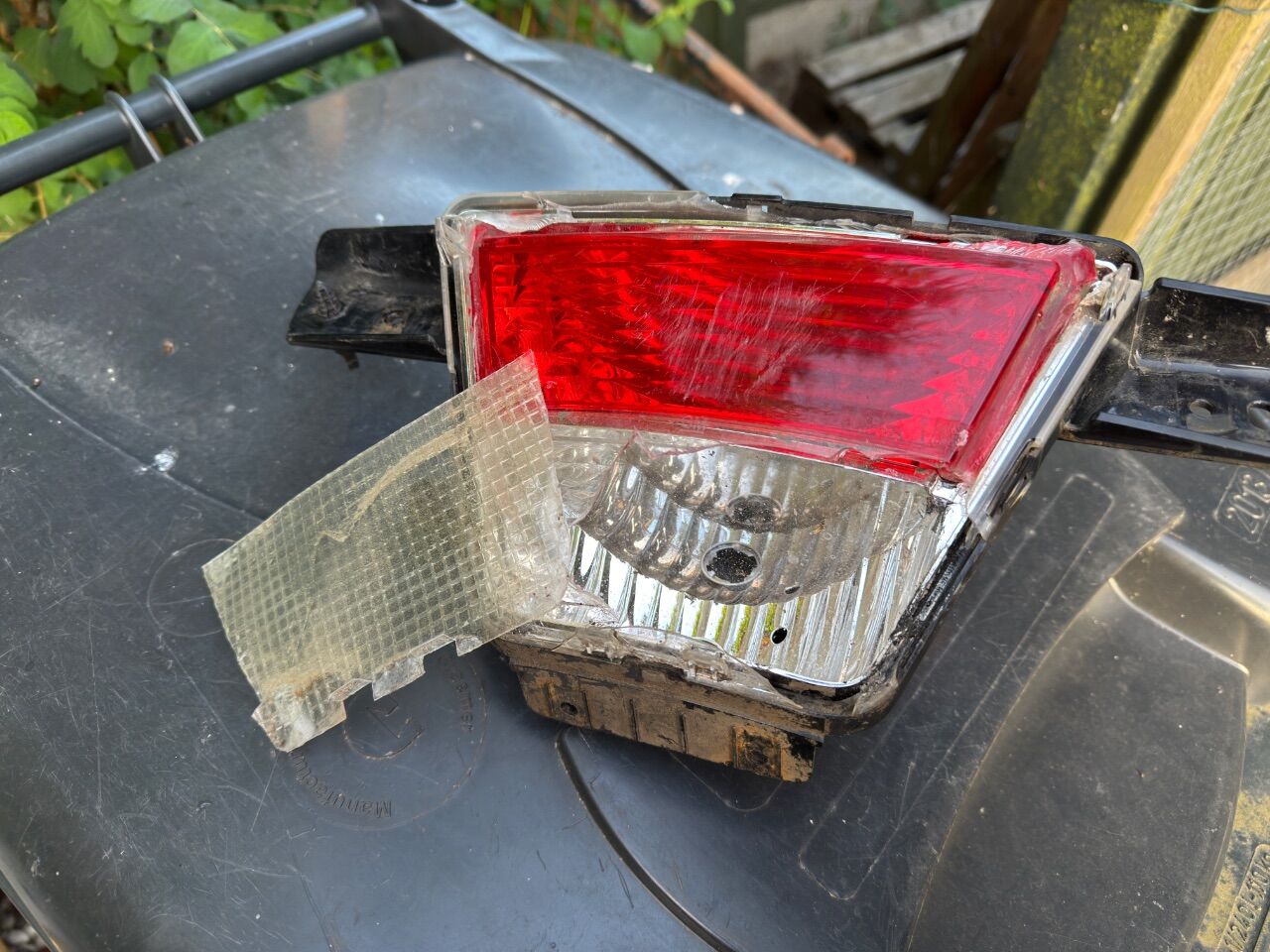

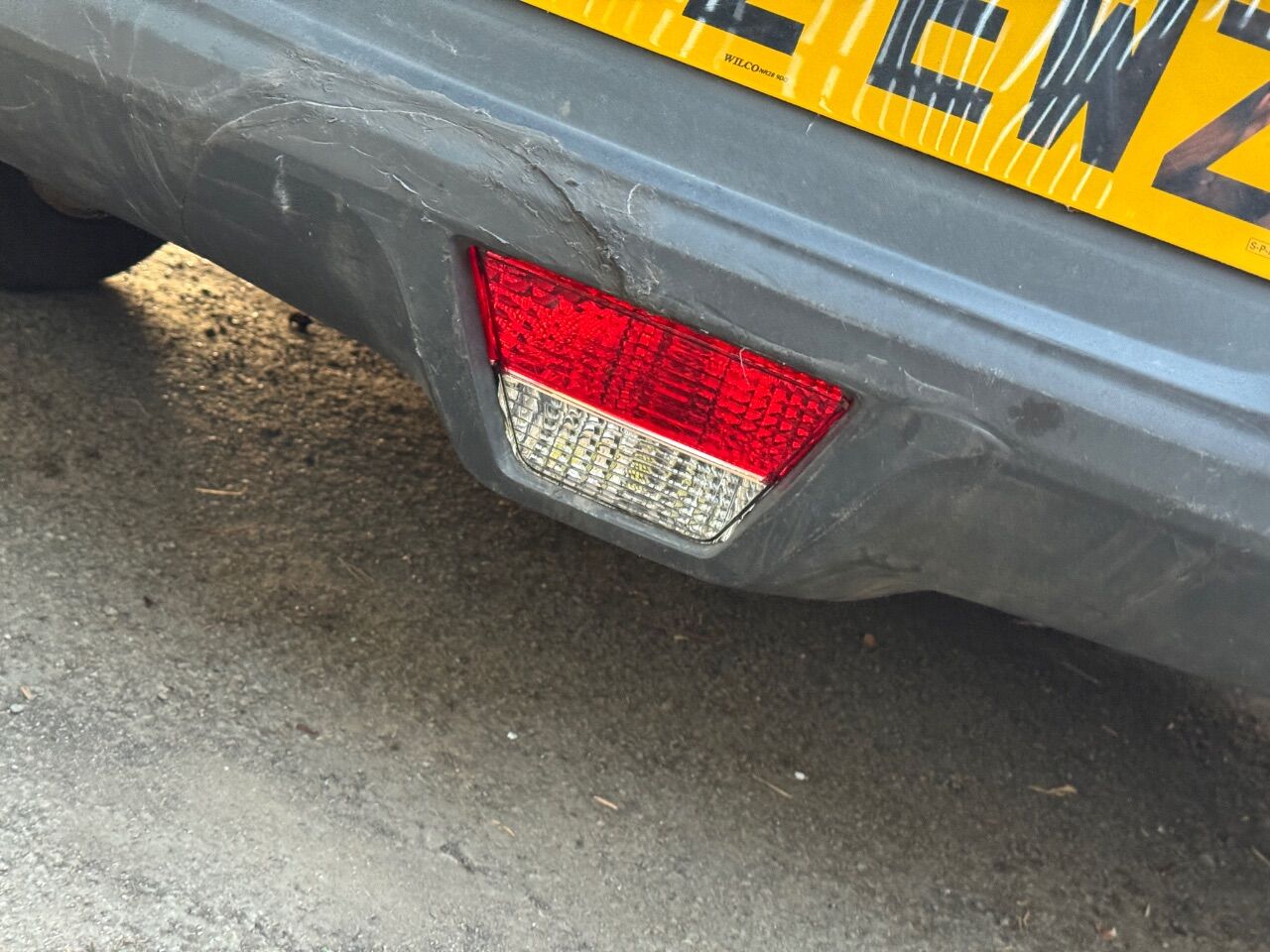

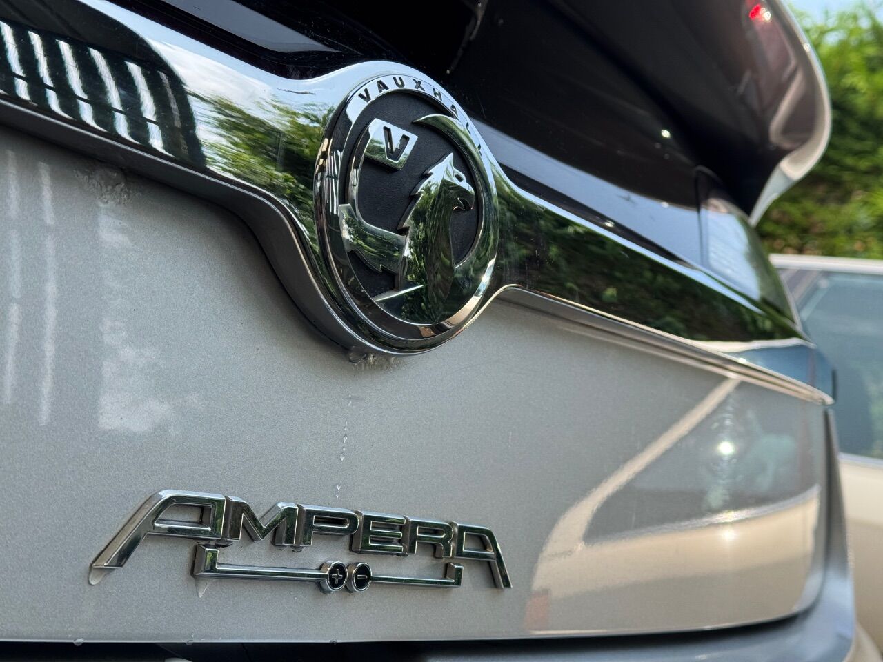

Walked past the Ampera and thought this looked a bit sad:
A tarnished griffin, poor thing...
Plastic chrome polish is good.
Also works on lights, and a clay bar has helped the bumper's larger surfaces before I do some tidying.
Old-school combustion reflected in the amp era...

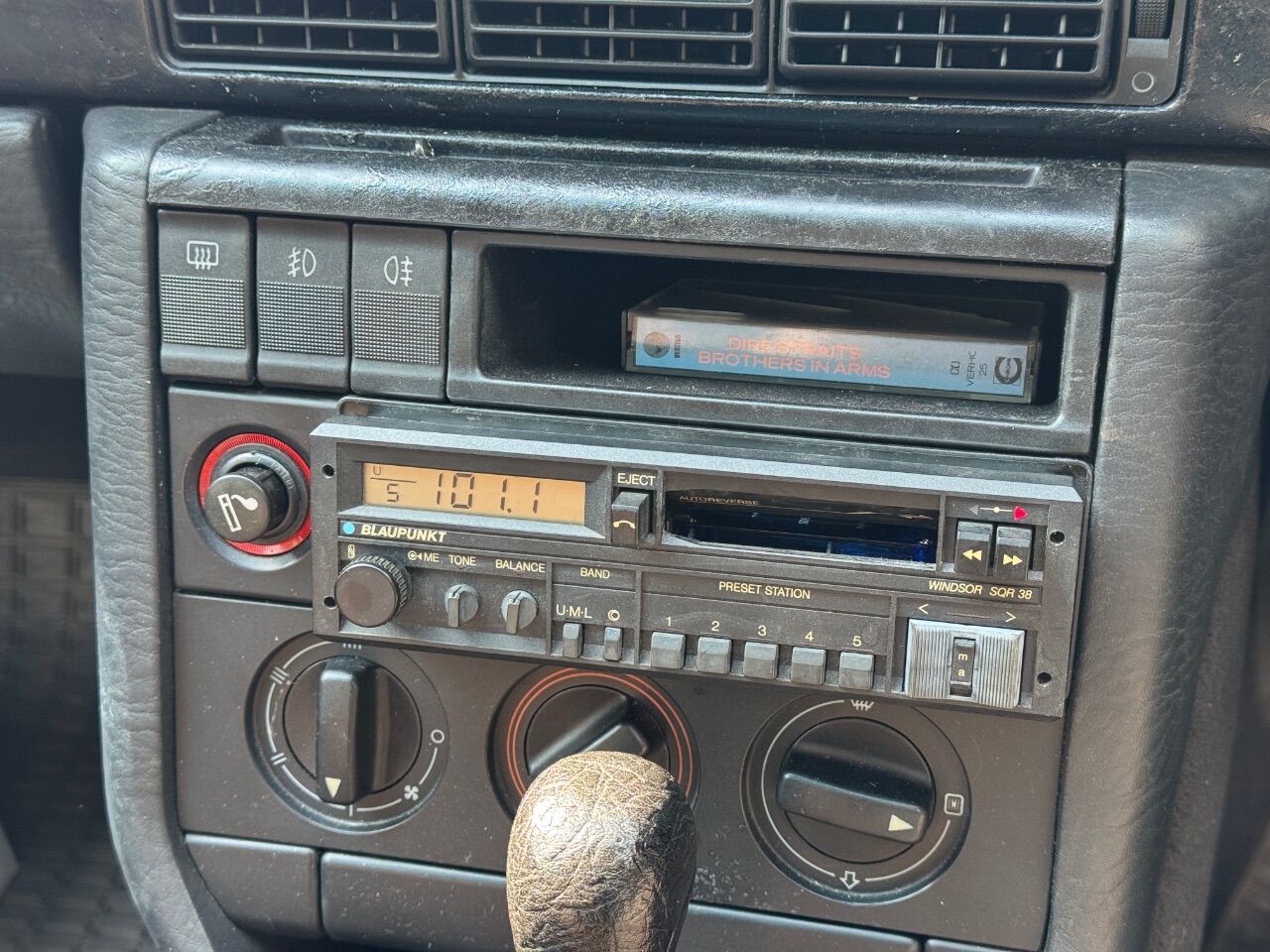

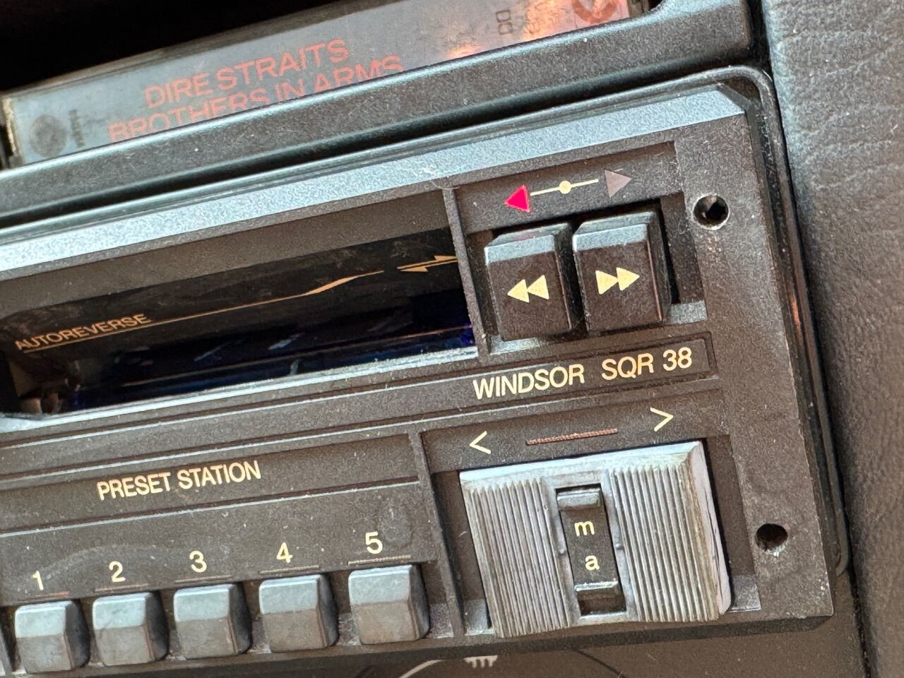

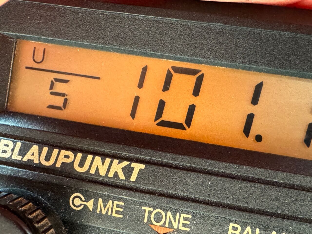

Well, I tried the Autocheck PCB I had spare. No rev counter, but no oil pressure warnings. However, the check display was showing things in the test that weren't applicable to this car - ECU, spinning wheel for traction, suspension lifting...
So I put the old one back. No errors.
Until I reconnected the radio. Then I got oil warning.
The radio wiring is, of course, screwy. But it seems unmessed with:
One connector has ground, 12V, illumination and remote switch (power antenna/amp/stuff) plus a white and blue wire. This is apparently the speed signal.
The speakers are speakers, albeit weirdly joined.
There is an extra connector for features this car probably didn't support like displaying radio data on the autocheck screen.

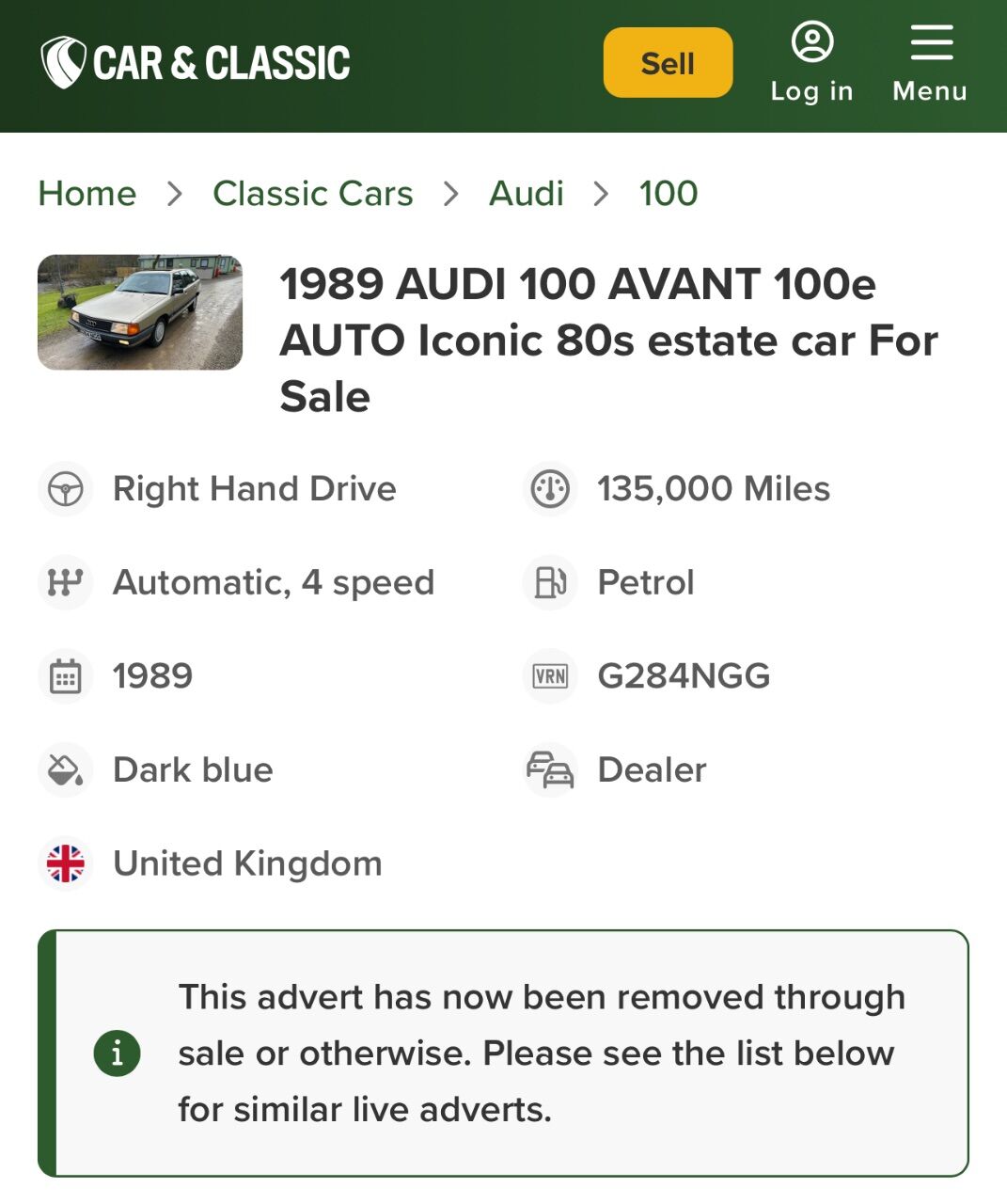

The Audi has not gone far in the past year..
Here is the Mathewsons listing - where it looks like a non-runner, and not MOTd, which might explain the sale price somewhat! The sunvisors were attached and the dashboard intact, though.
https://www.mathewsons.co.uk/auction/lot/604-1989-audi-100-avant-e-auto/?lot=37176
And then it appeared on Car & Classic
Can't see more pictures,  but it was also on eBay..:
Annoyingly the eBay listing has gone as well.

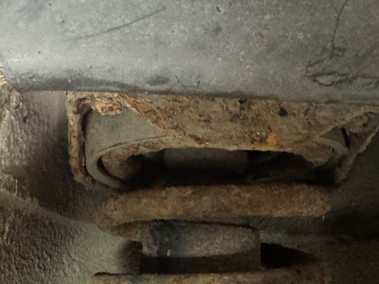

Audi parts I'm really hoping they will provide are the throttle cable and the rear spring perches:
They aren't too bad, but they are bolt on so I think if I get new ones and fit them now, perhaps with some new dampers and coils, it'll mean a few MOTs without issues.
New springs and dampers would make it look a lot nicer from an MOT tester's angle of view too.
These supports have rusted at the bottom, for the rear valence - the only bit of rust I've found that isn't a bolt-on piece. The plastic tub in the boot can be removed I think, leaving a nice working area to clean up and repair the rear valence underside and replace the supports while there's still lots of good metal.

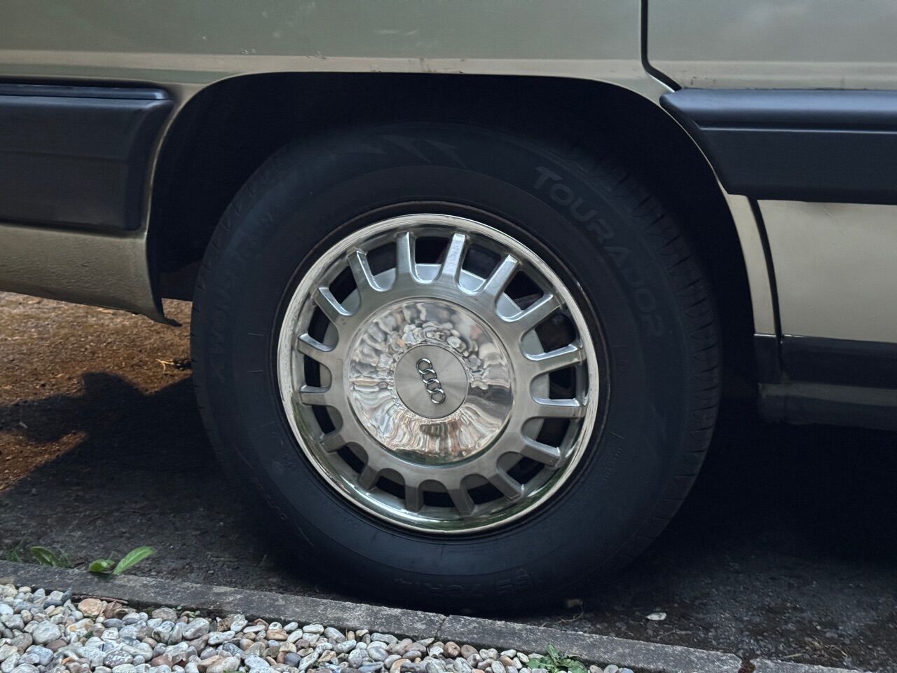

These are allegedly 14-inch wheel trims.
They do not fit my 14 inch wheels.
Shame, because they look great.
Anyone want a set of stainless steel Audi wheeltrims for £65 posted, polished and ready to fit wheels that are smaller than Audi C3 Typ 44 wheels?
Would trade for plastic 44601147 trims...

I was looking for non-plastic ones! A bit worried that like the C2 1979 stainless ones they won't actually fit though.
I have found a set of new plastic ones, but the price is not comfortable...

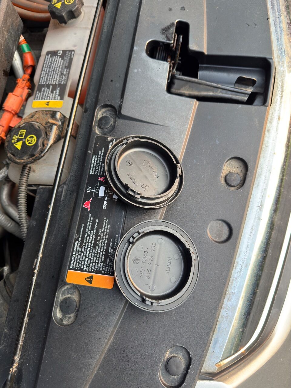

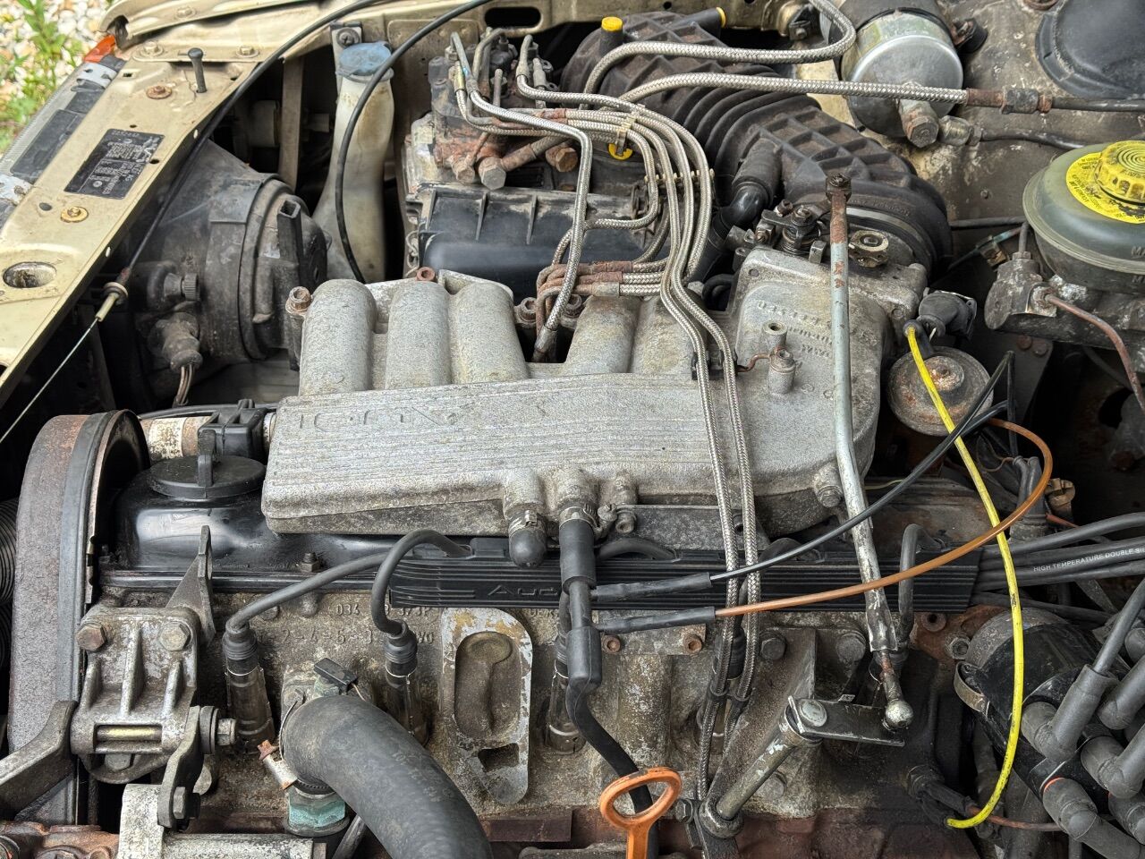

How it started (HT leads)
How it's going...
I always liked this detail on Audi 5-pots - there's an arrow on the plastic cover. It shows you how to slide it back to get to the cables. There's a clip behind that slides and releases the whole module.
Next up:
But first of all...

Do you know anyone (local shite?) with a car with "normal" 14" wheels and trims? Could be worth swapping over one to see whether the fitment is your wheels or the Audi trims.... I'm wondering there's any German metric weirdness going on with either party in the non-fitting debacle
Older trims are often only designed to fit certain wheels. I've had some that were literally only a couple of mm over/undersized and had to get different wheels to fit them. Unfortunately they weren't as universal as they are now in terms of steel wheel inner lip sizing, and often changed wheel suppliers.

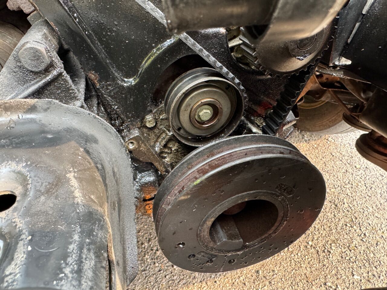

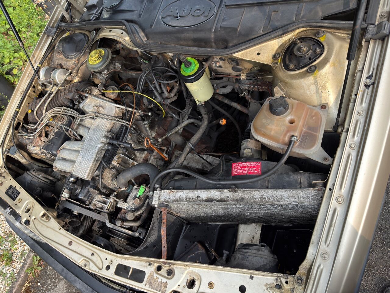

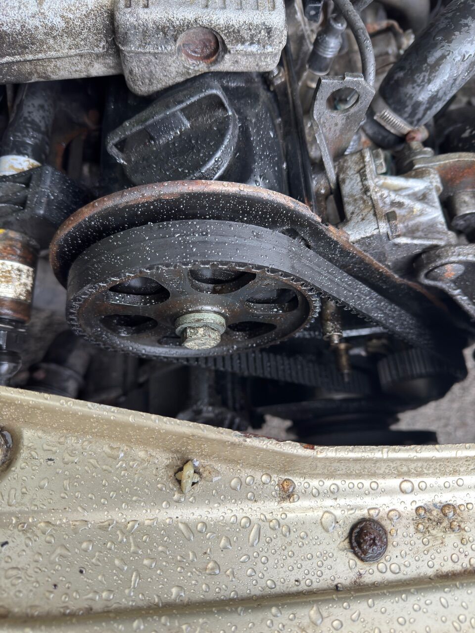

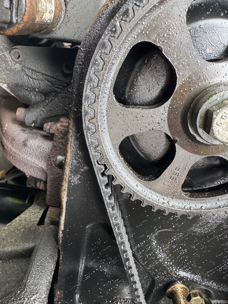

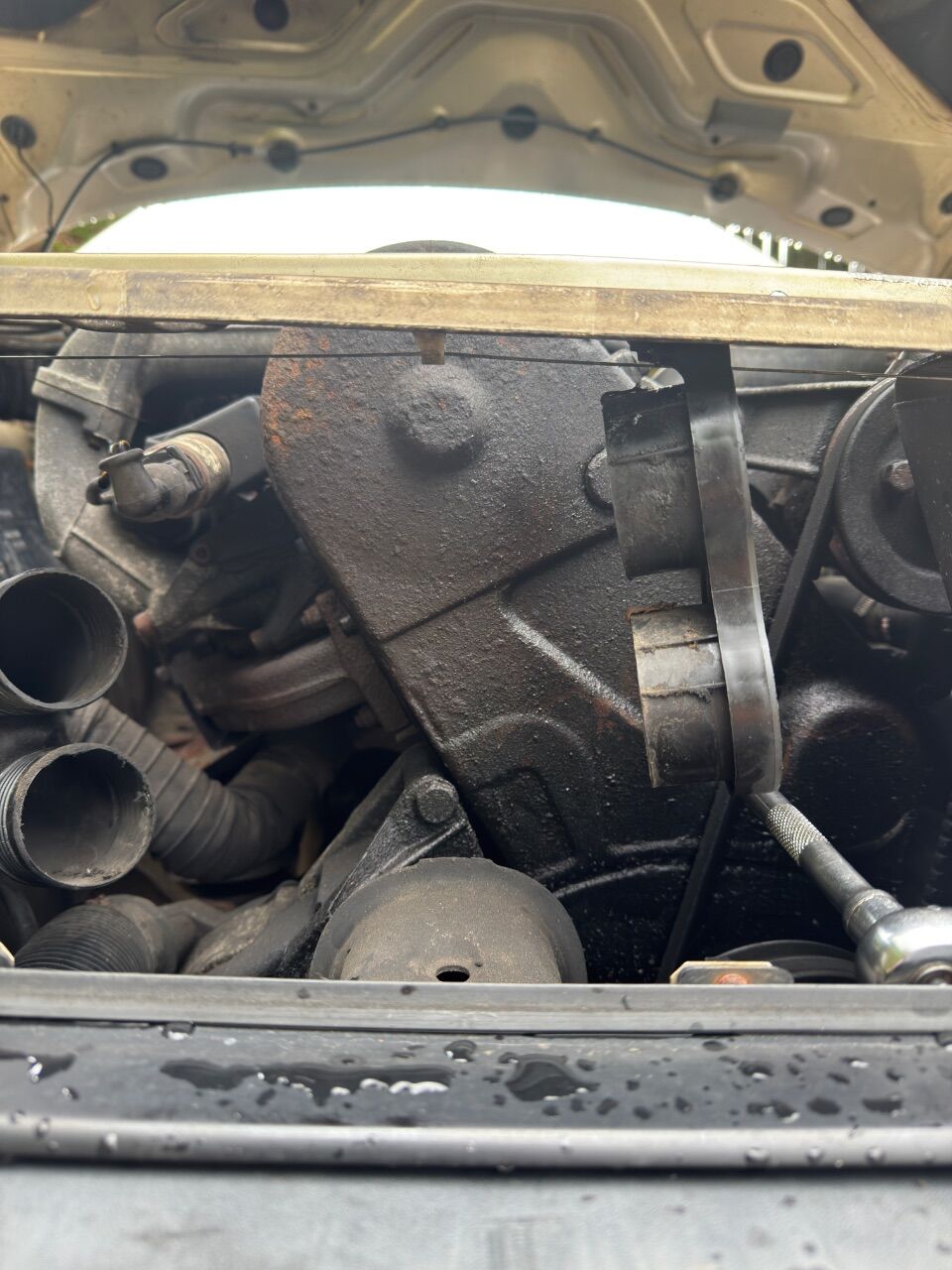

Belt looks alright. Not sure if that's a timing mark or abuse...
A bit of cleaning before waxoyl attack

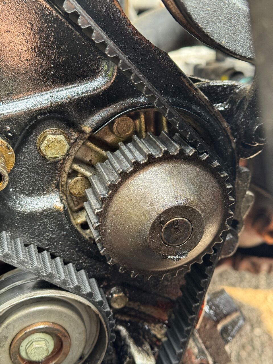

Lower cover off - hex cap screws had been chewed up and the lower timing cover is a bit bent, I've cleaned up the latter and will get some new titanium or stainless of the former...
Can feel a bit of play in the water pump even with the tensioned belt in place.
But... do I really need to take off the backing plate?
Annoyingly... it looks trapped behind this...
And speaking of trapped, even on this one the pulley has to come off to change the belt. Bloody Audi 😂
