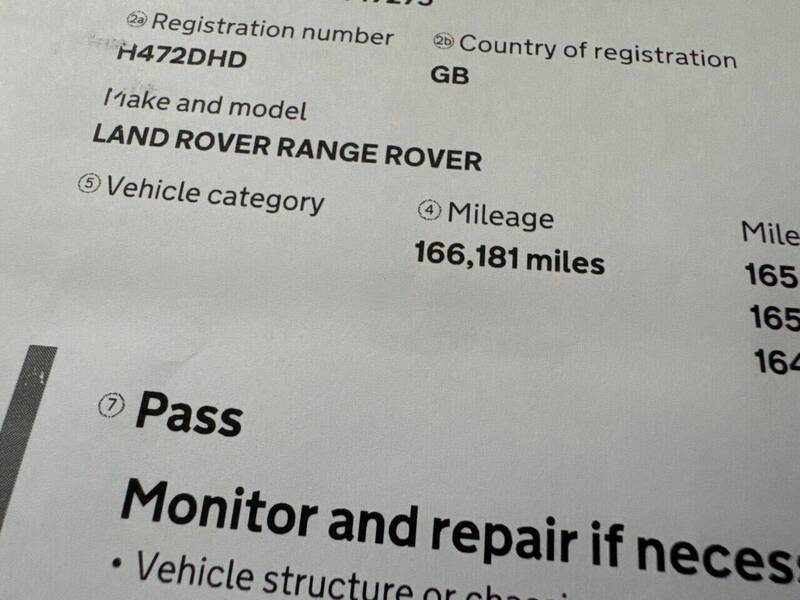

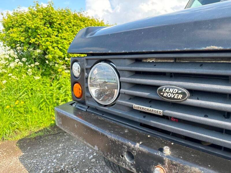

MOT time?
Over 1,000Nm right there.

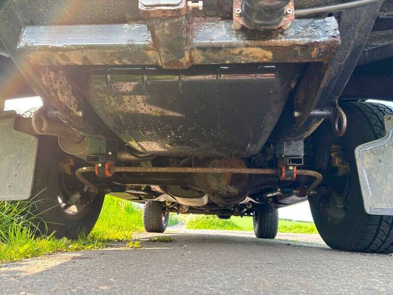

MOT fail!
Front mount under the headlight. The panel is manky but I am surprised it failed.
Let's see.
I think I'd need to weld new headlight pods on, which might then involve messing with inner wings.
Oh well.

I wouldn't be welding new pods in the RR. Strip down, clean up with wire brush on grinder, maybe a few easy welds if there's a way, then some good thick coats of paint and underseal. No more MoT grief. It's not structurally load bearing anyway, so doesn't need to be like the Forth Bridge.

Magic underseal MoT in a can over that front body mount?Β πŸ˜‰

Wire brush, rust converter, sit on the headlight and see if it wobbles, THEN the underseal in a can. I'm not a monster.
He just didn't like how much flaky visible rust there was, i think. Neither did I, I hadn't realised how bad it looked until I started cleaning the area up, I thought it was mud.
I need to fix the radiator - I think it's a standard one rather than anything fancy, but it's quite thick. Wondering about having it refurbished - new ones seem expensive, but I'm so used to "pay for a service in Britain, get something broken, or not very good, after a lot of hassle, the Β wish I'd just bought a new one". But it is only a pinhole so... how hard could it be to have it recored and pressure tested?
Bonus feature, it has remote gearbox cooler so no in-radiator coolers as far as I remember.
What the Range Rover really needs is someone skilled with metal fabrication to take a set of new inner wings and make some alterations to fit the modified chassis, suspension and engine layout. I can visualise it, but have zero skill - essentially a fluted part for the offside front body (not wing) mount, a box for the steering box which has swapped sides on the chassis, and new cutouts for the dampers. It doesn't, as far as I know, need the tall damper mounts at the front - it was running dual dampers for a while, but the terrafirma remote damper setup is ahead of the usual location and involves cutting a fair bit of inner wing away without that being done with a new flange to reinforce the edge.
It also needs new rebate/lip from bulkhead to inner wing - the bulkhead/floors are good, but that L-shaped strip is missing. And new wings would also give me the chance to consider the location of some other aspects of the layout.
