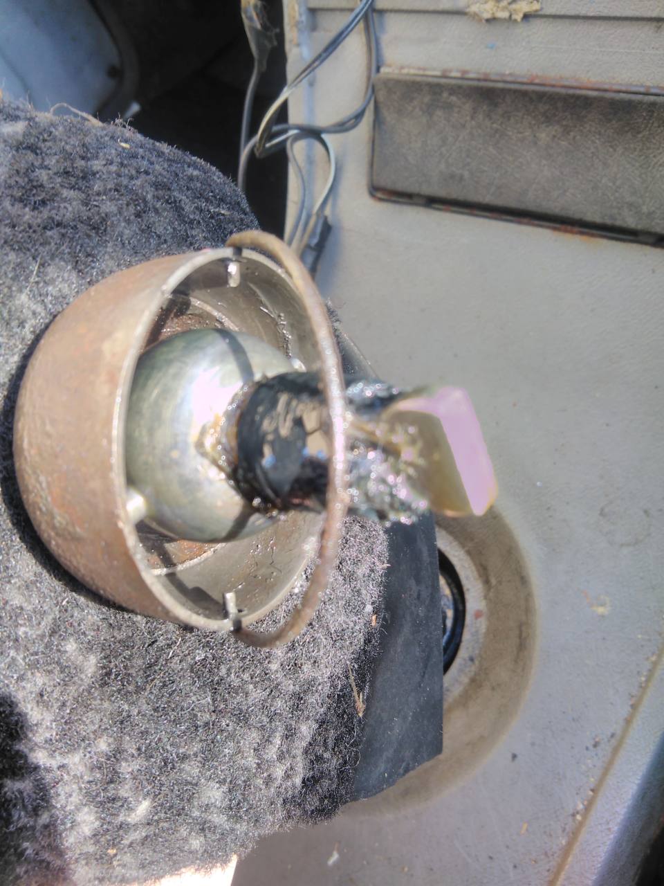

Mally Posted October 12, 2020 Posted October 12, 2020 13 hours ago, Custard said: I thought I'd start my own thread on this in case anyone has any interest in plastic pigs I bought this Rialto a few weeks ago because I wanted something cheap and small to be tinkering with. -Front indicator bulbs are soldered directly onto the wires, I assume its because the old bulb holders rotted away. -Clutch return spring has been replaced with a bungee cord -Engine access panel permanently sealed shut with silicone - -Gear lever falls off occasionally, which is actually hilarious tbf Sump is porous and I am afraid to touch it Still running a bit hot if anyone has any experience of these I'd be grateful to know about the brake feel. Doesn't roll over as much as people would have you believe, I did get it up on two wheels when I was flicking it side to side Bulbs soldered to wires. I used to do that! perfect solution. Needs new holders really with good earth connection. Bungee on clutch. Perfect. Engine panel siliconed in.. Not ideal, but cuts down on noise and fumes drastically. Gear lever, are these not secured with a wire spring? Horse shoe sort of thing? Never had a problem and we were crashing them. There's 2 small holes either side iirc, the wire clip passes through the ball cover into the ally. Sump, Must have no oil leaks, sump rusts through, I've had one. You need to change the pan, easy enough from underneath. Shouldn't run hot with ally rad. Anything obstructing airflow? Faulty gauge or thermostat maybe. Brake feel, mine were always good, Short travel, hard pedal worked well. Roll, Yes they will, have seen it done on a main road with 4 adults in, slid a long way. Avoid sudden movement of steering wheel. Great fun. theshadow, DVee8, BlankFrank and 1 other 4

Custard Posted October 12, 2020 Author Posted October 12, 2020 8 minutes ago, Mally said: Bulbs soldered to wires. I used to do that! perfect solution. Needs new holders really with good earth connection. Bungee on clutch. Perfect. Engine panel siliconed in.. Not ideal, but cuts down on noise and fumes drastically. Gear lever, are these not secured with a wire spring? Horse shoe sort of thing? Never had a problem and we were crashing them. There's 2 small holes either side iirc, the wire clip passes through the ball cover into the ally. Sump, Must have no oil leaks, sump rusts through, I've had one. You need to change the pan, easy enough from underneath. Shouldn't run hot with ally rad. Anything obstructing airflow? Faulty gauge or thermostat maybe. Brake feel, mine were always good, Short travel, hard pedal worked well. Roll, Yes they will, have seen it done on a main road with 4 adults in, slid a long way. Avoid sudden movement of steering wheel. Great fun. I think it may not be the original gear lever. Pattern on the knob doesn't match, reverse is on the opposite side. Thanks for the link to the sump, I think it's a priority job, so I might just grab what I can even if it's a tad expensive Temperature issues seem to be dealt with. I'm sitting in it idling right now and the gauge has barely gone over half way. Cleared some crap out of the grill and topped up the coolant a bit Craig the Princess 1

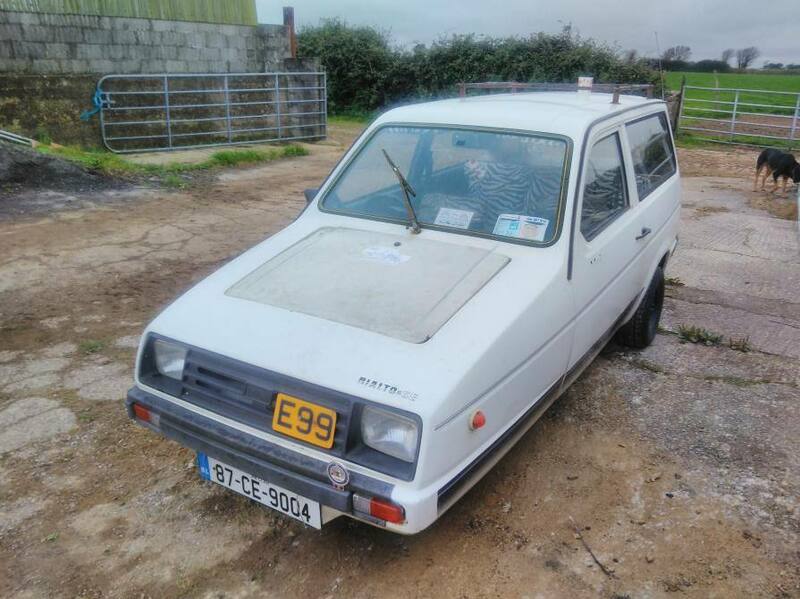

Mally Posted October 12, 2020 Posted October 12, 2020 That's try fitting the spring clip on it's own. Whats the yellow E99 plate? That will stop airflow.
Custard Posted October 12, 2020 Author Posted October 12, 2020 Got it in and secured. Huge thanks mate. Could not for the life of me see how it went in until you told me about those two holes Edit: the E99 plate is part of the old UK reg. Previous owner kept it because it looked like 'egg' and he called the car the egg eddyramrod 1

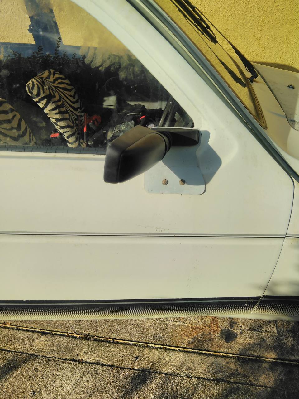

Custard Posted October 12, 2020 Author Posted October 12, 2020 Temporary wing mirror solution courtesy of my dad and some sheet metal. Shite Ron and LightBulbFun 2
