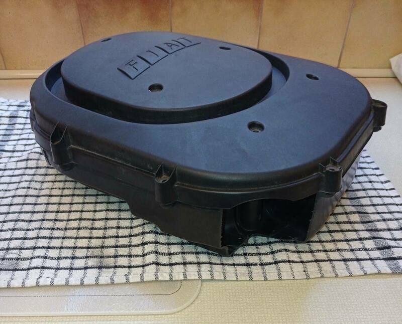

tooSavvy Posted October 7, 2021 Author Posted October 7, 2021 Looking Good π Installed height (thickness) of FIAT box is 100mm >> using bloo-tak + a screw, I pressed down to get the bonnet/ITB gap = 125mm π. rob88h, 500tops and privatewire 3
tooSavvy Posted October 7, 2021 Author Posted October 7, 2021 Further action...... I have cut off all the mounting bracket/webs from the base box. I have sliced a chunk out of the corner (where the inlet pipe neck would be) so that I clear the fixed EGR vac controller. When I reach the point of 'screwing it into position' I shall cobble up an enclosure to reseal the lopped off section of casing....Β re-attach the inlet pipe neck >> somewhere else... and look at reusing the FIAT snorkel π Β Jim Bell, rainagain, privatewire and 2 others 5

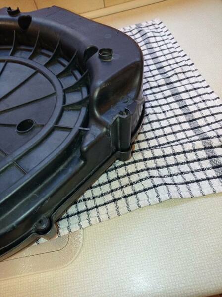

tooSavvy Posted October 14, 2021 Author Posted October 14, 2021 After..... Much FrettingΒ π€ I have lopped off the 'square end' of the air box >> now it more closely resembles a giant Do-Nut & should settle more easily into my existing engine compartmentΒ π rainagain, Mally and privatewire 3

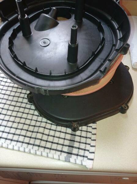

tooSavvy Posted October 20, 2021 Author Posted October 20, 2021 *Fork In Road* ..... FIAT box is simply too massive for space in engine bay ... PlanB I have popped for a much more conservative style enclosure [Allegro 1500 airbox] but with a twist.... As I'm keen to have as much 'open space' around the TB, I have done some Webbie mining and specced an A/F which is the correct thickness & outside dia BUT much thinner walled - making the insides much more roomy. Β£16, all in.... (No Jam π) *Still using the snorkel pipe from FIAT rainagain 1
tooSavvy Posted October 21, 2021 Author Posted October 21, 2021 My 'tin fryingpan' AllAggro air cleaner box has just arrived..... OooooF π
tooSavvy Posted October 23, 2021 Author Posted October 23, 2021 The FIAT 127 air cleaner inner has arrived... Ace! Now I can get this screwed together & installed....... 500tops, Jim Bell and privatewire 3

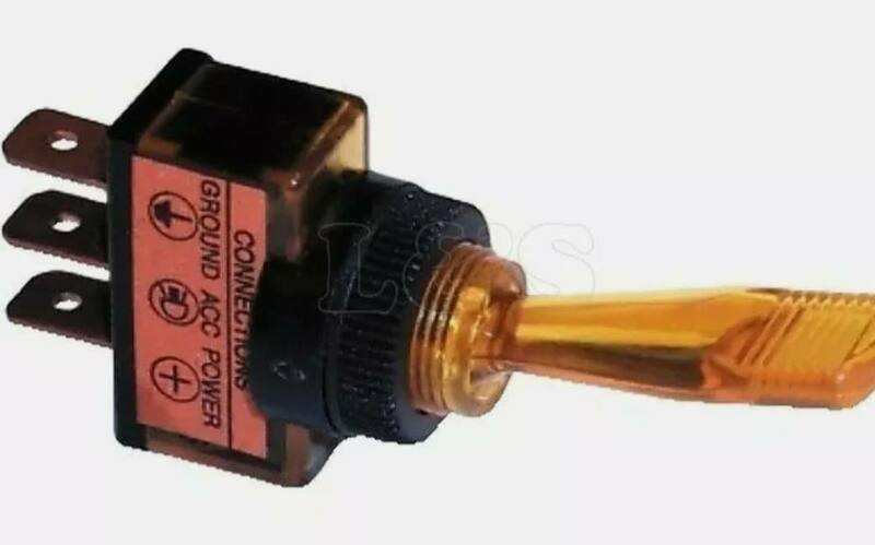

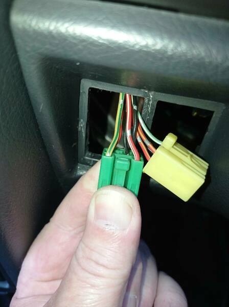

tooSavvy Posted November 8, 2021 Author Posted November 8, 2021 One *seasonal thing that buggs the fcuk out of me..... My HRW switch is iffy π± It is a pushhy inny/outty one, with a telltale - directly wired across the HRW output = no glow is NO DEFOG! Β£3 will see me sorted...... Β The factory switch is 'dash illuminated' but I'm tapping those wires off... To run the little lamp in my Oil Pressure Gauge β’when fitted π

tooSavvy Posted November 10, 2021 Author Posted November 10, 2021 HRW switch 'poingged' out.... Gutted and reconfigured to support 60's inspired SwitchToggle..... Β Β Photties tmozz, when it goes back in... Jim Bell and privatewire 2
tooSavvy Posted November 11, 2021 Author Posted November 11, 2021 All soldered up...... privatewire, Liggle and Mally 3
tooSavvy Posted November 11, 2021 Author Posted November 11, 2021 ..... Like the dash in a '70s 1100Β π privatewire, rainagain, paulplom and 2 others 5

tooSavvy Posted November 12, 2021 Author Posted November 12, 2021 As reported in 'giffer trinkets...' >> I have some DRL coming from China. My headlights are 'switched earth', so all the wiring is live all the time = fitting a 'lighting ON/DRL OFF' relay would be complicated. Having just rebuilt the HRW switch, which was 'dash illuminated'(when you put any lights on) AND the little lamps all go Direct To Earth π€..... We now know how to put a relay in [dashlights ON= DRL OFF]. Another problem blasted away...... π privatewire 1
