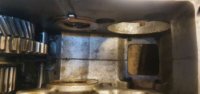

I've made a little more progress today, as I split the transfer box from the main 'box and stripped the gearbox down to the casing. To separate the two, you first have to pull the transfer box intermediate shaft out and remove the intermediate gears to access two of the fixing nuts. The shaft was fairly tight, and required a spot of heat before prying it out.
I cleaned up the bellhousing, as it looks like the engine real main seal was leaking into it. Once clean I replaced the layshaft front bearing...

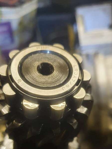

I realise that I have forgotten to fit the housing retaining studs, but I'm not happy with the input shaft bearing. The play seems just the same as the original bearing, but noisier! I've dribbled a bit of EP90 in there, but still sounds rough to me.

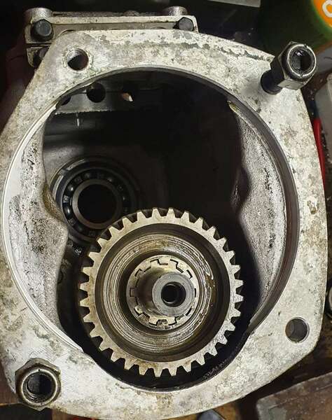

I've replaced the layshaft rear bearing and corresponding race in the gearbox housing:
Also the reverse gear gate springs (one had already broken).

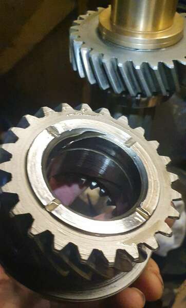

I've started to inspect bits for wear - all gears look really good:
The rebuild kit came with 1st and 2nd gear synchro rings, so I'll replace those anyway, but the 3rd and 4th synchromesh is all one assembly, and another £200 or so. So I was keen to see what that was like.

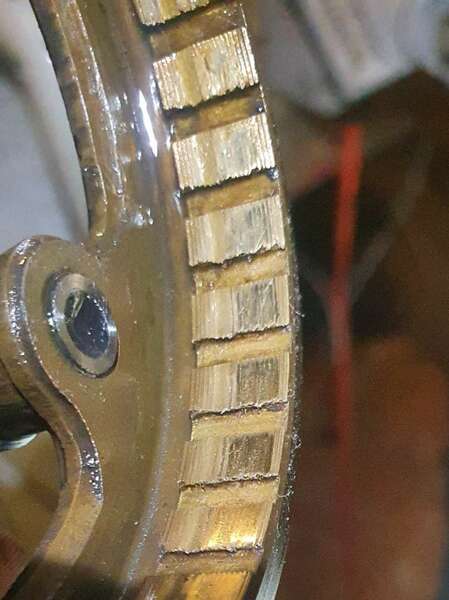

4th gear looks good...

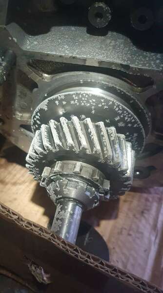

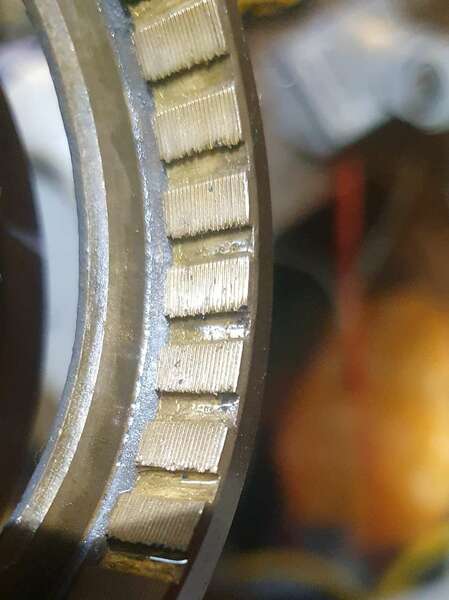

...but 3rd doesn't ☹️
That may explain why it was fairly easy to beat the synchromesh on changes to 3rd. Question is, am I expecting too much? It was perfectly drivable, just not driving perfectly.

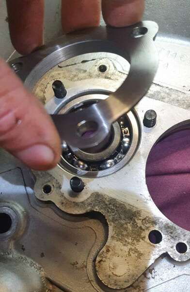

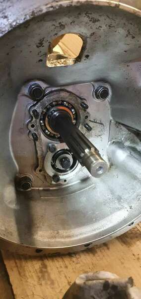

I've reached a bit of a delay anyway  as my circlip pliers aren't big enough to remove the rear mainshaft  bearing housing, plus the uncertainty over the input shaft bearing.
Can you make a valid assesment like that though, there is a twist applied to that ballrace with just the input shaft in place?  What about trying it with the output shaft and that needle roller bearing that goes between input and output shaft in place, ie with the shafts properly supported?
2 hours ago, Asimo said:
Can you make a valid assesment like that though?
Good question - I just don't know. I don't know what clearance the bearing is designed to have so may well be acceptable.
It's more the fact that it doesn't feel as smooth as the layshaft bearing beneath it. I actually have to temporarily attach the layshaft to it, to check for end float so I can do a similar video.
After a bit of research I've established that there is a fair amount of clearance by design in this bearing, which probably means the original was reasonably OK. This video shows a similar level of float, which backs up what I've read elsewhere.

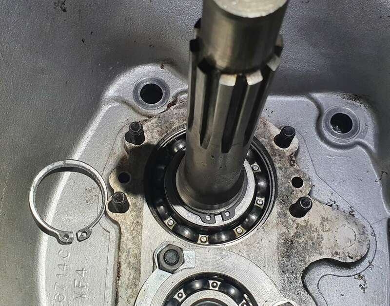

The only slight question mark is over why the new bearing is noisier than the old, when rotated by hand. I think I'll make an assessment when it's bolted back together.

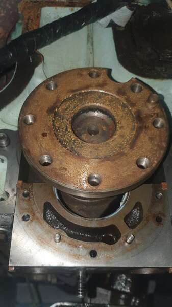

So, only to the mainshaft rear bearing. This is in a separate housing, which is held in by Loctite, and a circlip. With the aid of heat, the housing was removed and cleared up ready for the new bearing.
Bearing in and secured.
I then needed to warm up the gearbox housing, to push the bearing housing back in.
Again, this is loctited in, partly to prevent oil leakage.
Bearing housing in place, and circlip securing it.
The seal is a metal cased type, which I've known to seep oil between seal and housing, so I've used a thin smear of sealant to help prevent this.

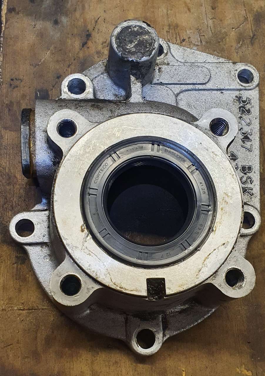

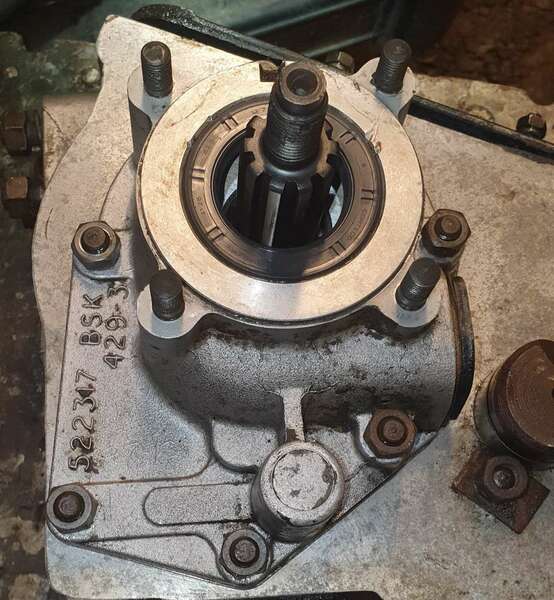

I had a small package of parts arrive, so set about changing the rear output seal. Greased it up to help it slide in.
Then used a 52mm socket, bolt and piece of plywood to draw it into place.
This done I could fit it to the back of the transfer box - first are the shims to preload the output shaft bearings, massive taper roller jobs.
Then the housing can go on.

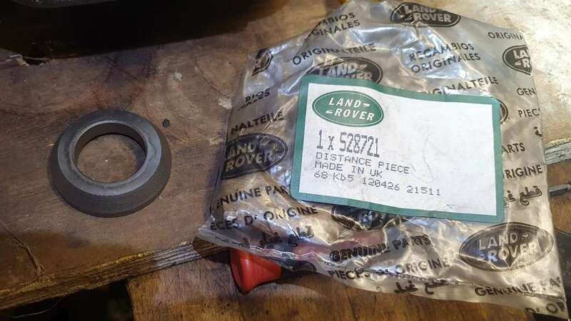

Another arrival was the layshaft distance piece, next to the old one which wasn't thick enough with the new bearing.

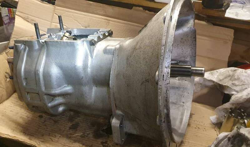

I temporarily refitted the layshaft into the gearbox...
...and attached the bellhousing. The idea is that there should be minimal end float of the layshaft, but more than none. If there is zero movement, it means the rear layshaft roller bearing has bound up. You can't check this with the mainshaft in place, hence the temporary partial reassembly.

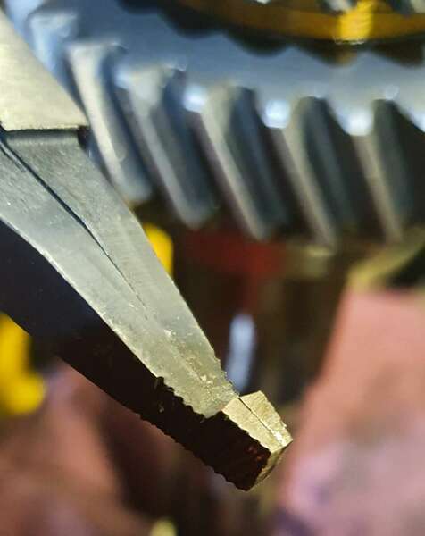

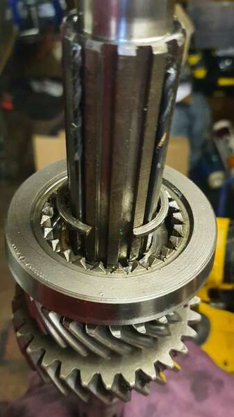

Next step is the mainshaft, specifically the bastard lockring,  tucked down below 3rd gear synchro.
I bought some flat lockring pliers, and modified them to fit in the gap.
Now although they would fit, they wouldn't open wide enough to get the ring out of the grooves. So I managed to tease it open a little with a screwdriver, and hold it open with drill bits down the splines.
And it's off, finally!

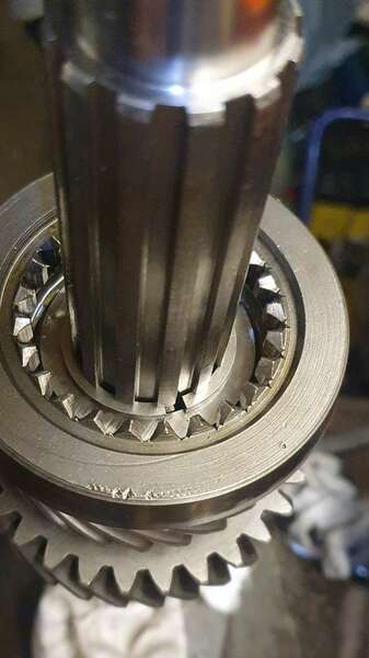

Notice that this has obviously been apart before, and clamped in a vice :-( It's not damaged the friction surface, but still...

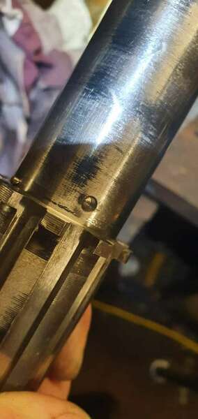

With the gears removed, this is the bush which supports them. It often breaks up and/or shears off the pin locking it to the shaft, but the only problem in my case is some light wear.
Now comes the fettling of the new bush. It's put into place with 2nd and 3rd gears, and weighted down with some old bearings (using the old bush as a spacer) so I can check the clearance.
Spec. is 4 to 7 thou, and I'm measuring between 5 and 6. I could assemble as is, but I'd prefer to get it as tight as possible. So I'll take the new bush out and remove a bit of material until it's at the lower end.
I measured the length of the new bush, then gave it a light rub with 240 grit wet and dry on a flat surface. I did this in a figure of 8 pattern, to try and avoid putting any tilt into it. After only 3 passes it was down to size, so the next stage was to check the end float between bush and thrust washer (you'll have to imagine the snap ring holding down the thrust washer in this photo!)
Spec for this is 1 to 8 thou, and I'm measuring 10. If I'd left the bush as-is, it'd have been (just about) OK, but right at the limit of acceptability. To reduce this down you have to change the upper and lower thrust washers, which are available in a range of thicknesses for selective assembly.
So I'm waiting for these to arrive, but what has arrived is a new 3rd/4th gear synchro assembly. This is quite pricy from Land Rover suppliers, so I did a bit of research and found that it was also fitted to Rover P4 gearboxes, under a now superceded part number. It turned out that JR Wadhams had a few of these as new old stock parts rather than modern reproductions (which may be perfectly OK, I've certainly not read of problems with them). But these were half the typical price of those listed under the LR part number, and don't come in a blue box :-)

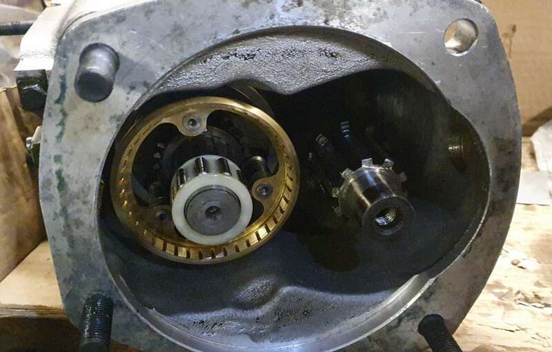

Switching to the transfer box now - I've got the rebuild kit for it, but struggled to find anyone listing it with the intermediate gear thrust washers...apparently stocks are exhausted.
https://www.onlinegearboxparts.com/product/series-3-lt76-overhaul-kit-transfer-box-minus-2-x-thrust-washers/
https://www.glfclassics.co.uk/ourshop/prod_7074185-LT76-Transfer-Box-Full-Rebuild-Kit-1965.html
https://www.shop4autoparts.net/parts/gearbox/lt76tbk-overhaul-kit-lt76-transfer-box/
This was a potential problem, as mine looked noticeably worn.
Closer inspection, and you can see a step in them.
The only option I found was some stupidly expensive (for what they are) NOS parts, so bit the bullet. I did consider getting some machined up, but they're not bronze all the way through, being steel-backed so not a simple job. When they arrived I realised that my originals weren't quite as bad as I thought, as there is a slight step by design. I could have probably taken out the excess float with shims, but hey ho.
These sit either side of the transfer case...
...and support the intermediate gear, here temporarily refitted to check for clearance.
Note that I've (deliberately) fitted it the wrong way round, as I wanted to be able to spin it to check smoothness, without it meshing with the output shaft gears. I have to remove it anyway to reattach the main gearbox, as a few of the nuts are obscured by it.

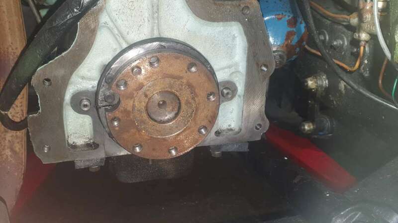

This was all good, so next I took a look at the engine oil leak. Clutch and flywheel off, and yes, that's pretty conclusive!
The clutch is fairly worn too, so the shopping list is growing :-(
I understand how you feel. So the engine is out, and the bearings are checked, so, does the crankshaft need a regrind, or at least a polish? Do you pull the head off and give it a decoke? Do you pull the pistons out to check for wear? What about the camshaft? Just where do you stop?
I'm hopeful, seeing as the engine ran quietly and smoothly, that any wear will be minimal. If you catch things in time, and it's been well looked after (and all the signs are that it has), you're less likely to have damaged the crank.
If something's been worn out for ages, chances are that some of the wear particles will embed themselves into the bearing shells and score the crank.
Barring accidents 2286cc Land Rover petrol engines tend to keep working indefinitely. They happily tolerate sporadic oil changes. I don't think I'd bother rebuilding the engine unless it was clearly on the way out. That's good going wearing a clutch plate out though, didn't think that was possible on these. Mine was last changed in about 1975, and inspected in about 1995 when I took the gearbox off to change a clutch linkage pin (when no apparent wear was detectable).
I certainly hope it doesn't need work, but we'll find out when I take a bearing cap off! It'd be daft not to replace the shells unless they are unworn.
Off with the flywheel housing, sump, seal retainers and main bearing cap.
Everything is looking very clean, so a good sign. But how is the bearing?
I'll happily take that! So it looks like it's just the 'simple' job of seal replacement. But look what arrived (makes sign of the cross...)

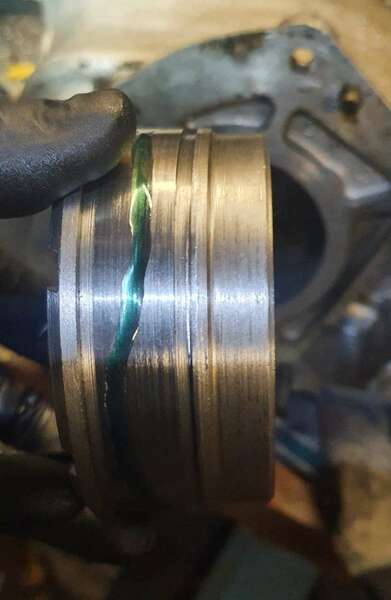

The seal is a weird design with a split in it to fit around the crank...
...and a spring you have to link, and tuck behind the lip. Plus the T-shaped seals which slot into the bearing cap.

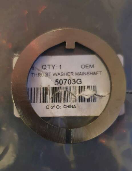

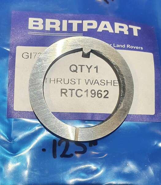

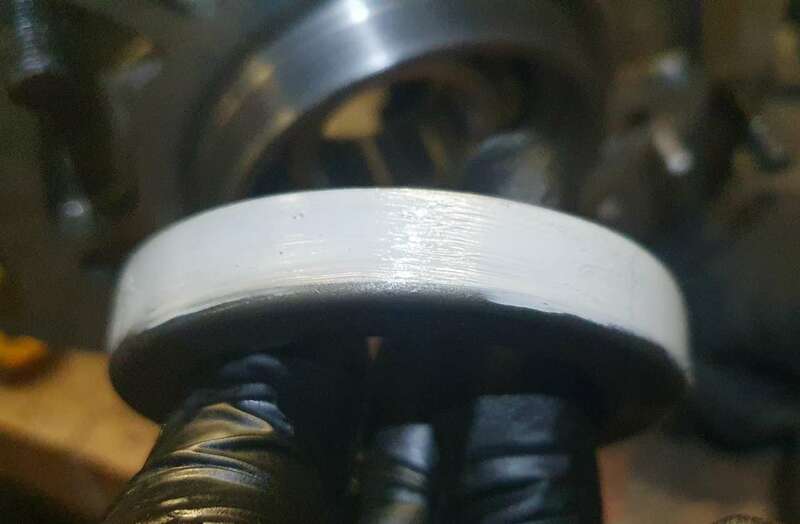

Back to the main gearbox, and I've been playing around with thrust washer thicknesses trying to get the end float down on the 2nd/3rd gear bush. My first problem was this pin, which stops the bush from rotating, but has to be removed to swap the thrust washer.
It's loctited in, so I tried as much heat as I dared without compromising the heat treatment of the mainshaft, but no joy. All I did was mangle the end of the pin to make pulling it impossible! So I ground it flush, and attempted the time-honoured method of drilling it exactly in the centre just off-centre enough so it buggers up the shaft as well.
Oooh, this might just work!
And it did 8-)
I'd previously calculated the correct washer thickness based on the original float, but when they arrived and were fitted the bush had zero float.
I then realised that there was a miniscule wear groove on the original washers, so what I really needed to do was add the thickness require to the worn surface, not the actual washer thickness. This is difficult to measure with home tools, so I've just bought all the available thicknesses, and will send back the ones I don't need. Dingocroft have been really helpful with this, and were happy to take back parts.

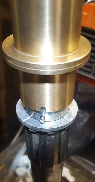

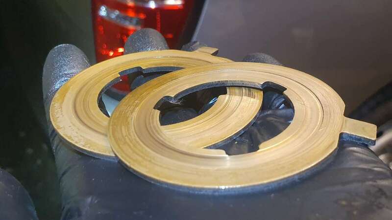

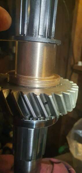

In this next thrilling installment there is actual progress! Not a massive amount, but better than nothing. My selection of thrust washers arrived, and a mixture of brands. OEM...
...and not OEM.
The washers sit either end of the bronze 2nd/3rd gear bush, and limit the float to between 1 and 7 thou. Mine was at 10 with the original washers, so some assembling, measuring and reassembly later I'd got it so it was tight on a 1.5 thou feeler gauge (the thinnest I have). Happily that was with a 0.128" washer each side, so will be as central as possible. That'll do! So I could then loctite in the bush locking pin.
The bush slides over this like so:
This was just a trial fit to make sure the pin was below flush. It was, so the 2nd gear could be fitted after making sure the oilways were clear, and oiling it up.
Same for 3rd gear.
With that done, the second thrust washer sits on too, all held together by the bastard snap ring. With a new one, the gap is next to nothing so I had to improvise to get it on.
And in place! Note the fan heater to stop my hands freezing to the shaft, ad it's been sub-zero all day here.
A quick check of the float again, and I could flip the mainshaft over and assemble the other, easier side.

No choice now! But in the event wasn't as bad to reassemble as the description suggested. Once back together, I built up the mainshaft again, taped the synchro hub together and repeated the process. Followed by wriggling the layshaft into position, and installing the new 3rd/4th gear synchro assembly.
This done, the bellhousing could be attached.
Everything seem to turn nice and smoothly, so next job is to fit the selector forks and mechanism, and check whether all gears engage correctly...
That's my fix of proper engineering voyeurism for the week!
Keep up the good work
The first difficult task tonight was actually getting into my workshop, as the padlock had completely frozen solid! To make matters worse, both my blowtorches, my oxy acetylene kit and my hot air gun were the wrong side of the door. After struggling for a while to even get the key in, I resorted to thawing it out with a 'warm fluid' straight from the tap.
Once inside I began the task of engaging the selector forks inside the gearbox, and attaching to the selector rods. This took a surprising length of time which I'm going to blame partly on inexperience, and partly on numb fingers!
I then tried to select gears by moving the relevant rods. 1st, 2nd and reverse all slipped into place quite easily, but worryingly I couldn't engage 3rd or 4th at all. I had to temporarily attach the gear lever, and even then it took some effort to move.
I'm hoping that's just down to a new synchro assembly, and will loosen off in use. It seemed just to be the initial start of movement when resistance was felt, and the actual engagement felt pretty positive. Plus this is with a dry box apart from the assembly oiling, so once full of EP90 it should be easier.

I did those gearboxes a long time ago.  It is only when looking at your parts, it comes back to me.
Even back then, the Original Parts were hard to come by, and spendy. I had the overdrives as well.  Enjoy your truck, they are  great fun!
This week has been crazily busy, but yesterday I got an hour or so to work on the gearbox. By selecting 1st and reverse at the same time, I could lock the shafts and tighten the layshaft bolt (also loctited in). Also bent over the tabs securing the layshaft bearing carrier.
Then I could install the cover plate. I'm not usually a fan of gasket sealants - I generally prefer a light smear of grease on the gasket - but in this case given the hassle a leak would cause, used a sealant instead. It came in a handy 'pen' applicator, so easy to only apply a thin layer.
In place inside the bellhousing...
...and one more job ticked off.

Crank seal - that is officially a nightmare job! The recommended way of doing it is to fit the top seal retainer to the engine with crank out, fit the seal to the crank, then lower the crankshaft into the engine. Googling it seemed to give the consensus that it was a fiddly enough job with the engine out, let alone laying on your back doing it from below. And one chap who replaced it twice  and it still leaked. He didn't post back up with a happy ending, which didn't fill me full of confidence!
So, what does the job entail? First of all the slightly awkward job of looping the spring around the crank, and joining the ends without stretching the spring too much.
OK, that wasn't too bad. Next, open up the seal and fit over the crank, making sure the split is at the top (more on that later).
Then, tease the spring into the groove of the seal, keeping the join at 90 degrees to the split in the seal. Again, fiddly but doable.
The worst part is fitting the seal retainers (which give the seal its shape) and keeping the seal square to the crank. The difficulty is attaching the top retainer to the block, as to insert the fixing screws you need to rotate the crank. And if you rotate the crank, the upper bearing shell can spin. I settled for loosely locating the upper retainer on its dowels, and bringing up the lower retainer to meet it, attached to the  bearing cap.
But first I needed to fit the T seals to the cap.
Then make up some plastic guide pieces, to stop the cork seals being damaged sliding into the block recess.
These have a slight taper to compress the seals as the cap moves upwards.
Part way in, and I can fit the lower retainer. Gradually tapping the bearing cap upwards, checking with a mirror that I haven't trapped the crank seal.
Eventually the cap was in place, and I could fit the seal retainer screws. I rotated the crank so that the cut-out was in line with the screw holes - and the seal promptly span inside the retainer :-(
All apart again, and repeat. This time keeping the seal retainers tight to the block, and once the bearing cap was in place, I tightened up the lower retainer and secured the seal before rotating the crank.
The sump is now on, and I still have a bit of reassembly to do before I can start the engine and find out whether I've been successful. If it leaks I think I will cry!
