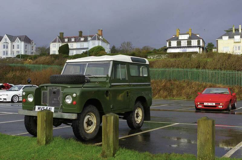

The oldest Land-Rover Series 3 around - new boots arrived
An unexpected benefit I noticed this afternoon - when pulling out of our driveway to turn right we join the NSL A-road at quite an angle, like a motorway sliproad but reversed direction so that the passenger side is entering the road first. This is a nightmare in a panel van with restricted visibility, and still not great in a car as traffic approaching from the left is coming downhill. The new windows make it easier to see the traffic which is above your level, without having to move your head to peer out.
EDIT - found this old video when we were returning home once, to give you an idea of the junction. (Always do a shoulder check!!!)

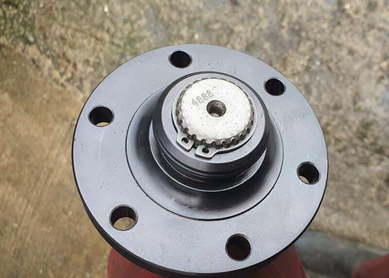

Today's first job was putting in the diff. Easy task, although noticeably heavier than the old one (or I'm getting weaker!) The next thing was the driveshafts. These are apparently a bit of a weak point on Series LRs, and the new ATB only comes in the later 24 spline pattern, not the Series 10 spline type. So new halfshafts needed.
These are a constant diameter rather than necking down after the splined part, plus are made from a pretty high grade of alloy steel (I remember it from my heat treatment days). You can also see a bit of spline wear on the old shafts.
The new shafts also need matching hub flanges, which were pretty cheap...
...and easy to slide into place.
So, what difference has it made? Firstly the rumble on the overrun has gone, as so has a lot of the drivetrain slop. I think that a combination of the pinion and crown wheel clearance, and spline wear was to blame.
And the ATB? Well, a standard 2 and a quarter is going to struggle to leave two black lines on tarmac, so I had to settle for leaving two brown lines on a wet grassy hill!
This is just in 2WD, and I could previously barely get anywhere until engaging 4WD. No adverse effects noticed, it just drives like you're on a much grippier surface.

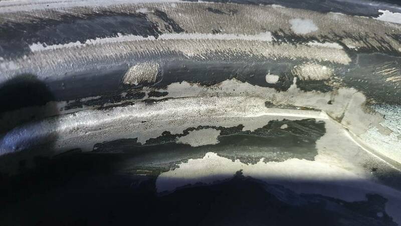

Tyres removed, and prior to wire brushing.
Rust has crept into the seam, so unable to mechanically remove. My plan is to dunk in Bilt Hamber Deox C, and allow to remove the rust over a day or two.
It works much faster when warm, but after 12 hours still has more to do. But looking a helluva lot better already!
After a little while longer it's all gone.
TBH, I was using it at the minimum strength of 1 kg to 20 water, so have ordered a bit more so I can do them faster. Still, it's not a bad result for little effort; all I did with the wire brush was to remove any flaking rust and paint.
I've now put a coat of galvanising primer on, and moved onto the next wheel.
