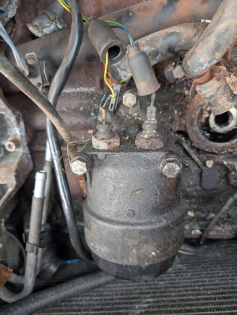

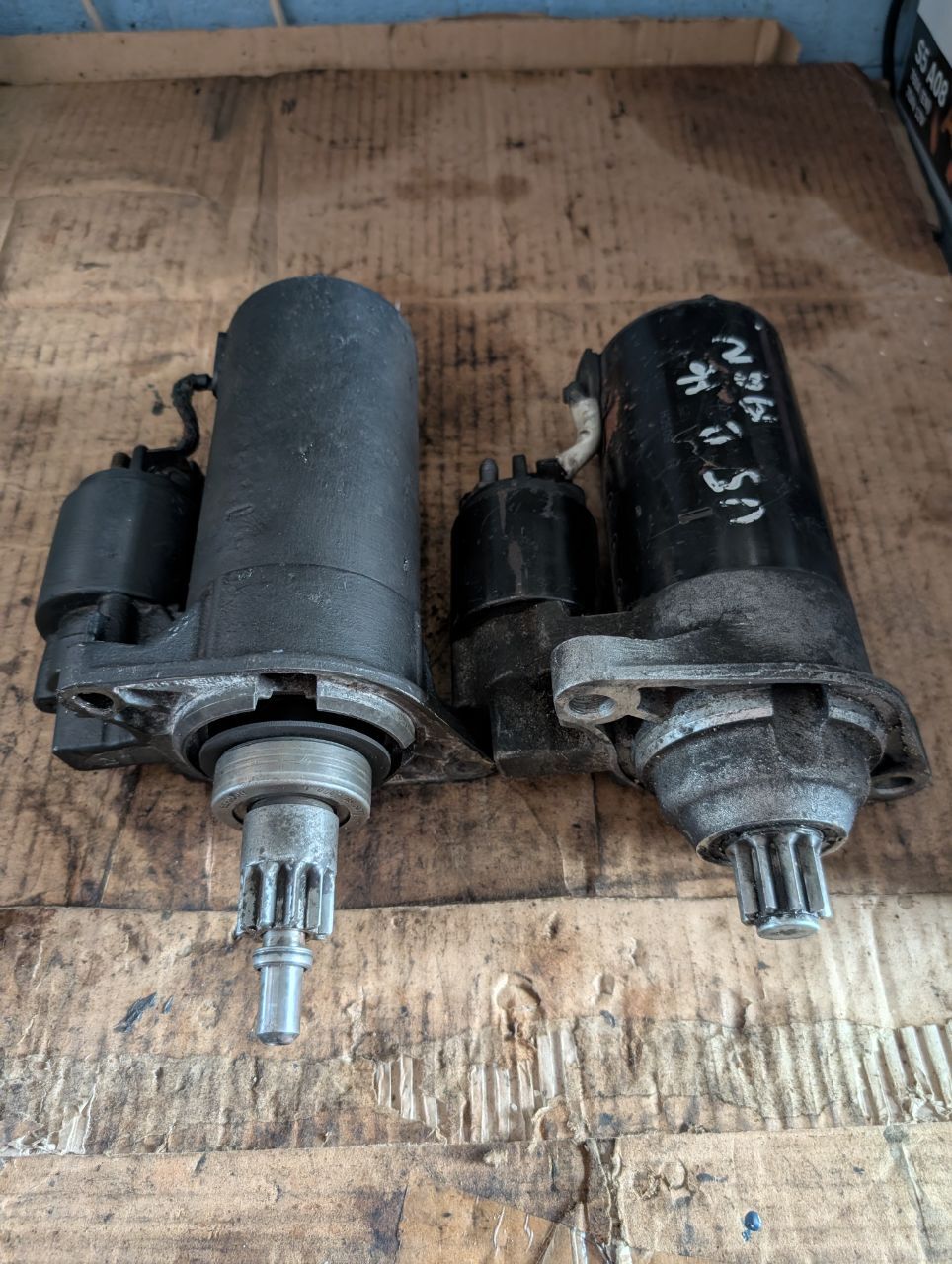

No photos today as I left my phone at home 😔 I fitted the starter motor and thought it would be a good idea to connect it to a battery with some jump leads and wind it over briefly as although I am fairly certain I have fitted the timing chains correctly I always have that lingering doubt lurking and I just wanted to make sure it sounded normal.
Anyway I am glad I decided to try as the original Corrado starter motor seems to have given up the ghost, it span but didn't engage so I took it off and freed off the Bendix but it still wasn't right so rather than faffing about further I have ordered a used MK4 Golf VR5 starter for £28 delivered which is apparently beefier than the original which will help with the higher compression ratio etc of the 3.2. It's also cheaper than a rebuild of the original or a brand new one so should hopefully be worth a punt.

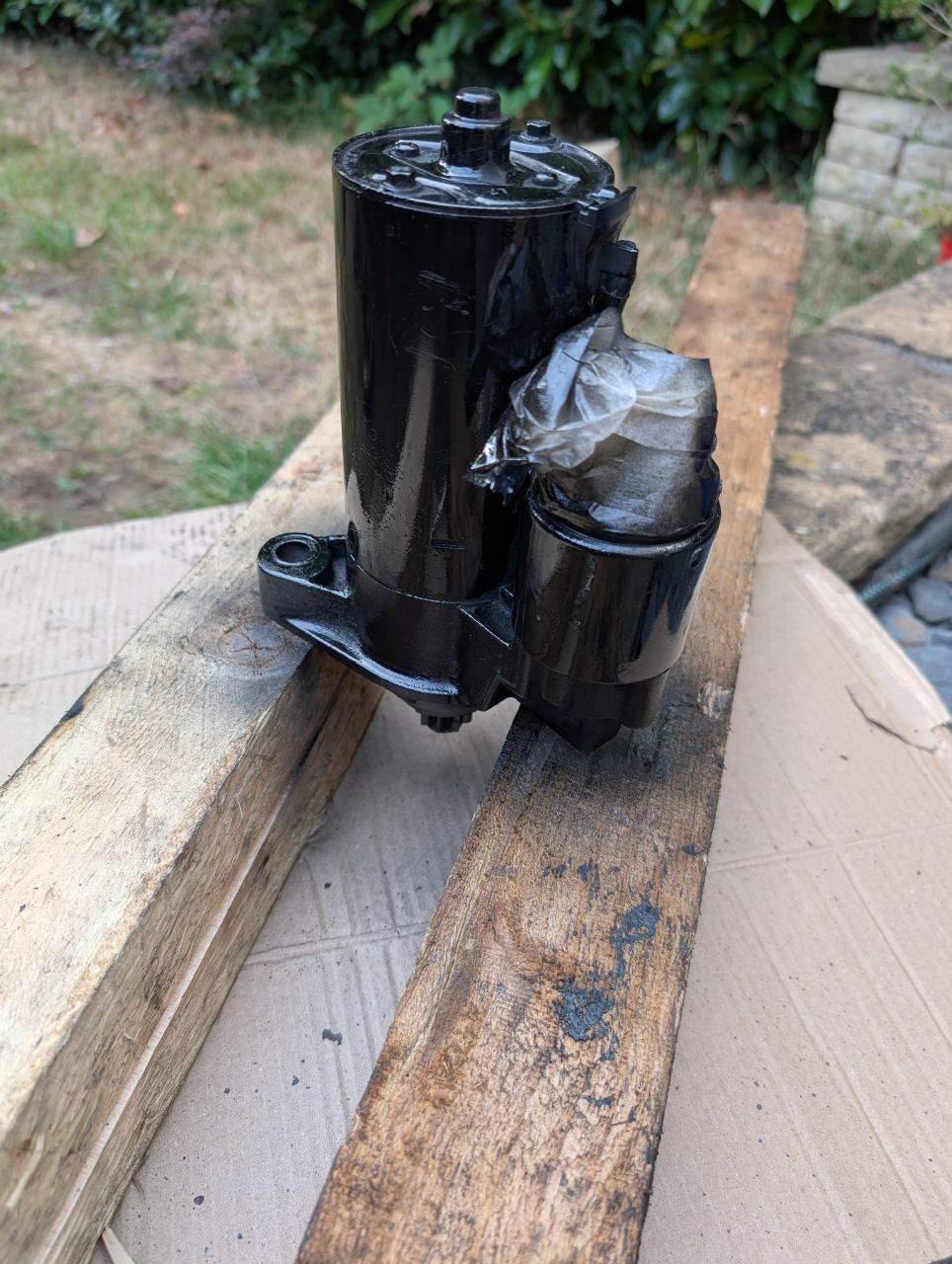

The new starter arrived, it's on the right. It worked fine and the solenoid is good too, it's even a bit lighter than the original which is nice but still had no problem turning over the engine and I am happy to report it made normal compression noises and no nasty sounds so it appears I did correctly fit the timing chains 😀
I am not exactly going for perfection in terms of presentation of the engine etc but I still couldn't put the new starter on with scrapyard writing all over it so I hit it with a quick coat of Poundland's finest black spray paint.

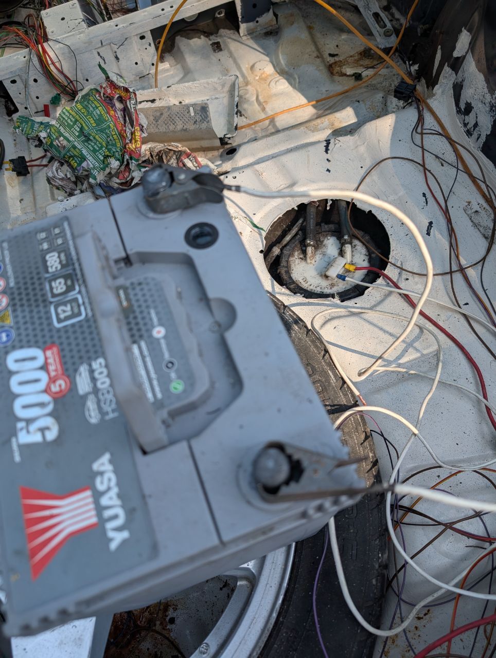

While the filter is off I am going to connect a battery directly to the fuel pump and pump out whatever stale fuel is still in the tank. I need to research if a stock 2.9 pump can flow enough fuel to support a 3.2. I do have the pump I removed from the TT and it's supposed to be a straight swap so I should probably just fit it to make sure.

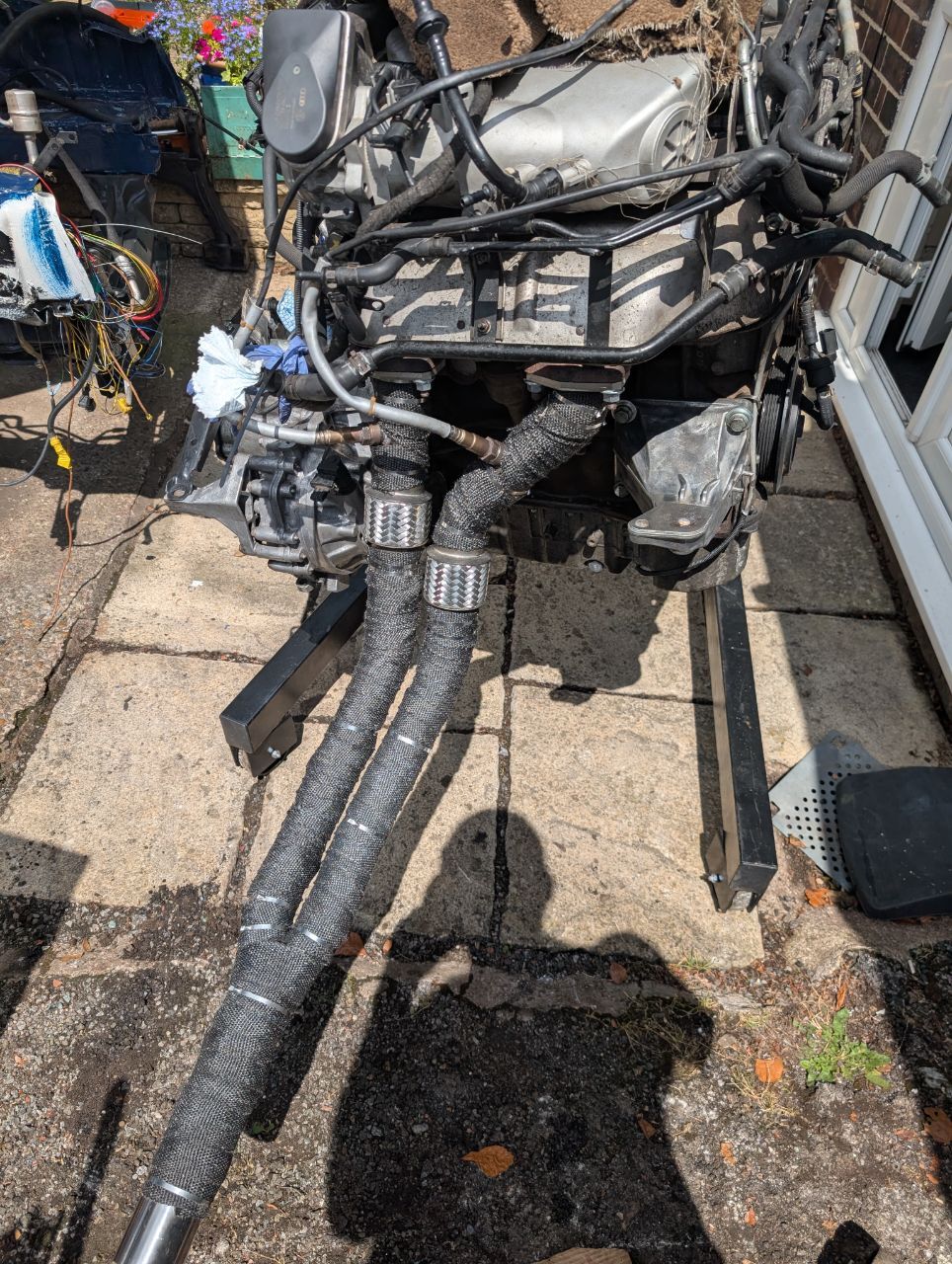

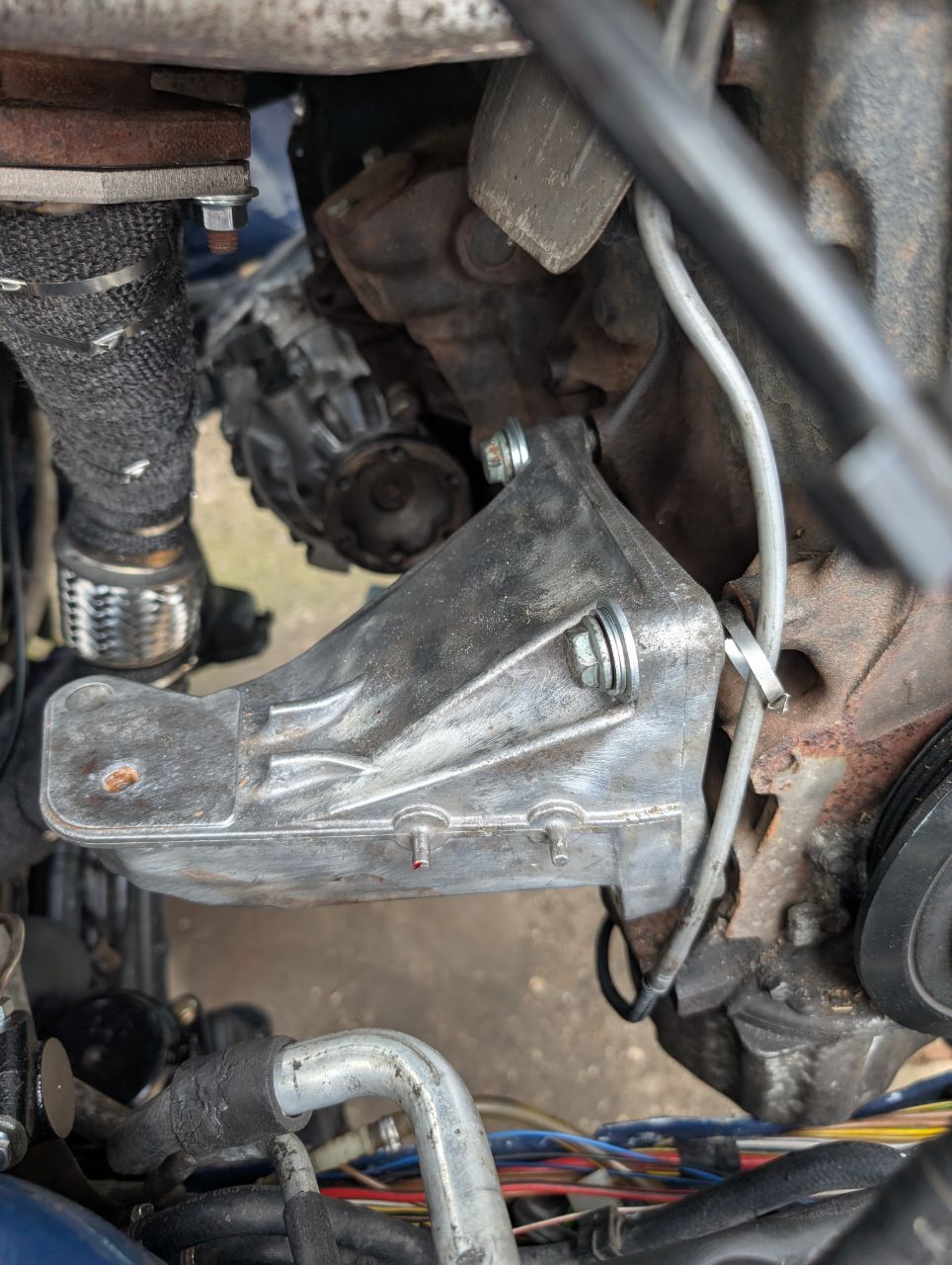

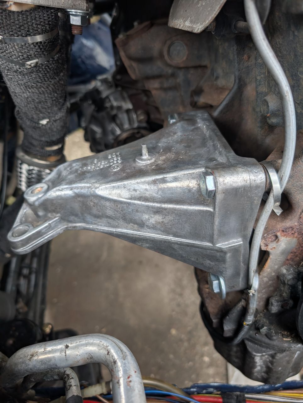

I got it off the stand and fitted the downpipes (I have wrapped them) and rear engine mount bracket but in my haste I made a silly mistake......
Yeah I fitted the bracket the wrong way up doh. I also cut myself so it's got blood on it. It's definitely taken blood, sweat but not tears yet lol.
Four bolts later and it was on the correct way up.

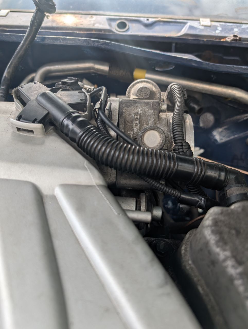

Then it was finally in the car. The bonnet wouldn't close 100% as the throttle body sticks up but looking at reference photos I have installed it wrong and I need to rotate it 90 degrees so it's flatter. If it still fouls the bonnet then I will have to break out the grinder to make some clearance.
Can't wait to get it all plumbed in and fired up!
Throttle body rotated to it's correct position.
And with that done the bonnet closes properly and there is tons of clearance especially considering the bonnet is sitting lower than it will be once the wings and rubber bump stops are fitted.

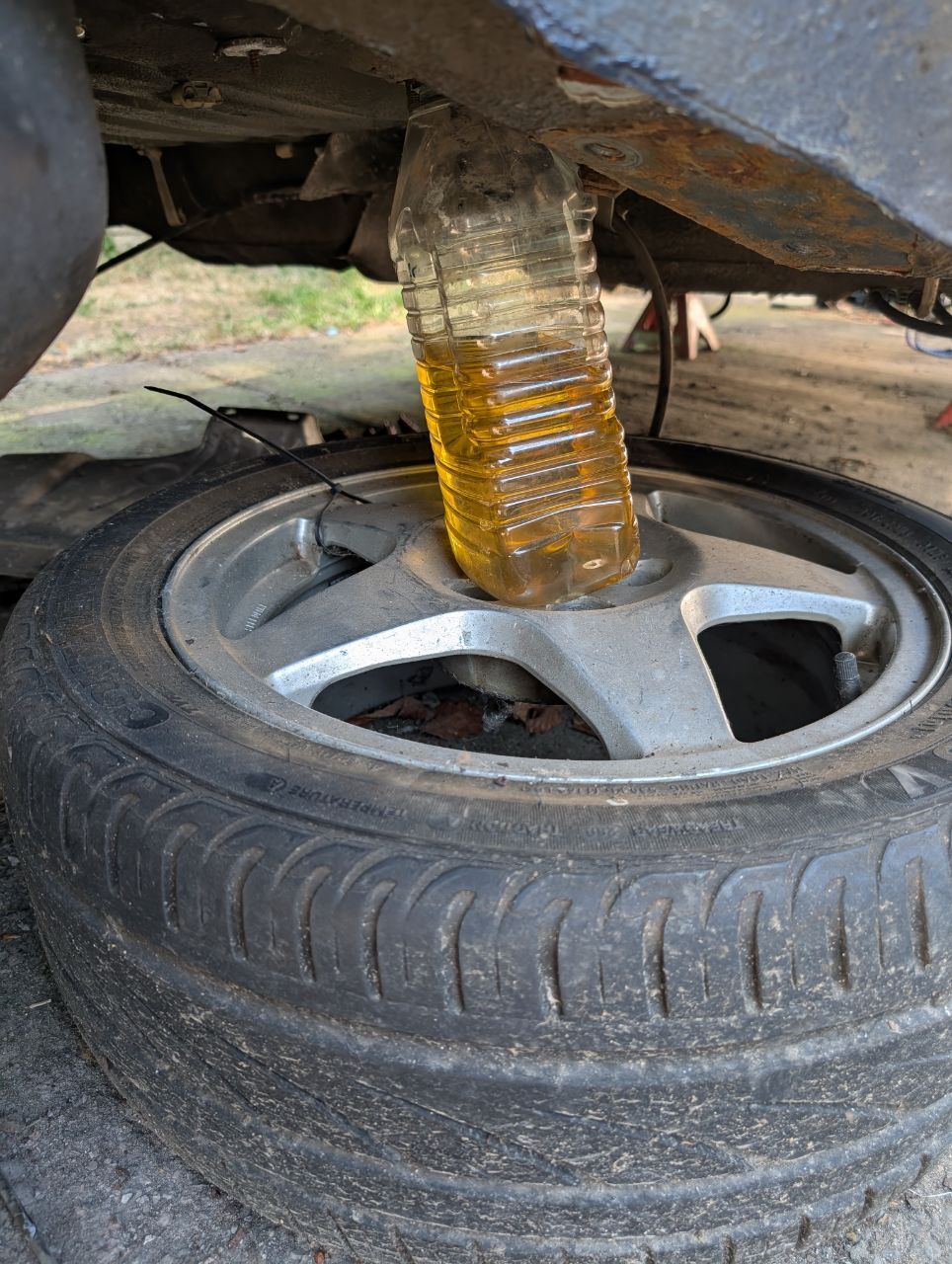

Approximately two gallons of five year old petrol pumped out.

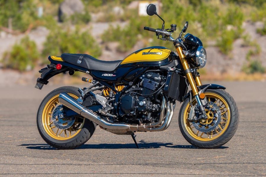

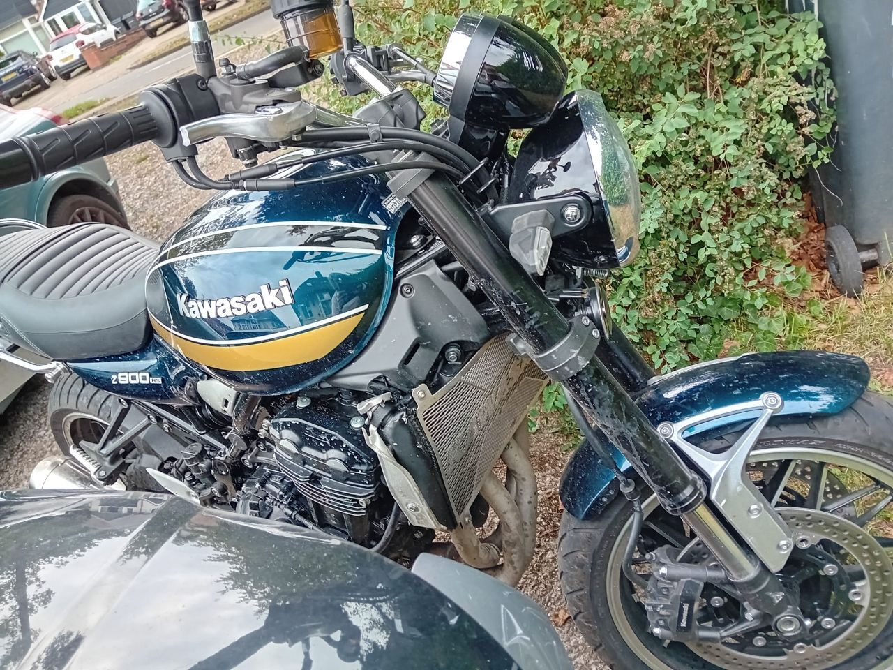

If you don't follow the grumpy thread I managed to have an interaction with a car that pulled out in front of me causing the above damage to my bike and leaving me a broken collarbone & a bunch of broken ribs. The bike was then subsequently stolen from my mother's driveway and found by the police two days later dumped in a park.
At this point I am hoping it gets written off so I can get myself a new 2025 Z900 RS but the SE this time.
I didn't get an SE before because I really liked the blue of the regular model and was not really a fan of the yellow especially with the gold parts of the SE.
However the 2025 SE looks evil in a good way with it's grey on black scheme and they have also blacked out a few parts that are silver on the regular model. You obviously also get the SE's Brembo brakes and Ohlins rear shock, I would still prefer that the gold bits were silver or black but I could live with them lol. I briefly had a look what alternative bikes I could get for the same money and came to the conclusion that I still think Z900 RS is easily one of the best looking bikes currently on sale and something I can see myself keeping forever.

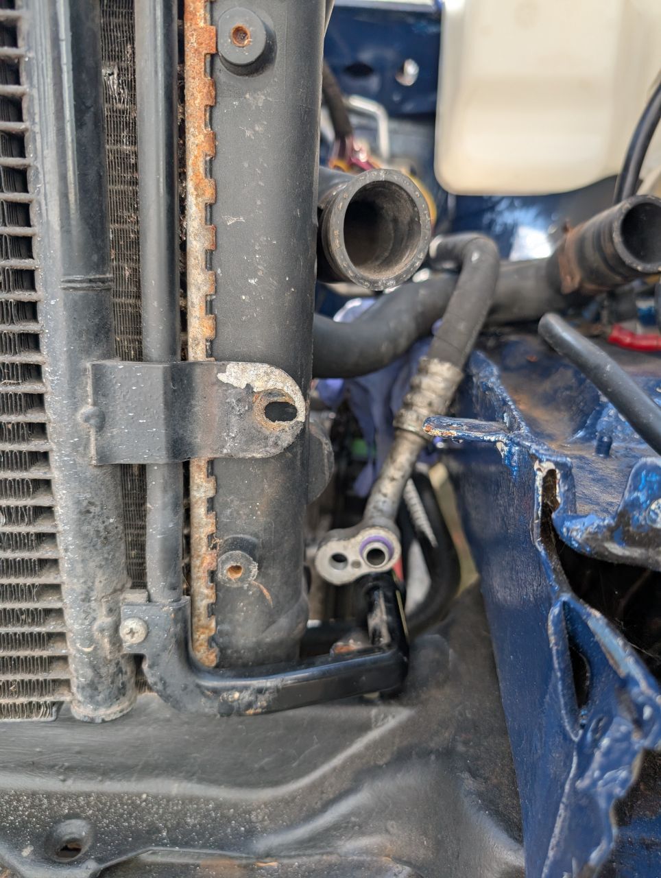

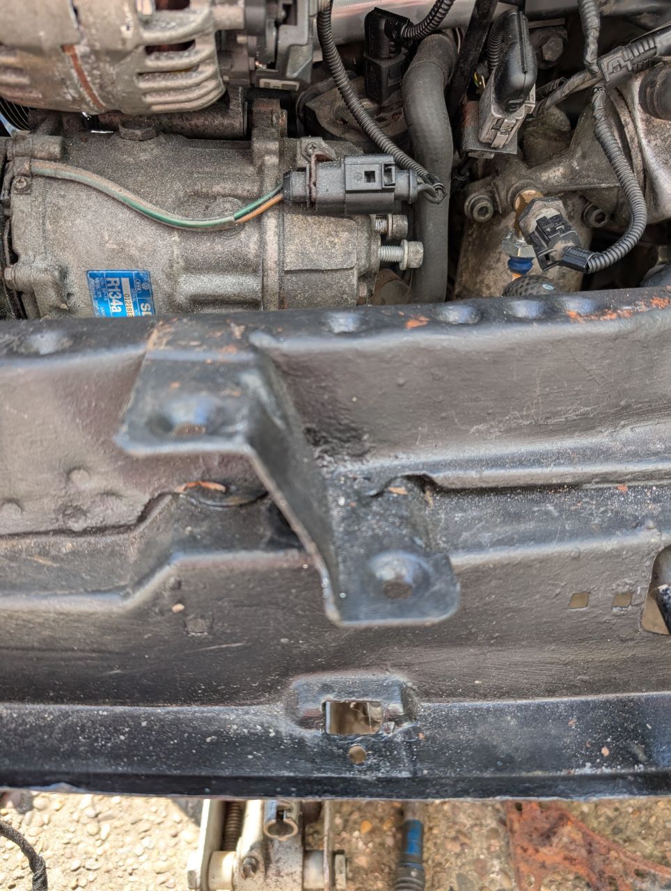

I am supposed to be recovering from my injuries and letting my bones heal but it doesn't stop me doing some light work on the Corrado. I wanted to work out how I am going to mount the Aircon radiator and started by removing this bracket/gusset thingy from the front cross member.
With the stock radiator in its factory position the A/C rad fits roughly in front of it.
I would rather it sat a bit lower as I think it's going to interfere with the slam panel but the pipework on the right hand side is in the way. Worse case scenario if I can't use the TT A/C rad I can always find a smaller one but I would like to try and use the one I already have as it's free.

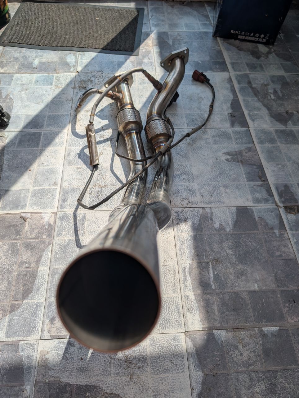

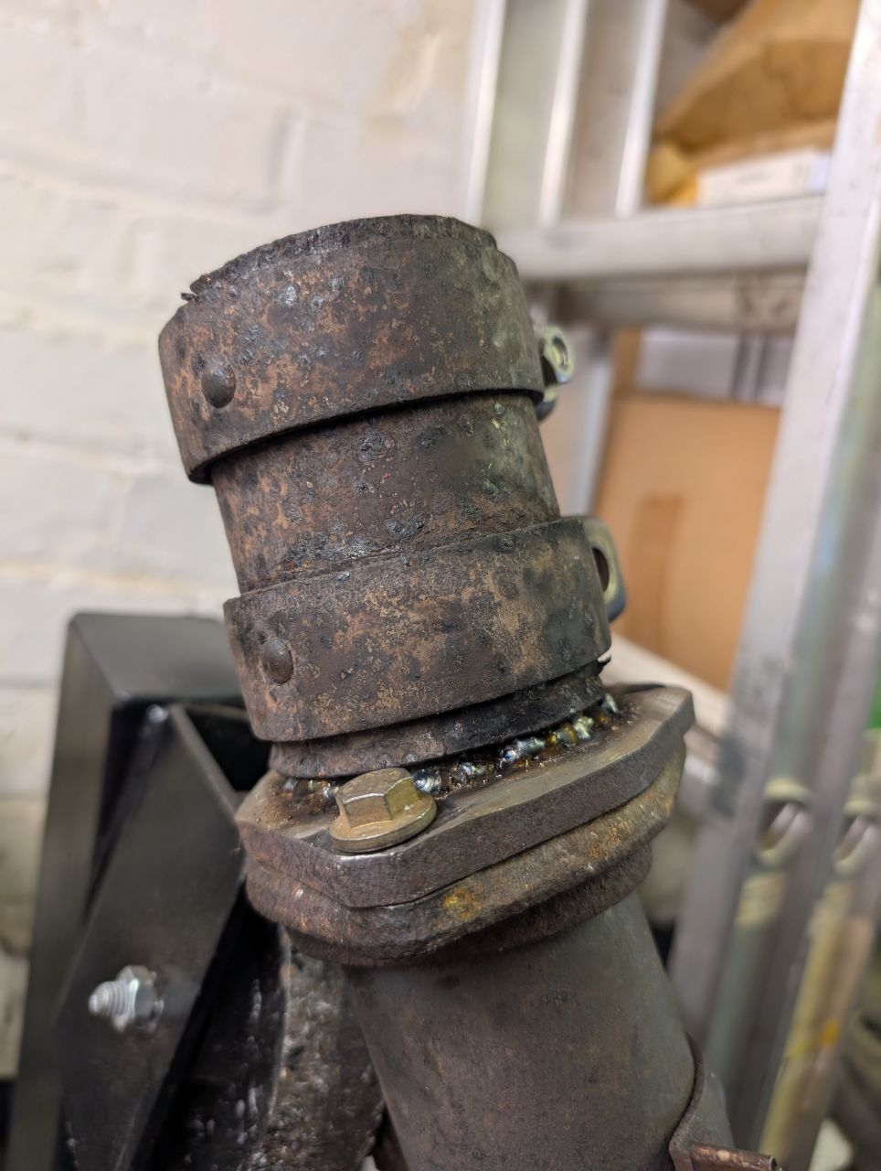

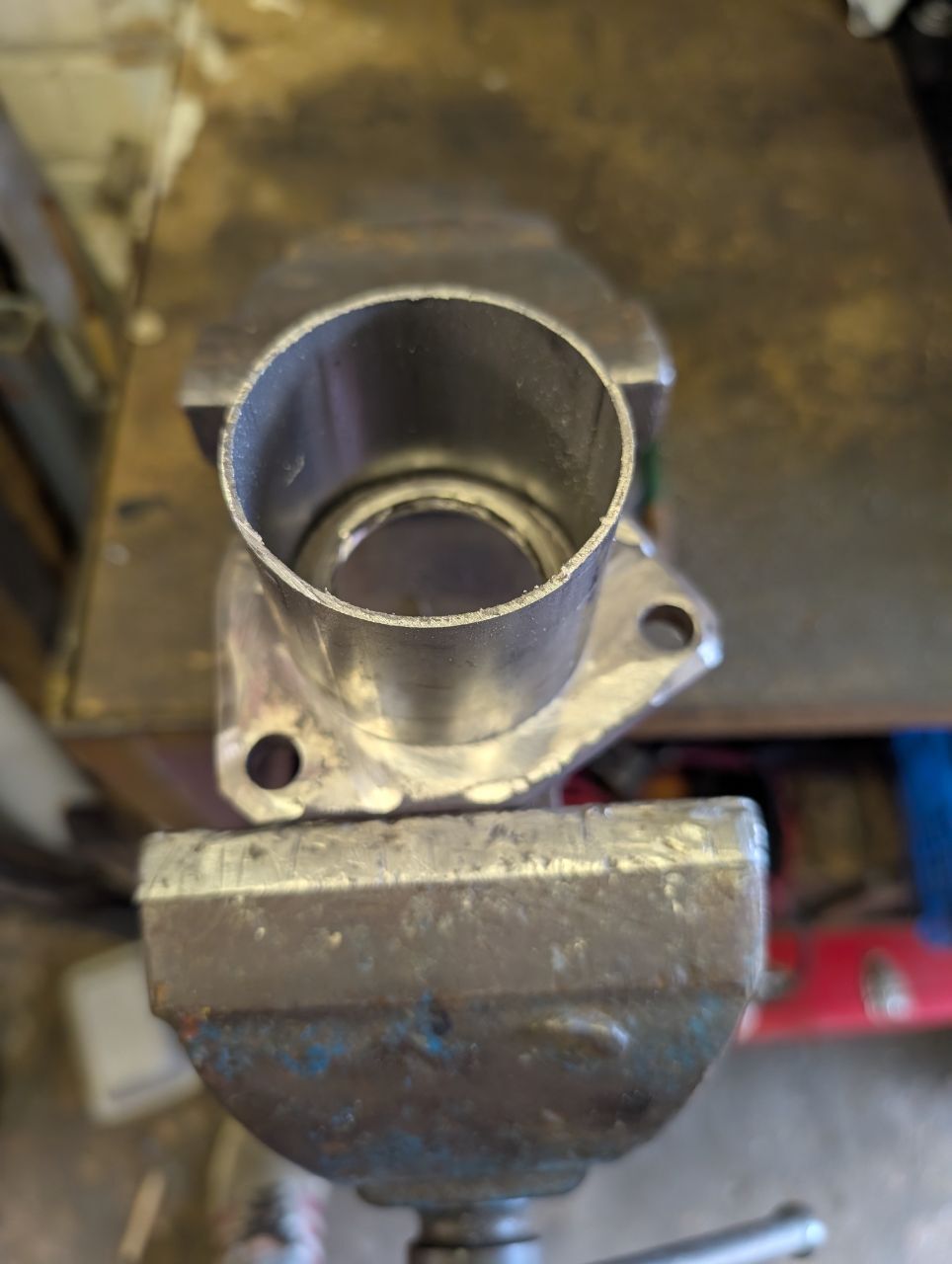

The new downpipe ends in smooth pipe of 2.5" diameter and I didn't feel like modifying the original Corrado catalytic converter to mate with it so I decided to make an adapter. I cut a flange off the old TT downpipe and also cut a 2" long piece of 2.5" pipe.
Some shitty welding later (I need more practice) and the two pieces were together.
How it will look on the car, I have a gasket to go between the two flanges.
Any extra length my adapter adds I will cut out of this bit of exhaust so all the hangers should line up correctly. I have spent a lot of money on various parts but the exhaust is one of the bits I couldn't justify replacing at this stage as it's mostly stainless and is in ok condition so it can stay for now.

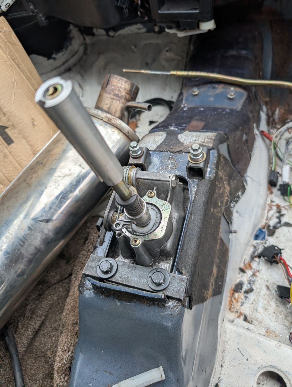

The Golf has also donated the later shifter and shift tower which has a much better feel with less slop. The shift tower at the gearbox end just dropped straight in and at the shifter end I improvised a mounting solution with some scrap metal I had laying around as it mounts from the top compared to the original which was bolted in from the bottom. The lever is a bit too long so I will need to cut it down once I have a seat fitted so I can work out exactly where I want the knob to be.

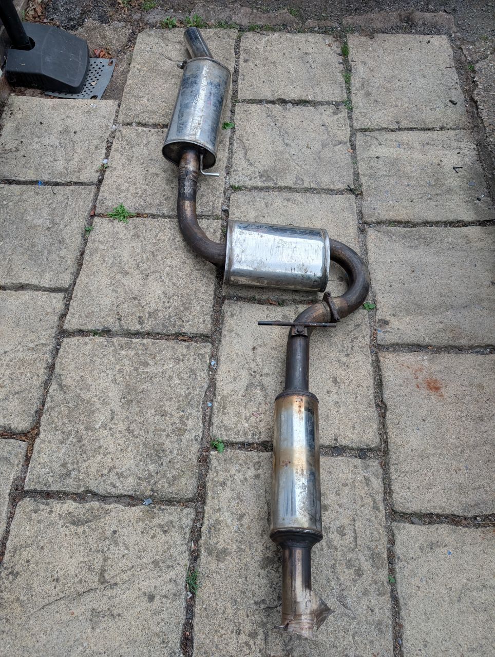

I am now feeling well enough to be rolling around underneath the car after the accident so today I made a start on fitting the exhaust, with the length of the new downpipe and my adapter the cat ends a fair bit further than I was expecting/hoping.
You can see where the first double hanger is in relation to the end of the cat.
Here you can see where that double hanger is on the pipe and also how medieval I had to get to separate it from the cat. I should probably just shorten the downpipe in order to make it fit but for some reason I have an aversion to modifying stuff that I have paid money for.
So instead I think I will delete the first silencer and cut it off at the green line. I will still have the second silencer and back box so hopefully it won't be too obnoxiously loud and if it is I will just have to turn up the stereo I guess......

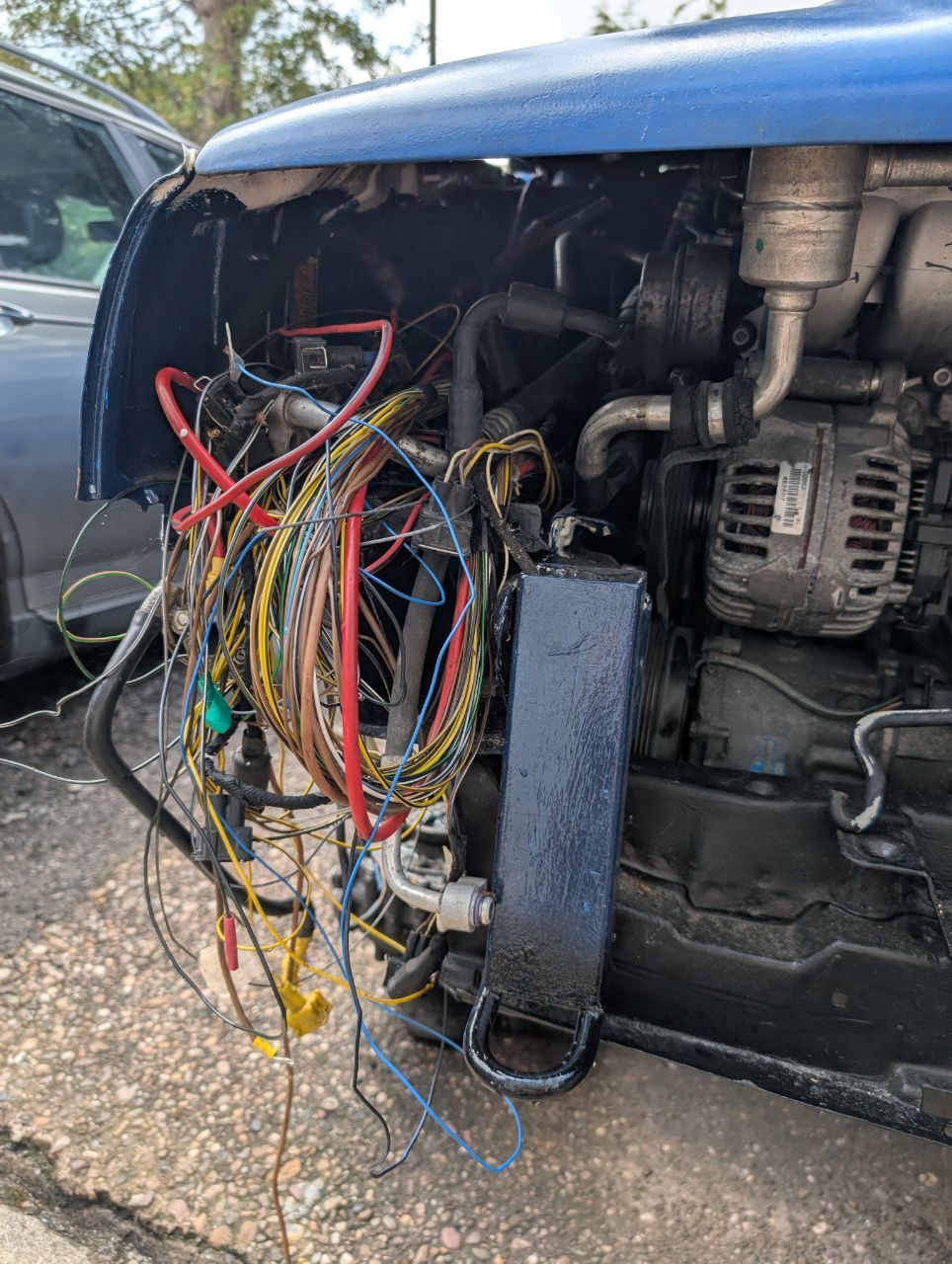

Cooling system pretty much sorted. I couldn't get the original cooling fan to fit in between the radiator and engine because of the A/C pipes so instead with a bit of butchery I am using the TT's twin electric fans. It's now a sandwich of brand new aluminium radiator, A/C radiator and cooling fans. The cooling fans are an upgrade in a way as the original arrangement was a single powered fan and then a second fan driven off it by a rubber drive belt which seemed a bit goofy. Now I have a big and little electric fan and because I am using all the TT wiring I have ditched the original fan controller so it will all be controlled by the 3.2 ECU.
