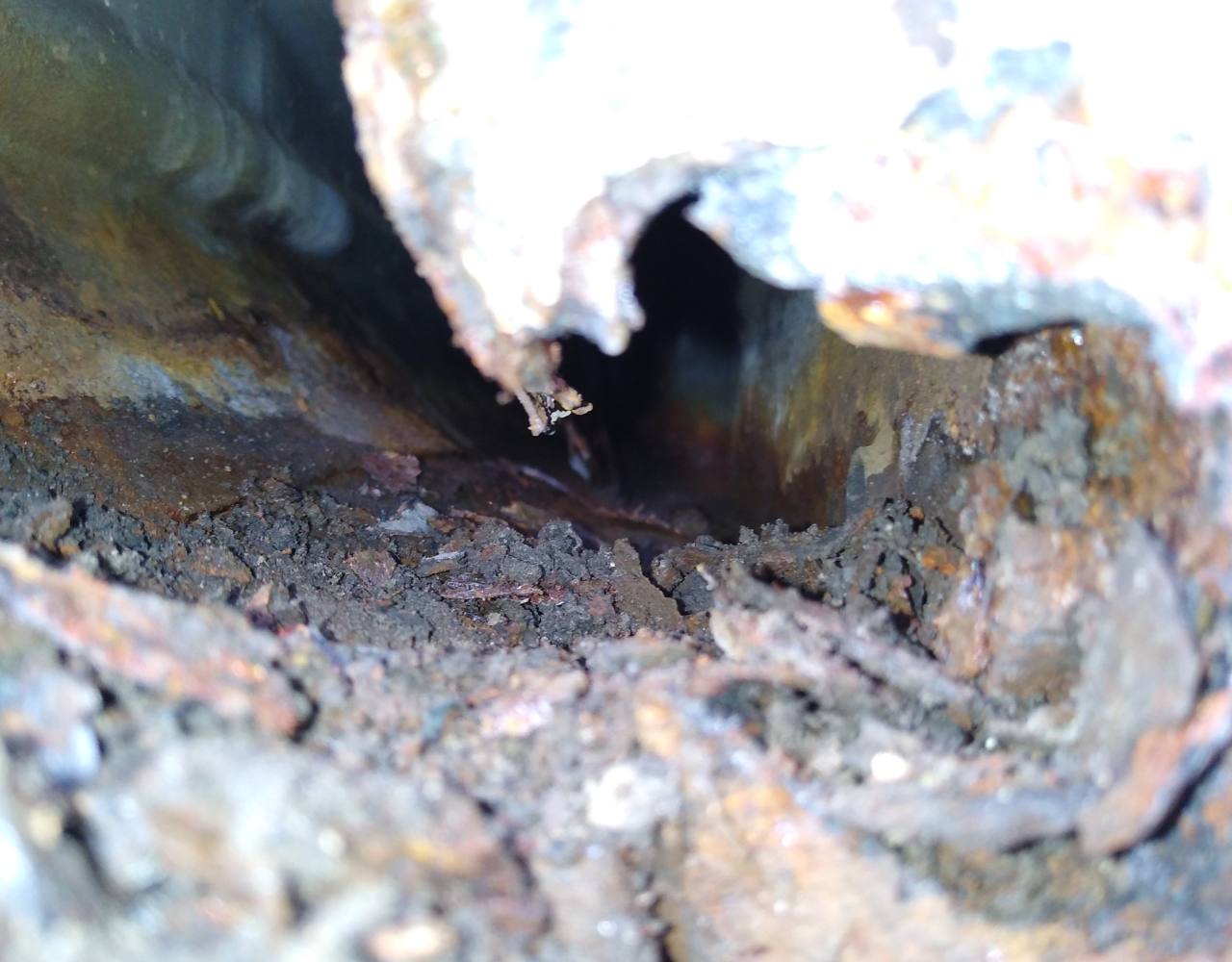

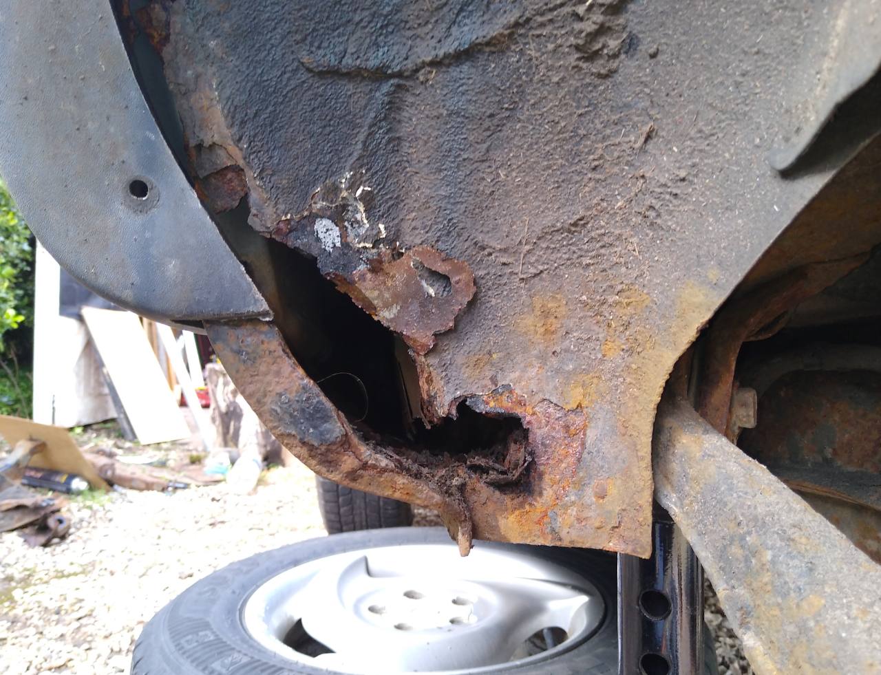

It's rotten.

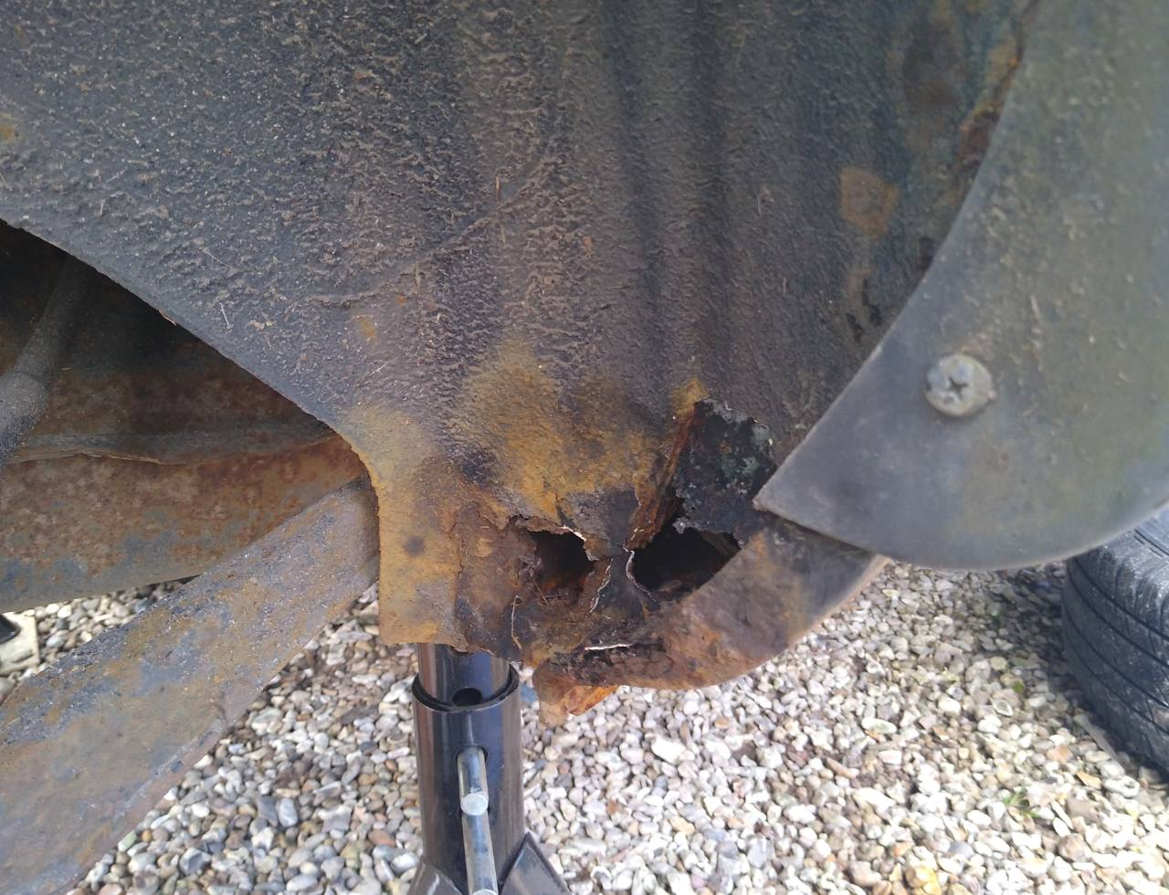

The passenger side rear most sill ladies and gentlemen, with rust galloping all the way up the wheel arch, thanks to the muck and shite that the plastic arch covers have held.
The same goes for the drivers side arch as well.
The rear as well under the door I sort of knew about, but it just feels that the whole arse of the car is gone really.

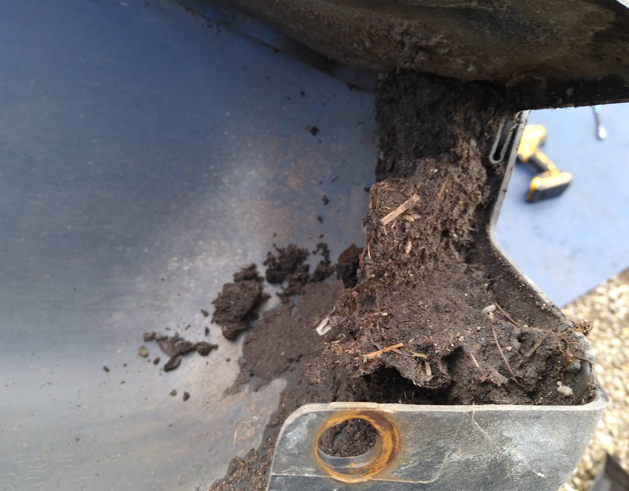

I'm trying to get the arch covers off, along with the rear bumper things to see how bad it all is. But the screws have decided they like being on the car.

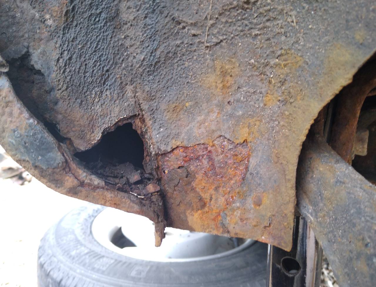

Had a bit more of a poke around on the passenger side.
Before:
After:
The steel is super thin here as well. But weight saving has started as you can see from the remains of this particular section.

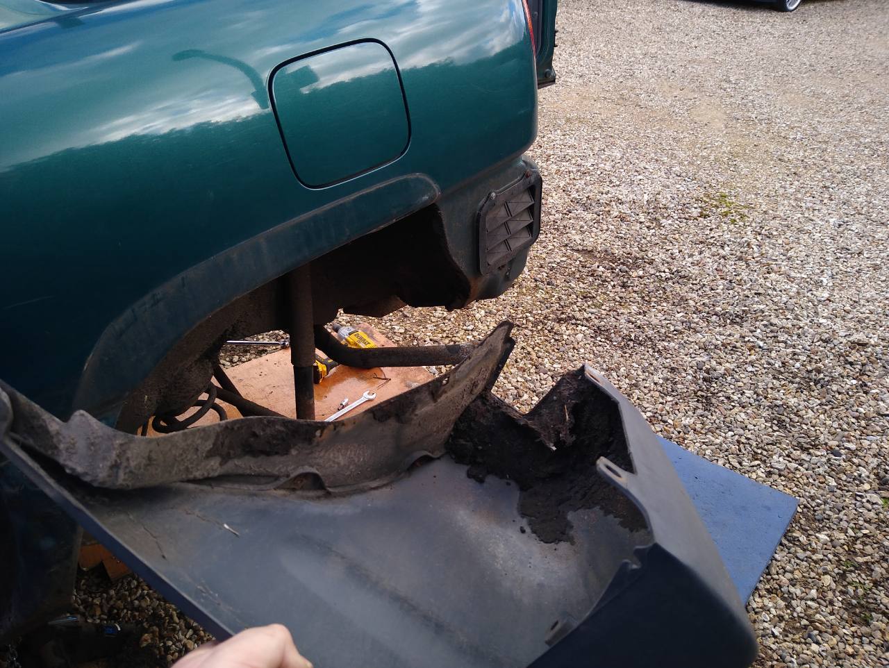

I've taken the plastic guards and shit around the passenger side. The arch on the outside is alright, to a point. Hiding behind the rear plastic bumper was a good 5cm deep of wet shit.
Which has caused this.
It's safe to say the entire inner arch is either cardboard or mud, and there's little to no steel left. I'm more than certain the drivers side will be equally as bad, so take this side as either the worst it'll get, times it by 2, and add it to the rust I actually knew about!

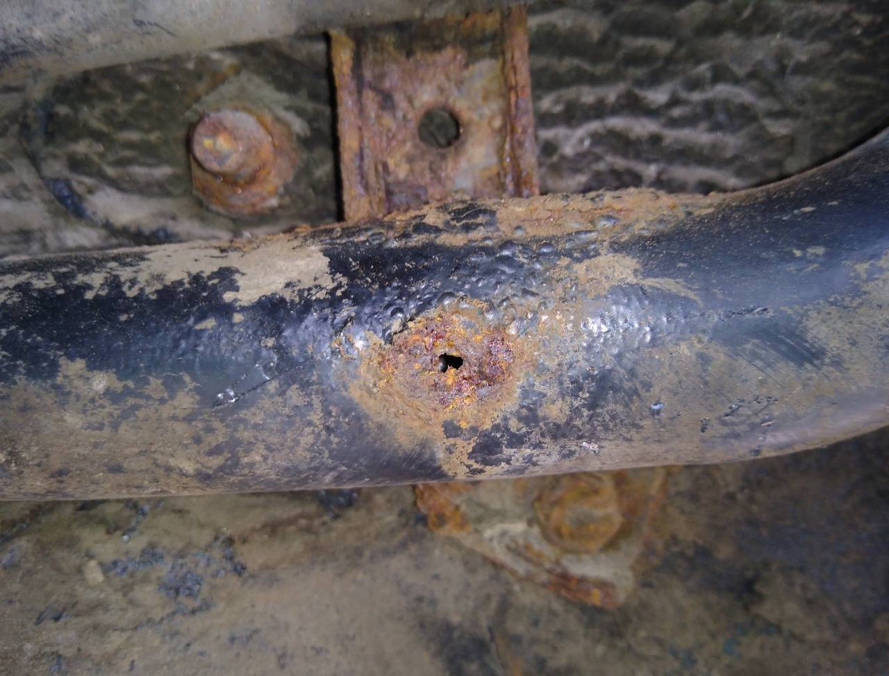

I could not work out how you were meant to get access to the bolt hiding above the exhaust. I was there scratching my arse wondering, and then it hit me - when I put the subframe back up, I should've put that rubber bracket on the exhaust side first, then the subframe. Instead, putting it on the subframe first then fixing it to the car, pushed on that little hanger and pushed the whole exhaust up in to the car.
I couldn't separate the back box from the mid section, but thankfully the back box had been taken off a few months ago so it was easy to just pull that all off. Still, because of the hanger fouling the rubber subframe bracket, I couldn't access the last remaining bolt.
A dremel later, I cut enough of it off and it lowered the exhaust enough to access the bolt. I didn't cut it all the way off, it's still attached a little to the exhaust. So when I'm welding I can just weld that back together.
