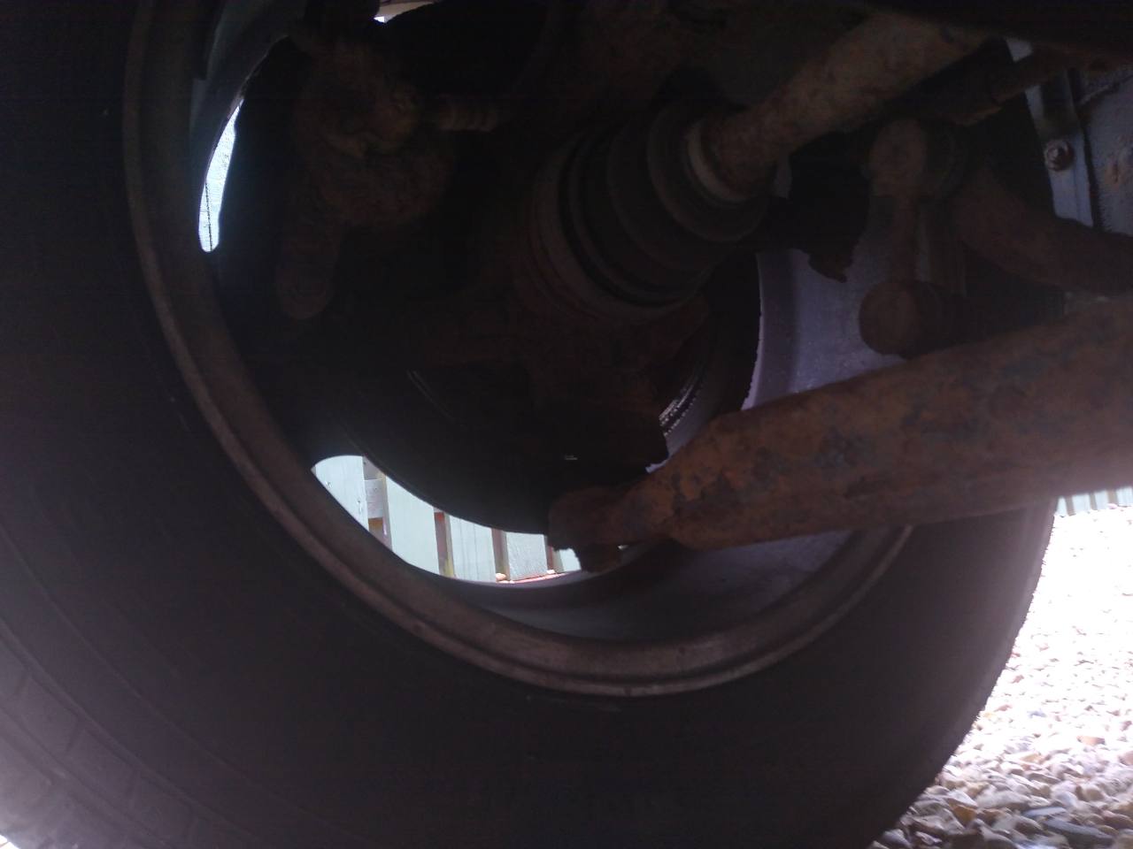

I now have a weeping CV joint, the joint I took apart. I didn't see anything that required the use of a gasket between the two mating surfaces. I'm going to say it probably does need one, so I'm going to go under the car this evening and re-do the CV joint with some RTV. Then give it a longer test tomorrow when the gasket has set properly.

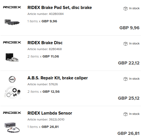

So after spending the weekend stewing over this, I've got the nearly maxed out credit card and spunked £154 on brake pads, discs, caliper repair kits and a catalytic converter. Based on the STARKK braking components I got given for my Corolla, the RIDEX things that Autodoc are selling for cheap will do.
The next day delivery cost of the catalytic converter made me chuckle though. Nah, you're alright mate. I'll wait for 48 hours.
I bought a lambda sensor just in case, as it might not come out of the hole it's been so fond of for God knows how many years. Going to take the converter and the RAV4 to a mechanic and get them to suffer taking it off. I've been there and done it with the Corolla, and I ain't gonna go back to it no more!
sand the brakes lines down,than underseal them,save money the autoshite way,spend asless as possible,to keep your old beater on the road.
They always have X% off them, although today seemed to be as good a day as any to buy. Pity I didn't do this last week, they'd probably turn up next week in time for a week off I have coming up.
With the brake lines, I've got some cunifer pipe in the garage so I could make them up myself. If I'm that bothered!

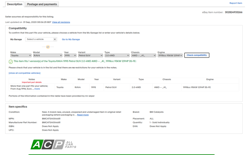

So the eBay bloke is adamant he didn't mislead me with the information he provided. I'll leave the screenshot here to leave you to draw your own conclusions. So I have to pay postage. Which means I have to set up a PayPal account. No other way of doing it, which angers me beyond belief to be honest as I don't want a PayPal account. Not even sure I can remove the PayPal account once it's been connected to the eBay account.
513758822_Screenshotfrom2020-11-0411-13-48.thumb.png.3a33480a6b7b1d28f38ccc8d12edc4c1.png

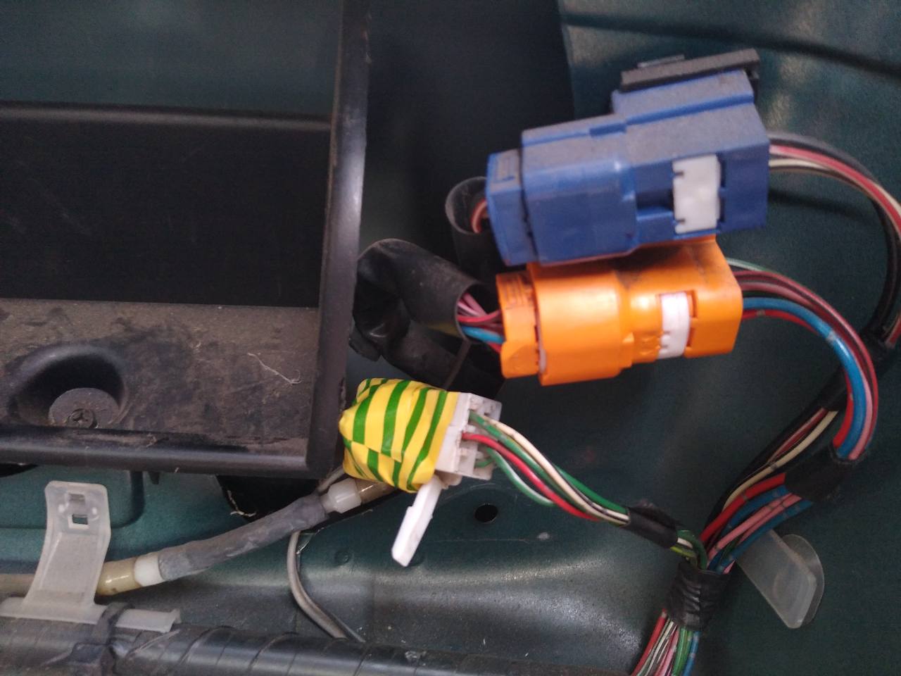

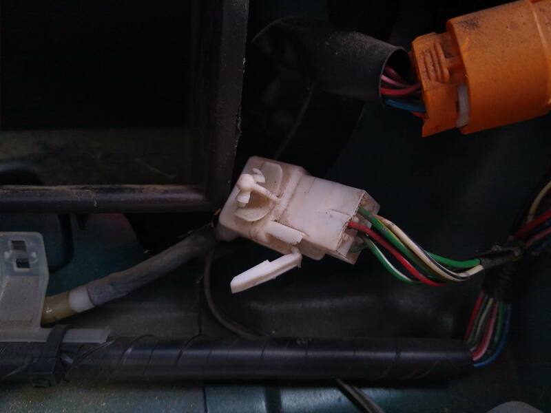

Anyway, on a happier note, I fixed the brake light on my lunch break. Turns out the connector from the brake light was broken and had a bent pin, and over the course of however long the vibrations have made it work itself loose. A copious amount of electrical tape around the block now means it should be alright. It works at least! Also taped it to the lead above, just to stiffen it so it won't work loose again.
Put the panel back on wrong though so come "home time" I'll be out again changing the panel. May also go to see if I can get the third level light thing to work.

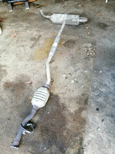

So are you currently running without a cat, bashed out the old one, or have you found a good one?
... because I've just unearth this...
The newest middle section will be too long for yours, but I should have sent you away with the other bits.

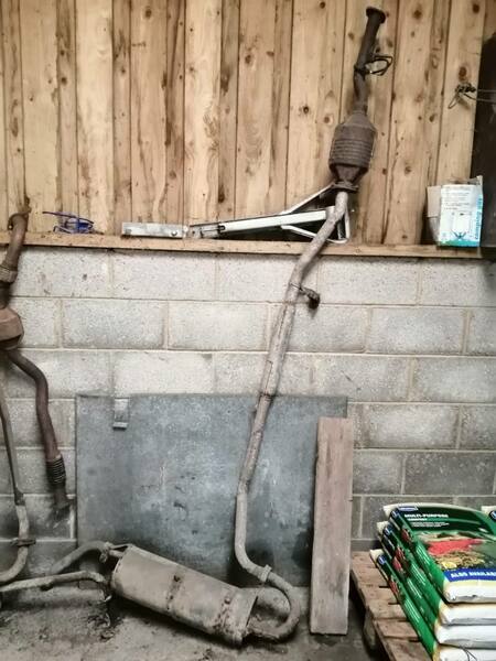

But yeah, whats that cat from then? The one in the field?

...whats that cat from then? The one in the field?
Correct.
It was a good exhaust but I took it off before the 5dr was "fielded" because life up there is not conducive to long exhaust life. It's been in the shed for over seven years. Anything parked in the weeds soon rots from the bottom up.
So yeah, the cat's yours if you want it. Can't guarantee performance obvz, but it's not rotten. Includes sensor.

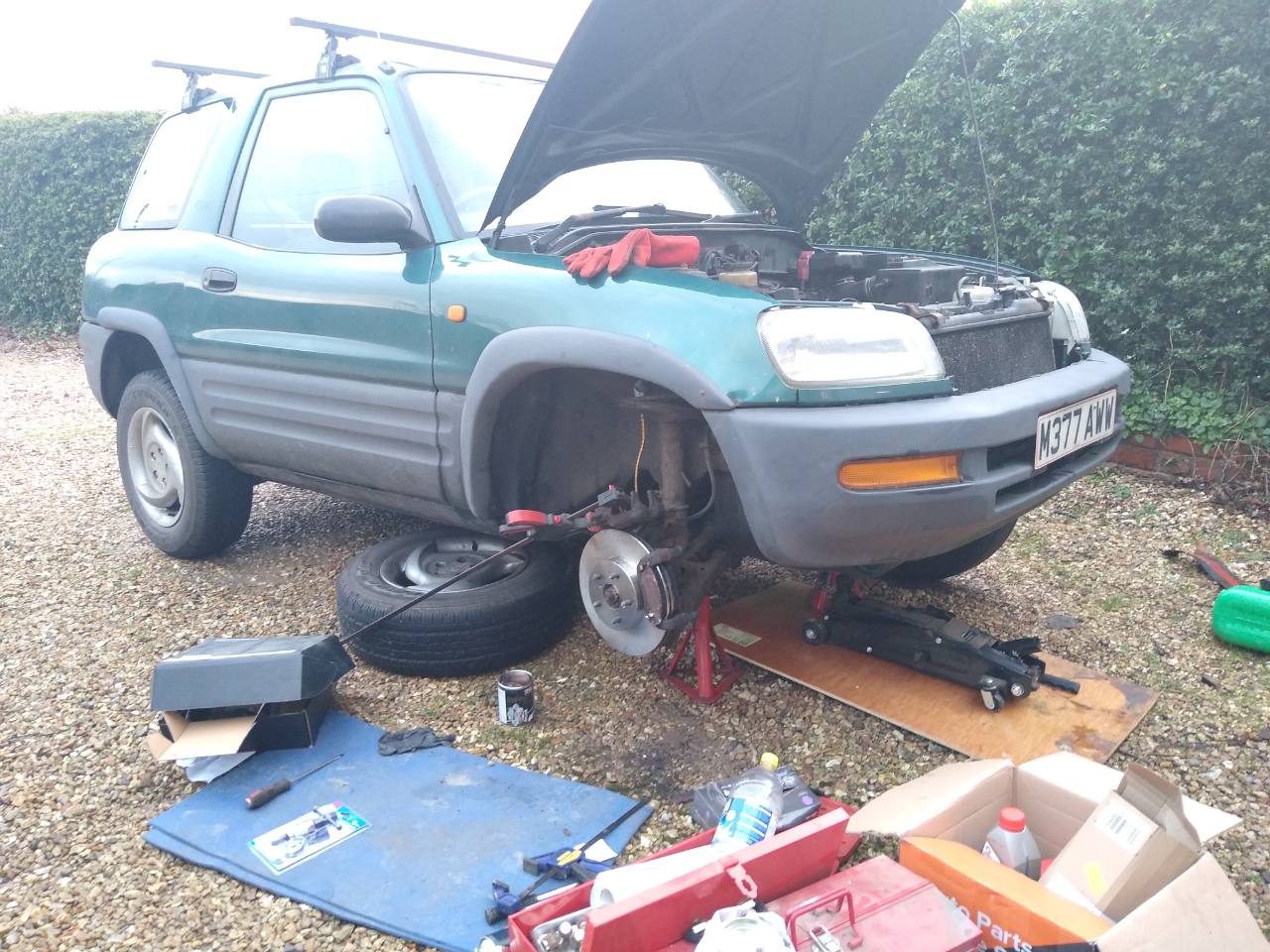

So I spent my day off today sorting out the brakes on the RAV4. As demonstrated by this photo.
This side wasn't too bad. I mean, it was difficult, as I swear the pads and discs were welded on they felt that old.
The passenger side though, a different story. And so vexxed am I that I haven't taken a photo of the predicament. Put the last bolt on to the caliper, and the bolt shat itself. It's just spinning inside the slider pin which was already questionable.
Called Toyota, I'm getting a new bolt and slider pin by Friday 18th December. A full week away for something so small, and about £13 for the pin. Sounds a lot, but they're about £8/9 on eBay for something of questionable source.
