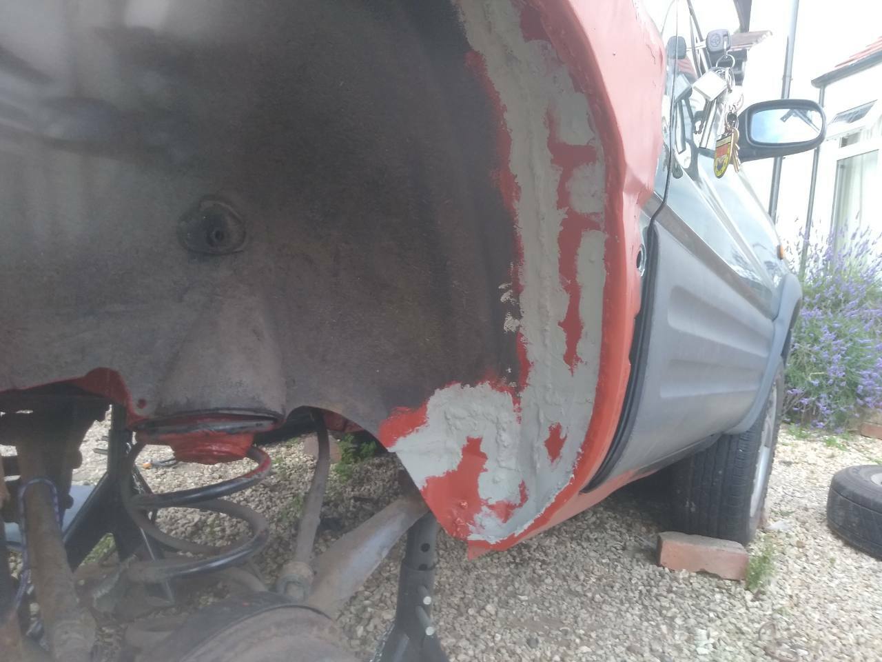

Anyway, first coat of red oxide is now on the car, on the arches (outer/inner), sills, and underneath. Except the rear subframe, I'm just going to prime and stone chip that.
I will say though that given the heat, it's nice to see my welding is now heat mapped...

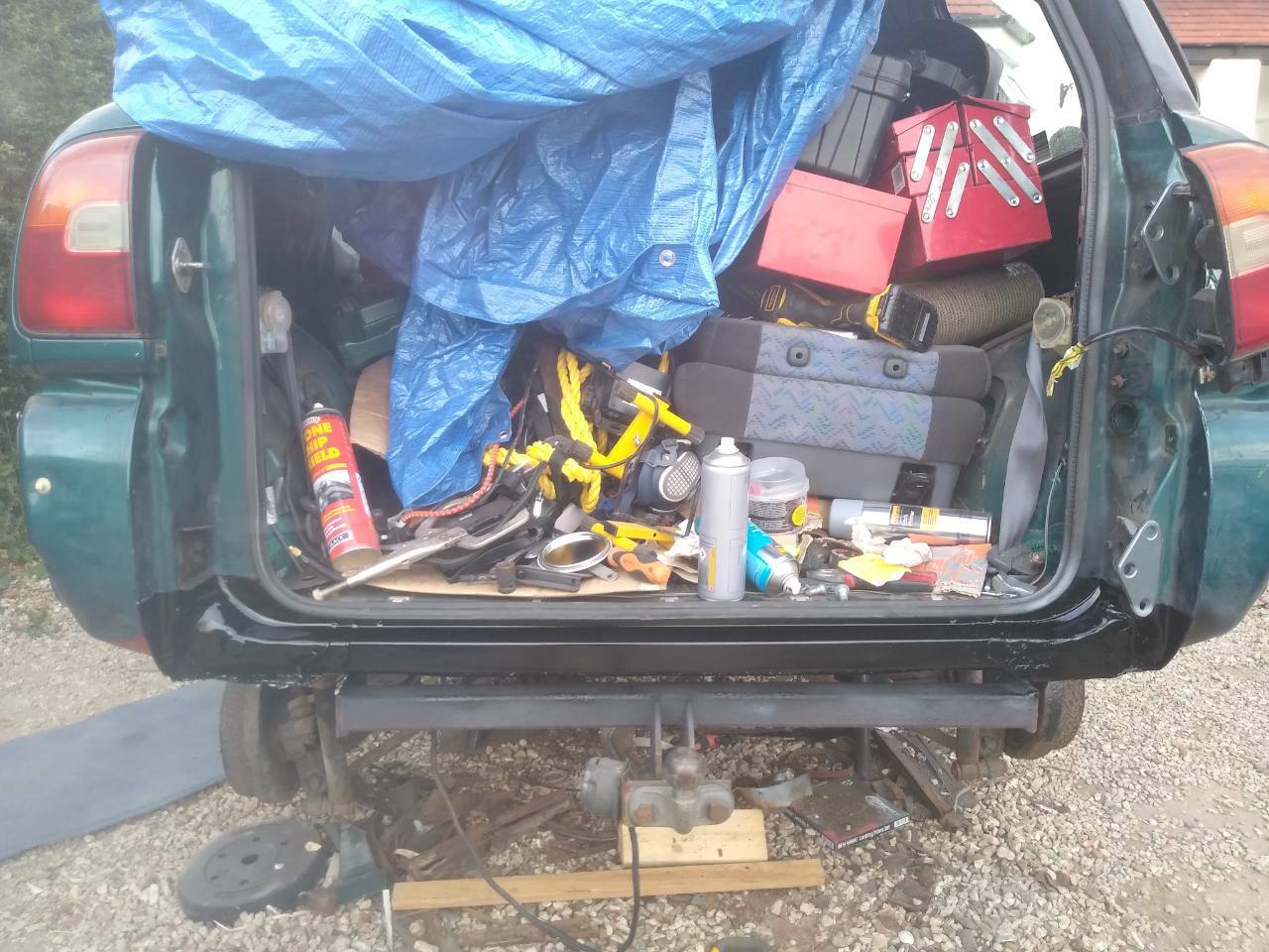

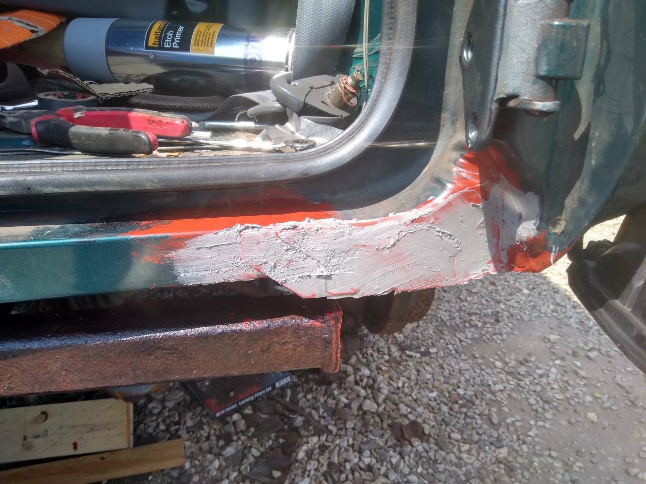

I noticed with the weather is going to turn Saturday, and I still have the rear door off. It's off as there was a bit of the body in the corner of the door that was rotten, which has now been welded up etc. I just needed to fill it, and paint it, then re-attach the door.
So on my lunch break, high off my tits on these lovely, lovely painkillers, I took out the filler I bought a few months ago. I'll be honest, I feel like the chap on the tin.
Slapped it on, it went off fairly quickly as the instructions said to use half a tube of hardener for half a tin of filler. I didn't use that much so I got the mix a tad wrong.
So that'll go off now good and proper, at which point this evening I'll sand it down a bit, put the primer on and use stone chip paint along here - just as it makes sense to paint this bit with rubberised paint given its the boot lip.

That Big Boy metal filler is great stuff. I slathered a load of it onto a rotted out silencer box because I couldn't be bothered fitting the replacement I've bought just yet, and was impressed by how hard it dries. It remains to be seen whether the MOT man is equally enamoured with it, but so far so good.

Went out this evening and sanded down the filled in piece. Didn't really go all out to make this perfect. I'm saving that for the arches.
Sprayed on two coats of primer, then one good coat of stone chip, and then one good coat of black gloss. I think it looks good, and should give that lip a good bit of protection. The tow bar is awaiting some hammerrite paint, which will go on when I get a brush.
I didn't realise I used my last brush on the seam sealer, if I had another brush I'd have done the tow bar tonight. But the seam sealer is very odd stuff, but I slapped it on over the welding seams on the arches and sills.
At this point now it diverges. I will now slap on some underseal on the arches and sills. But only after I do the arches on the outside. I have dents where the panels have warped, I'm just going to fill them in. I could hammer it, but I just have memories of Father Ted and I'd rather be one of these wankers that just fills in the gaps with filler, than lose half a Rover 200 from using a hammer!
Threw the rear door back on the car - forgetting to actually paint the primer on the door.
Then I just did the age old bodge job of slapping the filler on the imperfections.
I'll sand this down so it's flatter, then apply some Isopon P45(?) to fill out the inevitable divots I've got. Also found some dolphin glaze that I bought last year, so I'll use the three to make this a nice job. But I'm going to do it all on the driver's side first, so that I'm balancing out the shitness between the two sides.

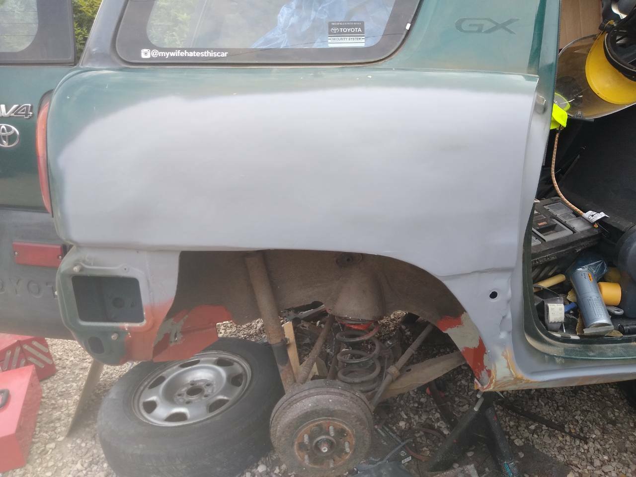

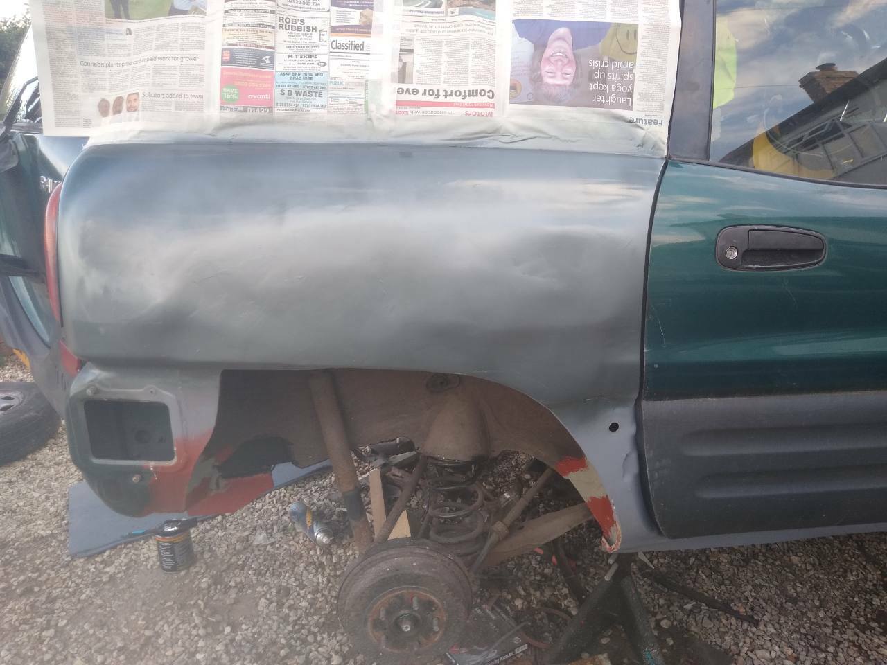

Went out this afternoon and threw on the first bit of filler on the passenger side. Quite possibly the worst bit of filling I ever done did.
Went out in the evening, put more filler on it. Took the orbital sander out to flatten it as my arm is deader than Lord Lucan so I thought it would be easier.
It isn't. So I just got the block and sand paper and smoothed it back, to the point where it was smooth enough for the dolphin glaze.
Which I managed to fuck up.
I don't need to smarten or smooth out the part of the bodywork that's in line with the plastic door trim, as it's all hidden by plastic trim anyway.
Didn't sand it down, as I felt a few drops of rain. Which promptly stopped. It's meant to be showers for the next two days, which I'm fine with.

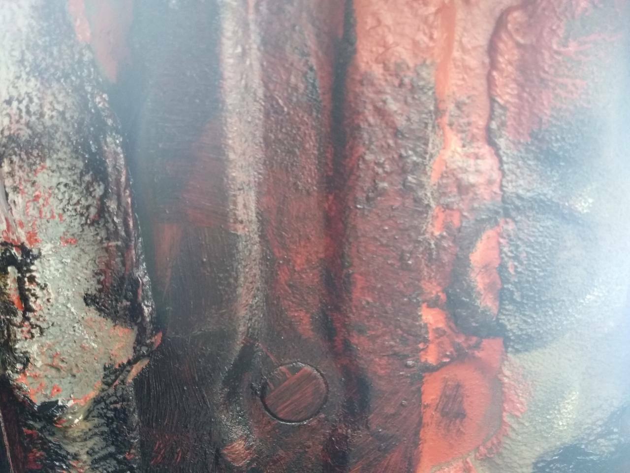

Also, this Hammerrite underbody seal - am I meant to do two coats of this? As it doesn't seem to cover the primer all that well in places...
5 minutes ago, St.Jude said:
Well I mean, it's a very good colour match if my car was silver.
What a load of bollocks.
Yea, if it's the brush on stuff I usually did two coats. Or a thick coat if I was feeling very lazy

I'll let the underseal dry off tonight, and go at it again tomorrow.

I'll be honest, I kinda like the colour. If I were to keep it long term I would actually get it resprayed in that colour!

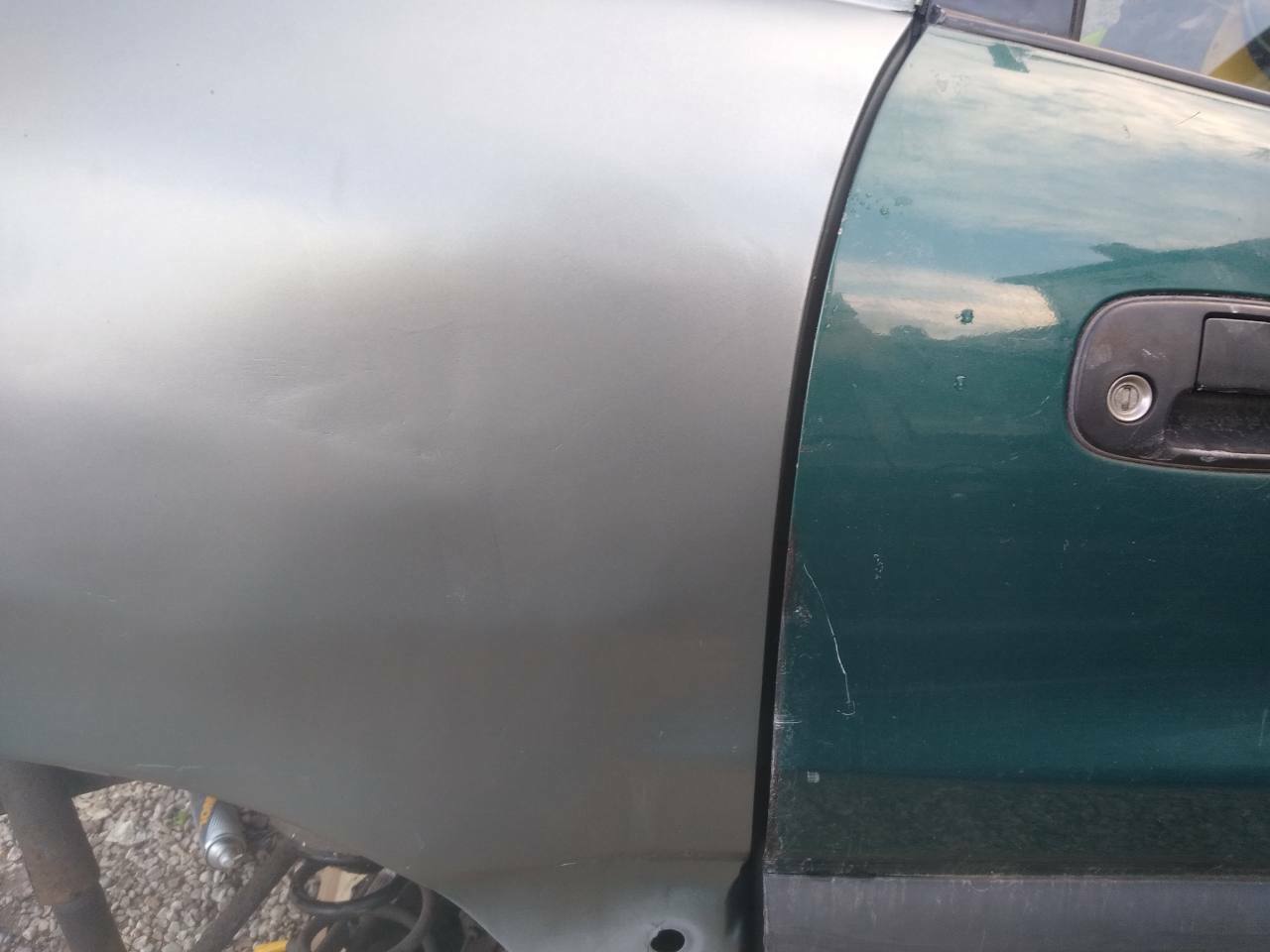

So went to the lock up to pick up my fuel tank, and on the way back I thought - it's Friday, where's my drill? Haven't heard a dickie bird from Screwfix about it.
Popped in, ended up with the same fucking useless mouth breathing duty manager. It didn't get picked up until Tuesday (they were given it Saturday), and they haven't bothered to see where it is. Told them I'll be back Monday evening and the drill (either repaired or a replacement) will be there, or she needs to give me her name, Area manager details, and head office. Yes I am a Karen when it comes to relying on people to do their fucking job.
So I've got to dig out the knackered £50 drill this was meant to replace to wire brush the fuel tank.

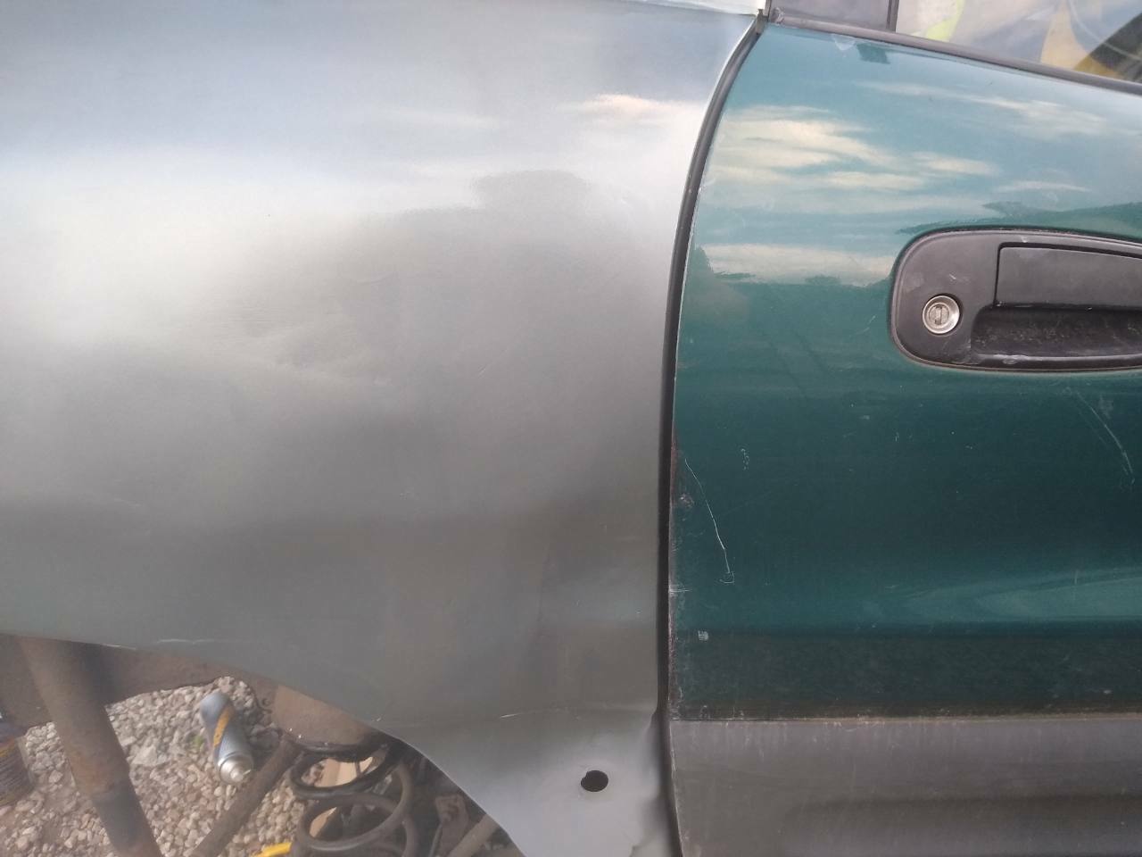

Also, paint wise - this is how it started
This is what is getting lacquered.
Far better colour match which shows off my piss poor filling on the driver's side. The other side, where I made the outer panel myself, is so much better.
Tomorrow will be fun. A mix of painting, lacquering, trying to tart up a fuel tank, make a new petrol tank strap, etc etc.
