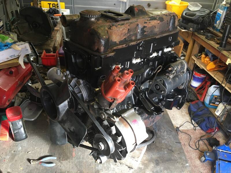

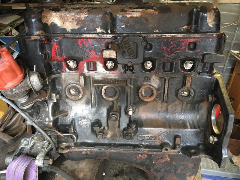

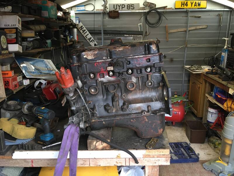

and doing work on the 2.0 engine. Got the sump off, it’s a bit dented so I’ve found a spare but need to take it to work to give it a good clean (ran out of brake cleaner). Also put the engine on my bench with the help of mr crane. And replaced the crank seal
the old fashioned way
small slither of grease round the spring to keep it in place
and hey presto!
also started cleaning the block and head. Soooo many layers of paint!

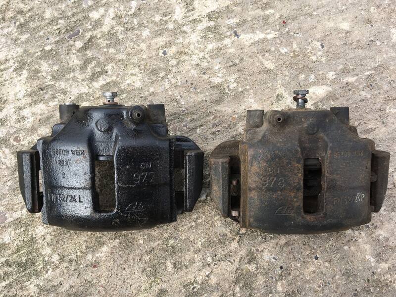

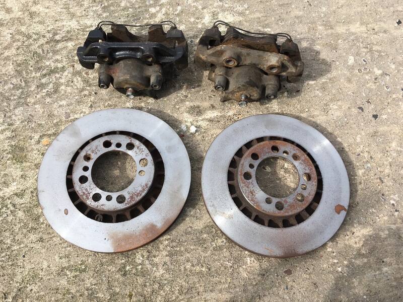

I found a set of Astra brake callipers in the shed. Pretty sure they are too big for 13 inch wheels. So I may still use the original brakes. Amazing the amount of shite I’ve got

a little more done on the engine. Got bored n started to paint. Taken almost 3 layers of paint off it. Black, red, black.

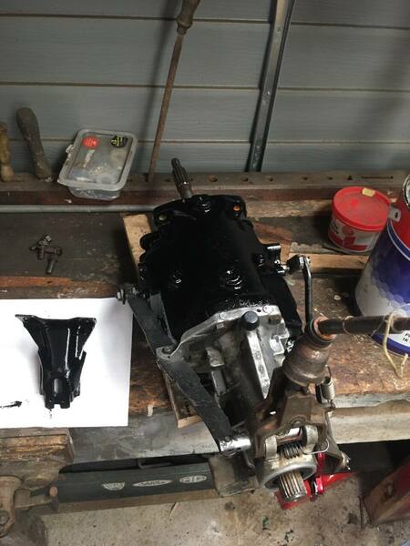

More work has progressed on this project over the last few days. If it’s rusty, it’s been painted. Sourced a set of correct engine mounts to go on it. Original alternator turned out to be scrap and I was given another, which I had tested - good.

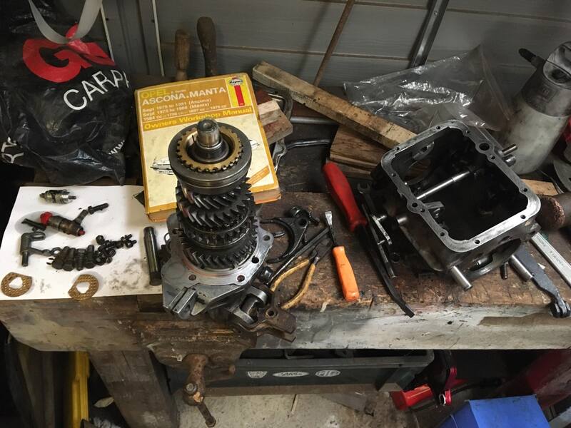

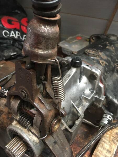

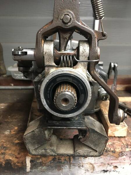

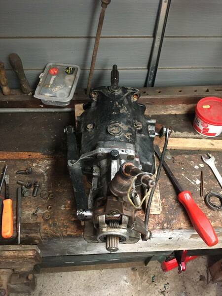

then I set to stripping the gearbox to replace the gaskets. Rear gasket involves stripping the internals out, which is a pain, but I managed it eventually.
The selector shafts are an interesting concept.
and it’s all rebuilt with new gaskets.
And a lick of paint to complement a successful rebuild.
replaced rear seal
and found a spring missing off the lever. Had a rummage in my box of spare trinkets and found a perfect match.

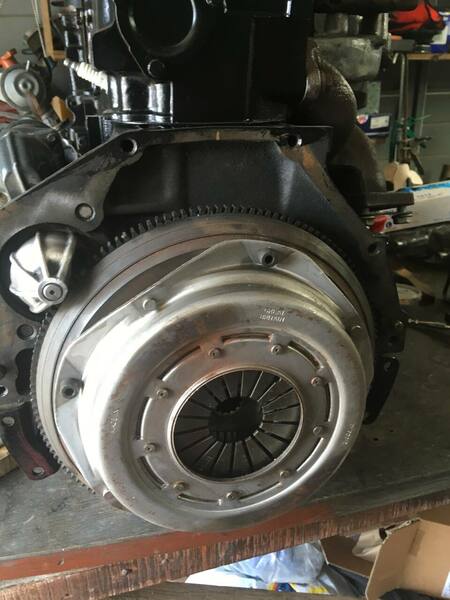

Still waiting for parts. Clutch came  on Friday. Wrong. Guy thought I wanted a 9 inch but a 9 inch won’t fit any flywheel I have. Nor will it clear the 4 speed box.
now I have an 8 inch clutch coming Tuesday night. Slightly more expensive. But at least it’s brand new old stock.
so until that’s here, I have to get it ready for putting the engine in. Turned it round in the workshop.

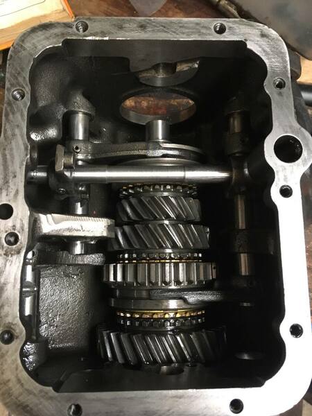

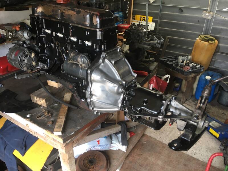

Picked up a NOS clutch kit today. Had to walk 3.5 miles for it. Then 3.5 miles back. At least merlin enjoyed it. Now fitted, and test fitted the gearbox. All fits fine. Engine can go in now.
I'd no idea the gearbox in these was so small! Useful pic, I'll save that for future reference.
Yes the main section of box where all the tricky stuff lives can fit on an A4 sheet of paper. Crazy!
Did the transmission tunnels change between the Manta B and C? I remember the getrag in my old GT/E as being a big lump of a thing.
Yes the 4 speed and 5 speed models had different tunnels. Some people fit the 5 speed and modify the linkage so they can keep the 4 speed lever. I’m not too fussed about that.

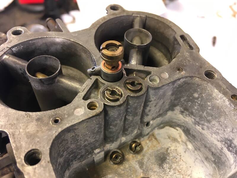

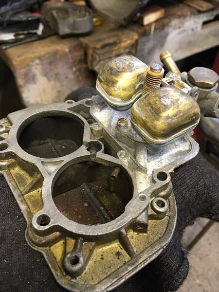

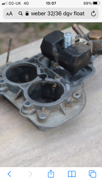

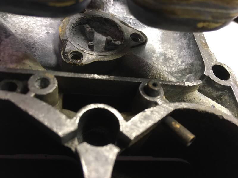

While cleaning the carb I noticed something “not quite right”.
what’s this?
tiny little metal tube.... did some image searching
ahhhh there it is.
and there it isn’t. So that gets sent in with a hammer.

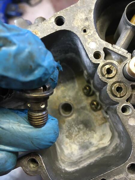

Took the power valve out, that’s seized solid. Great. So ordered one of those for £20 off eBay. Webcon want £31 plus £7 postage. Get fucked.
carried on with the needle. Took it out and the new one is the same. 2.00. Great.
and now I’ve got the floats in a tub of petrol to see if they leak in.
no that’s not my piss, it’s old mower petrol 😂
