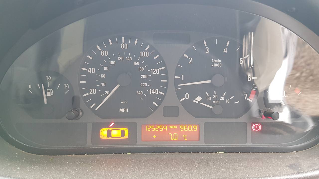

So I've added 10l petrol and managed to start the BMW and so far it runs. So I think that maybe the sender from the left tank does need replacing. It's only £20 or so. But I don't like the idea of throwing parts at the car until the problem goes away, but given the symptoms so far I think I may need to replace the left hand sender.
Apologies for relying on your brain @jamiechod I very much appreciate your help so far. Would you agree with my logic so far?

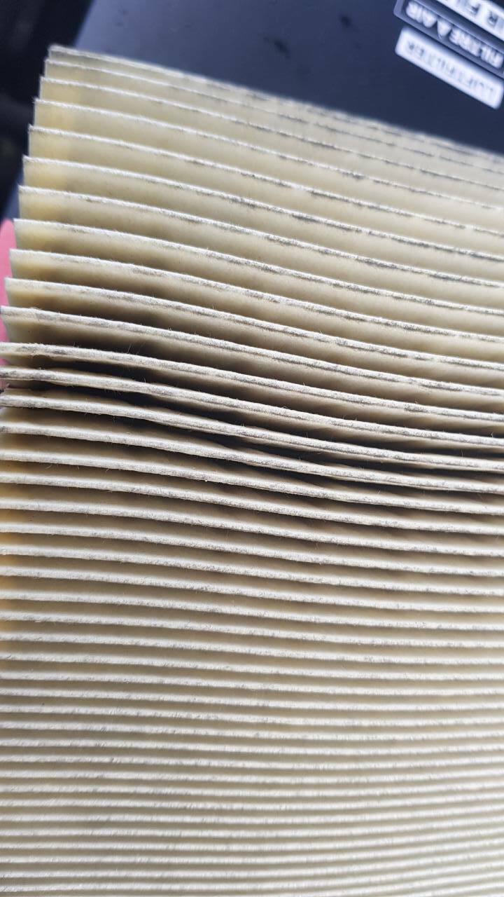

Air filter and new plugs arrived.
Had time to put the air filter in today; of course two of the three screws holding the air box in are toast, but no time to faff, I just willed them out and back in again.
Old filter looks ok anyway. New one in.

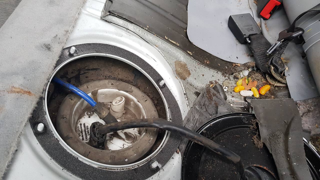

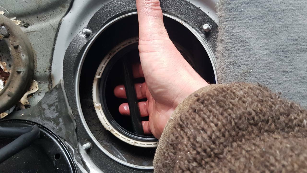

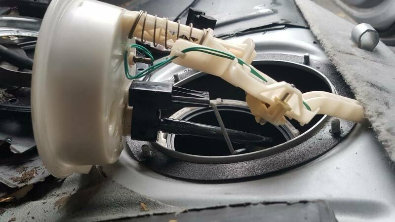

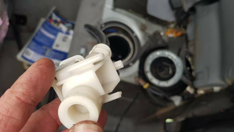

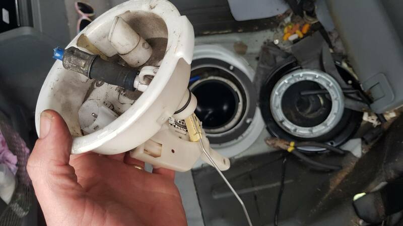

This is the left side sender unit.
I can't see how this works yet, what actually does the sending of fuel to the right side?
Anyway, we'll see

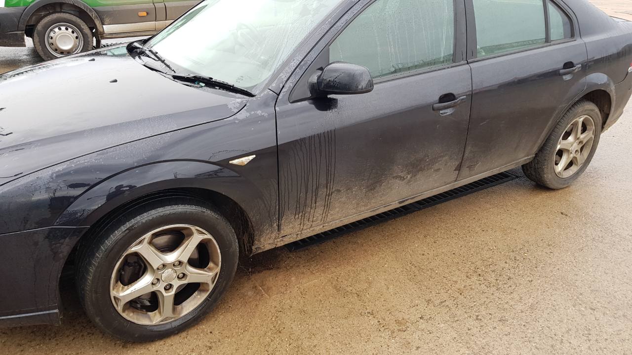

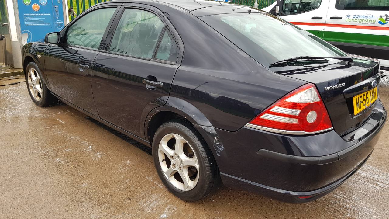

I wouldn't normally be posting that I've washed my car, though it is news I suppose.
But it's the first clean of the outside in my care so I get a chance to see all the chips and the little bits of surface rust that I want to (at some point) cover in rust proofer and black Hammerite.
Because the paint is metallic black it won't match exactly, but it will be close enough.
It turns out I missed a bit at usual 🤣

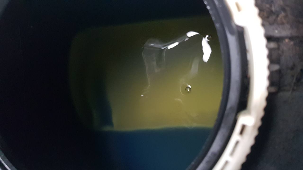

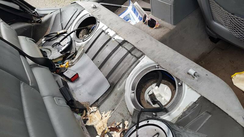

Progress on BMW. With a neighbour we managed to examine the left hand fuel tank sender.
Hands sent into full petrol tank (not my hands) and also petroly hoses were blown to make sure they are not blocked. That was me.
It turns out that there is no fuel in the left side, so I'm starting to wonder if the left side level reading is inaccurate. Hopefully putting a different albeit second hand sender might sort the issue out. I'm glad to say the issue does look like an inaccurate reading rather anything bigger, the car runs ok when there's enough fuel in. Funny, that.
So tomorrow I'll see if I can finish the job and take some pics.

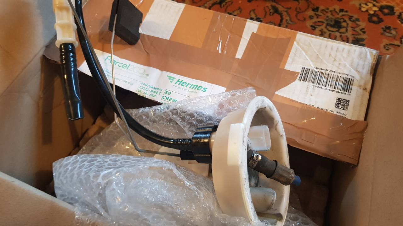

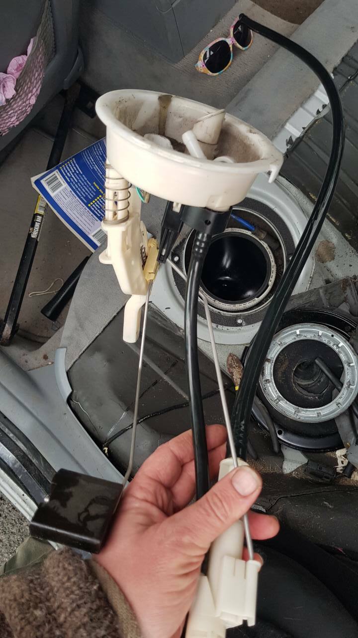

So, BMW fixing time. Today I ventured fourth on my own to attempt to get the old sender unhooked and the eBay second hand replacement in.
I had to get my hands in the petrol tank but after help yesterday understanding what's what in there with regards the pipes and the way it works (still not 100% on how the fuel gets drawn over the prop shaft tunnel, but at least I know where the pipe goes that supplies the bridge) I managed to get the old one out, find the easy way to get the preyss off. Believe it or not that is what has been baffling me.
Turns out that a few sleeps, a clear head and more time playing and poking supplied the answer.
So it's loosely back together, just need some jubilee clips after making sure it all works the way it should.
Now I need to loose some petrol...

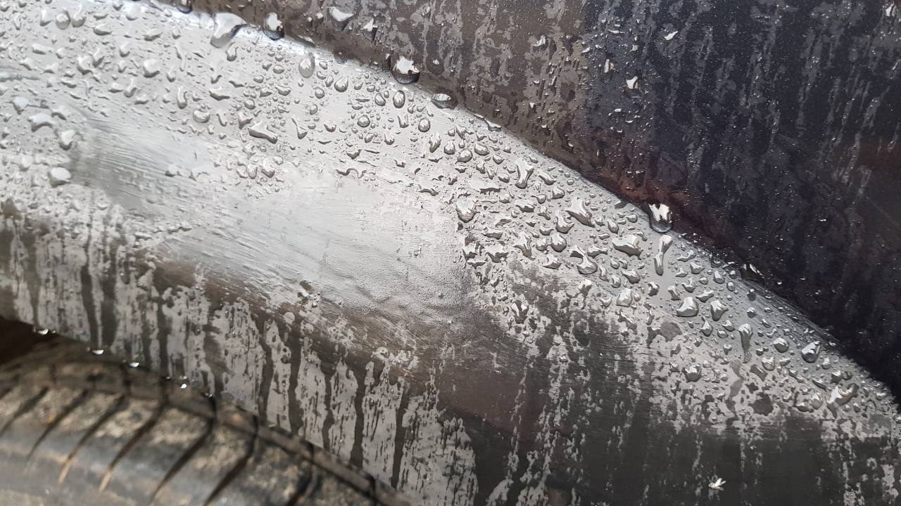

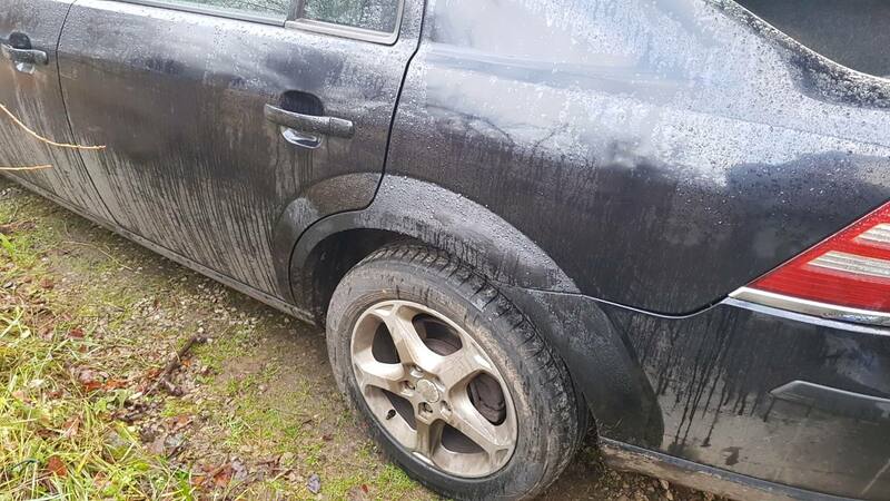

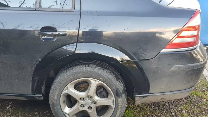

Probably about time I addressed one of the few remaining things on the snag list...
Surface rust along a scratch, coupled with bubbling de-lamination of paint from a previous repair.
First step: roughly clean area, sand back (with 80 grit only, can't find anything else). Then paint on some rust converting primer to suppress any rust that's still there.
This is not going to be a beautiful repair, I'm using the fact it's black to hide the scratches from the 80s and the thick brush strokes. 20201125_115207.thumb.jpg.77146ba5720dd63d6304b268b3dd77f3.jpg
  • Cord Fourteener changed the title to Tim's Generalistic Fleeting Phenomena - the painting game
Good enough, I think.
A bit of flatting and polishing wouldn't go amiss, but I think it'll do for now.
Predictably it's dried Matt grey rather than gloss black.
Which is fine, it matches the wet road silt spray.
And the metal is protected, objective #1 there sorted.
Maybe, if I'm bored on a sunny day or I get too annoyed when cleaning it I'll flat it and polish. It won't ever be perfect, but it might get better.
But for now I'm happy 👍

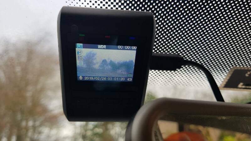

Fitted our Christmas present #1, a dash camera each. Done Wifey's car first, she commutes to the Wirral and back.
It's an Apeman C370, compact 1080 170° and all that kind of gubbins.
And hardwire kit so it's powered by OBD2 port, motion and G detection etc.
It's one of those things, I hope we never have to use it other than bad drivers lols but in case of a prang it's worth having.

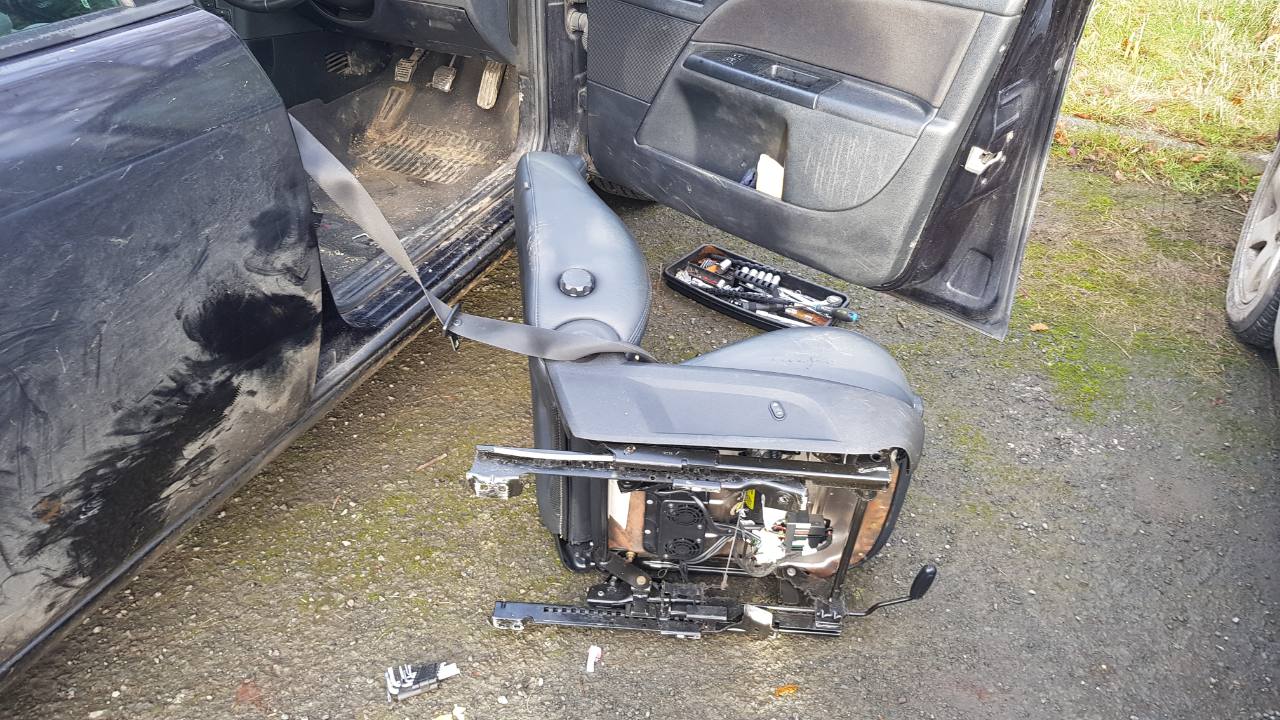

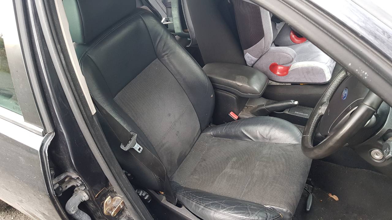

Seat is in!
It's so much better, the old seat was very broken, much more than the photo can show. This one is sweet! Passenger seat to go in another day.
I did strip a bolt hole thread putting one of the six bolts back in though, so I'm on 5 until I can do something about that.
Any ideas?
