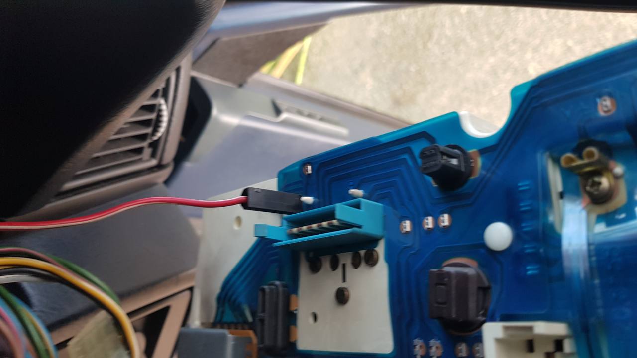

I had a poke behind the dash. Definitely one bulb was knackered so I moved one so I can see the rev counter (the only way I can guage my speed into I properly resolder the speedo). I think the PCB where the engine temperature guage bulb is might be a bit off-kilter.
All things to improve one day!

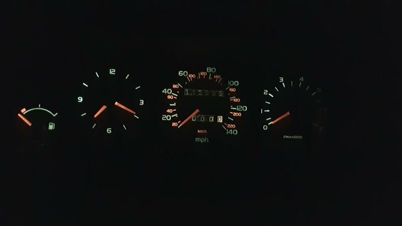

Improvement to night time drivability has happened.
Next to try and figure out the right hand light. Getting a working bulb will be a start but I think I need to look at the fitting. The bulb for the rev counter was in the very right most place before and there's something wrong with the socket or the PCB.

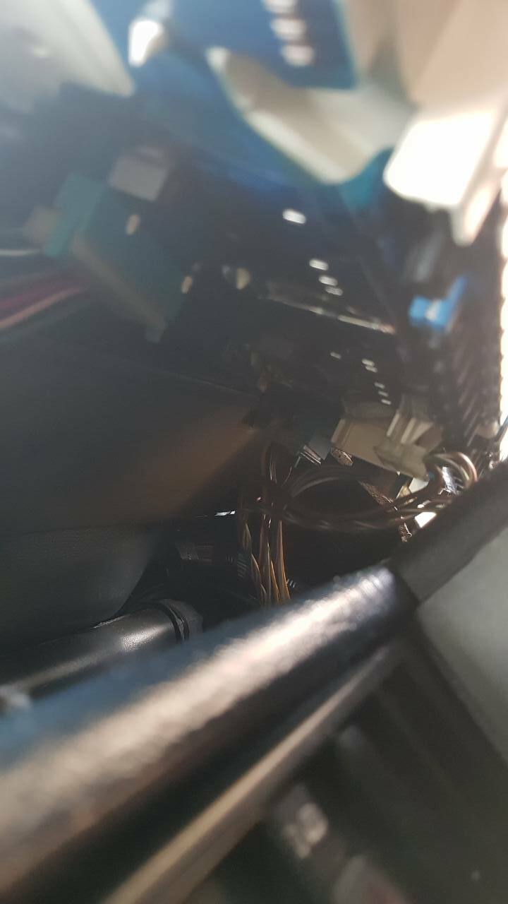

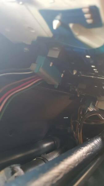

Latest:
I had the cluster out.
It's not the Japanese unit used on the later cars, mine is the German unit, the VDO unit.
So it means I can't just find the dry solder joints and re-float them for a quick fix.
It means I have to either fix or replace each individual broken guage, if that's possible. And check the various senders still work.
That's a job for another day!
I don't know why the temperature guage bulb didn't work, maybe a faulty PCB or just that it was a bad fit. A new bulb shall be had anyway, next week.

I've either broken the fuel guage completely (it was throwing junk numbers all over the place) or I've fixed it and I've managed to actually nearly run out of fuel... I've no idea how much fuel this car gets though! Even though I've been putting fuel in regularly...
I'll find out tomorrow.

It turns out the fuel guage is back to spraffing shite...
I have put wanted ads but if course every one wants them. Volvo quoted £defence budget each for the instruments and the headlight wiper parts I want. Hmmm
The only instruments I had working were the tach, clock and temperature gauge and nothing on the dash illuminates. Very occasionally the fuel gauge and speedo would briefly wake up, but I didn't tend to trust what they were telling me. The rest of the car worked so it didn't bother me.
Yes i have temperature guage, that's nice to see. I have tachometer, so I know how fast I'm going at least, I worked it out with GPS. Actually it's 2000rpm = gear x10 so it's quite intuitive.
The only thing is the fuel. I know I'm putting fuel in but I don't know how much I started with and how much it uses, nor do I know how many miles I've done so it's all guess work until I can spare the more than £70 to brim it, although with *some* fuel in who actually knows how much it will take.

I've discovered the fuel guage and speedo are a case of TADTS
I can live without them, I've been putting petrol in, car goes, all good.
If I ever want it to be the only 7/900 series in the world with fully functioning instruments I'll just have to pay Volvo the daft prices as second hand items are rare, it seems. Not impossible but rare. And there's about a hundred slightly different varieties used throughout the production life so another reason why second hand ones arn't always right.
