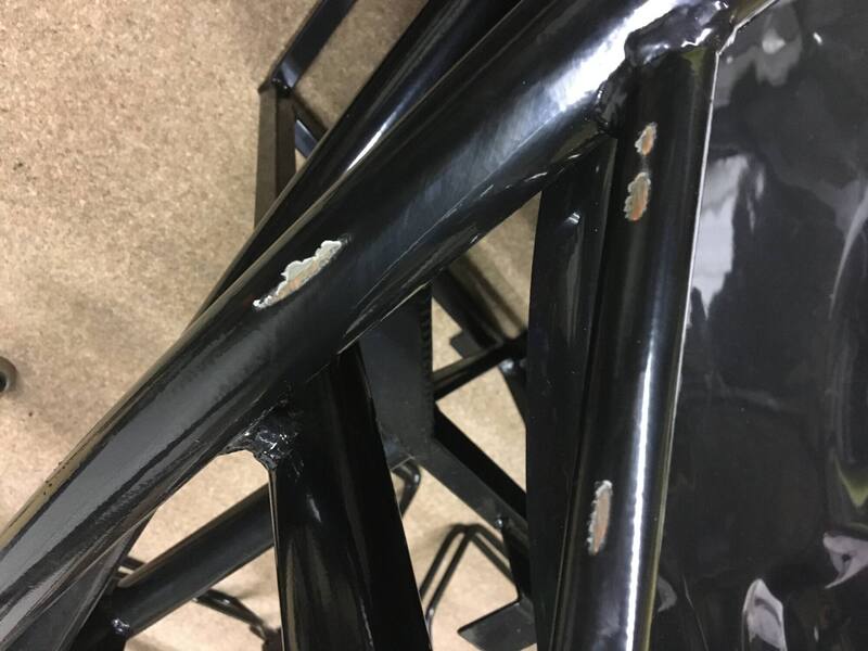

after a lot of effort, the vlsd is fitted to the mx5  but by this time I was really fed up, then it started pissing down and I was working outside. I got the mx5 down off the ramps (no exhaust fitted yet, sounds dreadful) and chucked the tools in the garage
went to shut the garage door and knocked over one of the ramps which couldn't just land on the floor, could it ?
on no, the little bastard took a chunk out of the freshly powder coated exo frame
I'm sure you can imagine just how angry I was at this point (the neighbours probably don't need to imagine)

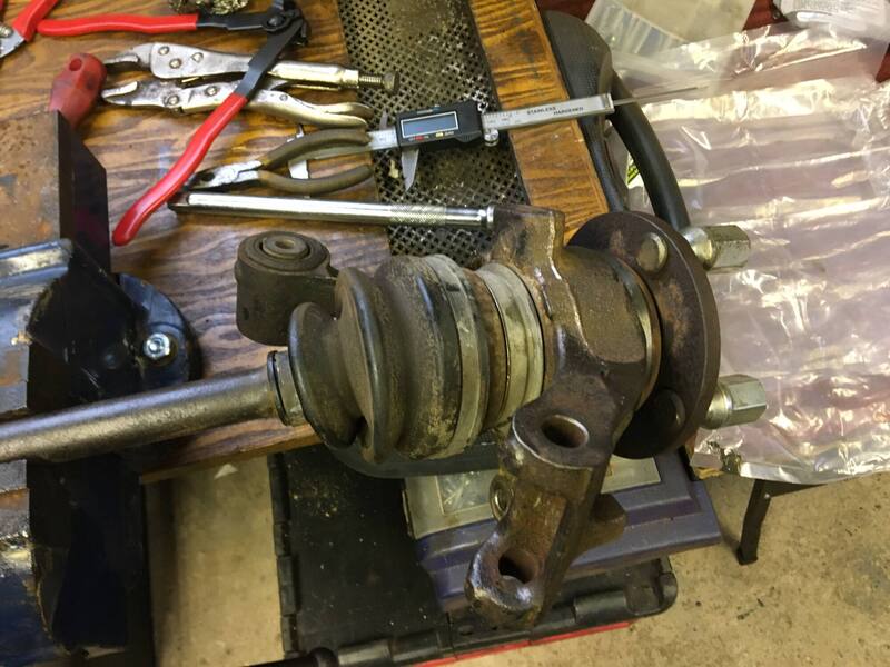

what I am needing for the exo is this
which I can replace with this
this is the one with the shaft that will not come out no matter how hard I hit it

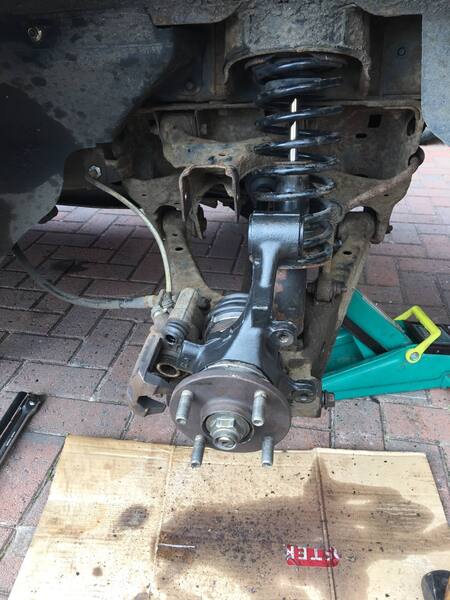

so up on jacks, wheel off etc
and fit the hub / shaft combo
and discover that I am a complete helmet and can't tell my right from my left :(
yes, I've just spend over an hour dismantling the wrong side of the car !
somehow managing to laugh it off I cracked on pulling the other side of the car apart (doing battle with the tightest bolts in the world - the notorious 'long bolt' which always seizes in place)

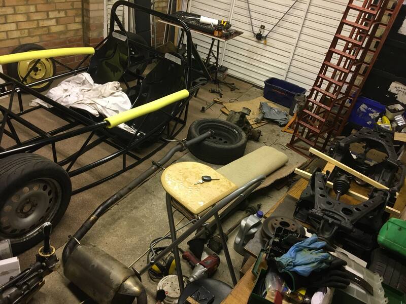

eventually it was all back together and I replaced the old asbo exhaust with a standard one I picked up a few weeks ago, even refitted the catalyst.
look, a pea shooter !
i took it for spin and it sounds normal terrible - maybe I'll stick an eBay cone filter on for a little bit of noise.
good news is that the viscous diff still works, doesn't lock up as well as the torsen did but can still kick the back end out on the roundabouts :)
so that's the mx5 pretty much back to standard now, ready for whenever I do decide to sell it.

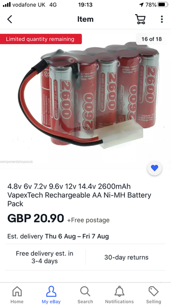

I’ve got some shiny new drill bits ready but the battery on the impact driver is knackered - shows fully charged but conks out after a couple of minutes. I’ve had it apart and reckon I can replace the individual cells so it will live on and come in handy I’m sure :)
