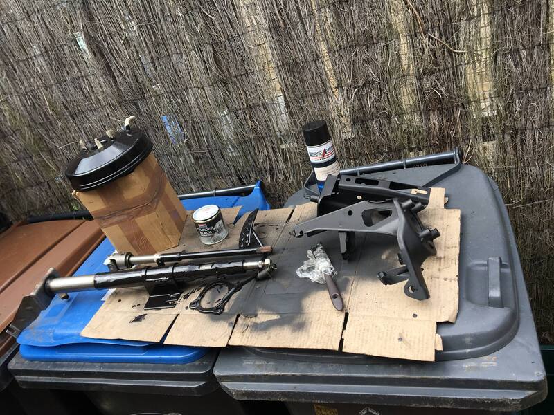

while i was covered in shit, it seemed sensible to replace the rubber boots on the upper ball joints
another job that required the use of a hammer and chisel, theres been a few of these recently
a 30mm socket and a g-clamp pushed the new (£9.90 each) rubber boot snugly into place
note : I had to touch up the omgsupertough chassis paint that I've chipped already :(
Top fettling. Had the paint fully cured. It doesn't bode well if it has.

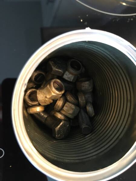

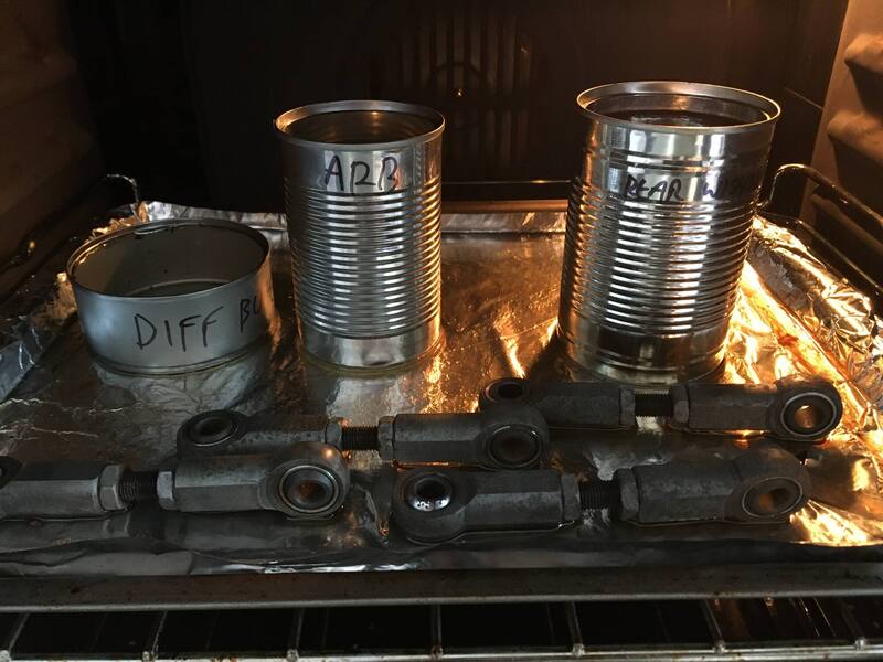

More misuse of kitchen appliances today

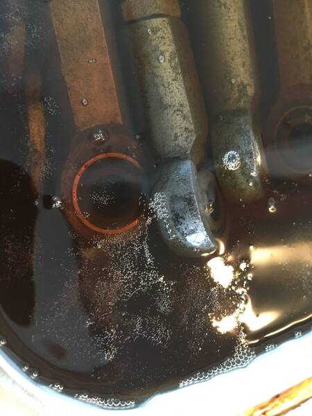

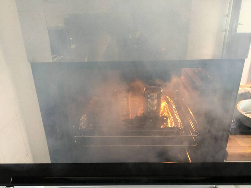

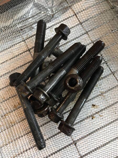

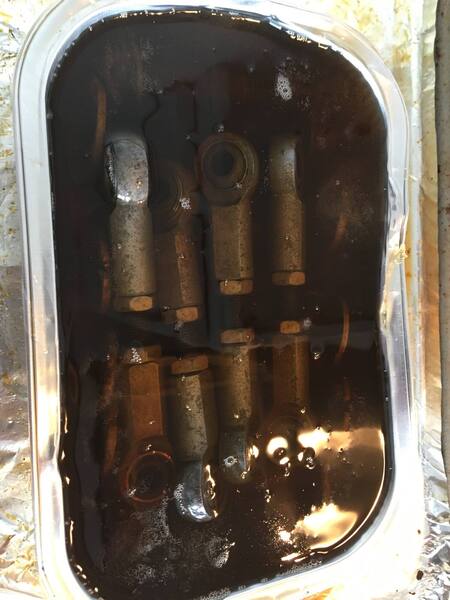

Probably an old wives tale but I'm sure I'd read somewhere something about hot oil being used as a form of corrosion prevention - heating up nuts n bolts then quenching them in oil or bathing them in a hot oil bath ?
I'm a bit bored so let's give it a go
yes, those are empty tin cans
fully synthetic !
15 minutes at 200oC
oh bolloocks !
fizzing away, must be something happening
mebbes a bit shinier ?
I've stuck the droplink and alignment bolts in for a good soak now

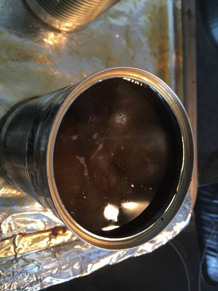

Top tip - don't use a tuna can, the buggers leak when they get hot !
smoke smoke fizz fizz etc
Results : inconclusive
Although there was a reasonable amount of crap in the bottom of the oil tray
I reckon that's a success! The joys of living alone ?
very true - the house is a bit fragrant just now ! I’ve buggered off to the garage instead :)
You're better heating them up directly, then quenching them in cold oil. Been doing the same myself with my camping stove, and the oil in a soup tin. Quicker, and much less smoky! Plus, I'm not doing it in the kitchen...

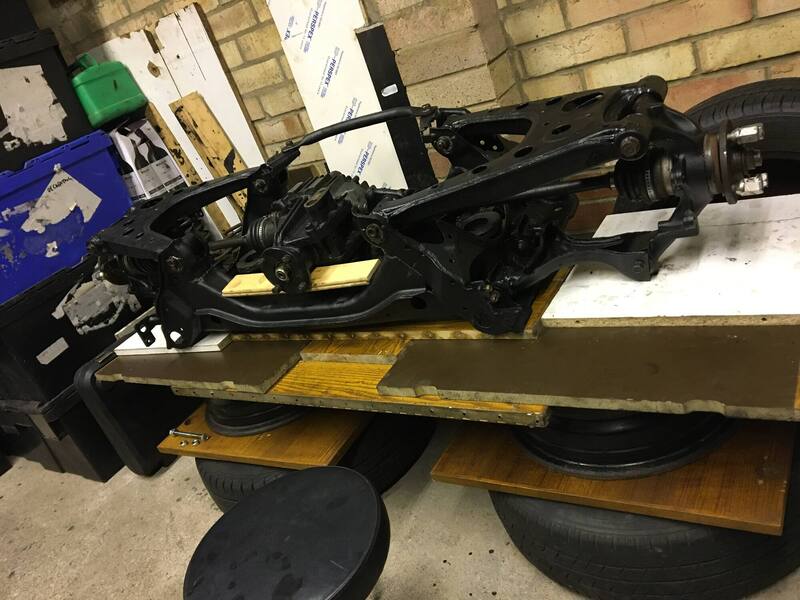

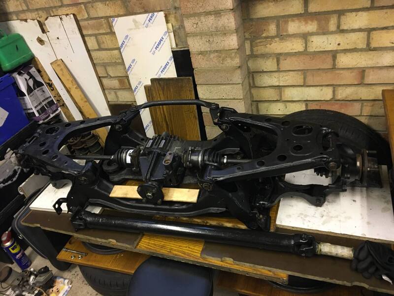

that is one complete* rear subframe, all built and torqued up
lets see it from another angle
and because I'm pretty pleased with myself, one more
(not really complete at all, the arb's need to go on, not to mention brakes and shock absorbers but I haven't even ordered them yet so that'll have to do for now)

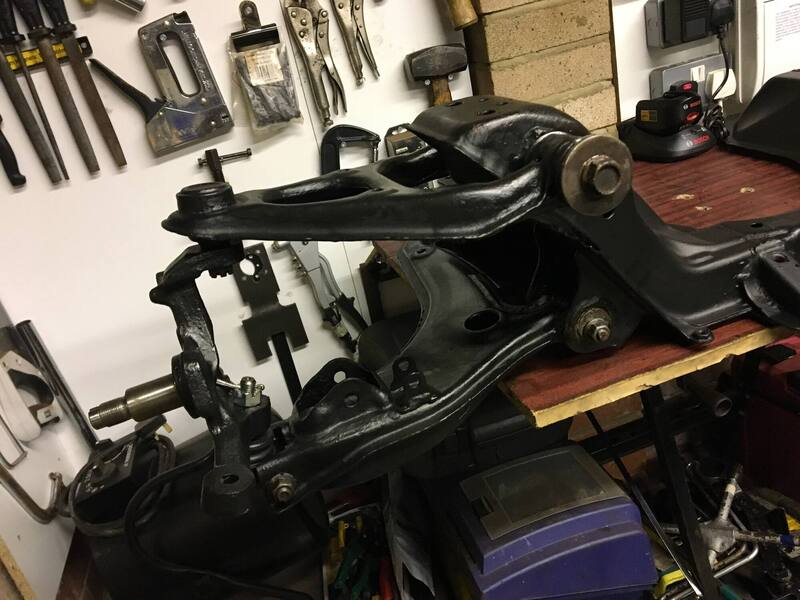

Another hour or two in garage gm this evening resulted in
front subframe coming together - it's so nice to be working on something that isn't all rusty and minging
but, lets have a closer look

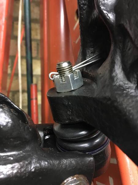

stupid modern castle nut is too wee :( that's not even tightened and the split pin is doing feck all. I still have the old ones so it's into the vinegar they go and we shall continue this in a day or two.

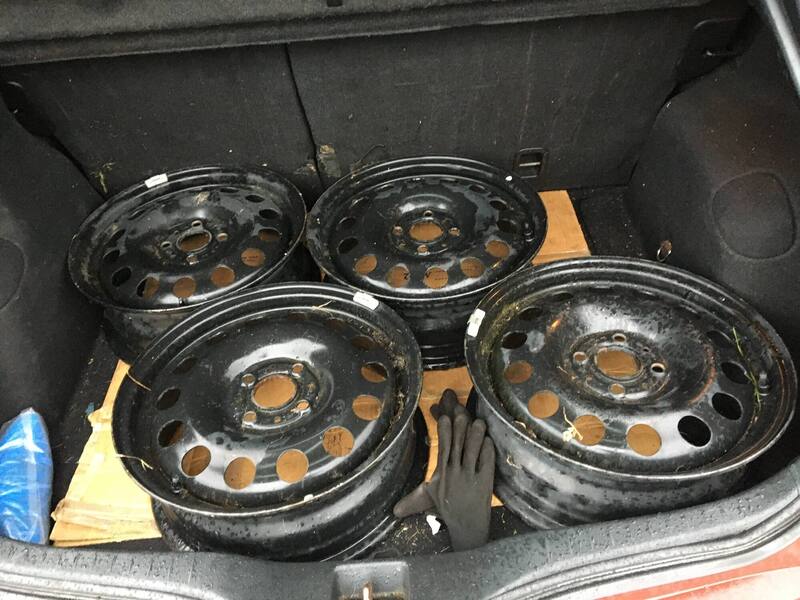

I also nipped out and picked up a set of steelies, I'm thinking a dark gunmetal grey sort of colour and proper fancy track tyres should look pretty smart
yes, that's a great idea, spend a wad of cash on tyres to roll around the garage getting filthy for months on end :)

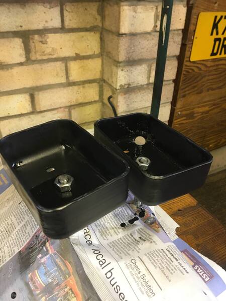

today started with a bit of painting
then I turned my attention to the front subframe - the old castle nuts had been relaxing overnight in the Sarsons, a quick wire wheel and oil quench and they were ready to fit.

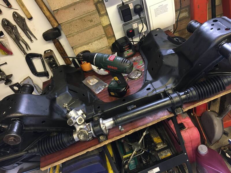

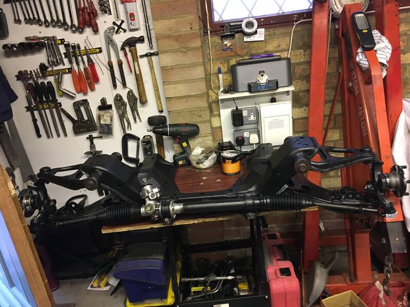

then it was time for the steering rack
no need to be tripping over that in the kitchen anymore
hubs were temporarily bolted on
and I had a go at the tracking
a bit pointless, but it will be interesting to see how far out it is when I'm finished.

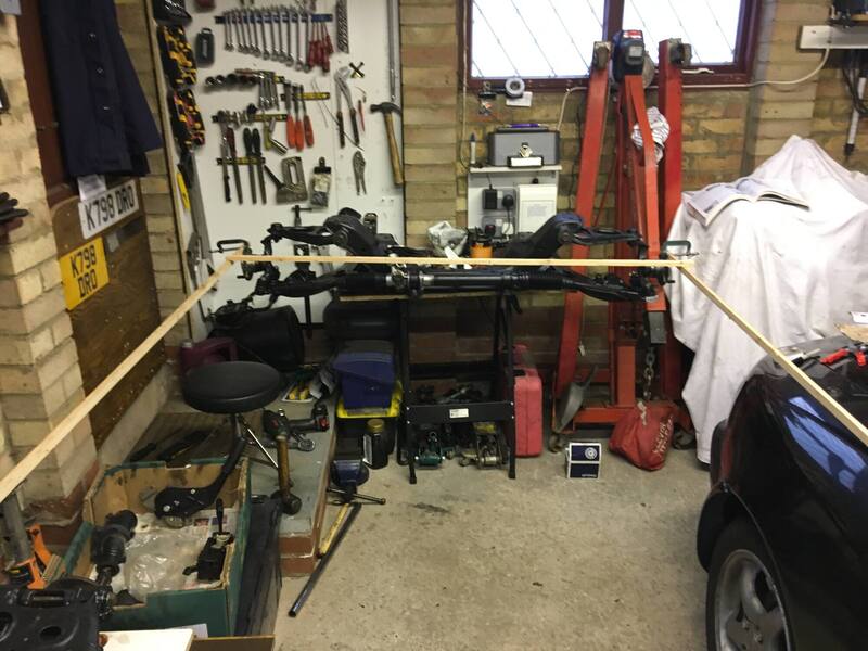

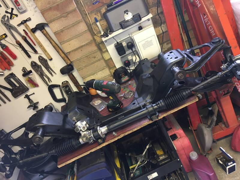

I'm starting to run out of space now

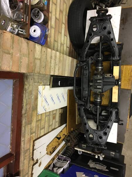

so we have a front assembly
a rear assembly

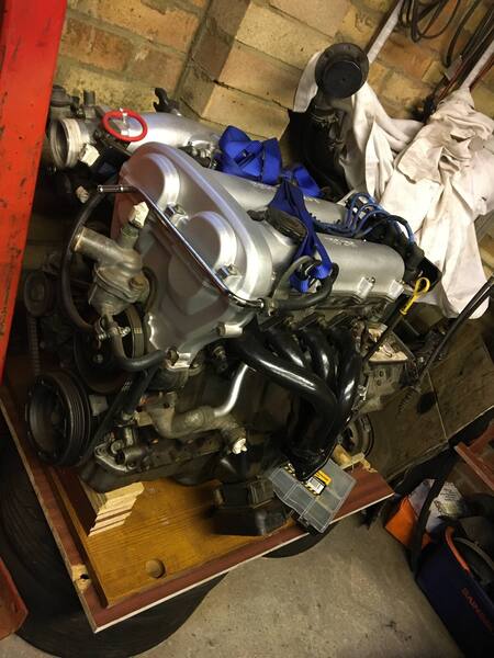

and an engine
all ready to put back together.

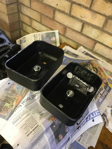

job one - a quick coat of sooper dooper chassis paint on the engine mount carriers
but wait a minute, let's have a closer look at the engine mounts themselves
Arsebiscuits ! I could have had them ordered last week and delivered by now. The other side is not quite as bad but no point in just changing one.

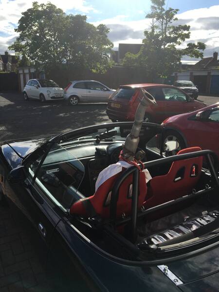

I went out and bought an exhaust instead - if the mx5 doesn’t sell as is, I’ll return it to standard and drop the price. If it does sell, this can go on the kit for the iva test.
got some odd looks on the way home :)
