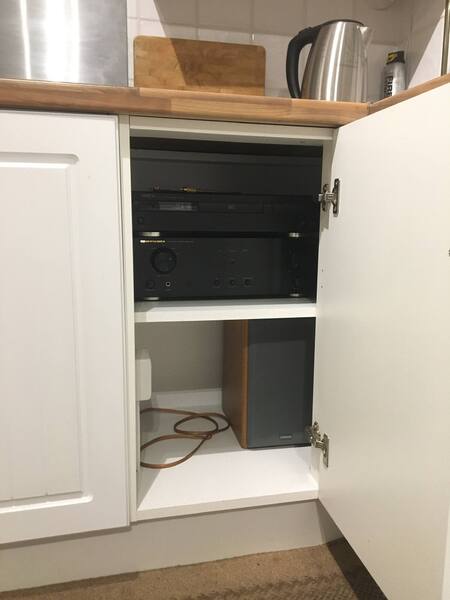

gm Posted July 21, 2020 Author Posted July 21, 2020 8 hours ago, paulplom said: 12 hours ago, gm said: i may be able to help you there Strange. I keep tomato soup, pot noodles and beans in my cupboard. maybe my garage is just very tidy ? (it is the kitchen, there’s a CD player and amp in another cupboard ) (edit) see ! Tickman and paulplom 1 1

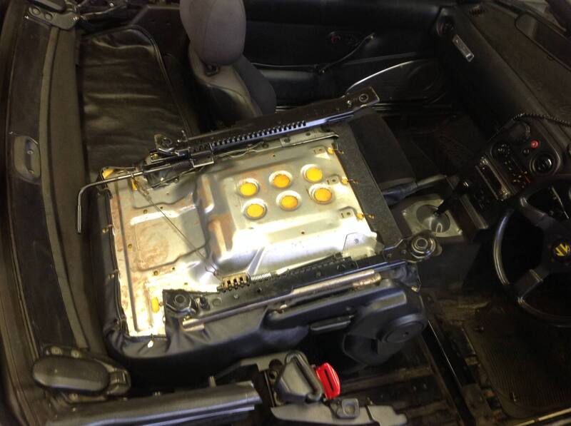

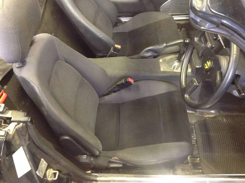

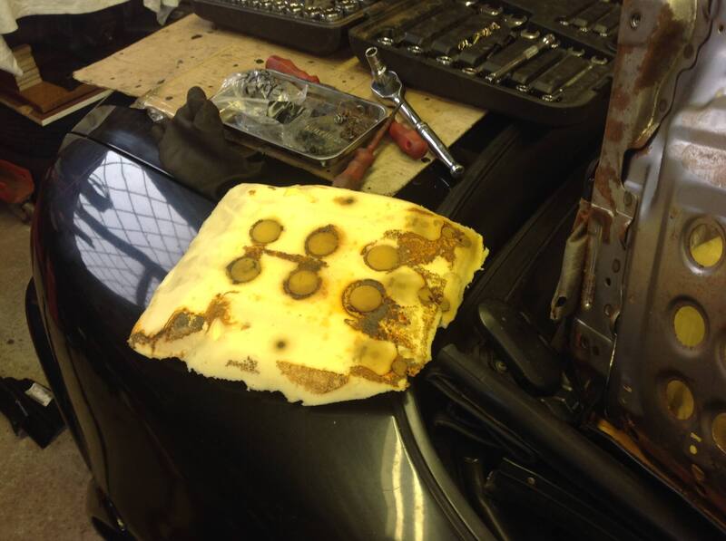

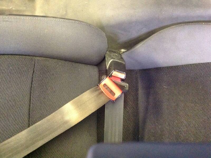

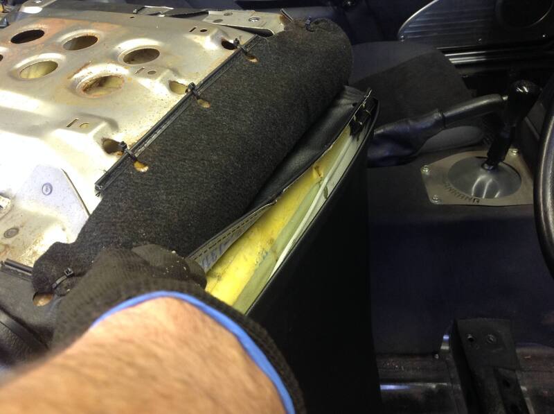

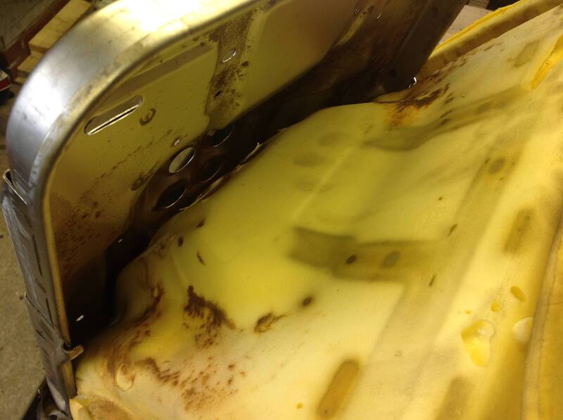

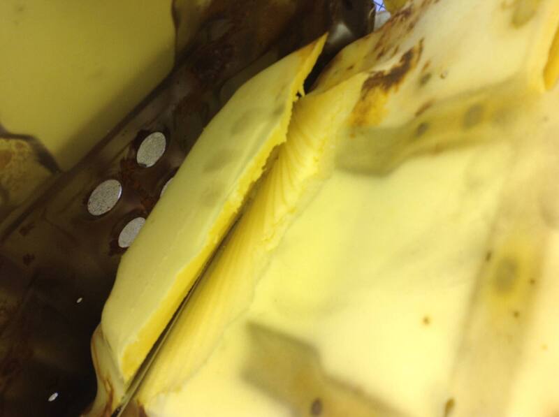

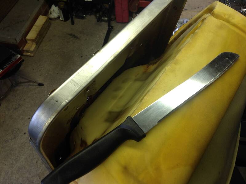

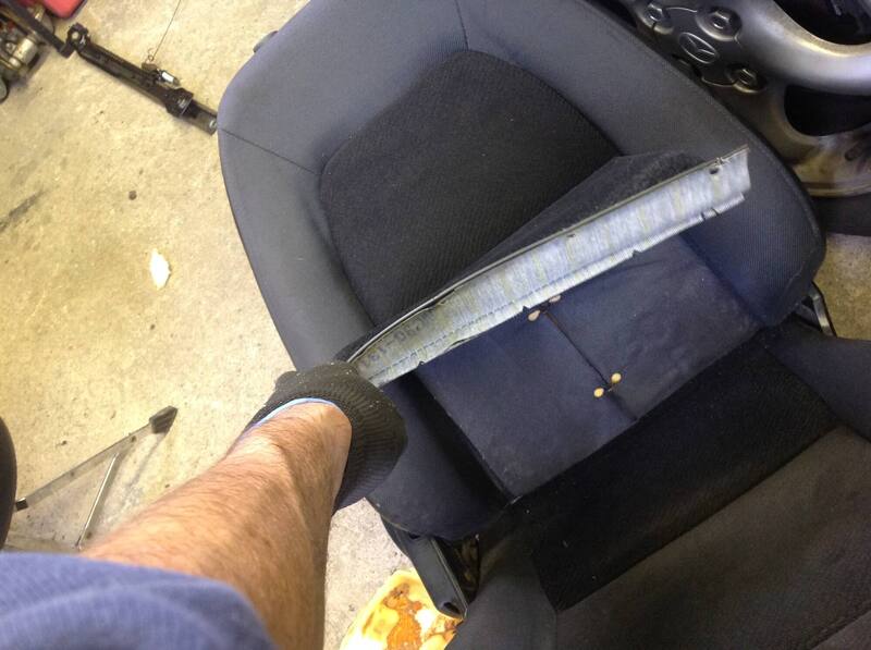

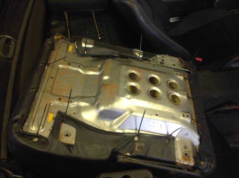

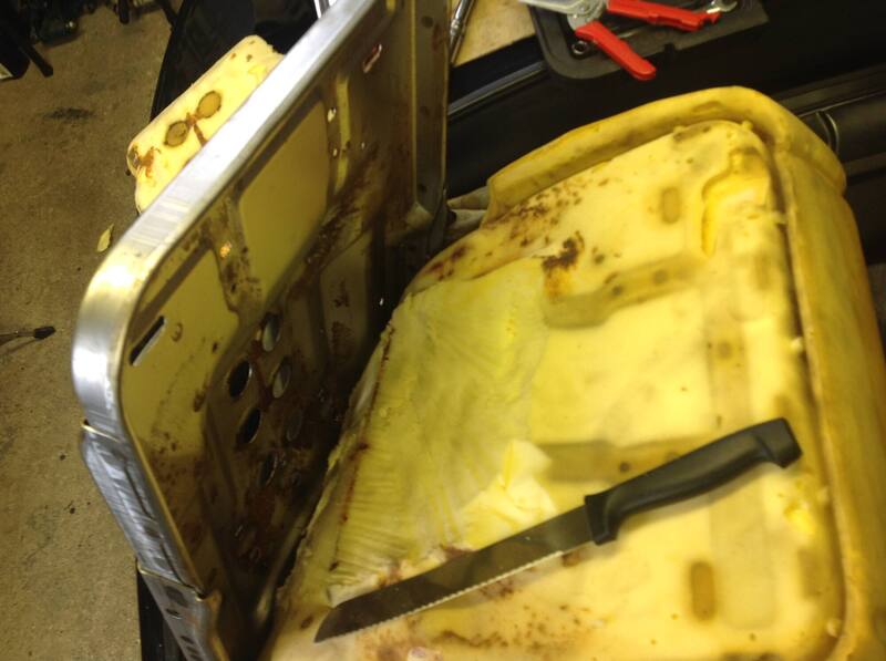

gm Posted July 22, 2020 Author Posted July 22, 2020 A bit more track day prep this morning : i did think about refitting the bucket seats but will do this one as a 'stock' mx5 but the comfy seats are just not up to it. Time for a "foamectomy" these seats belong in a late mk1 or mk2 car and do feel like you are sitting on rather than in them. four bolts out and flip it over another four bolts and the runners are off (six bolts for me as crappy later seats) ping off all of those rusty metal rings and peel the base cover back that big lump of foam is our target and we shall need to employ Mazda Special Service Tool #BRdKnF just like slicing a Hovis Don't dip this in your soup a quick tidy up cover back on and securely fixed in place look at all that space we've created if you have original mk1 seats (all in one backrest) then you can take things further ping off four more rings and fold the backrest flap towards the front of the seat lift the flap and you will see a 'swim float' size cushion that can be removed more cable tie action and it's ready to reassemble back in the car, can you see the difference ? nope, me either, but I am now sitting lower which surely means FASTER with my fancy* eBay belt lock, I'll be setting lap records nice easy mod, works best on mk1 seats but definitely worth doing on these too loserone, paulplom, Tickman and 3 others 5 1
