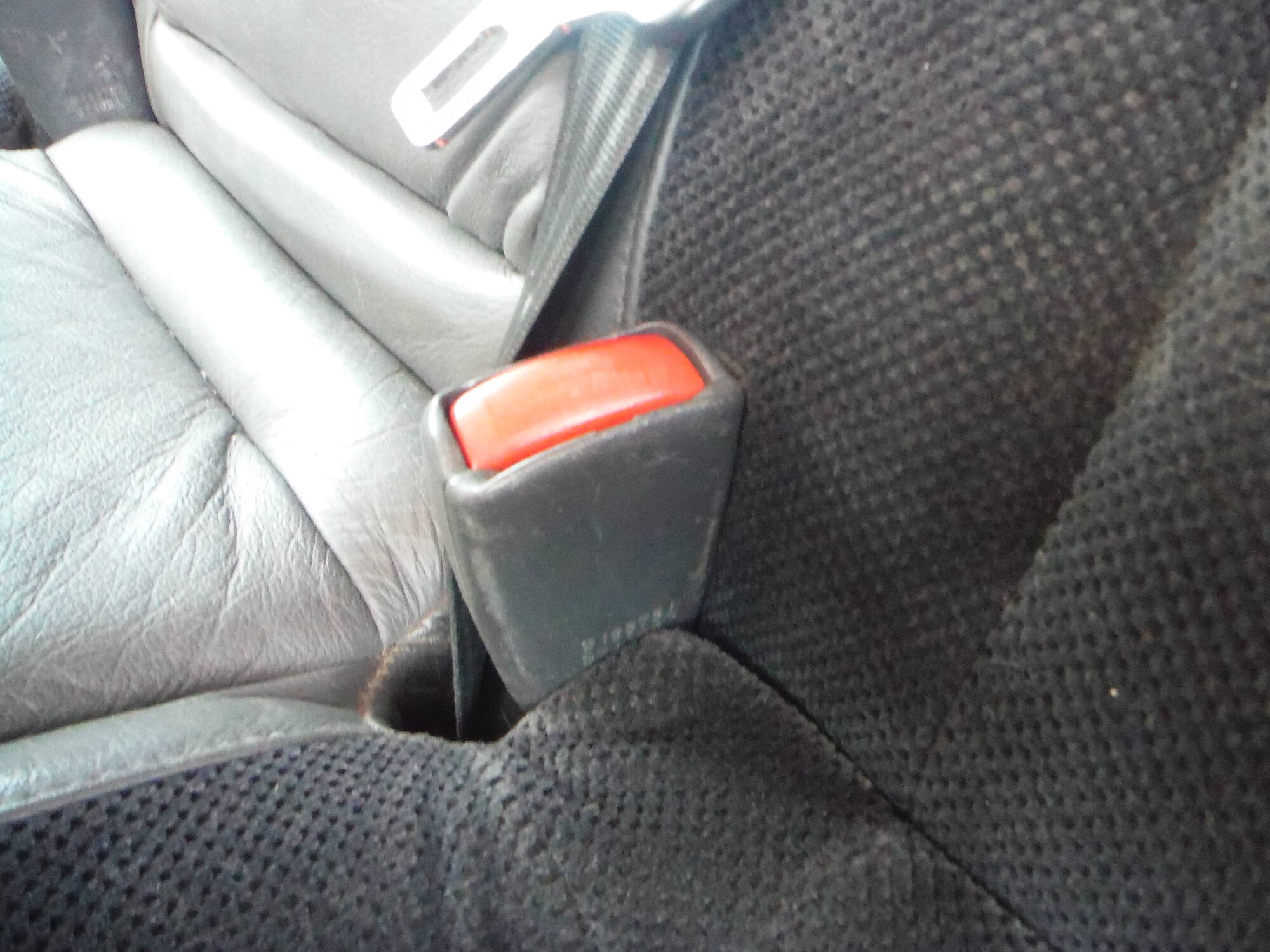

Replaced a broken rear seat belt socket. The two over the rear arches for the dicky seat are all smashed up too but at least they still work.

RE the seatbelt buttons, they pretty much all shatter due to the Volvos patented exploding plastics. If you can find any replacements, it's possible just to replace the red push button rather than the full thing so worth bearing that in mind.

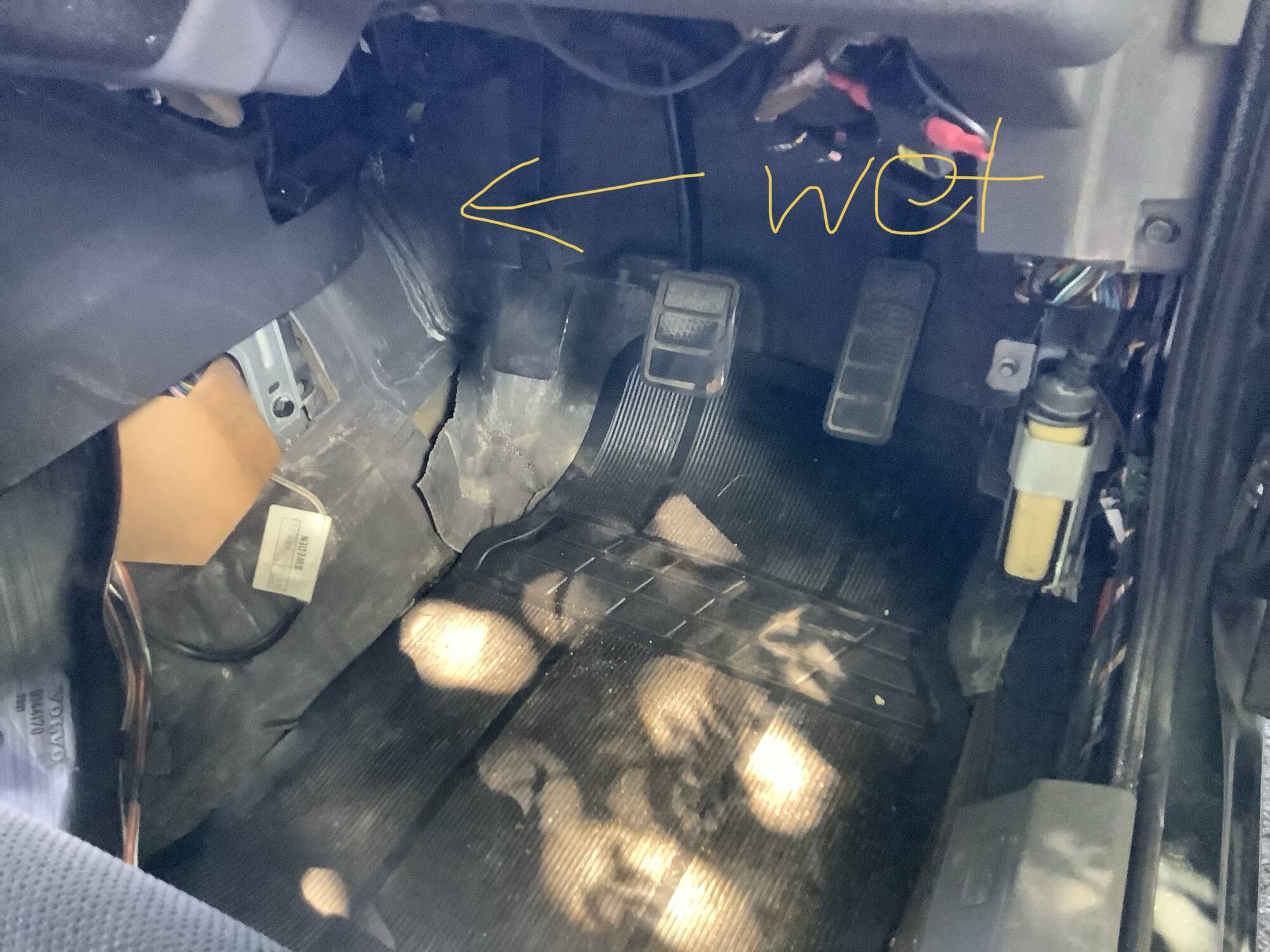

The main issue that made me decide to get shot is that it seems that the dampness is probably coolant after all. Appears to be coming from the air vents in the drivers footwell, and the voice of doom,is telling me it’s probably from the heater matrix as I think the valve is in the engine bay?
I noticed it in completely  dry weather while running about locally, so I’m fairly sure it’s not rain. Leaves white deposits when dried.
It’s not losing gallons of the stuff though, nor is it overheating or anything.

As above, don’t put any rad-weld type shit in it. Someone did that to mine in the past and completely blocked the heater matrix! Took a good bit of flushing with a hose to get it clear!

Seriously, it sounds grim but the dash bits come out very easily on these- Get stuck in man!

That does sound like it's coming from the heater. My old one suffered from it very slightly in normal use. After 5 runs up Shelsley Walsh with the boost turned up it turned into a fine jet of boiling coolant aimed at my left foot

It was uncomfortable at the time but in normal use I just had a bit of dampness. The tailgate got oily driving in the rain as well, but apart from being less than fluid-tight it was a lovely car that took a lot of abuse. Always have an eye out for another
