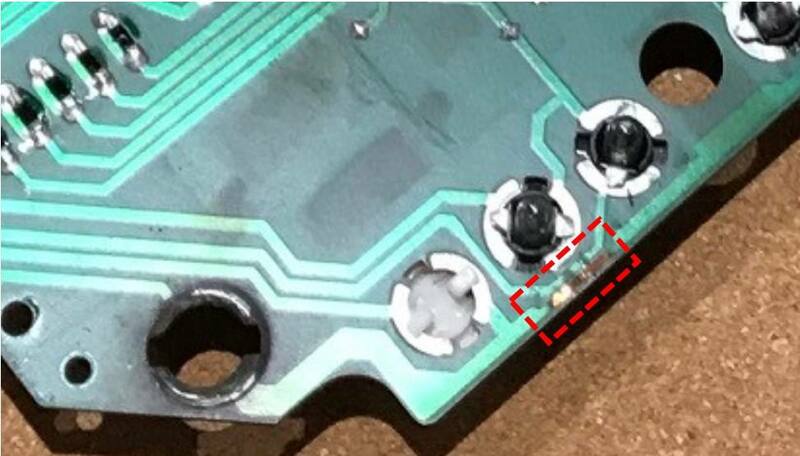

Volvo 480 - Electrical gremlins ad infinitum

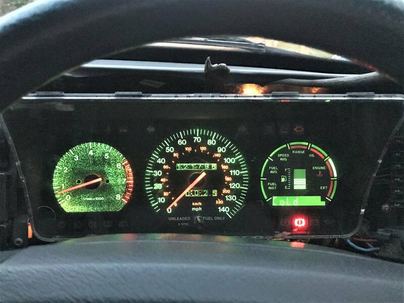

Using a car more means little details, like dash lighting, become more annoying. Especially as the fuel and temperatures are digital and invisible during the day. I’d tried to fix something I didn’t know was broken a few months ago when I had the binnacle PCB out to repair the odometer gears. There was a visibly broken track which I tried to bridge with solder but didn’t think much more of it.

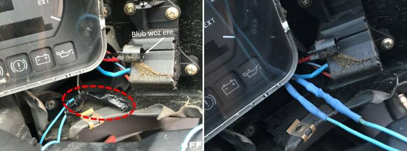

Also, I’d not really considered the fact one of the dash bulbs had its own “previous owner” wiring direct to the bulb. Anyway, long story short I was really happy to have repaired the ODO, but I was now blowing fuses if I asked the 480 to indicate while the lights were on. Indicators and dash lights are on the same circuit…
I thought about re-visiting the PCB again and seeing if I could do things properly, but as mentioned when I was doing the ODO fix, some previous owner had soldered the dials direct to the PCB, so separating it all risks further damage each time. These instruments are notoriously fragile, so I decided I should reinstate the previous bodge rather than risk losing other functions. What they’d done was pick up a bulb from the headlights switch and wired it into the binnacle from the back of the bulb.
I decided to replace the twisted together and taped connection with a more permanent solder and shrink wrap job as my token improvement.
With that, temporary success was declared, the Info Centre now lights up and I can see how much fuel I have!
I say temporary because although I can now see the fuel gauge, what it was telling me was complete poppycock. I was minding my own business driving around when I started to notice a droning from the rear somewhere that had been getting louder and louder. Sitting in traffic I started to think; is the aerial trying to pop-up? (motored aerial back there), maybe it’s the fuel pump? Then I thought about it and it’s been months since I filled up with petrol. Last year in fact. I continued to drive until I came across a petrol station without a great deal of fear as the tank was supposedly half full. I managed to fit over 63 Litres into a 60 Litre tank, so I’m thinking I came quite close to running out there 🤣
I’ve since done about 400 miles and after 300 the tank was showing half full again and It only took 30 litres to fill up – so this may have fixed itself. I’m thinking having had the dash in and out it needed to calibrate itself somehow and a nice brim job seemed to fix that.
Despite the potential self-fix there, I still maintain temporarily fixed because during those 400 miles the Info Centre has gone completely blank twice, leaving me with no indication of fuel. In its defence it has come back to life both times seemingly as randomly as it died, but still, my trip is now my fuel gauge.

Hey. You can check the calibration of the fuel tank by brimming the fuel tank, switching the Info Centre to either “Range” or “Fuel Average”, holding the grey button on the Info Centre switch and switching the ignition on.
(FYI one position displays the Litres and the other the resistance of the fuel tank sender).
You can adjust the figure with a little screwdriver adjusting the potentiometer between the two grey buttons on the Info Centre switch.
In theory, you can pull the potentiometer blank out with a pin but I’ve never managed it as always have to disassemble the switch first. You may be lucky though!

What do you know about the Info Centre temp gauge? I’m always reading “Cold” now. The engine cooling fan cuts in when seems sensible, but if it’s like other digital systems I guess it has one sensor for the engine and another for the dash?  It did read temps last year but I know how fragile these Info Centres can be... Oil temp  is working, so I’m not blind, but I’d like to get the coolant temp to display too if I can.
You are right, the engine has different sensors for temperature depending on what is being fed:
- to the engine ECU (under the No. 1 spark plug, distributor cap end). This will have a blue two wire plug on your car. This will not be your problem as you say it is running fine.
- to the Info Centre, near the thermostat. If it is disconnected, it will say “Cold” so you may have an easy win here if you find it and plug it back in! Im told if you short the pin to ground it will say “STOP!” and that you can test it with a 68 Ohm resistor to ground to display 100 deg. C to check the wiring. This is just a single pin connector.

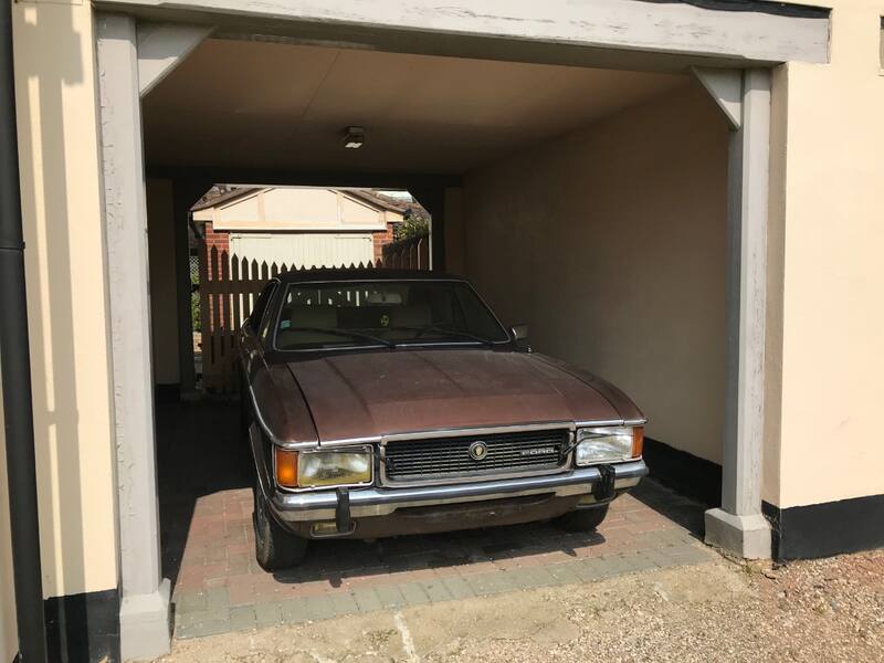

I did a buy!
Harrison's History #49 - Ford Granada, 336 PR 87 (mais oui!)
I've just achieved my primary car-life goal and bought myself a brown mk1 Granada. I didn't really think I would ever get to own one, but I took the plunge when just the right level of grot showed up. After 15 years of having eBay notifications set for "Granada", I can finally delete it. Stick a fork in me, I'm done.
No collection thread for this one - delivery was included in the sale. How could I refuse! It’s home already 😀
