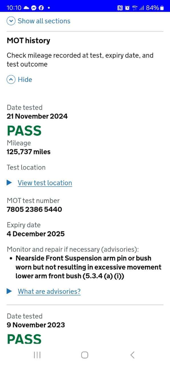

Cookiesouwest Posted November 21, 2024 Author Posted November 21, 2024 So CRV was presented for MOT at 9am. It seems as though you don't actually need a shock top mount to pass ! Garage now sorting the suspension and checking if the AWD system actually works. dome, Wibble, straightSix and 14 others 13 1 3
Cookiesouwest Posted November 21, 2024 Author Posted November 21, 2024 It also turns out that the shock bolt at the bottom was sheared. Still passed mot though. Gotta love a blind MOT tester New shock and top mount fitted. Picking it up, later today. andyberg, Marshall2810, Fat_Pirate and 1 other 4
Sunny Jim Posted November 21, 2024 Posted November 21, 2024 Whilst this is good news I'd be a bit concerned about what else they might have missed. andyberg 1
Tickman Posted November 21, 2024 Posted November 21, 2024 I'm assuming that the tester knew the shock mount and stuff was getting swapped before it went on the road. Still wrong obviously but possibly why. Joey spud and Sunny Jim 1 1
Sunny Jim Posted November 21, 2024 Posted November 21, 2024 Ah, that probably makes more sense than my glass half full interpretation.
Cookiesouwest Posted November 21, 2024 Author Posted November 21, 2024 I have now spoken to the mechanic. Weirdly, when using the prybar to test the bushes and bottom of the shock, there was no play. None. Despite the bottom shock bolt being sheared. This is why it passed the MOT, plus you can't see the top of the shock as its internal to the body. So I was being a bit harsh, calling the MOT tester blind. I was surprised as the MOT garage is not noted for being kind. My mechanic thinks its one of the weirdest things he's ever seen. Even though he knew why I had booked it in, he didn't believe me, until he started taking it all apart. Also this is a 2wd CRV. Officially, rather than suspected. Power is going to the rears, they are turning, until you apply any force. One finger can stop the rear wheel from turning. So the inner workings of the diff (LSD ?) clearly knackered. Oh well, its not like snow is forecast Will have to use the RWD merc instead. Sunny Jim and Datsuncog 2

Cookiesouwest Posted January 6 Author Posted January 6 The BFG has another year's motoring to look forward too. I will get the advisories sorted, when it goes back in for engine mounts. mk2_craig, Snake Charmer, Popsicle and 8 others 10 1
andyberg Posted January 6 Posted January 6 13 minutes ago, Cookiesouwest said: The BFG has another year's motoring to look forward too. I will get the advisories sorted, when it goes back in for engine mounts. Fantastic result chap. Easy peasy advisories too 👍 Cookiesouwest 1

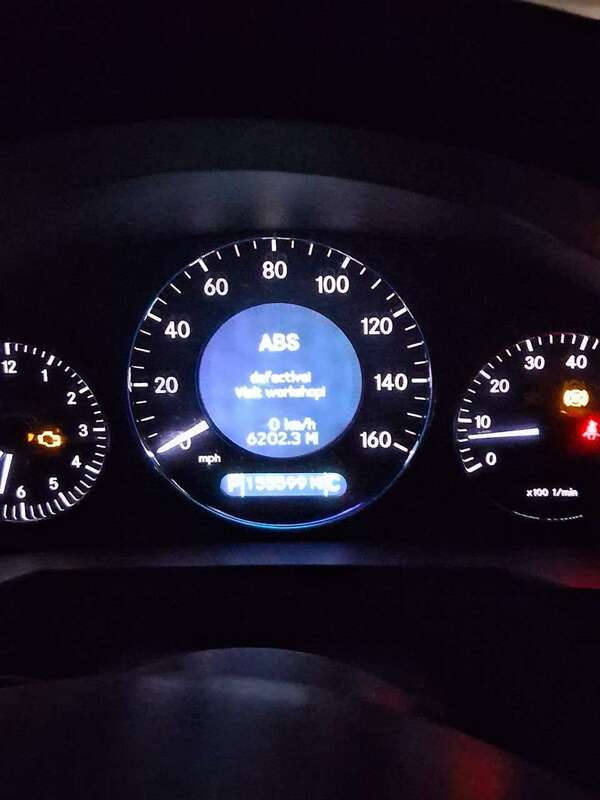

Cookiesouwest Posted February 26 Author Posted February 26 BFG has slightly disgraced herself this evening. ABS / ESP warnings and EML on. Can I find my Merc code reader? Can I fuck lol I'm hoping it's either it not liking a weak battery ala LR products or a wheel sensor. It's timing sucks. Meant to be heading to Hexham for a week on the 8th March. BFG is really comfortable for Mrs Cookie. The heated bum and back warmers, definitely help with her disability. Won't get it in anywhere before then, unless very lucky. Oh well, it's an excuse to buy another merc SiC 1
SiC Posted February 26 Posted February 26 2 hours ago, Cookiesouwest said: Can I find my Merc code reader? Can I fuck lol You didn't put it in the glove box or in a boot storage as somewhere sensible for it to stay with the car did you? 😀 Cookiesouwest 1
SiC Posted February 26 Posted February 26 If you can't find it, you're welcome around here to plug into my Foxwell NT680Pro for a scan. 🤞 It's just a wheel speed sensor. Cookiesouwest 1
