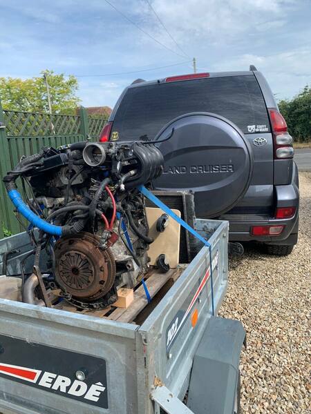

I also managed to (sort of) get the trailer working. Meaning I could shift the engine to storage.
The engine didn’t stay that way for very long, and it wasn’t until the oil pooled in the trailer did I realise I hadn’t drained it like I thought I had. A pure mess.

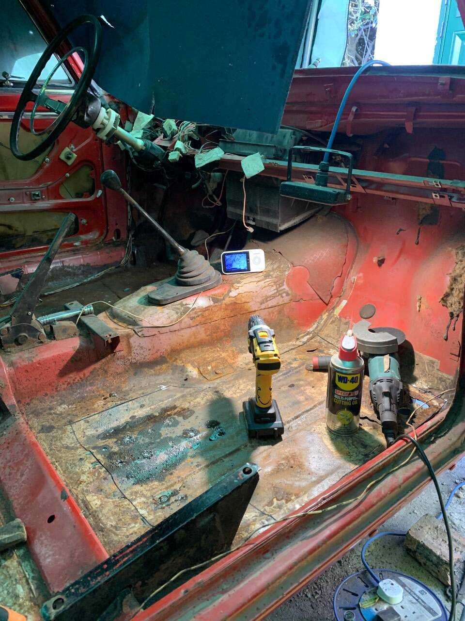

Took at it with a hammer and a screwdriver today. I managed to put a hole in it and nearly put it through two other places. So I’m taking most of the pan out.
Yes, that’s a baby monitor. My wife decided to go out and said if he cried I had to go in. I’m covered in muck and oil, by the time I cleaned to go and pick him up she’d be back. But he slept all the way through.

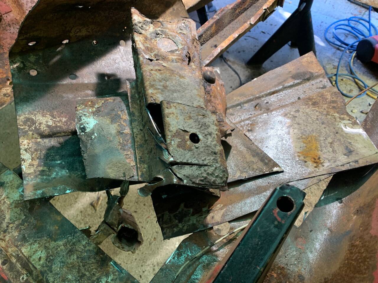

There is the floor gone. You can tell at the bottom where I did my best to drill out the spot welds, but further along it was harder to find them amongst the pitting. So I just chiselled them from underneath in the end.
Some bits of the floor were thicker than others. The jacking point and arm were totally gone, but we knew this anyway.

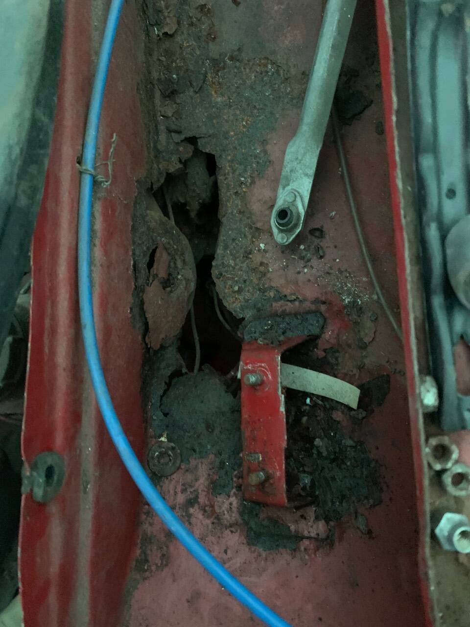

Had 20 minutes this evening so decided to investigate the hole under the wiper motor.
It’s a devil to remove if you’ve not read the instructions. But I got the motor out.
That hole goes straight in to the cabin, right over the steering column. I can imagine that this scuttle will need a good bit of attention when I get round to it.

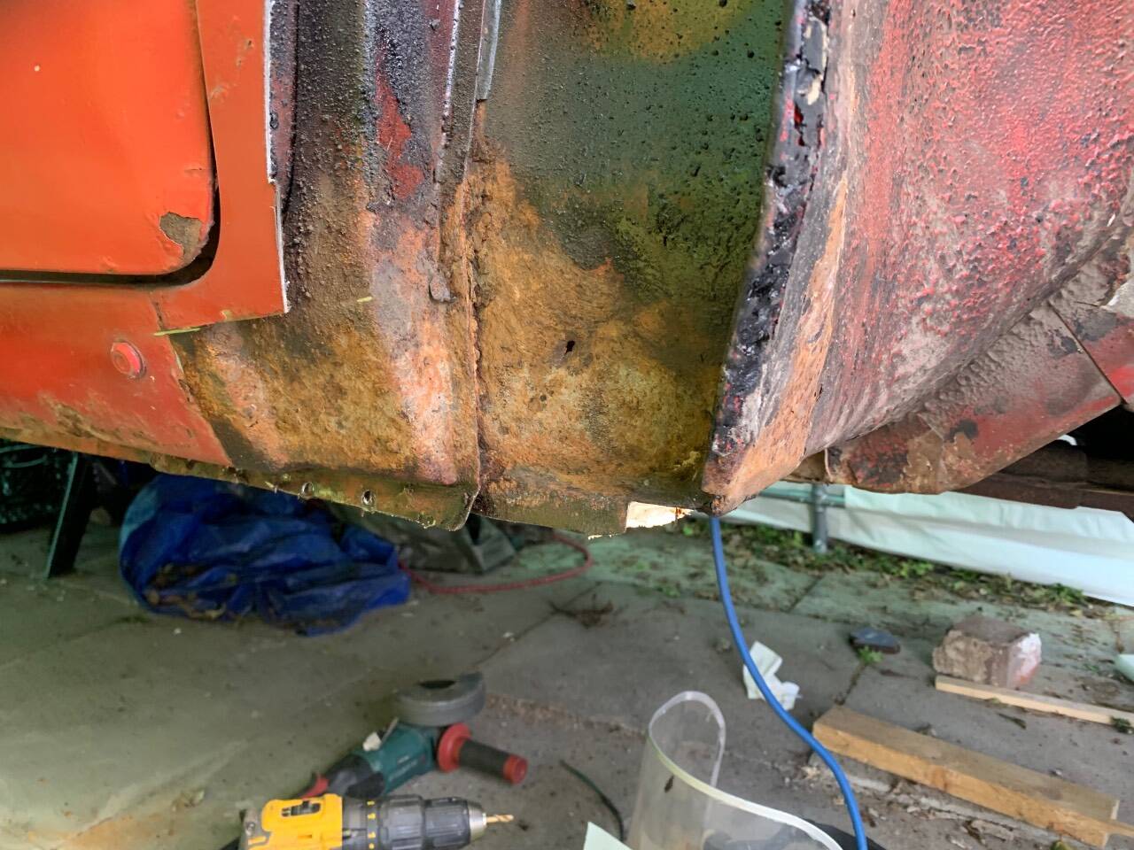

I did no welding today. Not for the want of trying. In a quest to tidy the area up and sort out the rust I found yesterday - well I found more.
At the foot of the A pillar it was thick with muck. A good 3” block of it.
Given I have to put a new outer sill on, I thought I would just take the whole bottom of the wing off.
I was cleaning up the inside sill stuff and I gave that rusty bit a tap with the chisel. No hammer, just me…
Oh dear.
Yeah all of this needs to go.

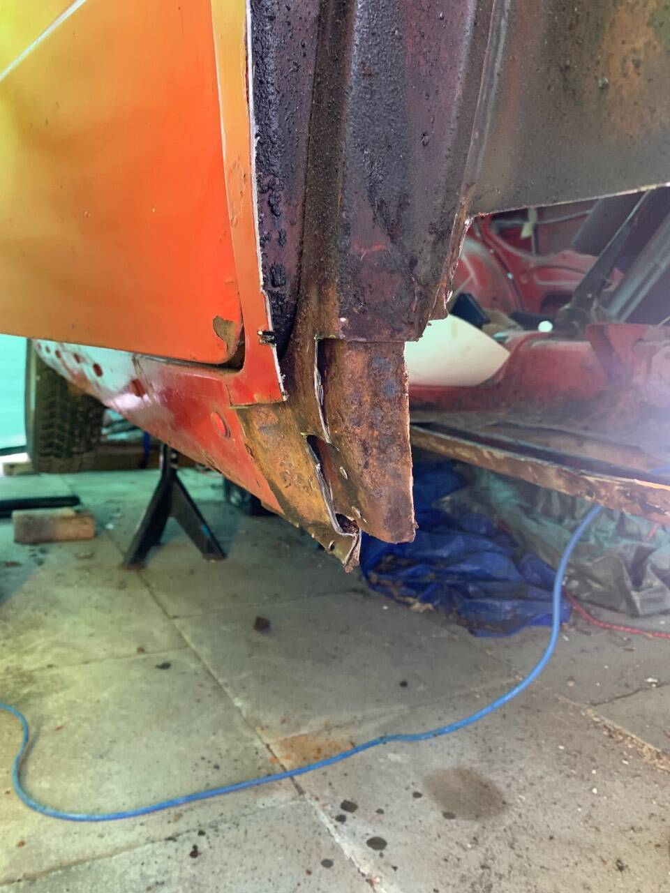

Not all finished with rust discovery though. The bottom of the A pillar was equally rotten.
Thankfully, this covered more steel which was rusted BUT only rusted where you see it. I cut more of the skin off to see.
As you can see in Australia, this is how it looks. But the inside part is strong.
I have cut back more of the interior sill because I suspected the inner sill was rotten. It was, but only really where the A pillar meets it.IMG_5572.jpeg.800db592a1d632364574d2caea857c4a.jpeg

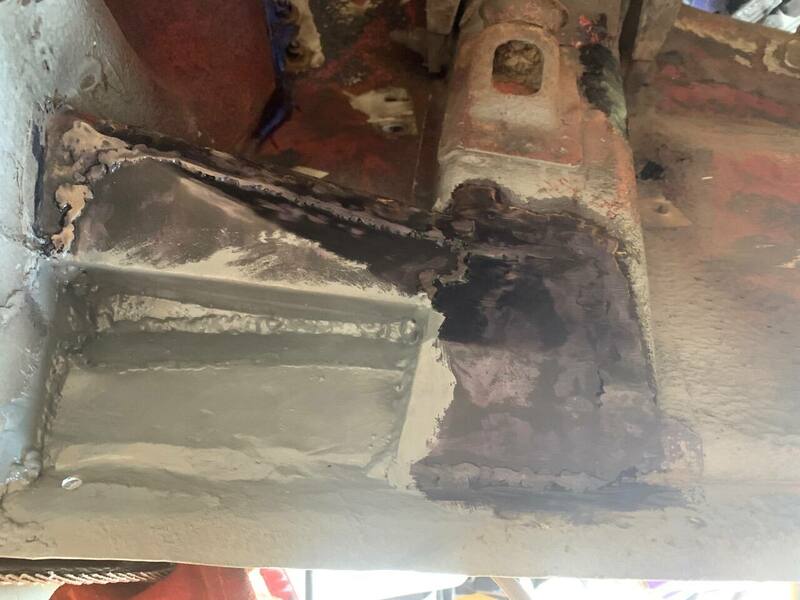

Worked all day on this yesterday and doing the same again today.
Yesterday was spent just fettling the replacement part of the sill. The, I think, inside sill. This welds to the floor pan, but also goes up to the wheel arch. That’s now in, and that meant I could fit the chassis arm and jacking point.
Before doing that I had to do some cleaning on the chassis rail, replacing bits of it that came off or I drilled through when I removed the floor.
It wasn’t until I put the arm back on to the car did I realise I made a mistake.
These do not have holes in them, those holes I drilled in to it myself. The mistake I made was that I was intending to weld the floor on to this from above. So I didn’t need to put holes in this, the holes should’ve gone on the floor.
So I’ll have to put the holes inbetween those holes as well.

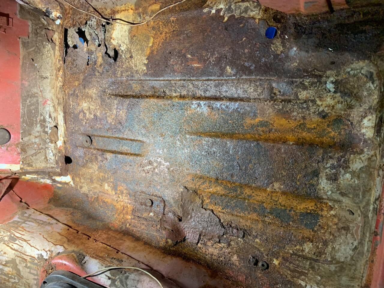

So, I have a floor.
Usual caveats apply: some places I blew through the steel so had to mend it.
I have an issue with the floor being high towards the arch, which means there are too big of a gap between the floor and the chassis rail and arm. I need to hammer it down, but I ran out of time.
I need to go back under it and redo some welding I did today. The moment a hole was blown I lost rythmn and ended up with a horrible weld. A quarter of what I did underneath was like that. I am considering a rotisserie now, but I think other than redoing the drivers floor side and the underside of the fuel tank/spare wheel wells, I’m not sure if I’d get a proper benefit out of it.
