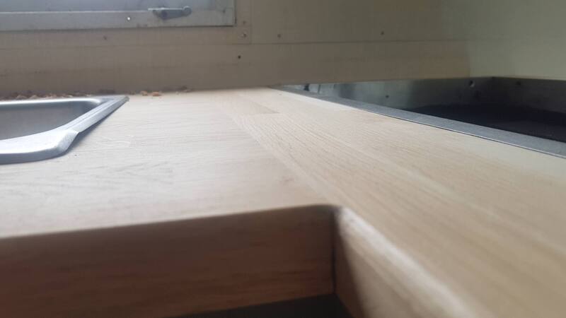

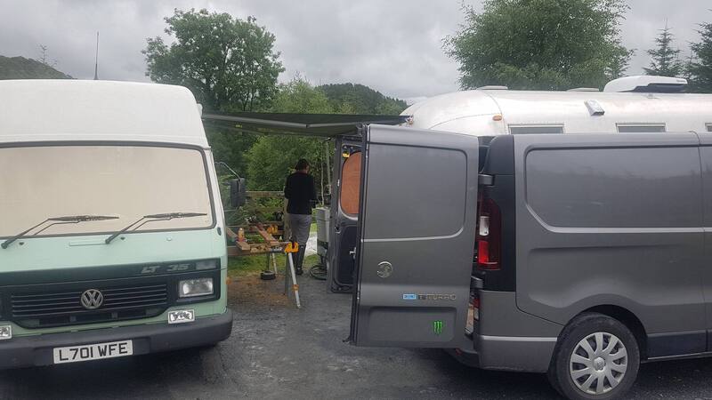

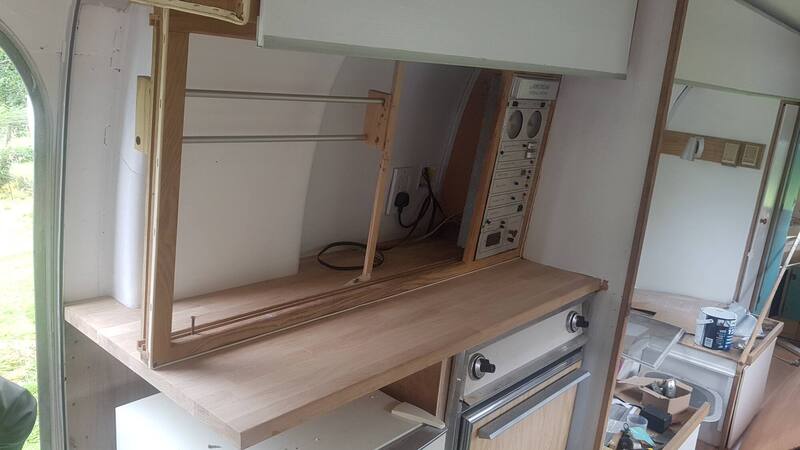

mat_the_cat Posted July 25, 2020 Author Posted July 25, 2020 OK, some positivity at least with the Airstream itself. A mate of mate is a chippy, and had agreed to come out and fit some new worktops for us. I wanted a neater job than I'd probably be able to do! We had a bit of a wait (not helped by the gearbox on his 16k mile Vivaro going pop!) but today he came over to sort it. The weather was predictably Welsh, so the LT was pressed into action to keep the rain off. I need to put the plywood end panel back on, but it's starting to look really nice inside now: The sink and hob section was made from two pieces, which were biscuit jointed together. Yep, I think he's done this before One of the offcuts was turned into an extra piece of worktop space, as there isn't really much otherwise. UltraWomble, Tickman, Mrs6C and 13 others 16

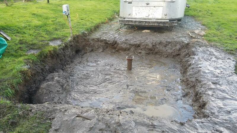

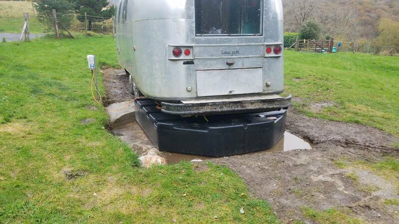

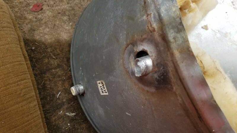

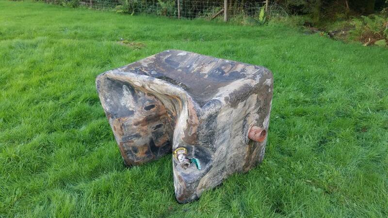

mat_the_cat Posted November 7, 2020 Author Posted November 7, 2020 It's been a while since the last update, but progress has been made! Remember the septic tank saga? Well, it turned out that even when encased in concrete, groundwater pressure can seep through and is enough to crush the tank. Getting this out was both back and heart-breaking, but it had to go. The potentially infrequent use ruled out a mini sewage treatment plant, so in its place we are simply fitting a large storage tank, which will be emptied when required. As we aren't planning on running mains water to it, it shouldn't fill up as often as one attached to a house. Obviously this needs a decent sized solid base, so a wider area was dug out (note the weather is definitely not on my side with this project!) The drainage gulley is connected to the soakaway I put in back in the summer, to hopefully avoid water puddling around the tank. The rock in the left hand corner I couldn't move with a 6 tonne digger, so have left alone! The base was filled with hardcore, leaving 100mm for the concrete. And 2.8 tonnes of shovelling later! Once this had cured for a few days, I built up the corners behind the Airstream, to allow more of the tank to be underneath it. And after a week, I reversed it into position, with the aid of the old Disco. There is a slight (unintended) gradient on the concrete, so water still does collect in one corner after the heavy rain we've had recently. But all in all, pleased with the job. Once we've put some decking up, and added a few plants, I think it'll be hidden quite nicely. UltraWomble, brownnova, keith777 and 13 others 15 1

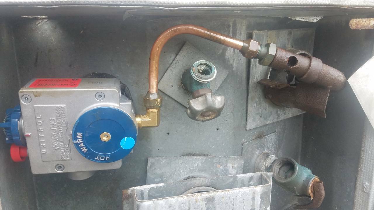

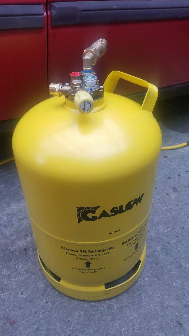

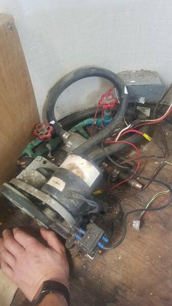

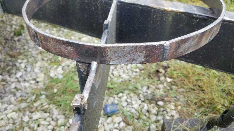

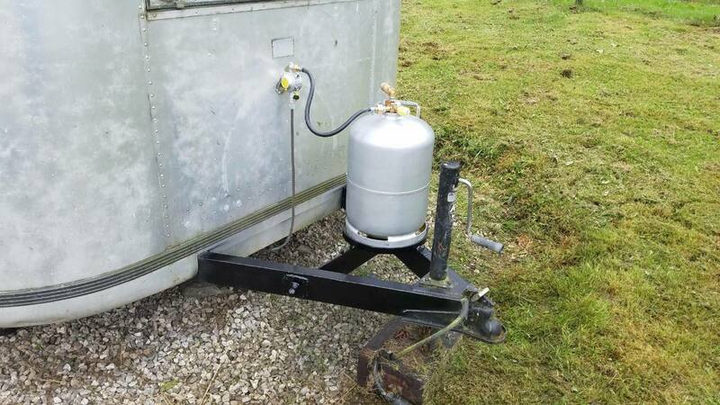

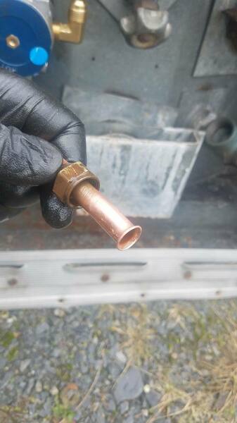

mat_the_cat Posted August 18, 2021 Author Posted August 18, 2021 There has been a bit of progress on this, which will hopefully be faster now I've quit the proper job. One of the tasks was to finalise the gas supply - as the original water heater (more on that saga later, once I've stopped crying) has a pilot light we may use a fair bit of gas, so Calor bottles will be pricey. Especially as we'd need two of them so we can get one refilled while the other is in use. There is also a significant supply issue at the moment - all of our local stockists have run out and have been for over a week. Lastly, they don't look in keeping with the Airstream, as they originally had unpainted aluminium bottles. Although I'd already fitted a fixed regulator, the bottle was just a temporary supply for testing. The obvious answer seemed to be a refillable cylinder. Not only is this a third of the price to fill, we can top it up between stays from the local LPG station, so no need for two cylinders and a changeover valve. There's a level gauge built in so little danger of running out. Plus, as we own rather than rent it we can paint it a more subdued colour! The mounting on the A frame needed alteration though, as it was designed for smaller bottles, and two of them. I cut the base mount off, bent it to an approximation of a circle, then welded it together. After working with rusty car bodywork, being able to crank up the amps was a delight! This is the final set-up, and £13 for 11kg is better than £38.50! Moving onto the interior lights, the diffusers were incredibly brittle and yellowed. The latter didn't really bother me, but were apparently "manky". Two of the rotary switches had disintegrated too, so work was obviously required. I cleaned up the aluminium as best I could, then wired in a new switch, of a slightly more robust design. Before unwrapping a very expensive bit of plastic! And the first one back in... ...just repeat 4 times and job done! Scruffy Bodger, somewhatfoolish, Coprolalia and 20 others 23

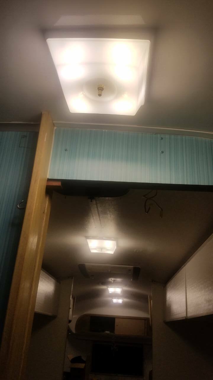

chaseracer Posted August 19, 2021 Posted August 19, 2021 The Boss is right, Mat - those new diffusers are much better! mat_the_cat 1
Zelandeth Posted August 19, 2021 Posted August 19, 2021 I am intrigued by the refillable gas cylinder... that's something I might need to look into for my van. I assume there's nothing saying they can't be carried in vehicles when filled is there?
mat_the_cat Posted August 19, 2021 Author Posted August 19, 2021 Not that I'm aware of - they are designed for motorhomes and caravans so would be less than ideal if they had to be empty! I've read that some filling stations haven't come across them, so try and stop you filling what they think is a standard cylinder. So you can purchase a normal Autogas inlet, and plumb that into the cylinder so it just appears you are refilling the vehicle. I just can't get my head around how it's so much cheaper than Calor, even paying the road fuel duty on it! Arthur Foxhake and Zelandeth 2
Talbot Posted August 20, 2021 Posted August 20, 2021 If you wanted to go for ultimate cheapness, if you have a bulk LPG tank with a liquid take-off port on it, you can then get wholesale LPG delivered in bulk, and then refill bottles/vehicles from this at your leisure. Last time I checked it was less than 1/2 the price of pump LPG, meaning you could buy 47kg for about £25, which would be about £50 from a pump, and is something like £70+ bought as a calor refill. LightBulbFun 1
mat_the_cat Posted August 20, 2021 Author Posted August 20, 2021 If we'd got an LPG'd vehicle on the road, I think I'd do that. We use a couple of 47kg cylinders for the cooker, so a tank would enable us to do away with them. Trouble is, we only use one every 18 months or so, so needs heavier usage to justify. Man maths suggests buying a thirsty car running LPG would be the answer. somewhatfoolish, Dan_ZTT, gm and 2 others 5

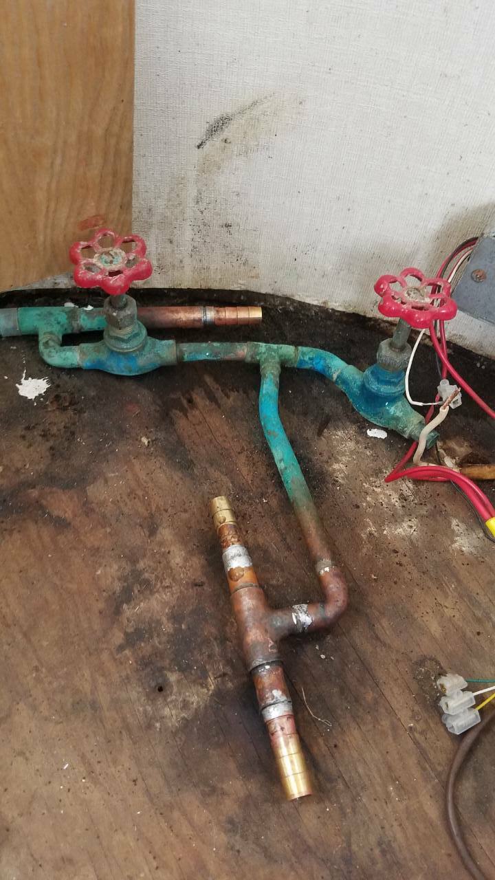

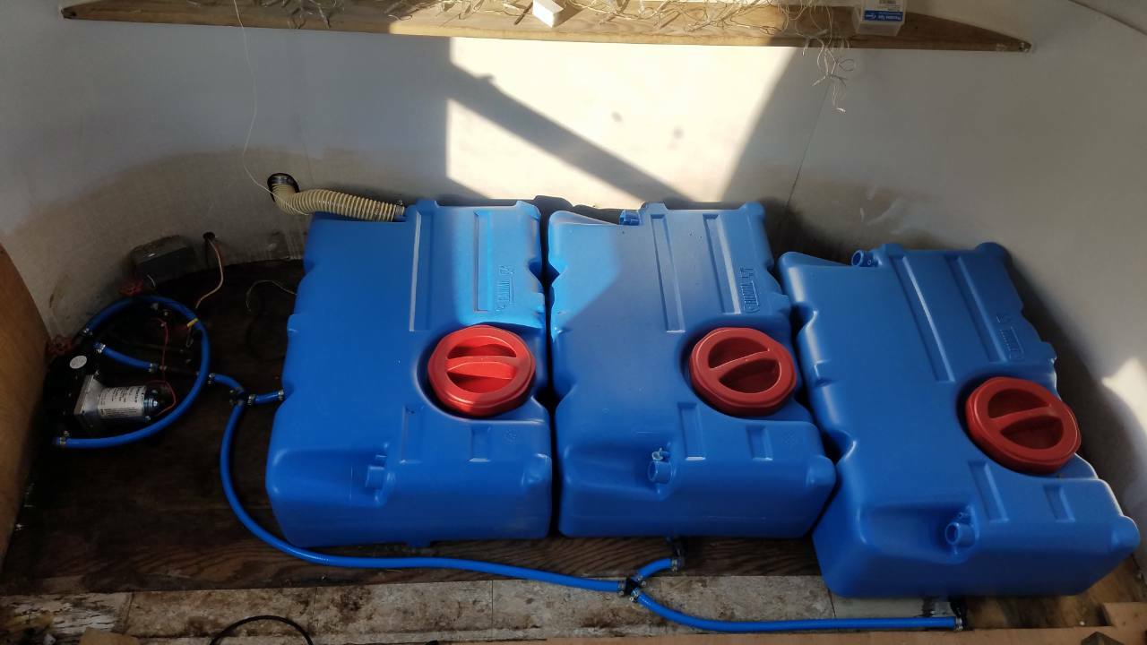

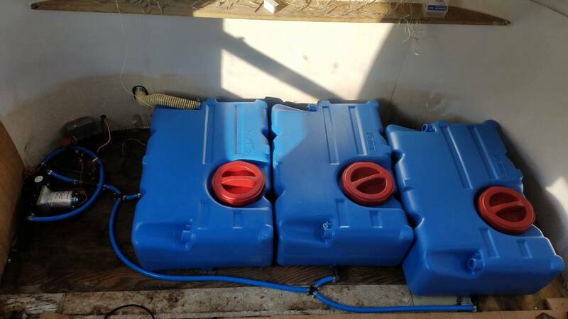

mat_the_cat Posted September 21, 2021 Author Posted September 21, 2021 Well, I say hot and cold running water. All apart from the kitchen sink! The pump maintains a constant pressure of 55psi in the system, so as soon as a tap is opened, it kicks in and water flows. But for some reason the new kitchen tap only allows a trickle, and then stops. It's a UK household tap rather than the original, but I can't see how a mixer tap could differ (or be faulty, on both the hot and cold taps!) I'll have to pull it out, and try it in the house to see if the problem remains. A bit more progress on the bed, as I've used the original sofa bed as a basis for a new fixed bed. I've raised it up 120mm to clear the new water tanks, and all I need to do now is build a framework around the edges and clad it. The whole top section hinges up, for access to the pump and tanks if required. Would have taken me a while to make something like this, plus keeps it original-ish. LightBulbFun, Coprolalia, puddlethumper and 7 others 10

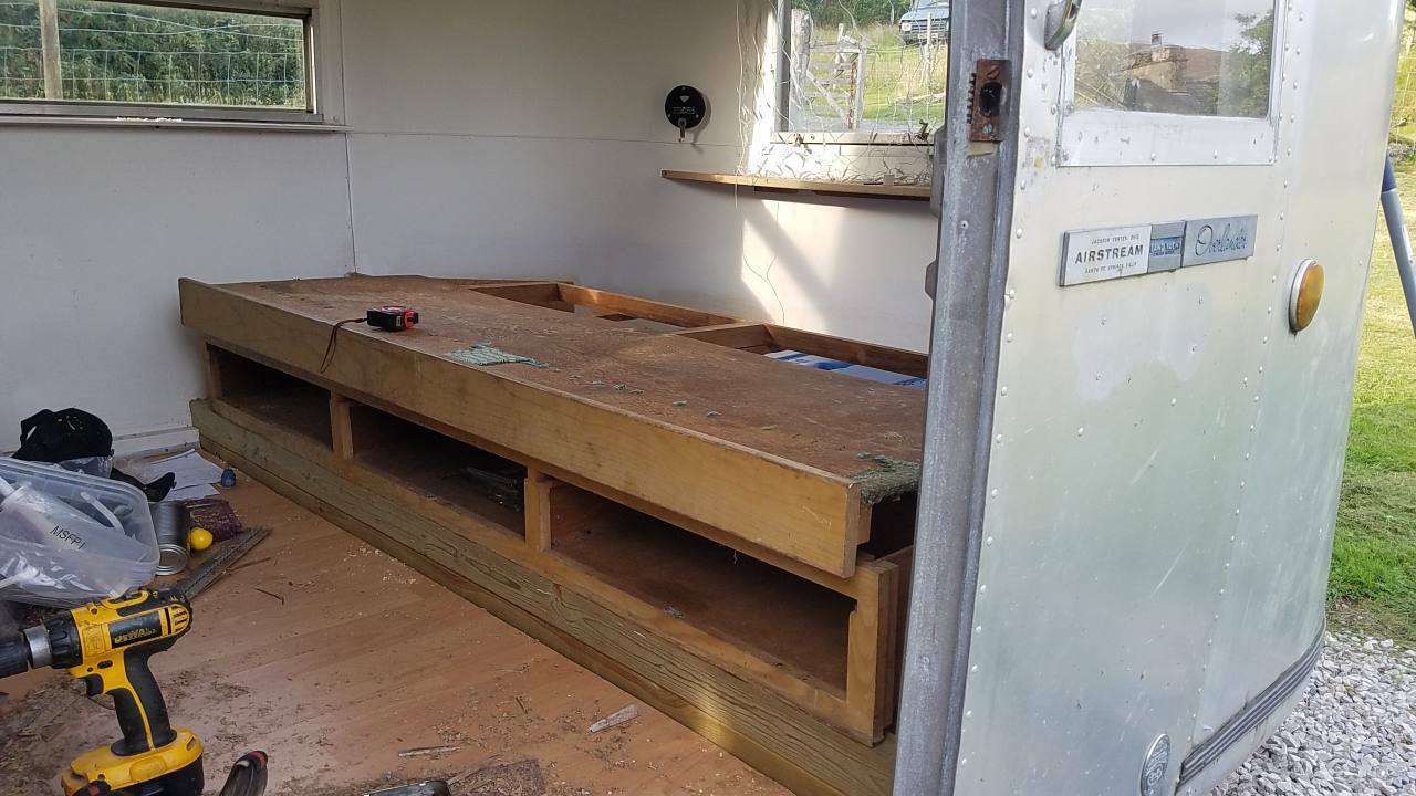

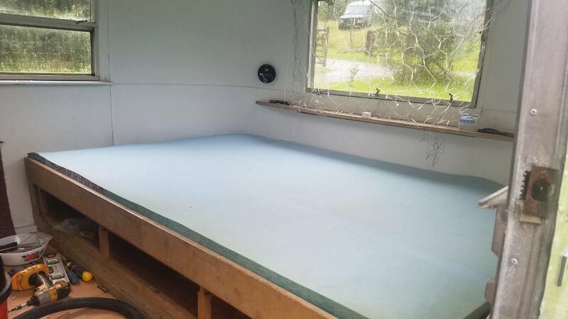

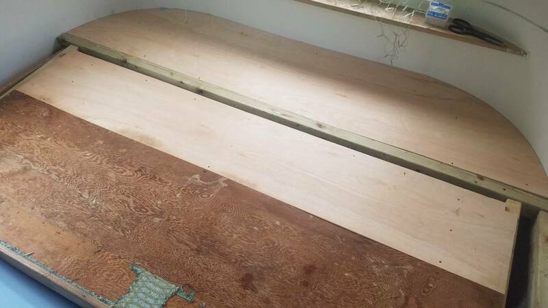

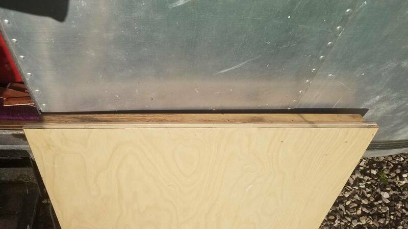

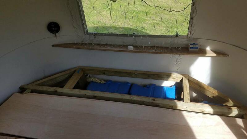

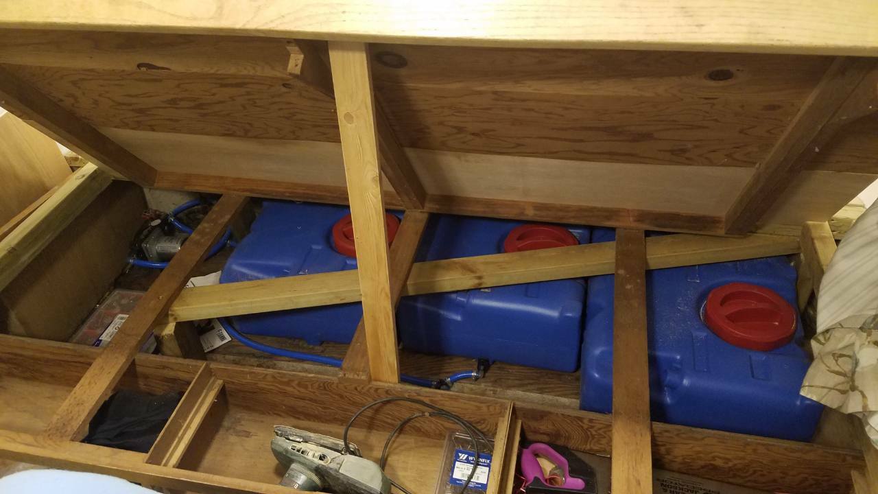

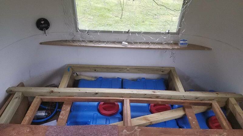

mat_the_cat Posted October 2, 2021 Author Posted October 2, 2021 Most recent photo first, as I'm writing this from the comfort of the (almost) completed bed! With the original base in position I built a frame around it, a little sturdier than required, but I had the timber already. What appears to be a support at a jaunty angle is in fact positioned to allow for removal of all three tank caps, for cleaning. 10mm ply was used to cover the top, which took a while to get the curves correct for the end section. It all hinges upwards for access, and is propped up by a hinged batten which swings downwards. Gas struts a possible future improvement... Then as a temporary job, I've cut some foam to size, purely so I can camp out in it tonight! mercedade, Dan_ZTT, loserone and 15 others 18
mat_the_cat Posted October 3, 2021 Author Posted October 3, 2021 I had a reasonable night's sleep, although not completely uneventful. As I was getting into bed I heard the door rattling, as if someone was trying to get in. I had a look, but as expected given where we live, nobody around. During the night it didn't feel as warm as I'd hoped, although the heat pump was still blowing out warm air. Biggest problem was how draughty it was, so I resolved that I'd have to do something about that before taking in paying guests. Imagine my surprise when in the morning the door was wide open and fastened back, yet still locked. Crackers, Dan_ZTT, Saabnut and 6 others 2 7

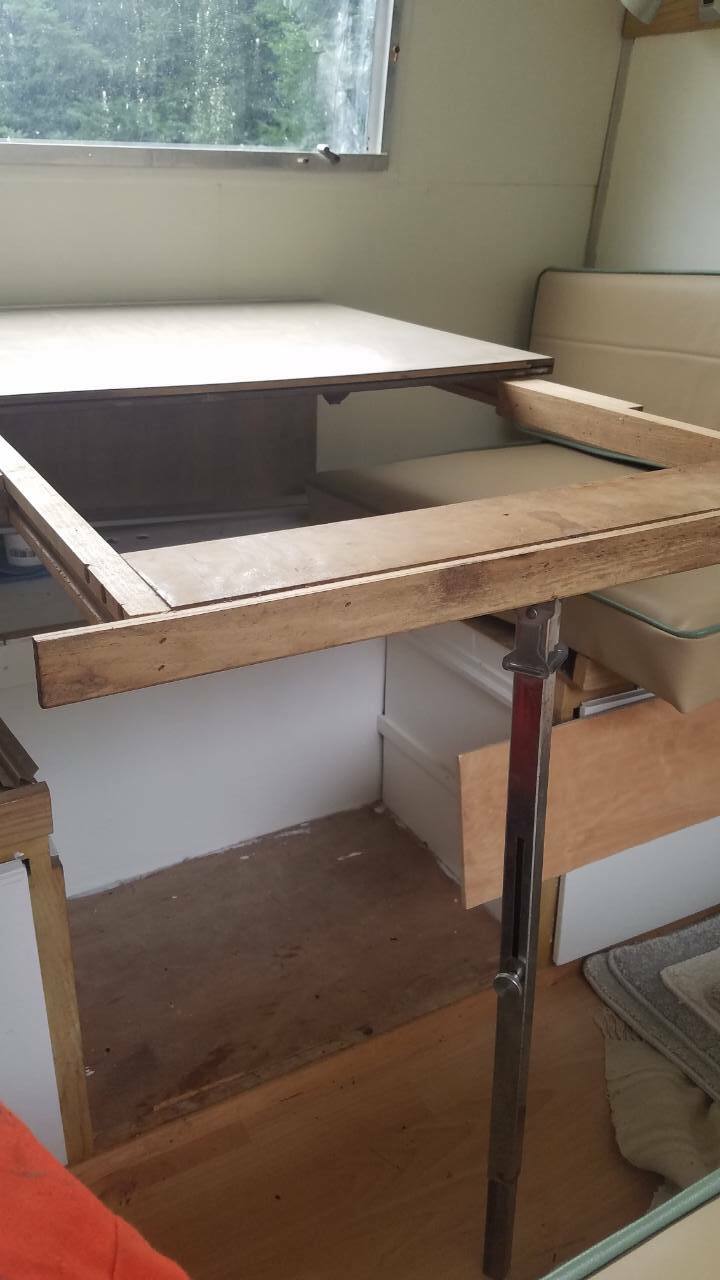

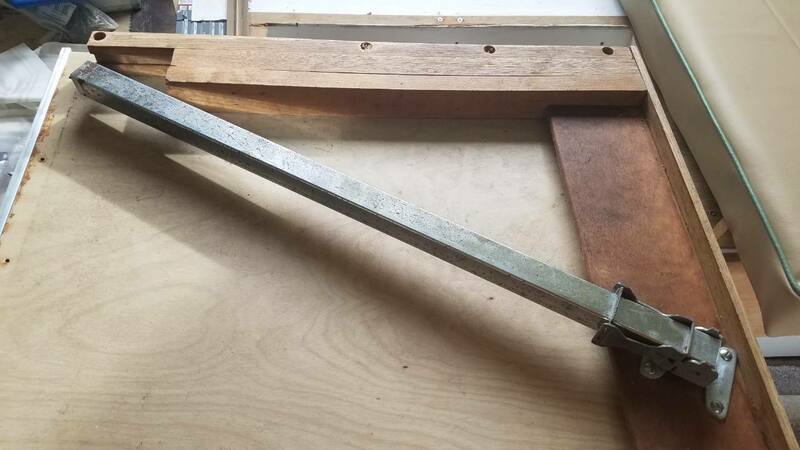

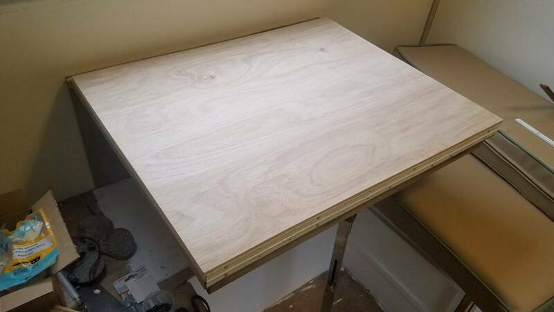

mat_the_cat Posted November 3, 2021 Author Posted November 3, 2021 We've converted one of the full length bench seats on this into a dinette area, and have moved the table from the front end, where the fixed bed now is. The table is quite a neat design (hence wanted to keep it), with a slide out extension and a flip-over section to double the size. Or at least there was, but the extra part was missing. The hinge was plastic, and after 50 years wasn't too great either. The T section fitted into a corresponding groove in each half of the table. To fit a conventional piano hinge, I needed to fill the groove, and also reinforce the framework if possible. So I added wood glue to the groove, and tapped in a strip of plywood. Once it had set then I trimmed it back to leave a flush edge, ready for the hinge to screw into. As the table is higher than originally designed, I needed to extend the leg. And as the floor where the table leg will be is at two levels, I need to make it adjustable, and no longer than original so it can fold up if required. Solution was to buy a length of tube which was a sliding fit inside the original leg. A slot was then cut in the existing tube, and the new tube drilled and tapped for a thumbscrew to lock in position. The table pulls out like so, giving a support for the hinged portion. Which I made up using plywood faces, and battens of the correct dimensions to equal the thickness of the original part. Both will be covered in laminate I think, although the plywood looks ok as it is! It just remained to test it out, and it seemed daft to walk all the way to the Airstream with a cooked meal going cold, when there's a perfectly good oven already in there... 200°C equates to 392°F (have to make up a conversion chart for guests!) and it seemed to cook pretty evenly Verdict: Great success! Dyslexic Viking, stephen01, gm and 12 others 15

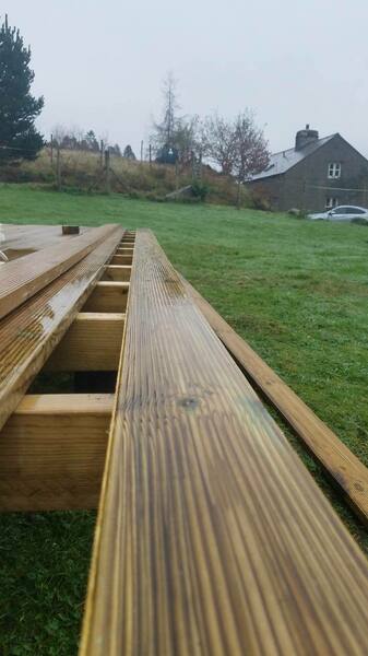

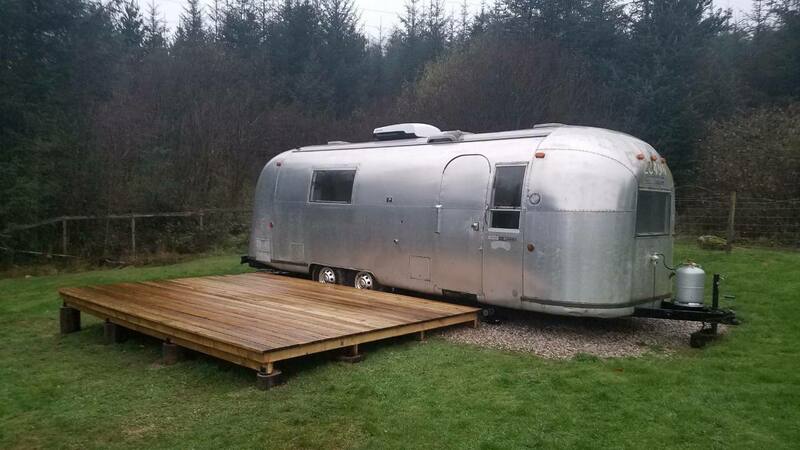

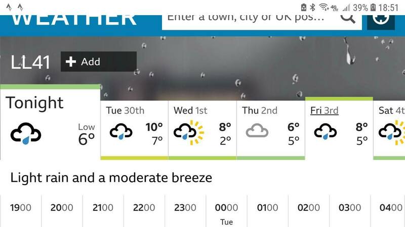

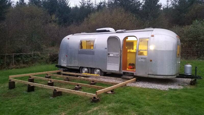

mat_the_cat Posted November 29, 2021 Author Posted November 29, 2021 Guess what the weather was doing today! Although Thursday looks great. Still, at least it's not snowing. Had a delivery of timber, so screwed all the beams together once I had double checked it was still square. I laid out the decking planks to make sure they fitted, and wasn't left with an awkward gap at one end. Then screwed down the first one at the ends only. Before adding any more fixings I stretched a plumb line from end to end, so I could pull it straight. Otherwise every other plank will have to follow the same shape as the first, or have non-uniform gaps. I try and get the gaps correct at 1/4 and 3/4 distances, then either pull or push the middle to the same gap. Finally the ends are tweaked to suit. I've still got to add a few hundred more screws and trim the ends, but all boards are down. Doesn't that look inviting to sit on and enjoy the sun? Dan_ZTT, Sunny Jim, Dick Cheeseburger and 12 others 15

mat_the_cat Posted February 14, 2022 Author Posted February 14, 2022 On 11/28/2021 at 10:19 PM, mat_the_cat said: I waited for decent weather, I'd never get anything done. Nothing much to add in the way of progress, but more to have a moan about the weather. Since doing the decking, it hasn't stopped raining long enough for the wood to actually appear visibly dry We've had the odd day with no rain, but not enough sun to dry the wood. I'd like to put some stain on , but fat chance of that until the spring!
