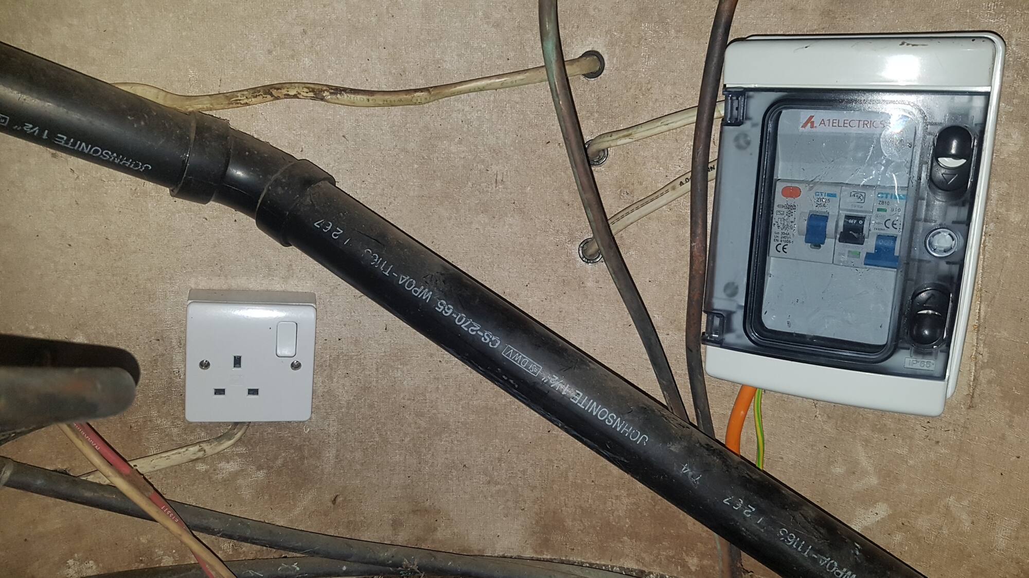

mat_the_cat Posted December 15, 2019 Author Posted December 15, 2019 You'll see from this photo that the mains electrical system needed some work! Not too easy, as all access is via a small panel in the bathroom. The old consumer unit was removed, and replaced with a UK version complete with 30mA RCD. The US wiring was then sleeved, and all connected up. I ran the orange mains cable into the rear bumper compartment, and fitted a plug which I will attach to the metalwork, probably with a couple of half washers welded on. I ran an earth cable from the consumer unit, and connected it to the chassis so that now the whole skin should be earthed. Job done! I've also added a socket so I can plug in the battery charger once the wiring is complete. UltraWomble, mrbenn, anonymous user and 4 others 7
Scruffy Bodger Posted December 16, 2019 Posted December 16, 2019 As this is now going to effectively be a static van rather than a tourer are you going to install an earth rod?
mat_the_cat Posted December 16, 2019 Author Posted December 16, 2019 That's something I need to work out. I'm not sure what earthing system the house has (other than it's not TT) and the caravan will be around 100m (in terms of cabling) from the house. The feeling is to run a length of SWA cable to a 16A socket on a post, and fit the earthing rod at that point. But I wonder whether an impedance check would say whether that's actually required or not? Need to do some research!
Scruffy Bodger Posted December 16, 2019 Posted December 16, 2019 Is it an old cutout, does it have a sticker on it saying PME. If it does then it'll be a TNCS. If there's an armoured cable and the outer sheathing has a plumb joint on it and that's providing the earth it's TNS. Probably best to put a rod on it anyway, proper sites all have the vans on one or a TT system as it's called. When I was a kid the caravan we lived in lost its earth completely, EVERYTHING was live on the bloody thing, door handles and window frames included. mat_the_cat 1

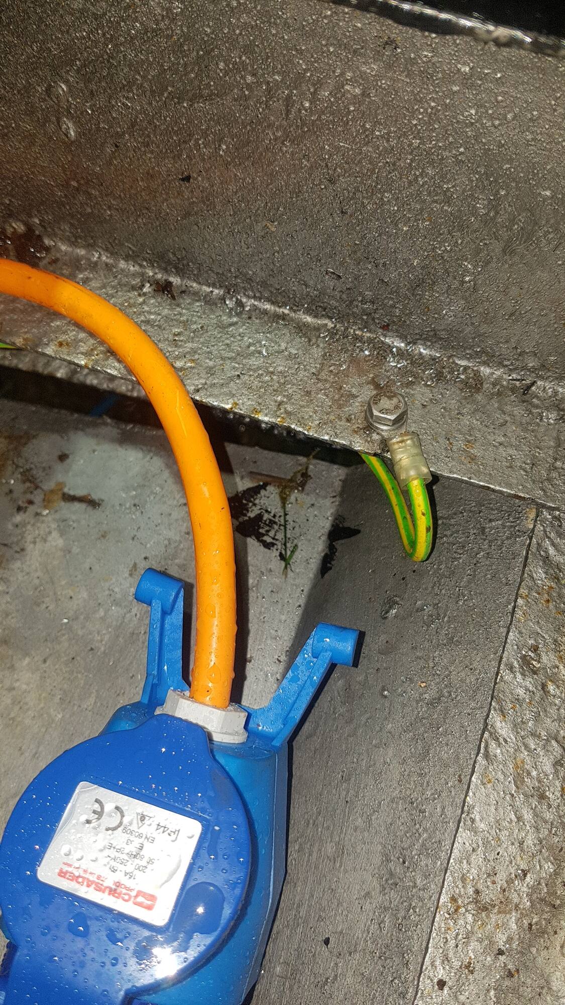

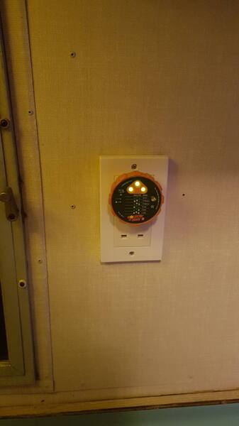

mat_the_cat Posted December 23, 2019 Author Posted December 23, 2019 Yes, thinking of something like that for the outside. Burning through paint is obviously of no concern, so no need to go for the safer but slower DA option. As of tonight, it has working mains electricity! A quick and simple test suggests no major faults, but I want to check the earth resistance with at least a better plug-in tester. I figure that if we're renting it out, the least I could do is regularly test the circuits with something a little more advanced. I've also bought a cheap UK to US transformer, so I can plug in the mains side of the control panel. Little practical benefit, although has a polarity light but would allow any American visitors to plug in their own appliances. Dan_ZTT, somewhatfoolish, LightBulbFun and 3 others 6

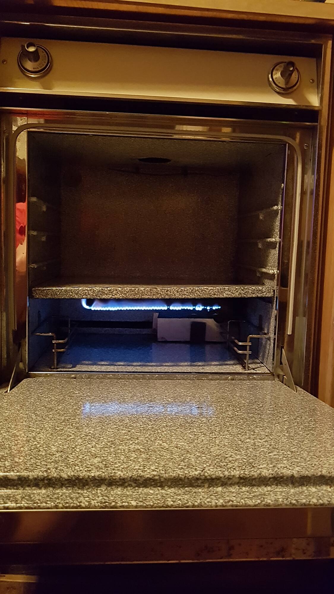

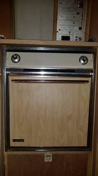

mat_the_cat Posted December 27, 2019 Author Posted December 27, 2019 I mentioned earlier that I couldn't light the oven, not even the pilot light. I wasn't sure whether it was a blockage or a problem with the thermostat but I wanted to keep the original if at all possible. I basically just worked way through each gas connection in turn, to see at what point it was being stopped. There is a valve block in the bottom of the oven for the main burner, and gas was reaching that point but not being allowed to flow any further. This I worked out was because the pilot light wasn't on, so the thermocouple was not allowing the valve to open. Cleaning the pilot jet with a bristle from a fine wire brush and WD40 seem to do the trick, and I got the pilot light lit. Followed by a whoosh as the main burner fired up! The oven seems to be lined with some kind of non-stick surface, as the years of grime came away very easily. Next job is to work on the plumbing, as several pipes seem to have been severed for some reason, and joined by lengths of garden hose, held on by silicone and jubilee clips... mrbenn, Cavcraft, Tickman and 3 others 6
mat_the_cat Posted January 5, 2020 Author Posted January 5, 2020 On 12/16/2019 at 11:04 PM, Scruffy Bodger said: Is it an old cutout, does it have a sticker on it saying PME. If it does then it'll be a TNCS. If there's an armoured cable and the outer sheathing has a plumb joint on it and that's providing the earth it's TNS. Right, as I understand it, if I have a PME/TNC-S earth then I *have* to fit a rod for the van, otherwise it's advisable. Unfortunately it's not clear from our incoming cable what we have! (Note the jaunty angle of the main fuse, after we had the meter replaced!) So will use the house earth to protect the armoured cable, then a rod to protect the 'van. In other news I've managed to fire up the water heater! Took a bit of cleaning out, and the thermocouple cut-out doesn't seem to be working, but the manual override is stiff so can be temporarily jammed on - strictly for testing only. I've had to drill out the screws holding the thermostat together, so I could strip it all down. The pilot light lit: Then by cycling the thermostat the main burner kicks in and out. I'm still waiting for the correct sized pipe couplers for the water system, so I couldn't see how long it takes to heat up the tank. I'm in two minds whether to rely on a 50 year old gs heater for renting it out, so may still replace with a mains powered heater ot a more modern gas unit. But always satisfying bringing something back to life Cavcraft, mercedade and LightBulbFun 3
Scruffy Bodger Posted January 5, 2020 Posted January 5, 2020 That's a TNS system. That's an SWA cable coming in with an old plumbed joint on it with the earth coming from that.
Scruffy Bodger Posted January 5, 2020 Posted January 5, 2020 That board layout of yours is a bit odd btw. Looks a newish one but it's not a split board with twin RCD protection. Does the RCD protect all the circuits and there are just 3 blanks in the middle or does the RCD only protect the circuits on the left side of the board. If so it'd mean you've no RCD protection on the outside/downstairs sockets which would be far from ideal...
loserone Posted January 5, 2020 Posted January 5, 2020 Is that new CU alright in the van? I thought they now needed to be fireproof (i.e. steel). I did a bunch of tests with a 12v battery and a multimeter I can't really remember to test my new earth rod for my garage, and when an electrician tested the earth before fitting the car charger with some fancy kit I can't afford he was quite impressed to see his readings were within 5% of my handwritten notes. He was obviously pretty impressed as he signed off the whole garage as his own work without asking ?
mat_the_cat Posted January 5, 2020 Author Posted January 5, 2020 2 hours ago, Scruffy Bodger said: That's a TNS system. That's an SWA cable coming in with an old plumbed joint on it with the earth coming from that. I'm not certain about that - would an overhead line be armoured? I'll grab a photo of the other end, at the nearest post to see if that sheds some light. I assume that if 3 connections are coming into the house, it proves TNS, but could it in theory be TNC-S at some point earlier in the supply? 2 hours ago, Scruffy Bodger said: If so it'd mean you've no RCD protection on the outside/downstairs sockets which would be far from ideal... It's not a current photo, but one I took after the meter swap, which was not too long after I did the CU. Yes, the downstairs and outside sockets weren't RCD protected at the CU, but the outside ones were at the time protected by fused spur units with an RCD built into them, as the previous CU was an old Wylex with rewireable fuses! So to avoid the main RCD tripping when the outside sockets were turned off in the house (via the test button) I wired the downstairs sockets to the unprotected side. 1 hour ago, loserone said: Is that new CU alright in the van? I thought they now needed to be fireproof (i.e. steel). Oooh, good question. I bought it based on what I had seen in modern caravans, but not sure what the current regs are. Cavcraft 1
loserone Posted January 5, 2020 Posted January 5, 2020 I know mine was fitted before* the new regs came in.
Scruffy Bodger Posted January 6, 2020 Posted January 6, 2020 It's still a TNS. It's using an earth provided externally by the supply authority. TNCS bonds the earth to the neutral at the cutout and uses that as an earth instead. mat_the_cat 1

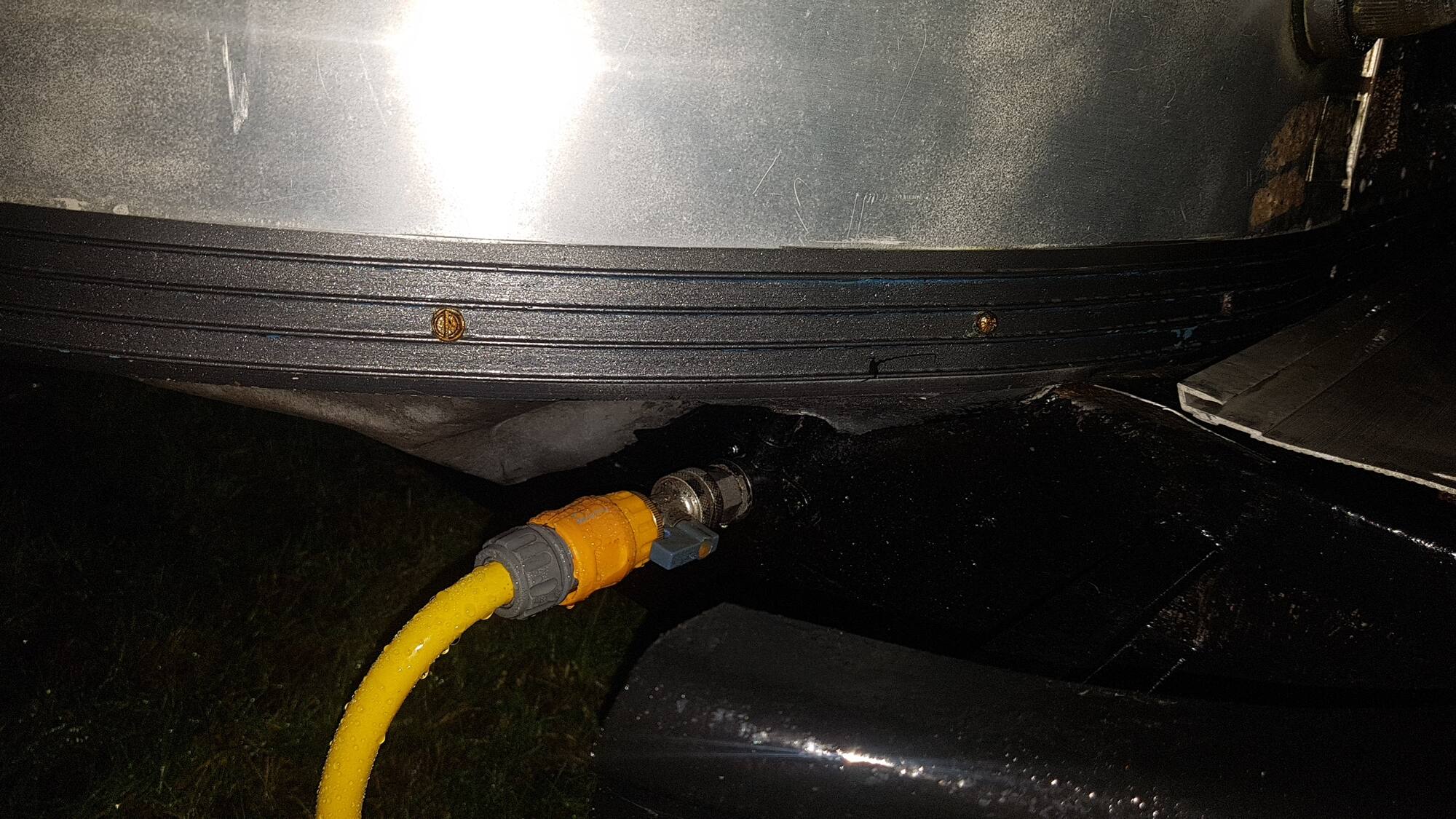

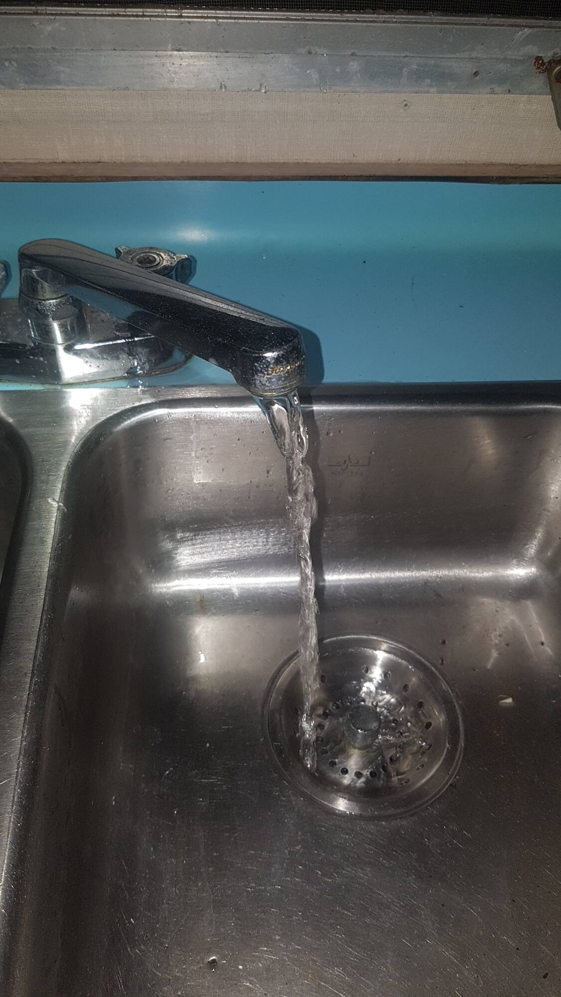

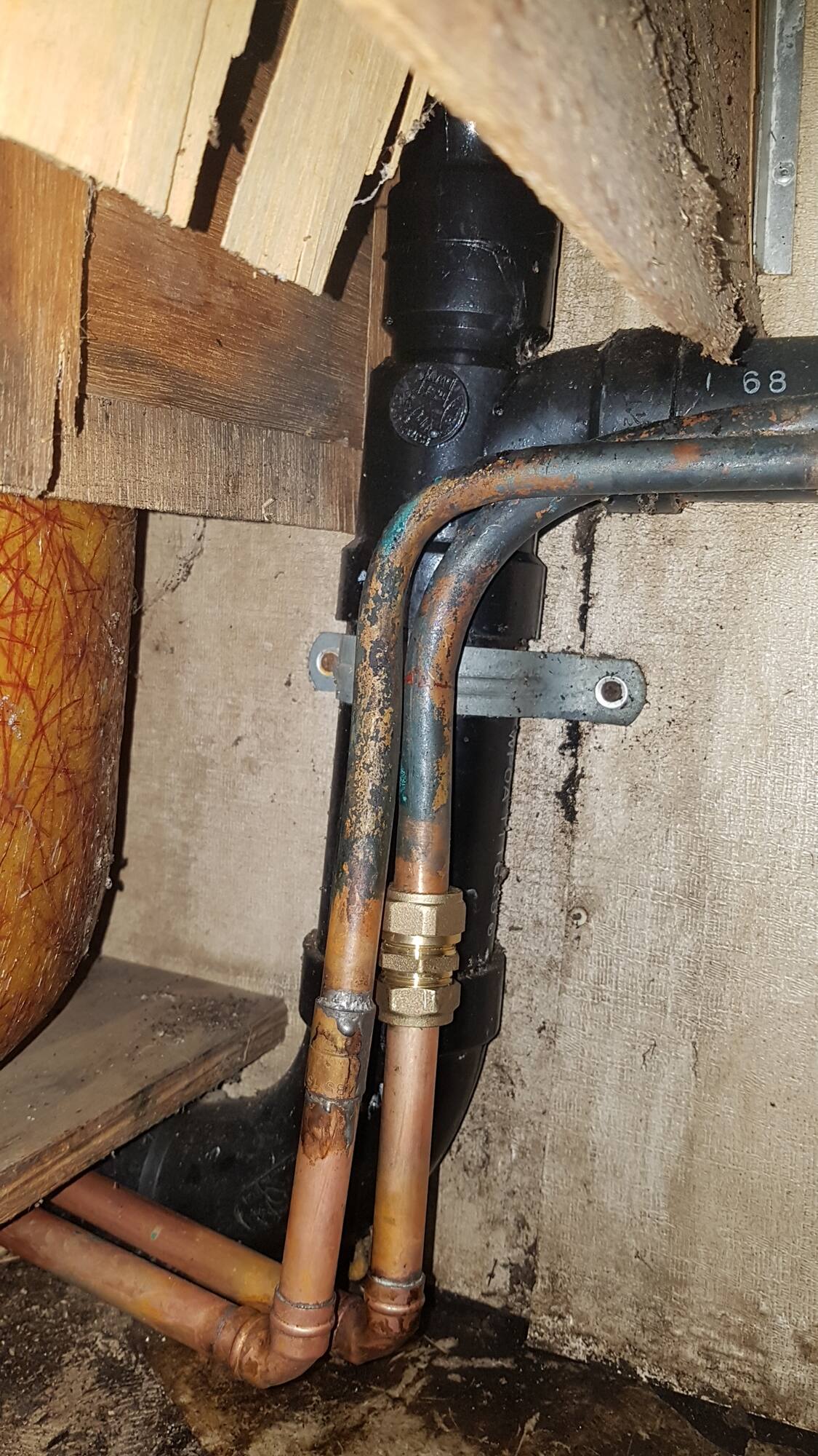

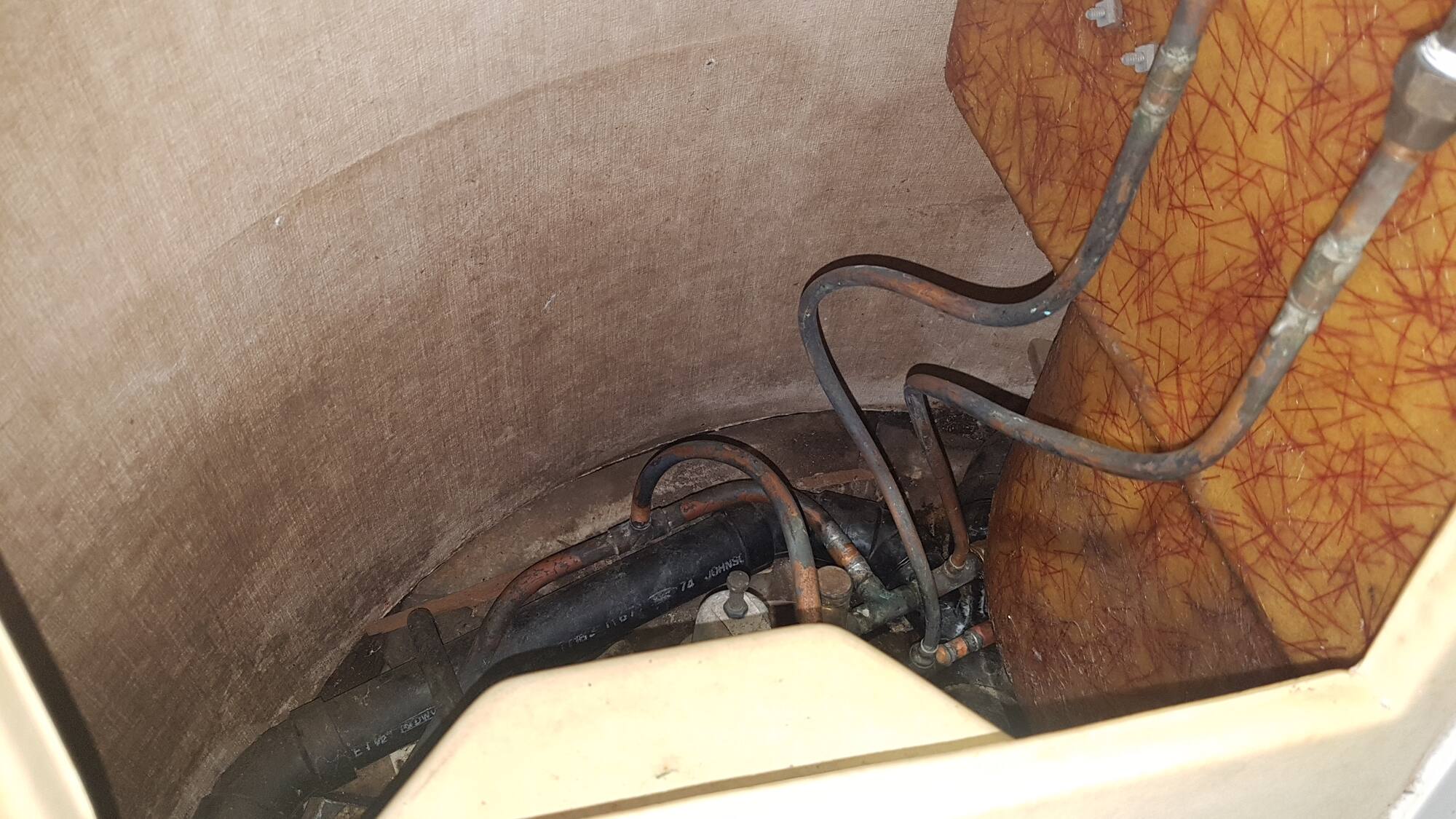

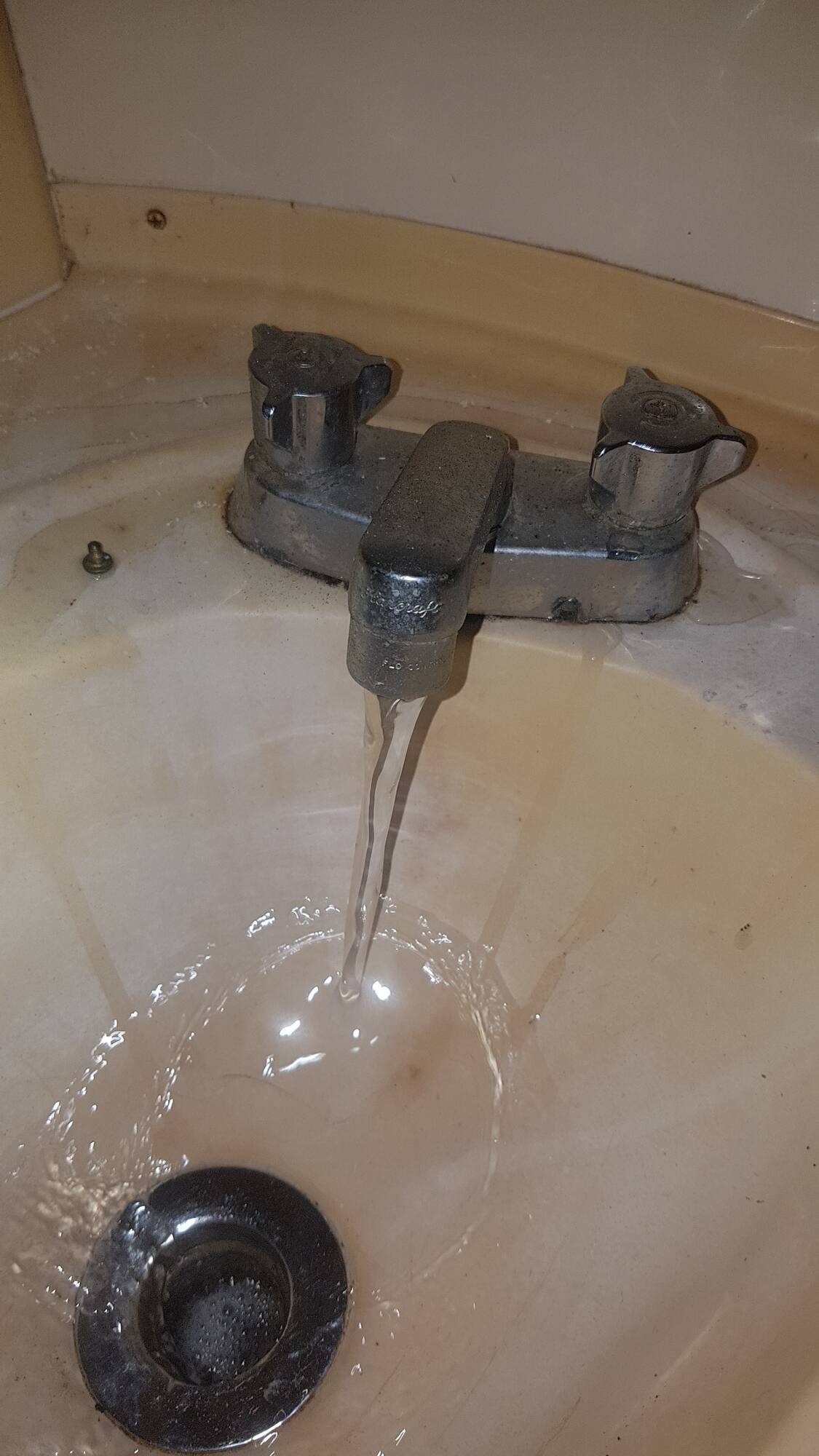

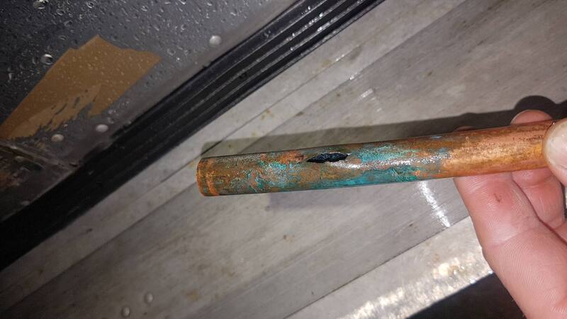

mat_the_cat Posted January 11, 2020 Author Posted January 11, 2020 Water system next, and it became clear why some of it had been replaced with garden hose. After replacing several lengths of pipe in accessible places, it was time to connect to mains water. I've had to use various fittings to convert from US pipe sizes to UK 15mm, hence the apparent bodgery! I've managed to thread a standard hosepipe fitting into the original water inlet. And success! Next step is to fire up the water heater and see if it does a decent job of providing hot water. Cavcraft, Aston Martin, anonymous user and 8 others 11

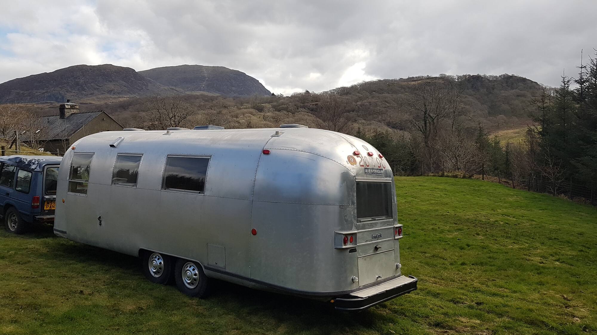

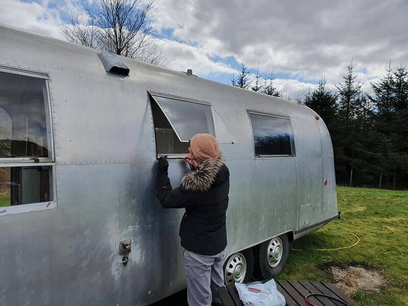

mat_the_cat Posted March 29, 2020 Author Posted March 29, 2020 We've been replacing the door and window seals on this, to try and make it watertight. We've also been planning where we can site it, so today dragged it around the field to see where suits it best. Yep, that'll do I think! Next stage is to hire an excavator, and level the area, dig a trench for an electricity acble, and install a septic tank. Whether any of that is possible at the moment I have no idea, but I managed to buy enough SWA cable, a mains hook-up point and an earth rod before lockdown. If work does close then I guess I could try digging by hand to kill some time... Dirk Diggler, Dan_ZTT, Cavcraft and 10 others 13

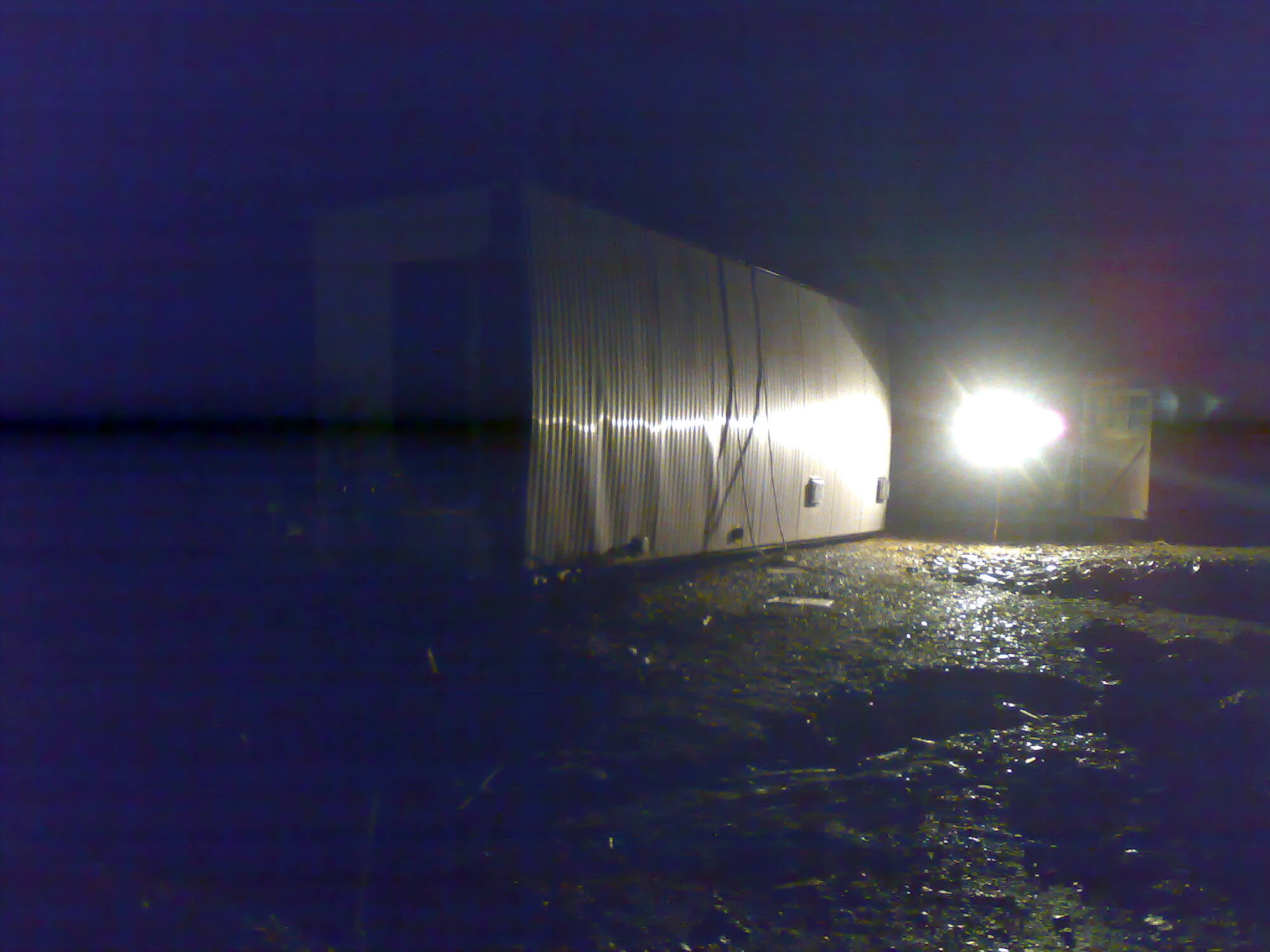

mat_the_cat Posted March 31, 2020 Author Posted March 31, 2020 This one might be 'free to not a lot'... @Talbot As it happens, the owners of the blown over static are the ones who had your old XUD engine! Cavcraft 1
Cavcraft Posted March 31, 2020 Posted March 31, 2020 Imho, the idea of the Airstream is a cracker. Aside from perhaps buying a wooden lodge (serious money) you can hire statics all over North wales, so this is something different and hopefully a bit of a USP. Who wouldn't want to wake up to those views? Dan_ZTT, mat_the_cat and Scruffy Bodger 3
Talbot Posted March 31, 2020 Posted March 31, 2020 16 hours ago, mat_the_cat said: As it happens, the owners of the blown over static are the ones who had your old XUD engine! Bummer! I hope that wasn't their home they lost there! Having lived in a caravan in Wales, halfway up the side of a rather windy hill, I know only too well how hard you have to strap a caravan down to stop it blowing away. Mine was only a 14' touring caravan, but it was held down with six 5-tonne ratchet straps to about 20 ground anchors that went down something like 350mm each. And it still moved in the wind. Actually the movement in the wind was the main problem I had getting a decent night's sleep. Rain? No problem. Cold? Another duvet. Wind shaking the caravan? Woke me up every single time. I'm guessing you plan on putting some fairly significant anchors on the AirB&Bstream. Although nicely aerodynamic, it would be very bad news if that started to roll away.
Mrs6C Posted March 31, 2020 Posted March 31, 2020 In your siting of the lovely Airstream, have you given thought to the aspect of its doors and windows and also privacy from overlook for your guests? Many holidaying folk want to be able to sit outside the door of a summer evening and enjoy the sunset, glass in hand. Also, having the long side with multiple windows facing south will heat it up inside fairly uncomfortably in the summer. Situating it with its long axis running NW to SE and the door facing SW should work out about right. If you can get it in a location where that enables that SW-facing space around the doorway not to have sight of the house or be overlooked by it, then that gives the privacy as well. You may already have thought about all this, of course! I'll take my anorak off, now... mat_the_cat and somewhatfoolish 2
mat_the_cat Posted April 1, 2020 Author Posted April 1, 2020 We haven't yet anchored it, but it has withstood the winter's storms so far! Maybe it's the weight which helps, with a steel frame it feels very different to a UK caravan. It even has a ceramic toilet, so clearly weight was not too high up the design brief...
