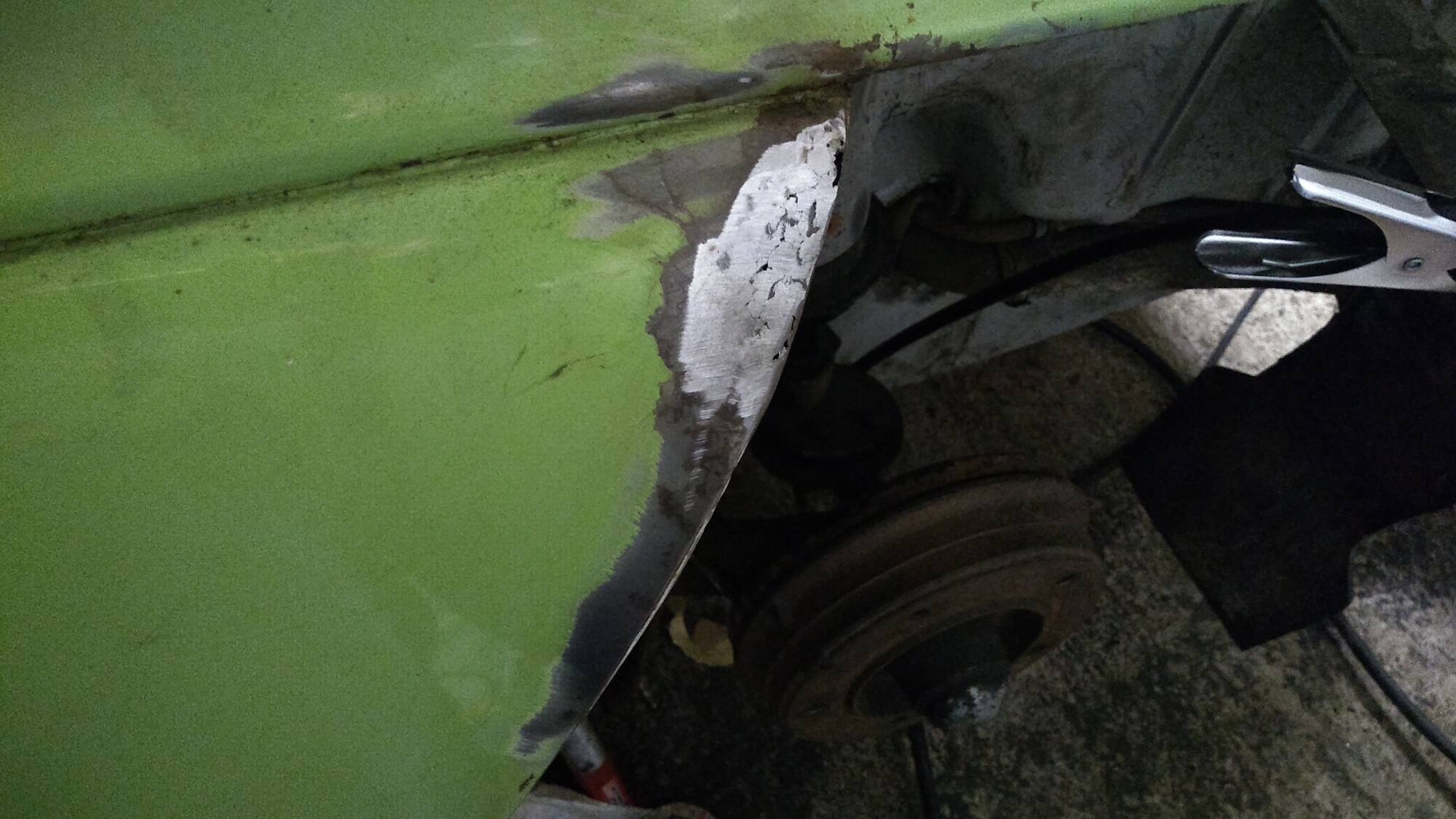

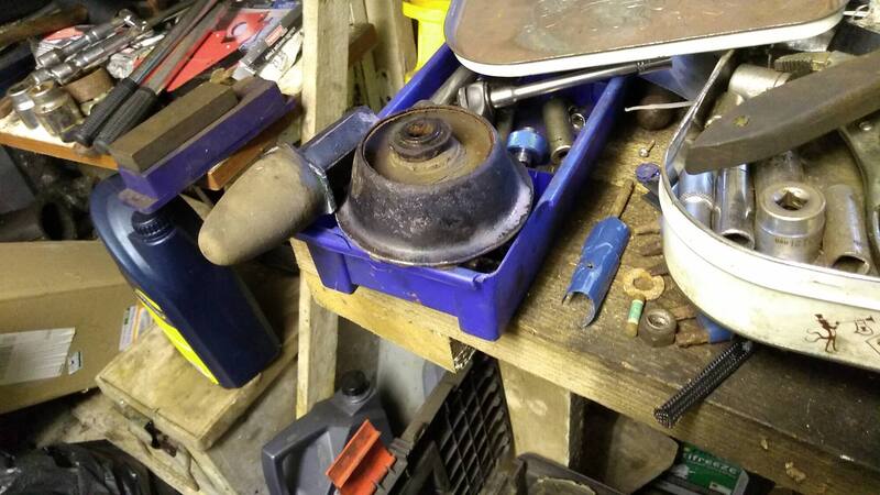

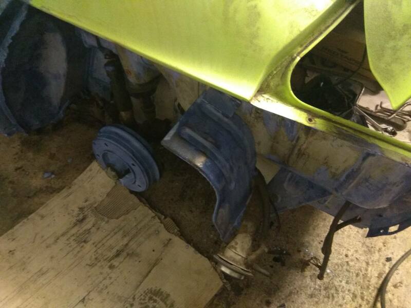

This really is a solid car.Almost finished stripping the left rear quarter,having decided I needed to remove the shock and spring to gain access.These are the only holey bits I could find.
In other news,I can confirm that 15 year old Kurust still works,or at least turns purple.I was too mean to open my nice new bottle of Hydrate 80.
This corner is a bit of a weak spot on these cars.I think it's already been done before.Also some bits around here are a bit thin so some holes had to be filled with weld.I need more welding practice,really.

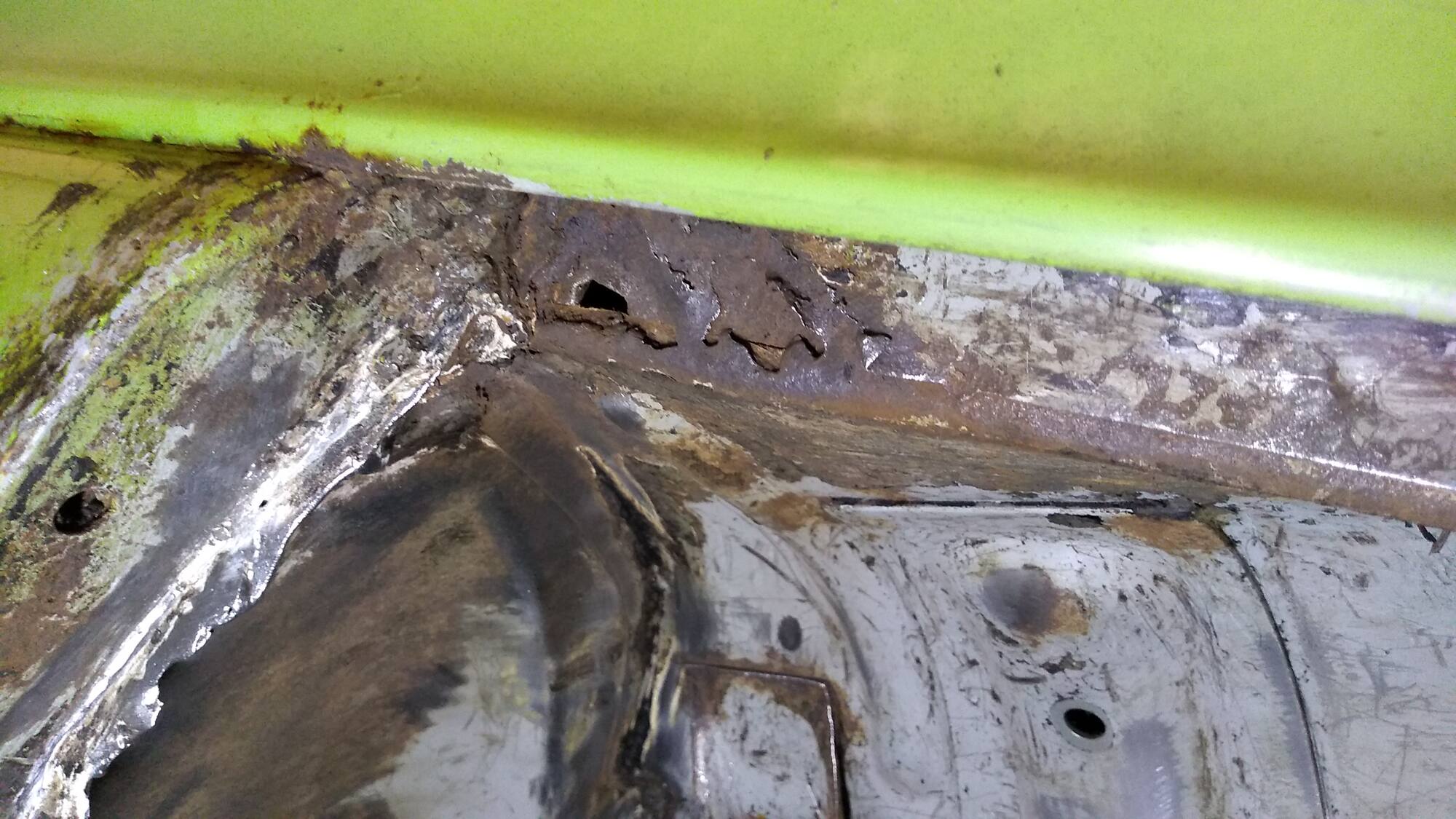

Then I cleaned up the top corner of the side panel,and found the holes in the picture,which I welded shut.

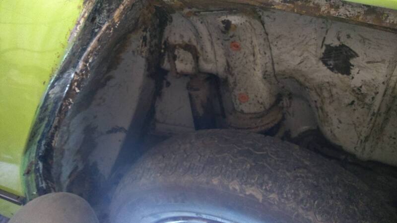

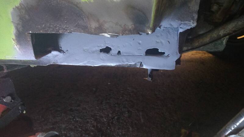

Then I noticed that the bottom corner of the same panel below was a bit flakey.Looking through a hole I poked I saw that there were a couple of holes in the end of the outer part of the upper sill.So I cut the bottom corner off to gain access.The picture shows it painted with weld through primer.
The next stage was to build up the bottom flange ,which is the return edge of the floor, with weld,then grind it back flat.Then patch the sill ,with plug welds on the bottom edge and stitch welding around the other 3 edges.Followed by grinding back .The next stage is to reinstate the side panel bottom corner

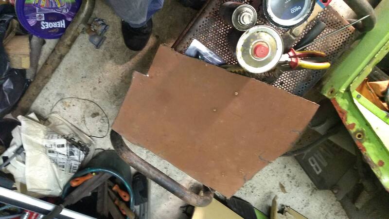

Here's what the patches are being made with.It's a piece of roof I cut out of a Saab 96 I broke up about 10 years ago.The roof was the only non rotten part of the car as it had spent about 15 years in a leaky shed.
