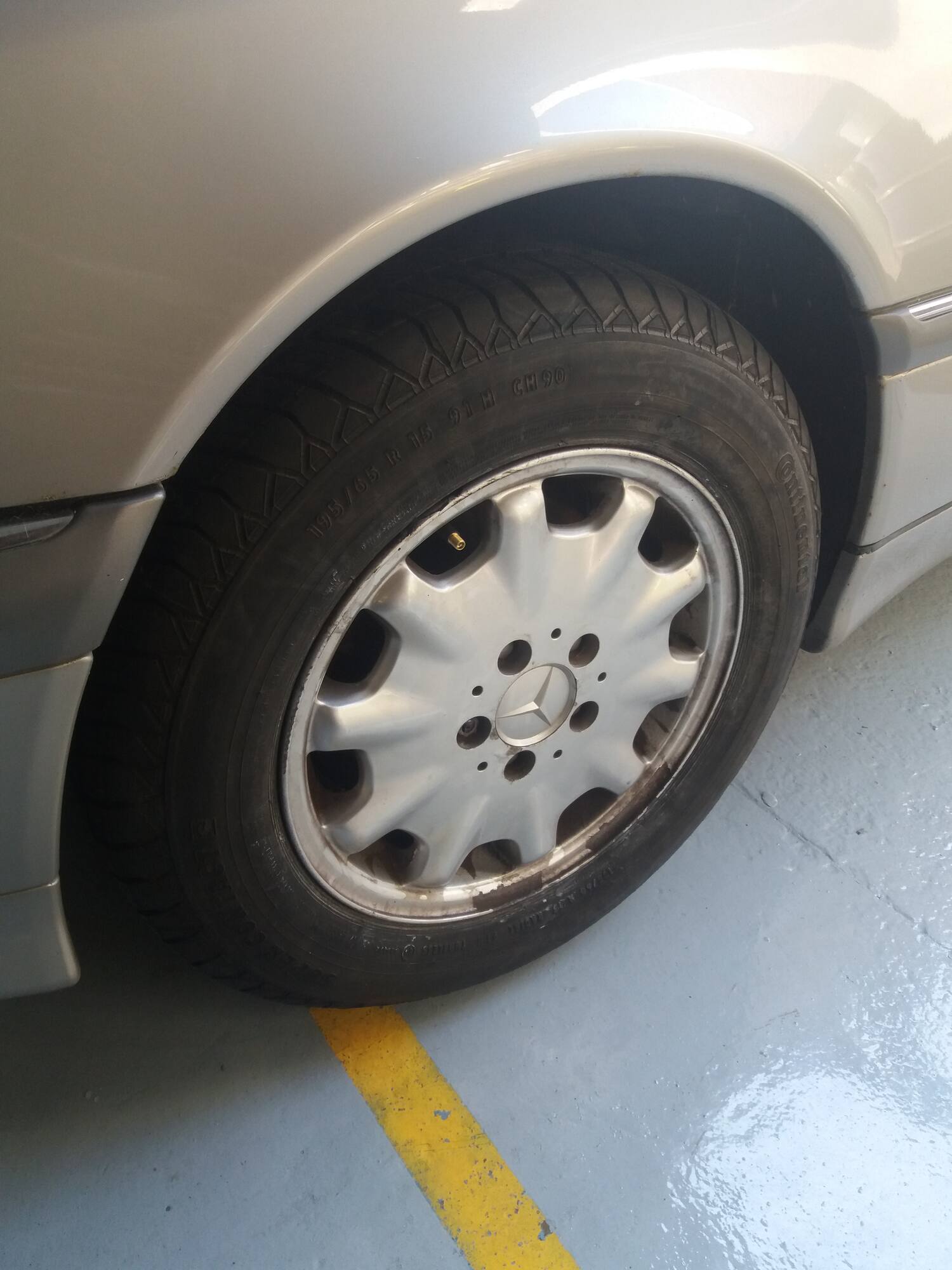

Surprised about the locking wheel nuts, mine hasn't got any.
What's the broken bit, cannot work out where it is?

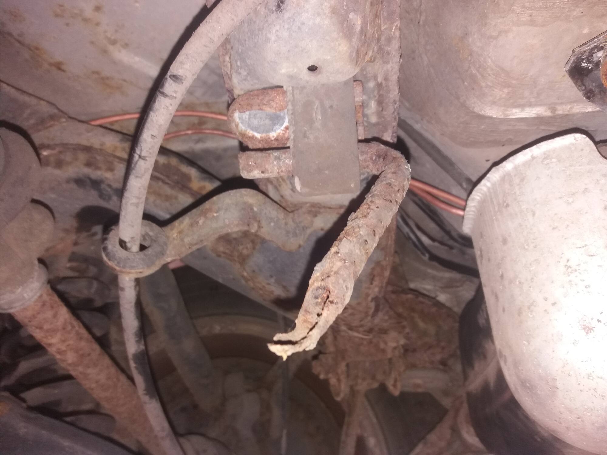

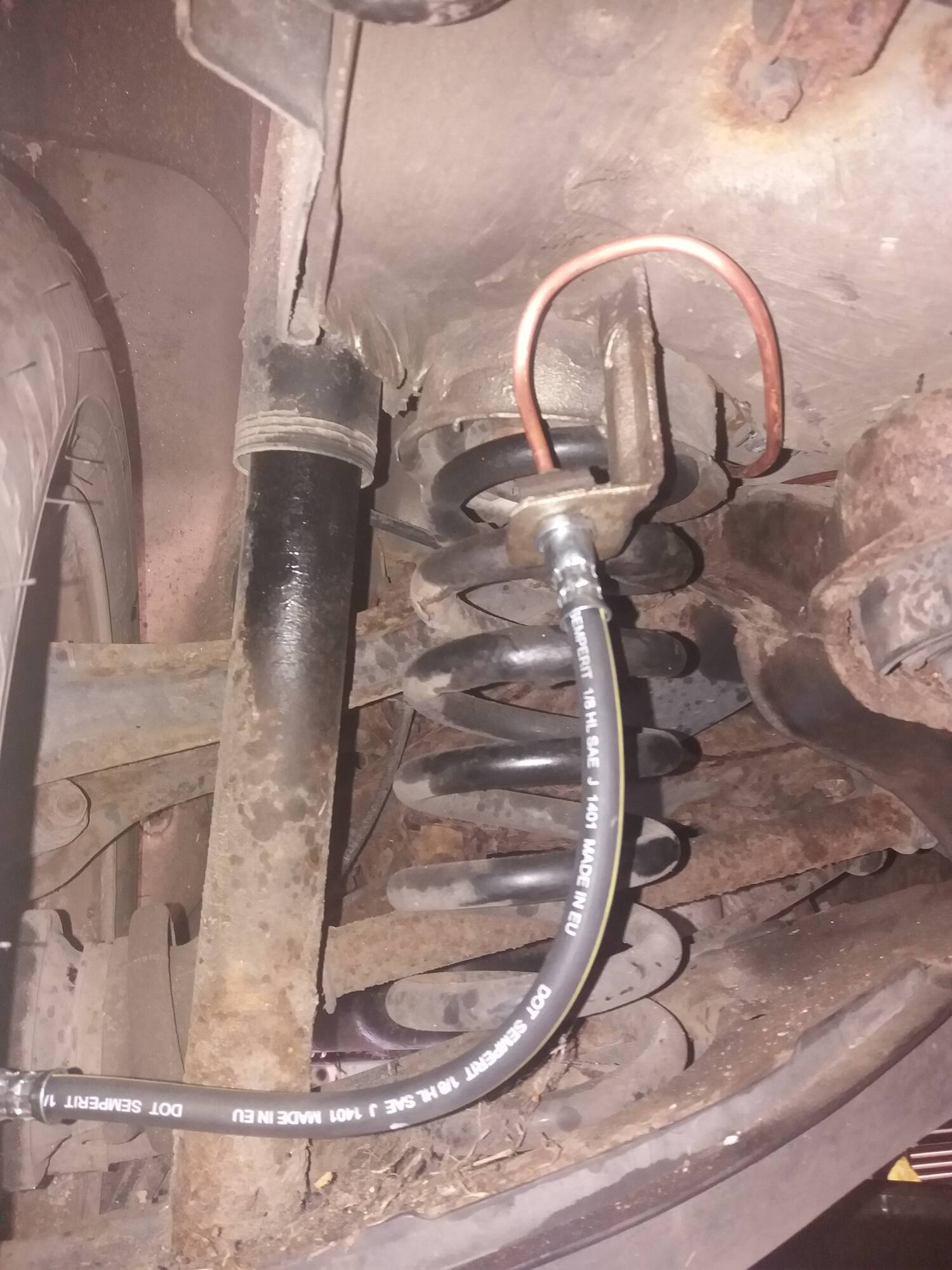

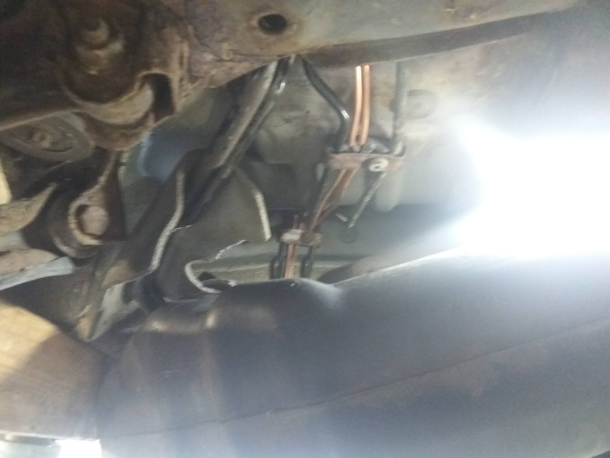

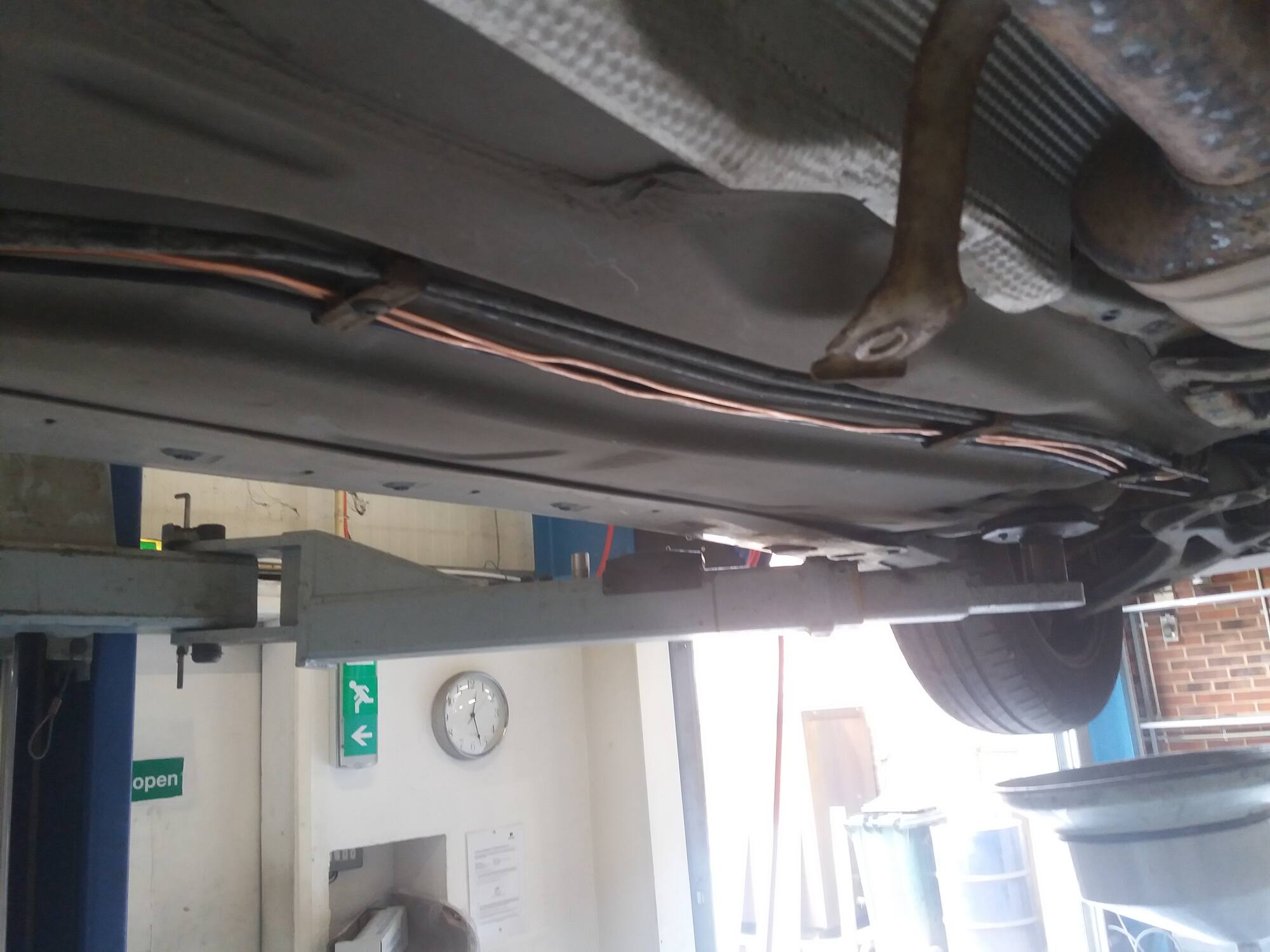

Cheers all. The old lines are out and the new ones run. Just having a tea and then I'll fit the clips back and reassemble.
Managed to do it all without removing the tank, prop or exhaust so it won't pretty but more than good enough and they are routed the correct way so will be fine.
As for the rust beneath, it's an solid so I'll clean it up and treat it at some point.
Just want the mot today as it's the last day for a retest and I'm too tight to pay for another mot. Lol
I got hold of an XR2 for £50 like that, owner couldn't be arsed sorting it's bad behavior so I made a piss taking offer.... it needed 1, that's one, spark plug. Nice Merc, would look good on the motorway next to the Jaag, 11/10.
I fitted new rear hoses too as the old unions were seized into the fitting and I couldn't be arsed so mess around for the sake of a tenner.

Just phoned the previous owner to ask about the locking wheel nut key. He has it along with the owners handbook and some paperwork which he is going to drop down. Not only that but he has bought me a bit of chocolates to thank me for saving this car from being scrapped.

I ended up using the new unused tyre off the spare for the one that failed
