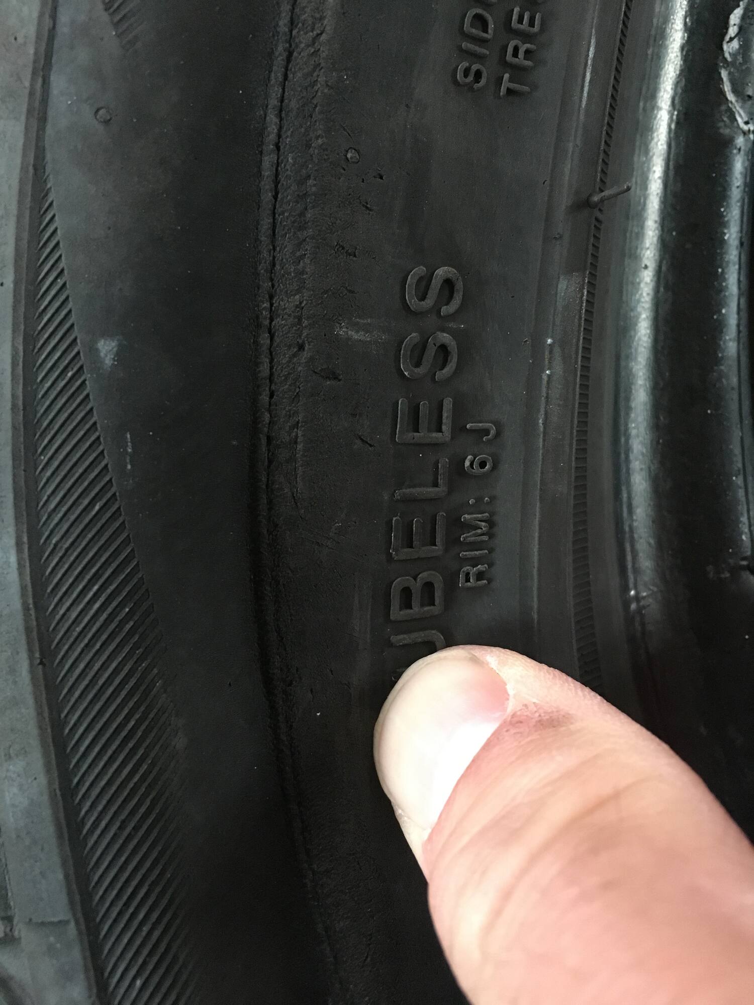

I noticed the handling was a bit ‘interesting’ going round right hand bends. It would corner ok then it felt like it suddenly lost grip. I had a look at the tyres. There two run flats on one side which were over eight years old and two random tyres on the other. They all had an alright amount of tread on them.
I decided to splash out on a set of decent tyres and ordered four Yokohamas. I was amazed at the state of the old tyres when there were removed.
cracked sidewall
another cracked sidewall

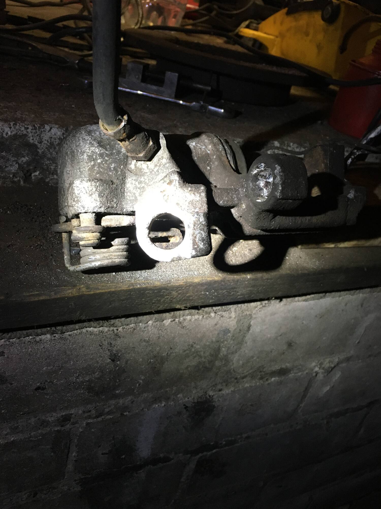

my next job was sorting the non working hand brake on the n/s wheel, it was pretty obvious what was wrong with it, this bit should be attached to the end of the cable:

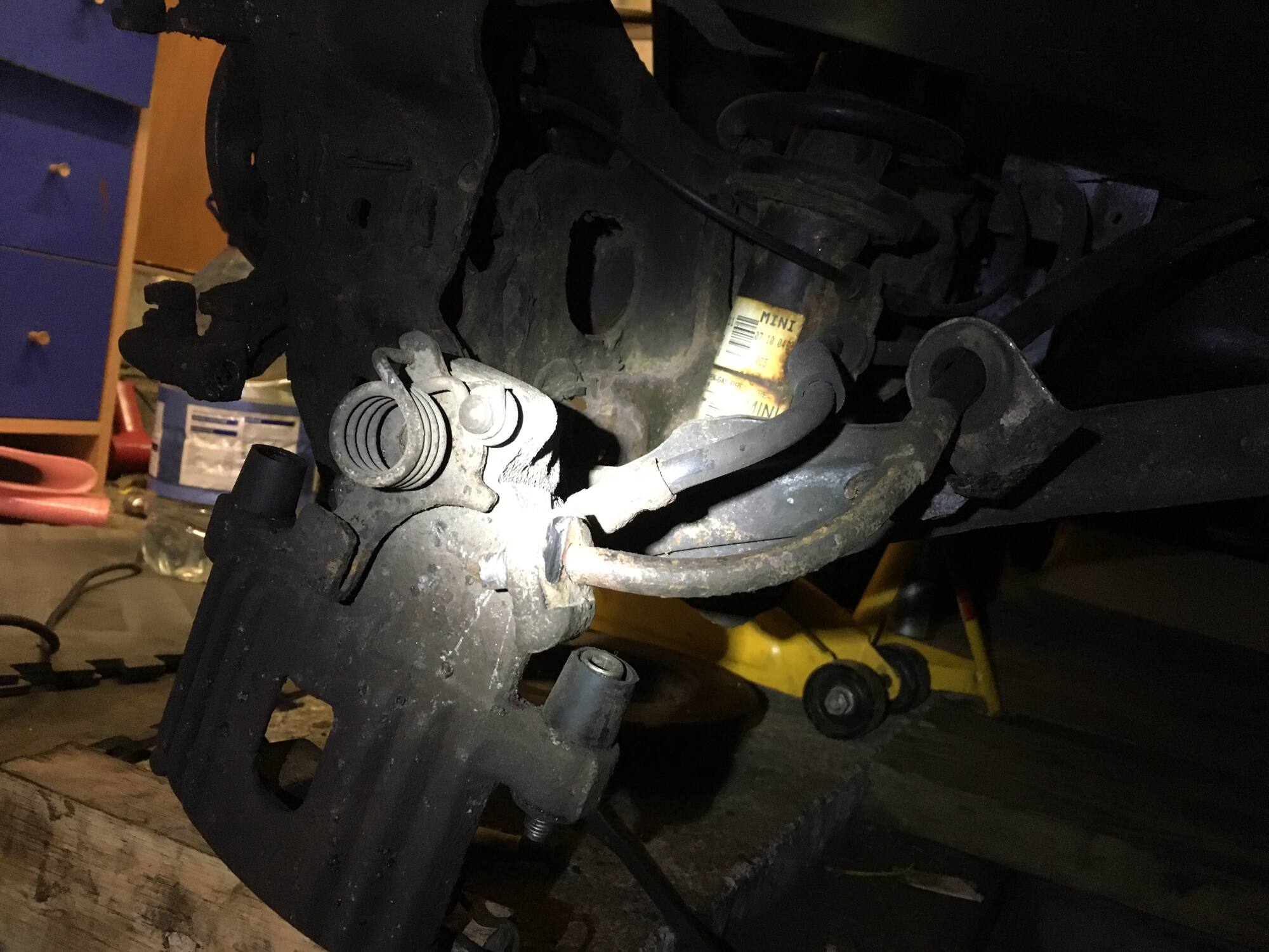

I then had to remove the old cable

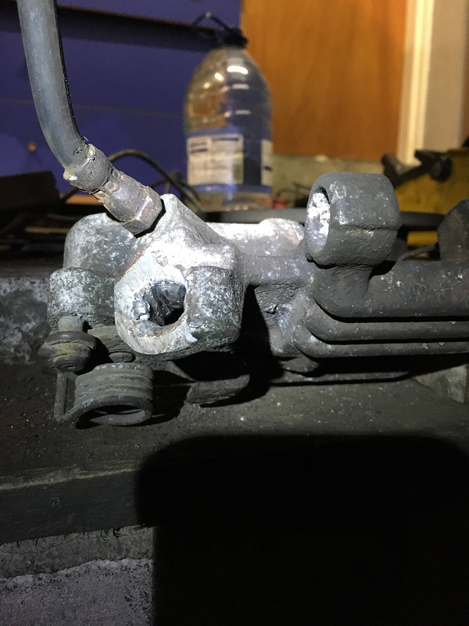

This was a total **** of a job as the cable had well in truly become part of the aluminum caliper thanks to dissimilar metal corrosion. I first cut the cable flush with the caliper IMG_0030.thumb.JPG.083f95e431e06e1bd9e619a1b469de03.JPG
I then tried to use a cold chisel to knock it out
I then tried my Aldi air saw to try and cut a slot in it, but the saw blades just rounded off. I thought the outer must have been made from some really hard steel until I tried a jigsaw on it, turns out the Aldi air saw blades are really really soft. the jigsaw made some nice cuts.
Which let me tap out the remains
Looking at the times on the photos removing this stupid cable end took me over an hour and a half.

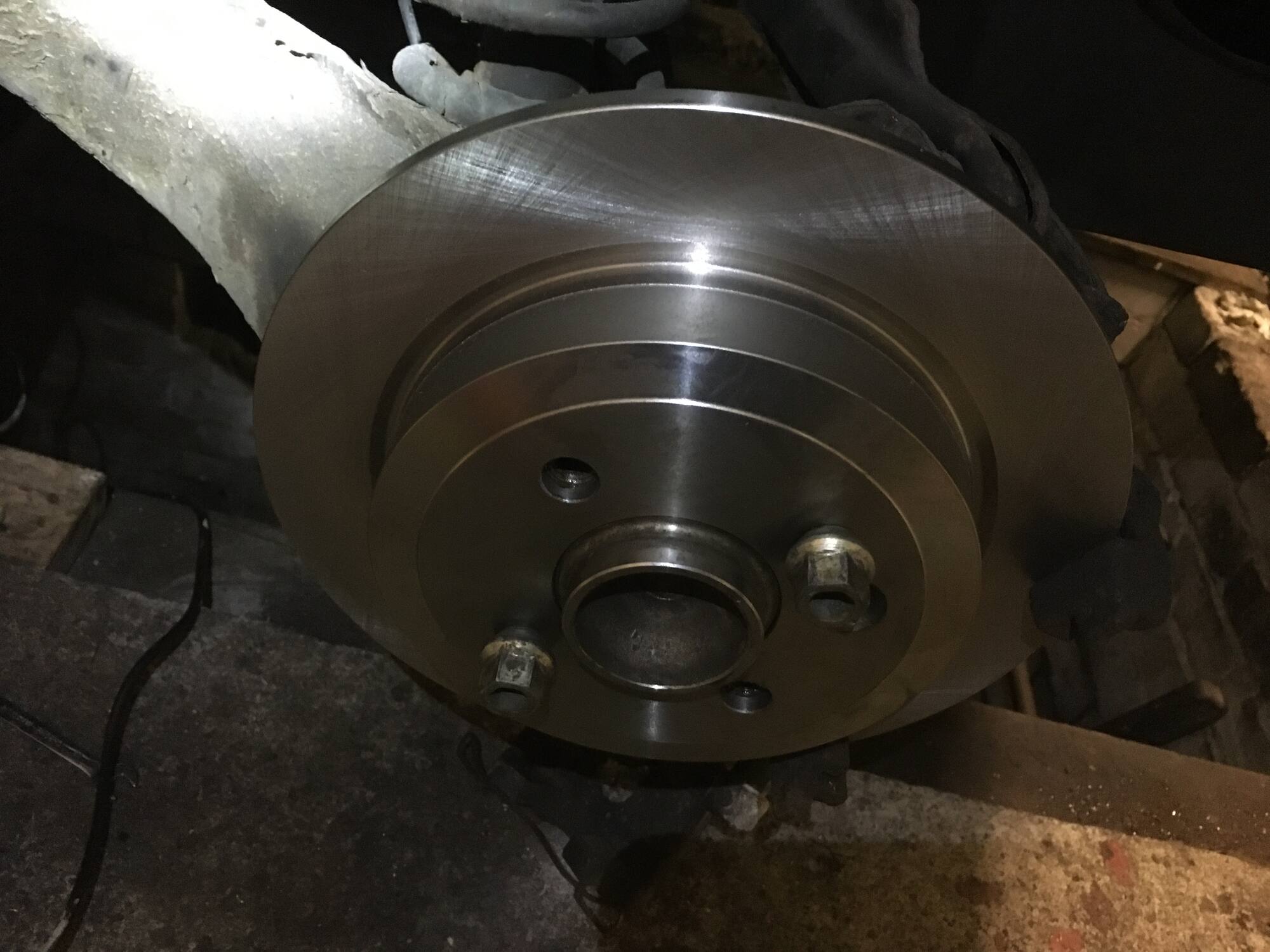

The rear discs had some strange bumps on then, like they'd gone rusty. These bumps were causing the car to jerk as it slowed down. I ordered a new set of discs and pads from ebay. Both rear disc screws had been sheared off by someone in the past so I chucked wheel bolts in to make sure they were sitting square.IMG_0037.thumb.JPG.06abef150a63b04897ed6b30cc3942d4.JPG

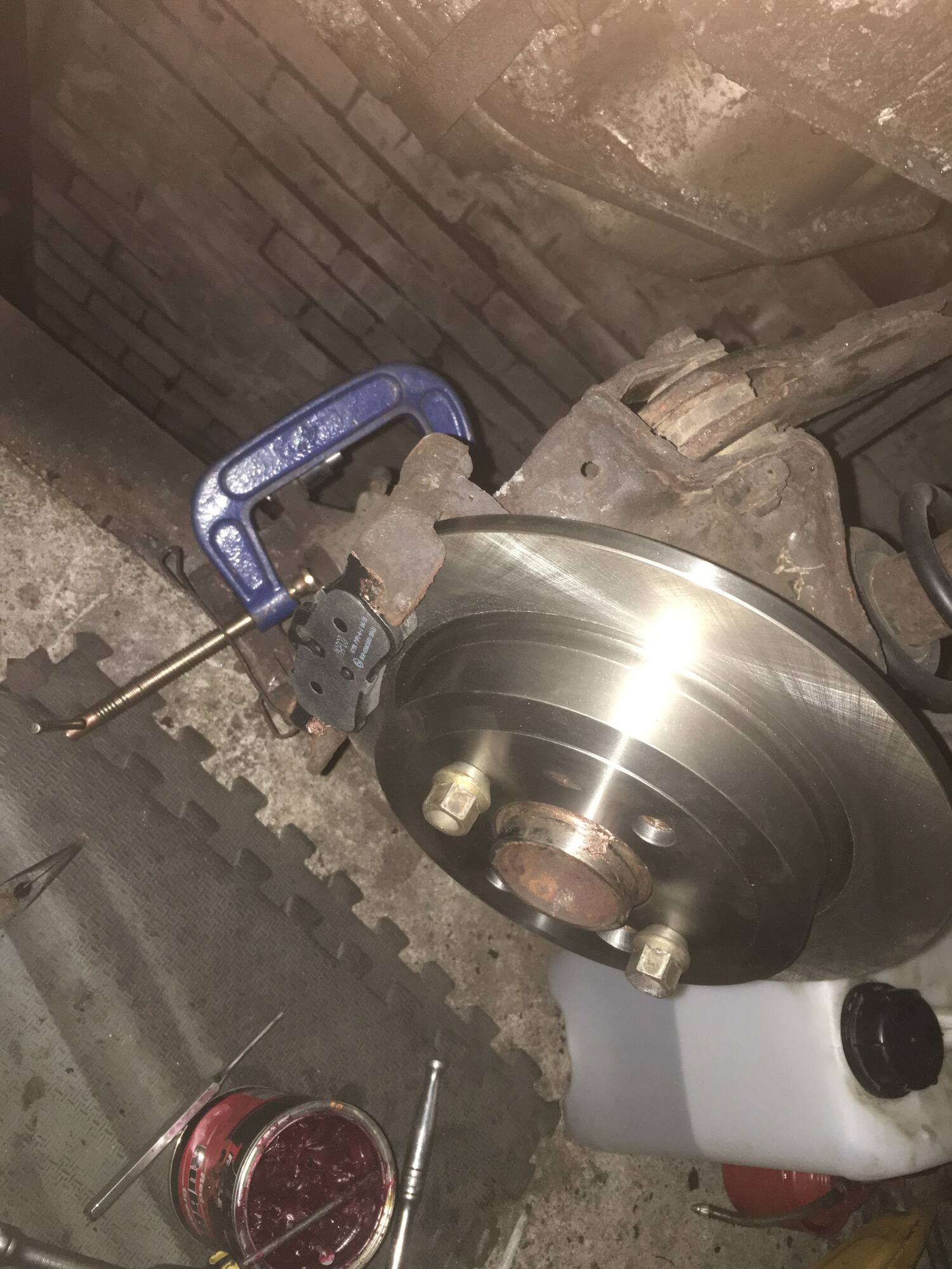

The holes in the piston were too small for my wind back tool, luckily I managed to get them back in using a c clamp and some needle nose pliers to push.
The calipers had corroded around the rubber sleeves meaning the guide pins were sticking, I had to push out the rubber sleeves and and then run a round file around the hole to remove the aluminium corrosion.
