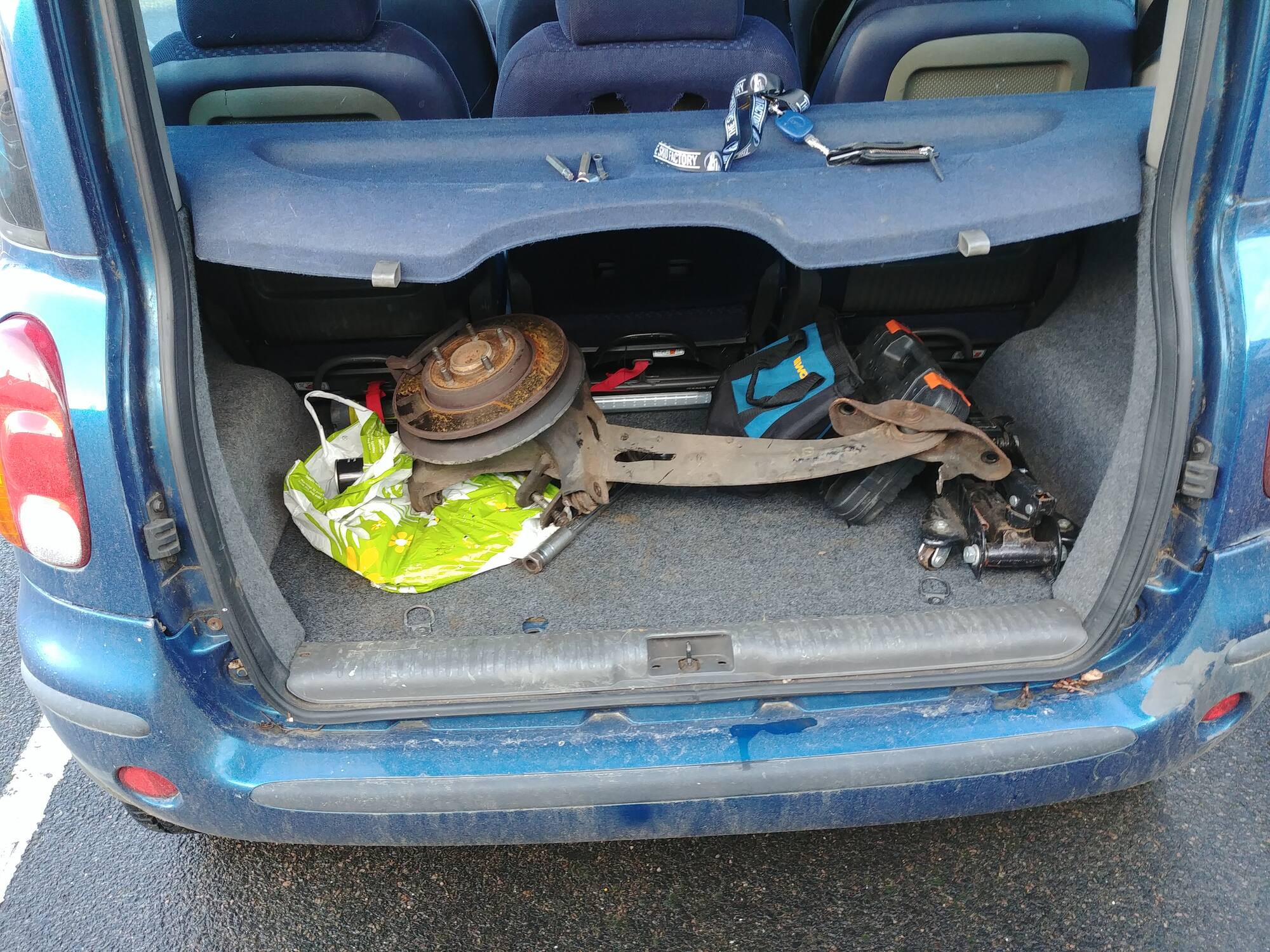

Don't let people convince you 'oh thats just a Mondeo in drag' etc etc.  When it comes to a few crucial differences it can make a lot of difference.  The injectors are due to be replaced after 100K, the Ford diagnostic software wont talk to a Jag ECU so you have to take to a Fuel system or Jag indi to get em coded in.  The rear lower control arms (another common failure) are also specific to the Jag.  Mondeo ones will put the camber out.  Check for dodgy tyre wear or a brand new set of tyres on the rear - then try to look at the bushings on the lower control arms to assess the condition.
Not particuarly difficult to change if the bolts come out...
