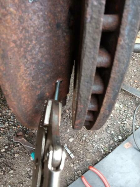

Nice sunny but cold day here today, so thought I'd swap out the A8's abs sensors.
Have had an intermittent fault for a wee while, which affects many things in this car, traction control, the parking brake, abs obviously, headlamp levelling (?!), and eventually the speedo, speed-sensitive steering and even the smoothness of the shifting.
Vcds points me in the direction of the left hand two, and although it always resets on startup, and can last a good while before coming back, it's  still annoying.
Easy fix anyway (!), one wee bolt and out they come, right?  No.  Bolt out, and half the sensor!  The long bit is firmly stuck in the hub...
Does explain why it was faulting out at least, looks like they're original and have just gone brittle.
Too cold now, so have left it jacked up for the morning.  Access isn't great, I have tried screwing in to the remains to pull it out that way, but no dice...
I still have a CV joint to do on this side (is ok, but did the driver's side and always meant to do the pair...) so will just pull the shaft out tomorrow which I think lets me see the other end of this sensor, maybe the bearing has to come out too.  Once I'm at that stage I could just drift the sensors' remains right through, grab and twist from the inner end, or just drill it all out I suppose.
Bastard.
Gradually replacing a lot of the running gear on this car I suppose, that's all the wheel bearings, drop links, cv's, tyres, control arm bushes...  None of it has stopped progress though, and it has really racked up some miles at the same time.
Passed the MOT no bother at all too, and I'd really be lost without it now.  It's just too comfy and easy, must be going soft in my old age, need some Trabant miles!
Cheers all.
GREAT SUCCESS!!!
Ever wondered how to grab and remove a  broken bit of abs sensor from an A8 hub?
Wonder no more...
Apply hammering and swearing techniques as required.
New one went in no bother.
Test drive completed, a good twenty minute run and no lights/beeps.  Happy days.

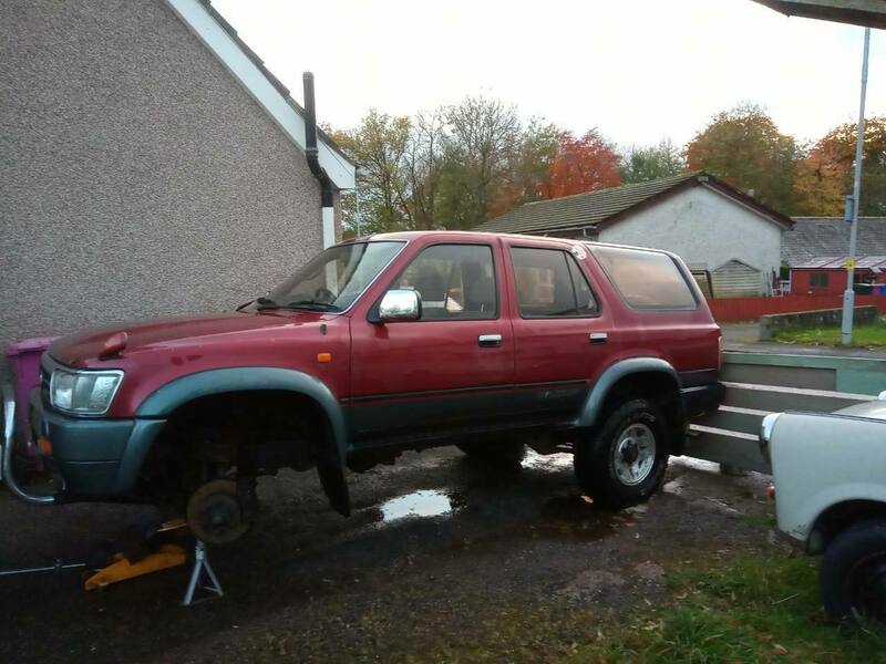

Intake assembly, thermostat and radiator removed, and everything flushed out.  All works have been carried out by my eldest, who has his theory test on Monday night, so motivation is high!
This occurred while my youngest was changing the front pads on the Surf, so it's fair to say I've added two to the 'shiter population!

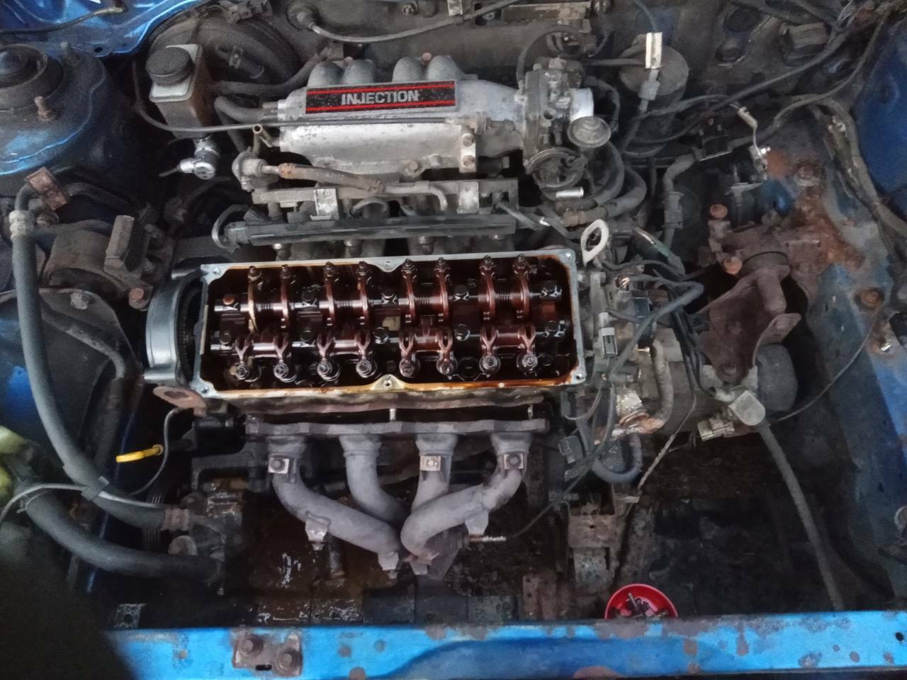

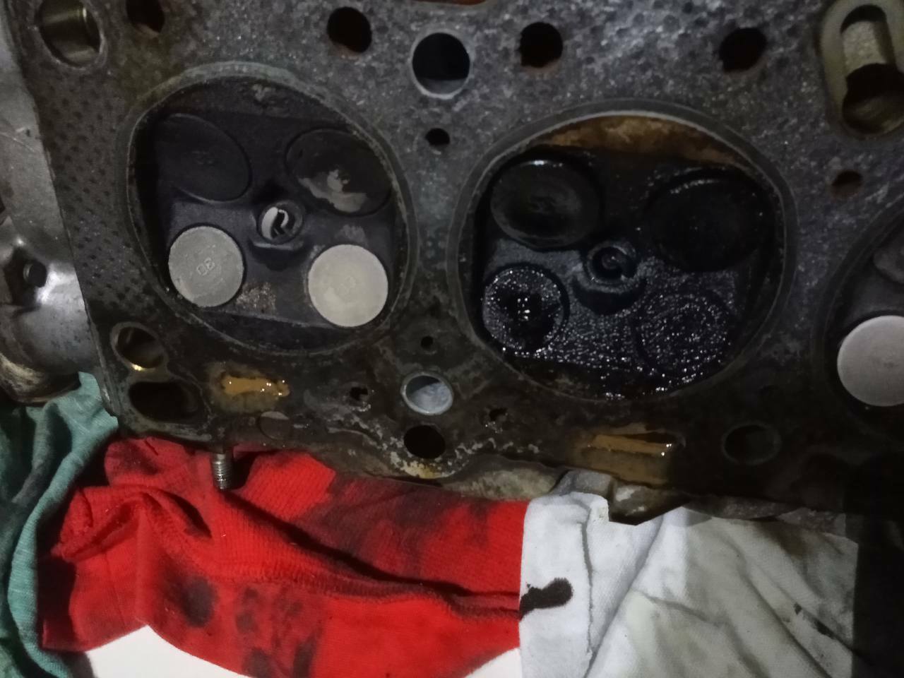

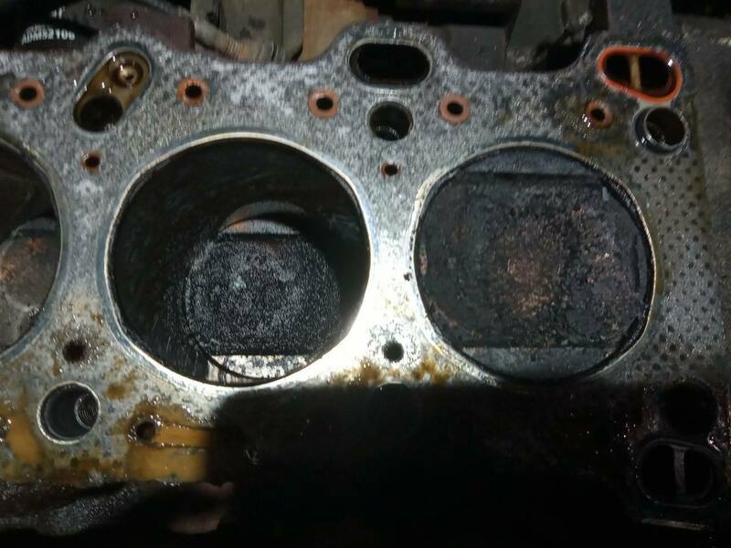

After a very disappointing weekend weather-wise, we decided to do a bit tonight, and so the wee Mazda is inching closer to the road again...
Couldn't reach the last nut holding the intake manifold/throttle body thing onto the head, so pulled it all off together.
Number three cylinder has seen things... and number four has collected some crud too.
Number three on right, below...
Others seem happy though,
so over the course of the week we plan to clean everything up (a lot of engine bay sprucing is planned while access is so good), and I'll be Denso-taping everything in sight!
All good so far then, but we haven't had a good look at the cylinder head yet, hopefully no crackage/warpage has occurred.  Will see tomorrow night, I'd forgotten how much fun* it is working with crap light in the cold, and have come in for a cup of tea.
Did make a friend tho'...

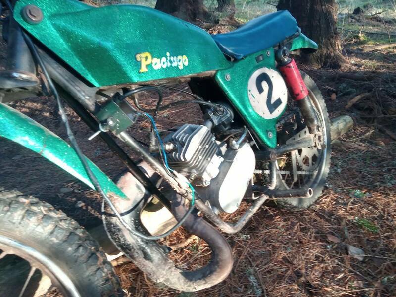

A 1970's Tecnomoto Paciugo!  Little kids twist & go thing, that came fitted with a beautiful wee Franco Morini motor...  sadly a knowledgeable machine shop will be required to get that going again, the crankshaft is damaged where the Woodruff key engages the magneto bit.
So, I gave my youngest budding engineer a Chinese 80cc lump (designed for fitting to a pushbike) for his birthday, to see if we could get her going...
So far so good, chain alignment is fine in the position shown, and the required brackets have been prototyped in cardboard, for me to make up in steel tomorrow at work.
Bit of fun, both in the making and (hopefully), razzing round the woods before too long!  It's a bike that only ever really ran a few times when the kids were the right size for it, but we all fell in love with it anyway!  I've even seen them push it up some fair hills just to freewheel down!

In other news, and to cheer us all up, we had some fun up in the woods with the wee Paciugo today...
Chinese 80cc all installed and running well, although a fair bit less power than the KX80 to put it mildly!  Revved a lot easier with the air intake assembly removed, and incredibly easy to start (bump start only on these units).
Managed to fettle a better exhaust on ( can't remember where it came from, but I never throw anything away!), Which has helped I'm sure...
Great fun, and nice to see one of their favourite old toys come back to life.  It'll sit around mainly waiting for the Grandkids to appear now I suppose!

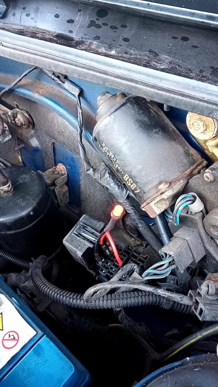

Just in from our daily Mazda fettling session...  Started and ran smoothly (but smoky) despite the minus whatever temperature we have here this morning.
Once up to temp, we shut her off and removed plug number 3 to allow a fresh dose of ATF.  This time, a lot of smoke came wafting out of the cylinder...  could this mean that gunk is starting to soften/move around?  I poured in the next dose, and could hear and see it bubbling away in there.  We gave her a rock back and forth in gear to wiggle the piston and will see what tomorrow brings.  Where there's life there's hope.
After that we gave the diagnostic led a whirl, which worked perfectly (it was made for a MK1 mx-5, but I thought it'd be similar as the engines are closely related).
Via a series of Morse code flashes, it informed us of one trouble code, the O2 sensor.  Totally expected given the amount of oil it's been exposed to lately.

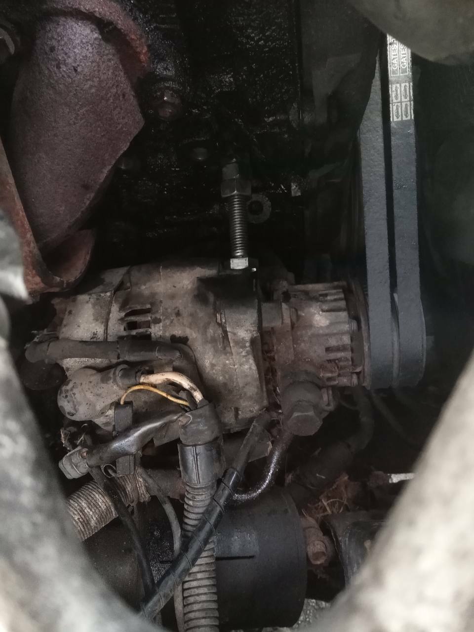

The old girl repayed this kindness with a sheared alternator adjustment lock-off bolt... dissimilar metal corrosion and hooning around in the mudsnow are, I suspect, equally to blame.  I had noticed slightly squeally belts, and so this service included their replacement.
The sheared bit of bolt remained entombed in the the alternator lug when I removed the rest, which was literally hanging by a thread.  I was staring down the barrel here, potentially having to remove the alternator/drill out remains/refit and bolt up with a nut on the back, which all seemed very tedious with night time encroaching rapidly.  I engaged 'thinking outside the box' mode, and started bodging.
The bracket that includes the adjuster rail for the alternator is a big old lump, as it used to carry the long departed air con compressor, that I launched when it got in the way years ago.
(It is pictured below on a genuine factory Trabant rubber floor mat, especially for Jim Bell)...
This seemed like a good bit of weight-saving, and with my Nurburgring lap time foremost on my mind as always, this too got launched ( into the garage though, not the bin).
Replaced with...
That's right, it's a set screw with a specially notched head to lock into a perfectly placed notch on the alternator!  I know right!  The other end is screwed into a set of three nuts (welded together) to provide suitable adjustment of length.  This end located in another perfectly placed notch in the engine block!  It's solid as a rock!  Will the MOT man notice?  Will he mind if he does?  Who can tell?!
I have completed 57.4 miles since, and all is well.  I do, however, promise to fix it properly in the summer...

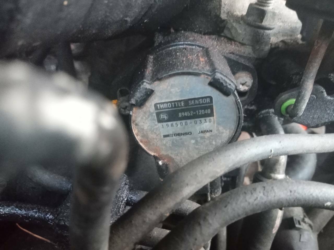

Hi all, had a shock FTPATCP (failure to proceed at the correct speed) in the jeep!  It went into limp mode, I didn't know it could!
A wee hesitation on the way to work one day, and a reluctance to change into top were the first signs of trouble.  The next morning, while bowling along in the dark, the engine dropped to 1200 rpm, and would not rev higher.  This led to a very frustrating time for following lorries while I crawled to the next layby (just south of Rothes, if you're interested...).
Turning off and on again worked for a wee while, but things didn't really improve.  Thinking along throttle/fuel lines, I cast my eyes along the intake side of things and noticed the following...
Tucked away under the UFO looking thing, is a throttle position sensor, who knew?!
The engine ran so well that I knew it wasn't anything mechanical, it just wasn't listening to instructions.  I think the above sensor has a tired bit at '58mph' setting.  I was surprised to find all this out as the ol' girl has a cable operated throttle, but apparently altering the air side of things has very little impact on acceleration in a diesel, it's all down to fuelling.  Controlled in the Surf's case, by an ecu connected to the TPS.
Nursed her along until last Saturday, when I removed/excercised/cleaned out the offending part, and she's now going great guns again.  I did order a used but shinier one to keep in the shed for eleventy-three years, or the next hiccup, whichever comes soonest.
To celebrate normal service resumption, the kids removed the poor old thing's air filter to make her sound like a Supra (surprisingly close, actually), and fraped her round the woods a wee bit...
A week has now passed, and the fix has remained good, even today's MOT was passed without much pain.  Advisories were limited to a rusty brake bias valve/line, and a leaky engine.  The cambelt is 10,000kms away from replacement, and I plan to sort the front crank seal at the same time.  Not much is getting past, but she does go from max to min on the dipstick between services now.
