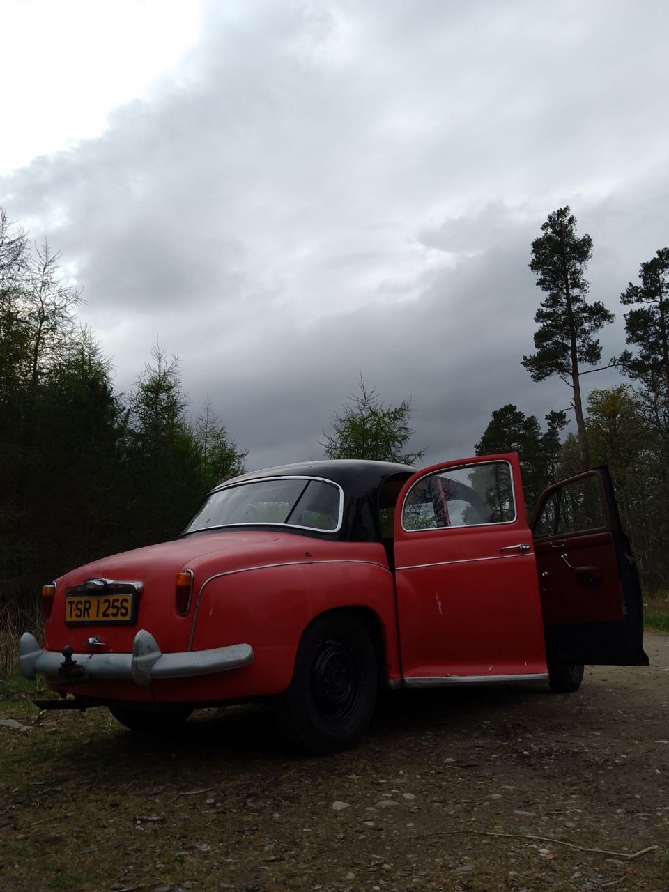

P4 electrons are flowing again!
Literally took five minutes to plug in the new voltage regulator, and that was that.  After a short time running, I see 14v across the battery terminals, and no red light on the dash.
The fuel gauge has sprung to life, and the fan is now twice as fast.  My dashboard ammeter swung up to max for a few minutes (I assume the battery needed a pick me up after so many starts without getting anything back), before settling at 2/3rds.  As I suspected, the ammeter is wired the wrong way round, so it has been left alone following a negative earth re-flash at some point...
Anyway, to celebrate, I swung the old lady out of the drive for a run up the lane.  She's covered in bird doo doo, and the linseed oil shine has faded somewhat, but still proved a graceful way to travel.
The 323 support vehicle couldn't keep up over a rougher section of track, despite it's fresh rear suspension!  Made of strong stuff these old Rovers...

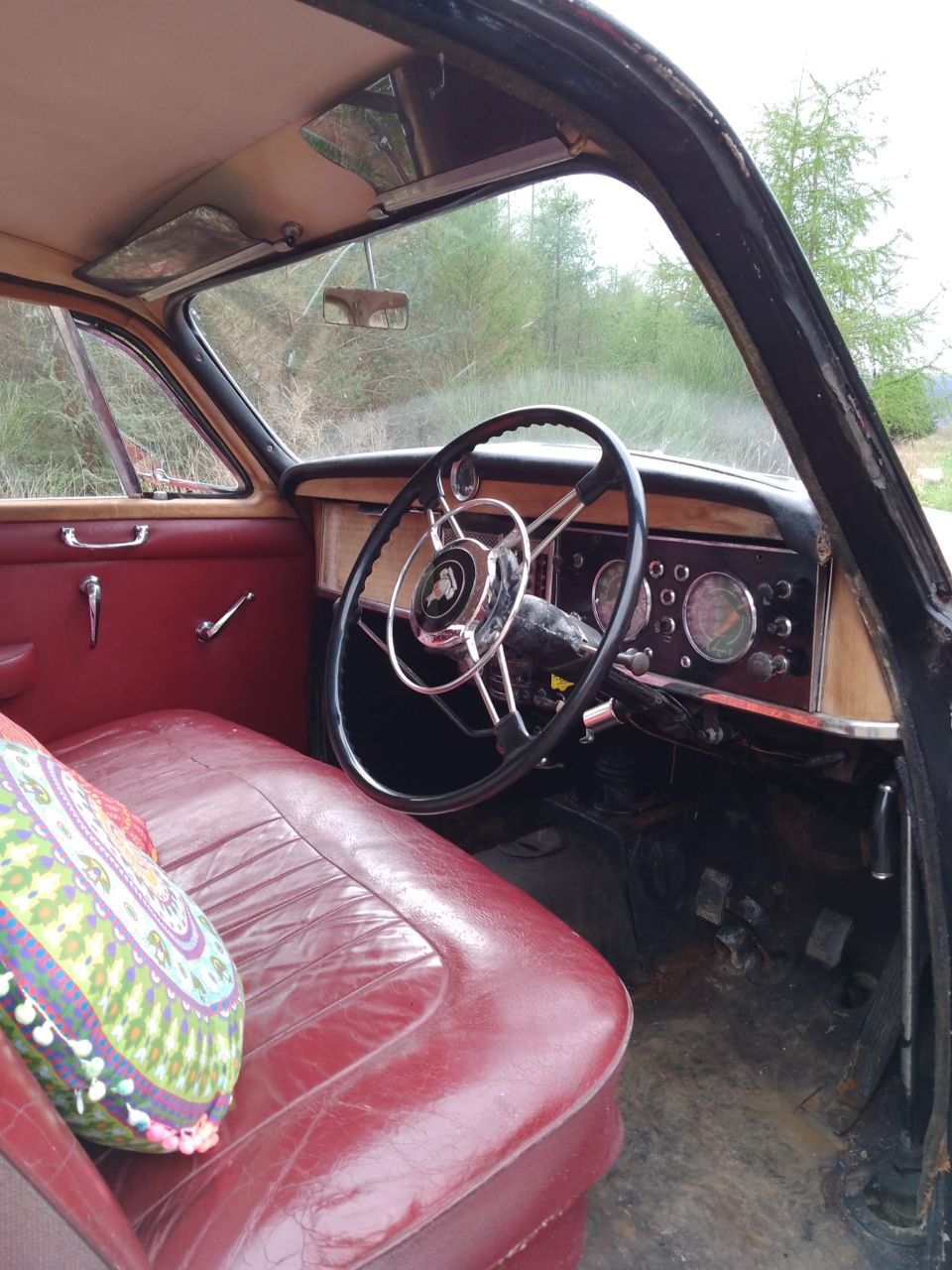

Needs some carpets...
One similarity with the RX8 anyway...

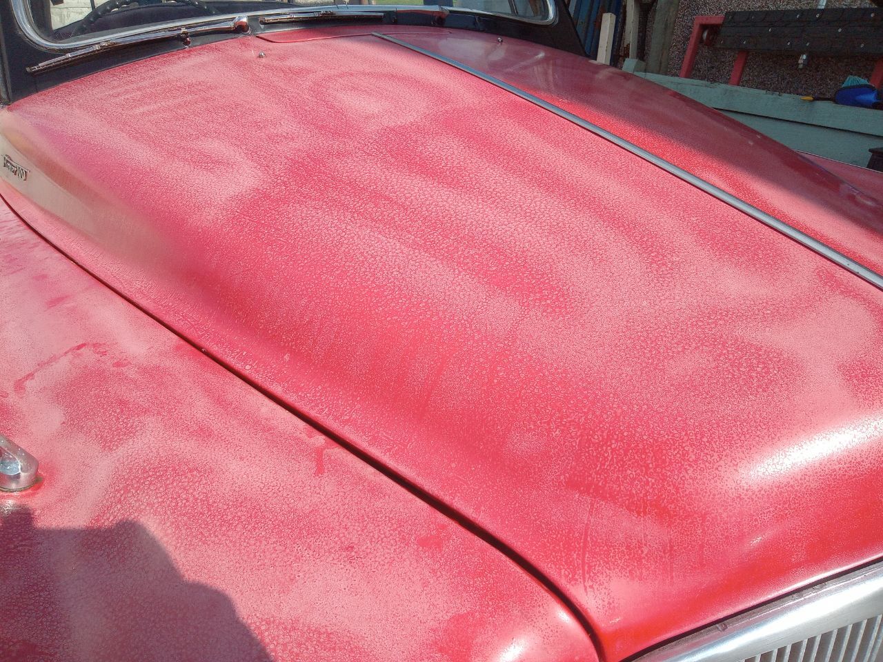

I then noticed that my radiator top tank has been brush painted at some point, underneath is shiny...
This will be a labour of love, polishing it up a wee bit at a time I think.
Next up, I wanted to update the linseed oil 'shine juice' status, and try a slightly different application method.  A quick wash left this...
Almost back to how she was on arrival, but you can see the pattern I used to apply the neat boiled linseed oil last time.
It was a couple of months ago I think, quite cold and damp, and took an age to flash off.  This meant a lot of dead bugs stuck to the car, and wee dots where the rain then sat on it.
This time, I mixed my BLO 50/50 with thinners, and obviously today was a much warmer, nicer day.
A decent result again.  I rubbed it in more this time, a little went a long way, and it was touch dry after about an hour.  I think I could go over it again if I wanted, but it looks good in that old car/old paint kinda way!  Did the roof as well this time, which has come up lovely.  This takes no time at all compared to polishing a car, and considering how faded the paint actually is underneath... amazing.

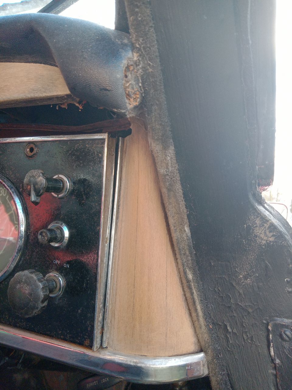

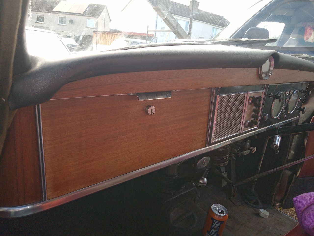

Next up, the wood.  After a very light sanding, I was left with this...
I actually quite liked the light colour, I don't know what wood it is, but it was obviously needing a bit of love.  Out again with the linseed oil...
I've still the back door cappings to do, but a nice way to spend an hour or so I'd say.  It was very thirsty, so I'll probably be coating it again before long, build up the colour and shine.

I think the wood is African walnut.

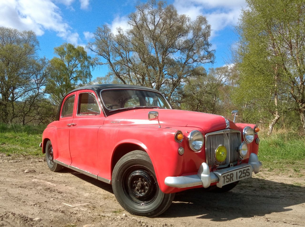

Haha!  Full power achieved!
The pink P4 has reacted well to new (hotter) plugs, leads and a twiddle with the distributor base plate (NGK B6ES out of interest, same as the Trabbi I think).  Also learned a bit about the SU carb from my old AA Book of the Car, which has helped me lean out the mixture a wee bit.
She has a lot more pep, and actually feels willing now.  There's a lovely straight-cut whine in first, and she wouldn't be holding anything up out on the road, that's for sure...  I've seen 40mph along my private test track, there is now a real need for the refit of the brake servo and I can justify ordering tyres too.
I've checked and re-secured the exhaust, which although rusty, is actually solid.  I'll clean it up and give it a lick of high-temp paint.  While the wheels are off I'll carry on with the underbody refresh/protection.
The clutch bite is high (smooth now though), perhaps not long for this world, but then I don't have a reference for these, it may be normal?
The inline fuel filter has required cleaning out, as well as the float bowl... I keep adding fresh fuel and will monitor the situation.  Maybe dropping the tank is in the offing, which would let me sort the reserve solenoid too, which currently doesn't work.
In short, she feels really close to the road now, and I am one happy camper 🤣🤣🤣.
