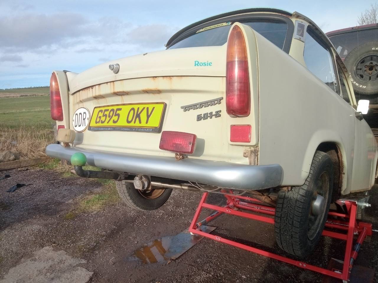

Got a new toy!  Rosie was employed for testing duties...
Bloody marvellous thing, you can see-saw the car end for end by hand.  Feels nice and solid too, my driveway is a tad* uneven so I've had to put plates down for the wheels to roll on.
I bought it second-hand off a colleague, but it doesn't seem to have been used much.  I've set it up for wider than he had it, the Trabbi just sits on the pads and no more, but it should take the 323, Coupe and maybe the RX8.

That's going to make so much stuff easier. Am more than a bit jealous. Great purchase.

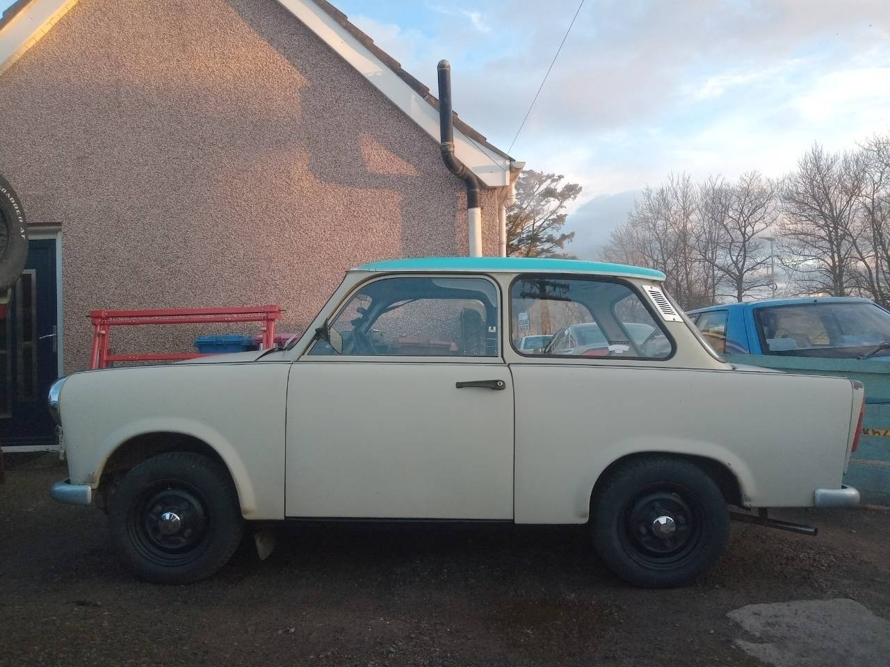

Couldn't resist the opportunity to tinker on the Trabi while she was up, so have had a good day's scrubbing and re-oiling...
Will need to attend to this rear panel again soon, really is looking scruffy now.  Even that'll be easier with the lift though.
Here's a pic for Zelandeth, shows the difference between my old-style hubs and his fancy new-fangled ones...
They're pretty much the same both ends, the front drums have cooling slots in to handle the massive heat build up on re-entry to the village obvs...
Spent the day wire-brushing, then painting and or oiling everything that moved.  I even scrubbed and re-painted the wheels (inside and out!), a perfect day.  My youngest was doing the same on the old jeep, will update that when we get it back together.
More pics...
Can't believe the original underseal has lasted so well, god only knows what it's made of!  The car is actually older than registered, built in 1983 (they were often returned to the factory, rejuvenated and re-vinned, then sold again apparently, hence the '89 reg).  So yeah, not bad for forty-one...
And down.  Still needs a wash and hoover, but I'll do that in the morn, weather permitting.  I plan to commute in her as much as possible now, it'll let me get a bit of a tidy up on the white Audi (needs a bit of paint now) this summer.
So, she's running well, and I feel better having undone some of the salt damage she endured standing in during the A8's abs saga.

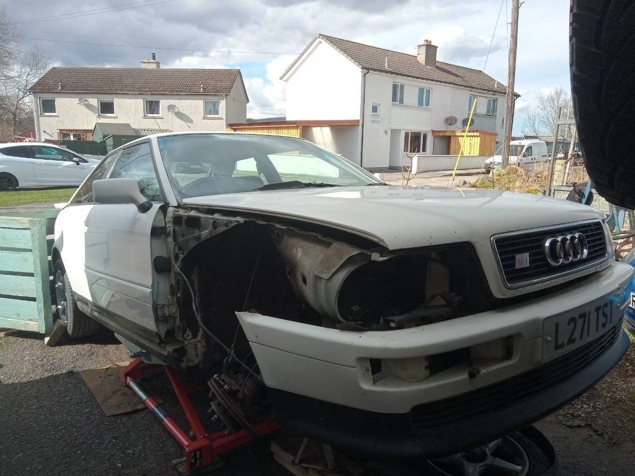

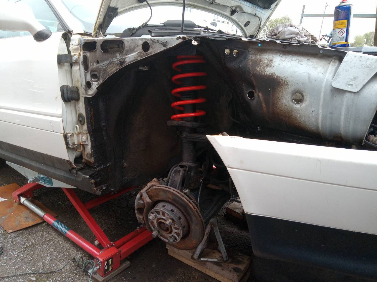

The Audi Coupe had its turn up on the new tilty-ramps today, to let me at the broken front spring.  It lifted the pretty nose-heavy old thing no bother... with the front end pointing skyward, the rear wheels are touching the deck, but only just.  I stuck an axle stand under the subframe just in case she wanted to play see-saw.
The offside spring was broken at the top, meaning the coil had jumped up past the shock cap and was hard against the inner wing.  This meant I'd have to compress it before pulling the strut out...  This seemed like quite a faff, so instead I cut the spring up with the angry grinder... much easier!
I really should look into getting the proper tool for undoing strut top nuts...
That's my brand new 22mm socket getting abused already.
I cleaned everything up, wire-brushing and treating the strut to some Fertan (German Vactan), it's marinating now under the bonnet...
It takes longer to go off than the Vactan, eventually turning black.  It's the favourite amongst boaty types apparently, and I couldn't see Vactan on eBay any more?
I'll give it a coat of chassis paint before reassembling with the new spring.  I'm waiting, however, for more new bits as unbeknownst to me the nearside strut top rubber has left the building!  I'll replace the pair, it didn't seem to have any impact on the driving, but was just floating about as soon as the weight came off it.  I'm on lates tomorrow and Sunday, so might get the other side dismantled if I'm energetic in the mornings (unlikely...).

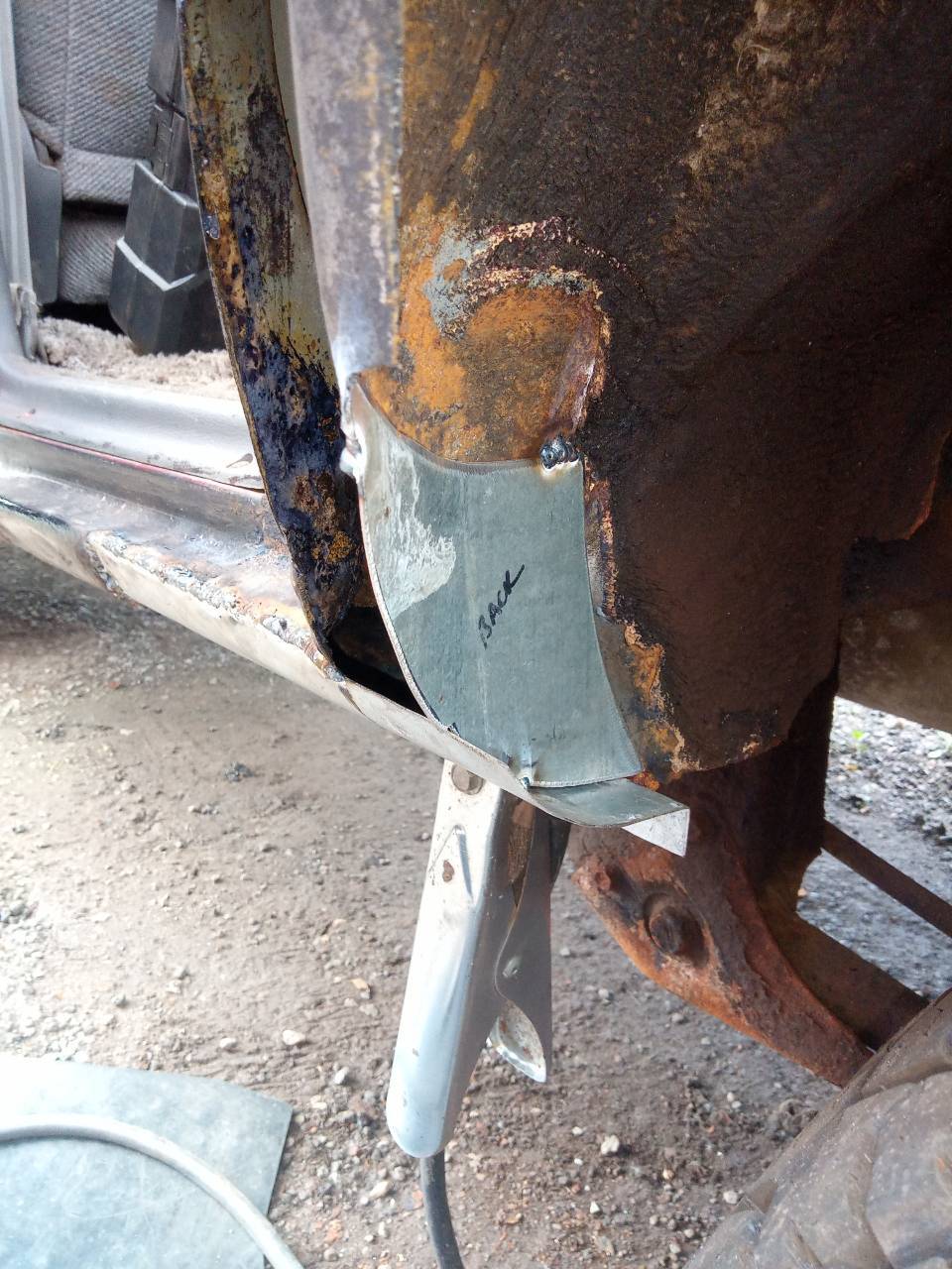

SIGNIFICANT ESCALATION OF WORKS ALERT!!!
Shouldn't be surprised by now, these 30 year old motors are never straightforward!  Whilst stripping out the strut for spring/top mount replacement, I found a bit of rust...
Vigorous poking and prodding revealed the full extent...
It's a weird place for it.  Seems like the water running down the wing top gets to this point, gets stopped by the wing bolt, and then runs down the seam.  Maybe a brake fluid spill in the distant past or something compromised the paint.
Anyway, the cereal box came out, and a patch template has been formed...
It's a bit of a compound curve job, but should be do-able with a bit of tacking and whacking.  I'm in work later on, so can't be arsed getting the grinder and welder out today, but weather permitting, will do so tomorrow.

So, today I broke out the welder-up machine for a go at turning my cardboard design into metal...
The story in pictures...
Bit of a tricky shape, so required the weld-whack-weld method.  I've tried to match the original, so my first go at plug welding along the back seam was first... I could then hammer the rest down into shape as I went.
I have stuck to the method I used in the Mazda, cutting a smaller than required hole out, bending the edges away slightly to let the new piece sit in, then welding up.  It leaves an extra bit of old metal on the back, but careful dressing back of that gives a neat finish, and the weldings easier as it's then lap welds as opposed to butts.
This was much easier than the RX8... Better steel, new gas (hobbyweld) in the welder, and a bit more experience I guess.
Anyway, rain stops play so I'll dress, fill and paint another time, then new springs on and back on the road!

This is post dressing up the welds a bit with the flap disc, and the application of some Fertan:
Hard to see in the pic, but came out quite neat, and even the plug welds show good penetration.  Had a good scrub around the area, pulled off some loose factory underseal but didn't find anything else dodgy.
Planning a skim of filler over the patch on the inside, as it's visible, and I don't want to remove too much of my weld to make it smooth.  Again, splashed a bit of Fertan around as a preventative.

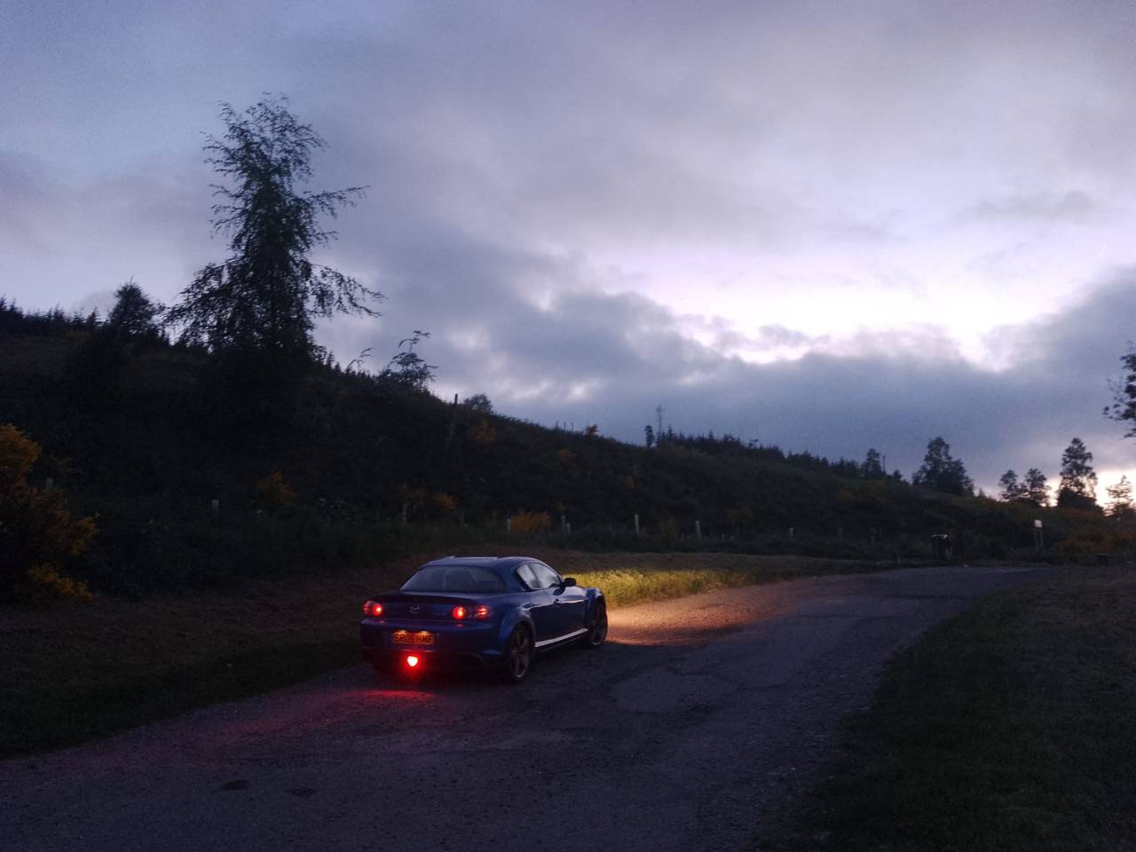

It's been laid up for the salty months, as I fear it may actually dissolve if exposed!  My fears are well founded, there is more 'weight reduction' to sort, but will get into that closer to MOT time.
I'd actually forgotten to SORN the old girl, and realised one sunny day that I had a road-legal rotary weapon just sitting ready to enjoy... or so I thought!
I nicked one of the jeep's batteries (it starts fine on one), and hooked it up.  The engine started well, and I hit the road in Scotland's roughest RX8.  Within a few miles, a misfire reared it's head though... no acceleration to speak of was available.  It felt like when an old two-stroke bogs down, not good.
Got home and sputtered back into the driveway, defeated...  Googling RX8 issues is depressing, it's one of those cars where even it's own enthusiasts seem determined to do it down, or put people off bothering with them (I find the Trabant forums tend towards this too).

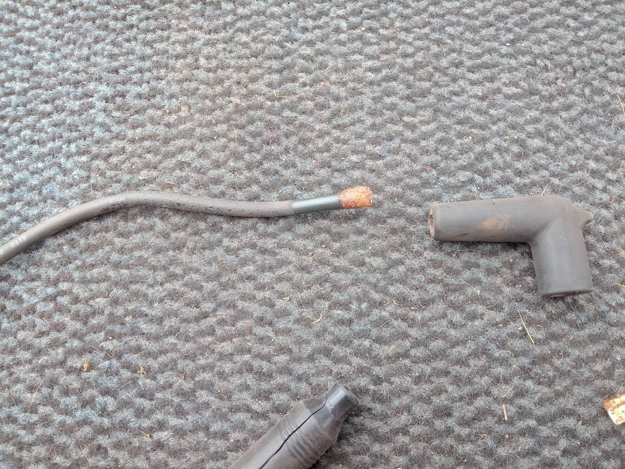

Anyway, I stopped looking at that, and started on the car.  Pulled the passenger front wheel off for a gander at my spark plugs... always a good indicator of engine malfunctions.  The RX has four, a leading and trailing plug for each rotor, pictured below...
Handy access...
The eagle-eyed will have spotted one odd lead in the top picture, the trailing plug of number 1 dorito.
This is because, when I removed the original lead, I found a perfect spark plug, and a totally vapourised connection!
That's all there was, there was nothing touching the plug inside the boot!  I've never seen it before, and the other three were fine.  I butchered a new lead I had in the shed (bought for an ill-fated e28 many, many moons ago), pulling off and re-crimping the Mazda ends on.
It worked perfectly!  Turbine smoothness and general rapidity is restored, better than ever really.  Chuffed with such an easy and cheap fix, she will now get the welding work required before the MOT in a couple of months.

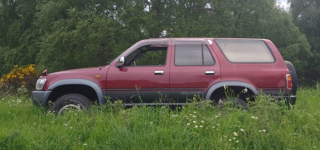

Jeep repairs continue apace, this week saw two doors and both front wings replaced, and the front end put back together.  I then set about removing the rear wheelarch trim to rub down and paint the sill end, which wasn't really very 'there'...
I don't even think about it anymore, just off with the rust, and out with the cardboard/welder/bits of random steel...
Cobra Beer packets definitely* are best for template purposes.
None of this is particularly pretty, but it is fine and strong, and the vast bulk of it is covered by the plastic arch trim anyway.
Anyway, weve had much fun testing out the new ball joints, steering arms etc...
And just sort of hooning around...
Cheers all.
  • Like 9
Well, it's starting to look like a Surf again, new doors on one side and front wings looking fresh...
We're loving the Toyota sump guard that was included in the spares haul...
Bit of bling, currently cable tied on.  Also went (just) off road...
All systems seem to have survived her protracted spruce up, so won't be long now.
  • Like 10

I have had an EML flash up, the VCDS diagnostics read this really well thankfully, so I know it's the post cat oxygen sensor.  I took it out for a clean, and discovered it has taken a whack at some point, the mounting position is ridiculous, sticking down lower than the already very low exhaust pipe.  A replacement is on the way, £18.  Apparently it has no input on fuelling etc, but just confirms converter operation.
The welding work required has been scoped out, so I'll get to that nearer the time also, for now we're just enjoying the car.

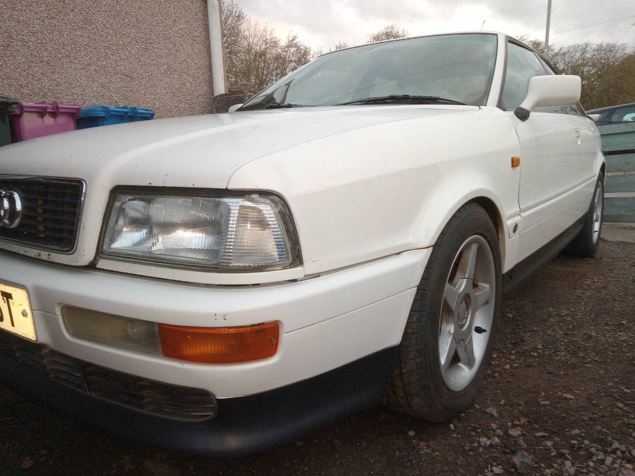

The eldest of my young shiters has expressed a desire for a bigger car, so I'm keeping half an eye out for something 90's and estate-shaped, to replace the 323.  We're not in a rush, but their band is taking off a bit, and the wee Mazda's not big enough for the amps/guitars etc, and the band.
He really likes the look of the Audi 80 estate, and I think after a couple of years good driving since he passed, that he could handle one ok.  We'll see what comes along, he's saved up a bit, and I'm sure the 323 would sell ok to somebody retro-friendly (following the aforementioned tidy-up)...
