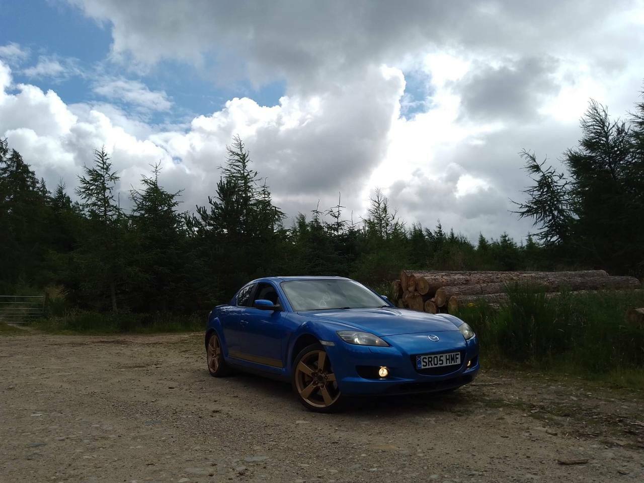

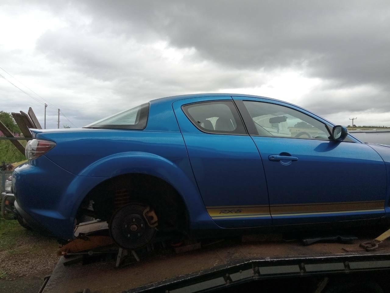

Thanks man, I wanted to try one before they outlaw them.  It will never be concourse, but if I can get it solid and mot'd for next summer I'll be happy.
It seems mechanically good, very tight and responsive car.  Nice stainless exhaust and fancy suspension and brakes.  Air con was ice cold, and everything worked inside too.
There is rust and poor repairs everywhere, but it was at least cheap at £400!
Definitely brings out the hooligan in you!
Had a good old look at the car now we've washed it, and it isn't as bad up top as I thought.  Every wheelarch needs something, but I think they could all be tidied up without having to weld anything in...  Will see more tomorrow when we get the liners out but I'm not too worried.
Underneath may hold more horrors though, I could see a hole developing behind the front nearside wheel during the viewing, and an awful lot of underseal slathered about.  The sills have been replaced already, and feel solid, but as always, they may need tidying along the joint with the inners.
Mechanically, I'm pretty impressed!  The engine has good oil pressure, starts well hot or cold (with a decent battery!), and pulls well.  The exhaust is a bit loud for my taste, and pops when you come off throttle, but when you're just cruising it is quiet.
The coolant was at the right level, spotless looking, and even the oil was pretty clean.  The boot held a half- empty bottle of engine oil, and a measuring pot for two-stroke oil.  The guy I bought it from had two RX7's, he and his dad were rotary mad, and with its low mileage I'm starting to believe it might be alright...
We've torn around the local lanes for an hour or so now, nothing has dropped off, levels and temps all good, and we all love it!  It's a strange power delivery, like a two- stroke bike, but genuinely fast.  The brakes are drilled and grooved discs, and it stops very well.  Tyres aren't the best, so proper hooliganism will have to wait!

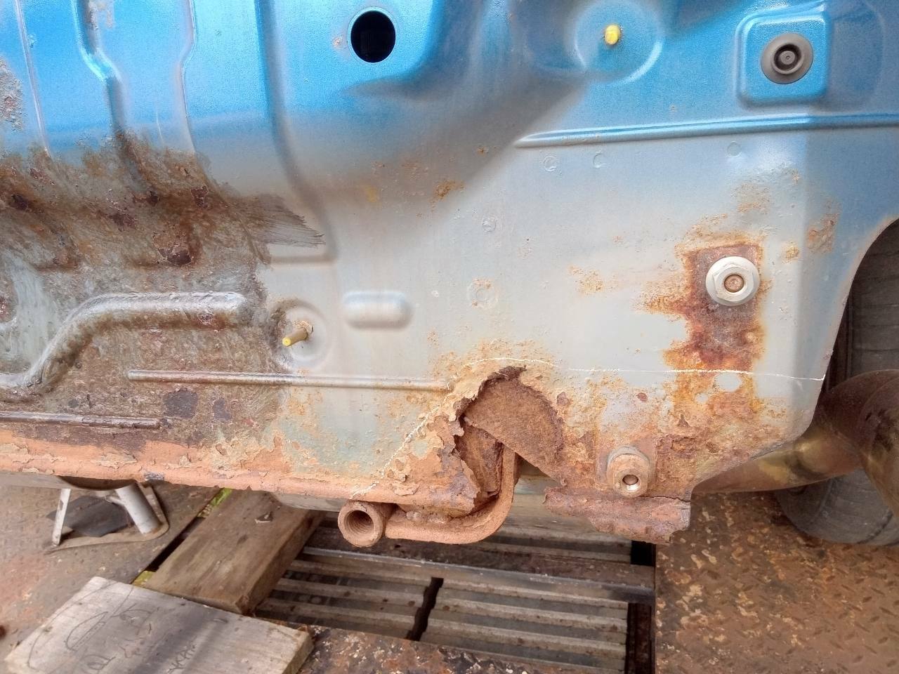

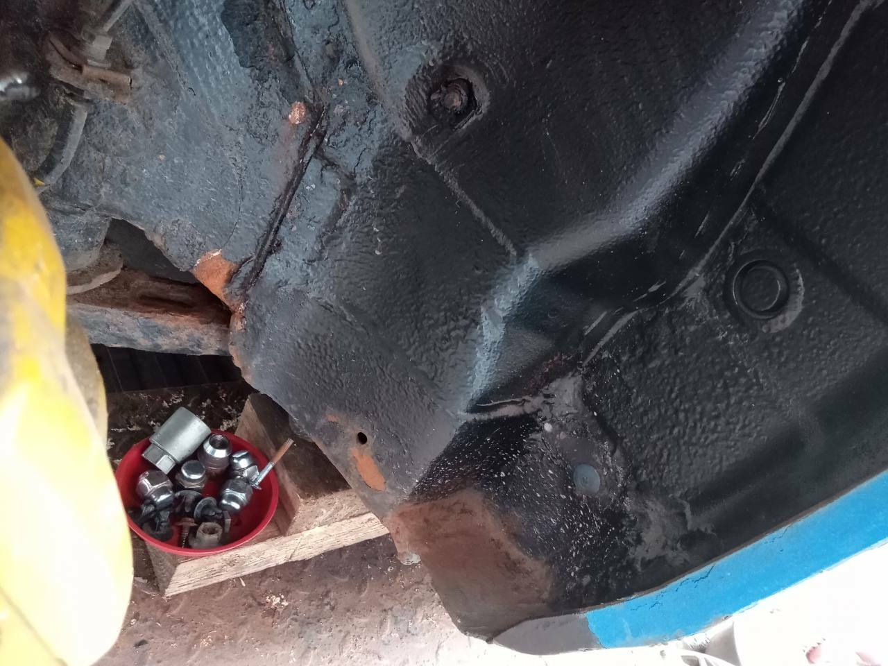

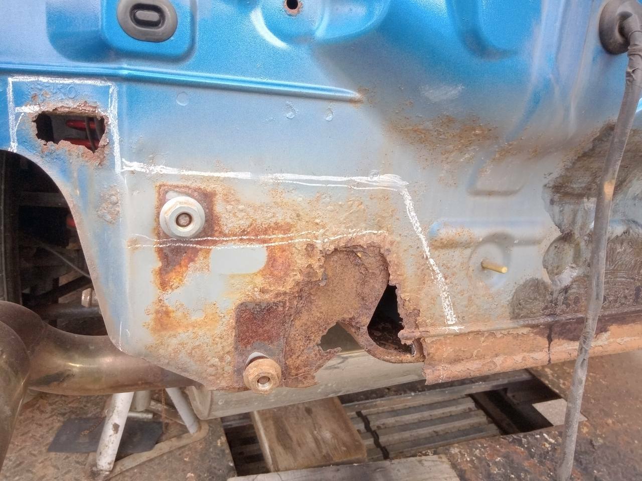

Liner off has revealed nice solid steel, maybe it was waxoyled recently enough that it hasnt had chance to trap too much moisture.  Quick brush of the loose stuff and a brush in with some fresh oil should see this corner ok at least...

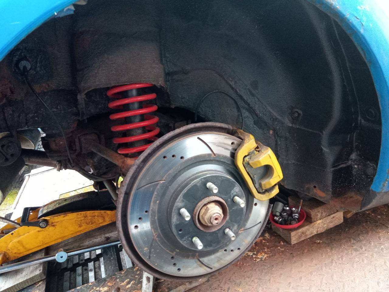

Brakes and springs look like new!
Will have to acquire some bodywork skills to blend this back to smooth, it's solid behind though (other side is worse).

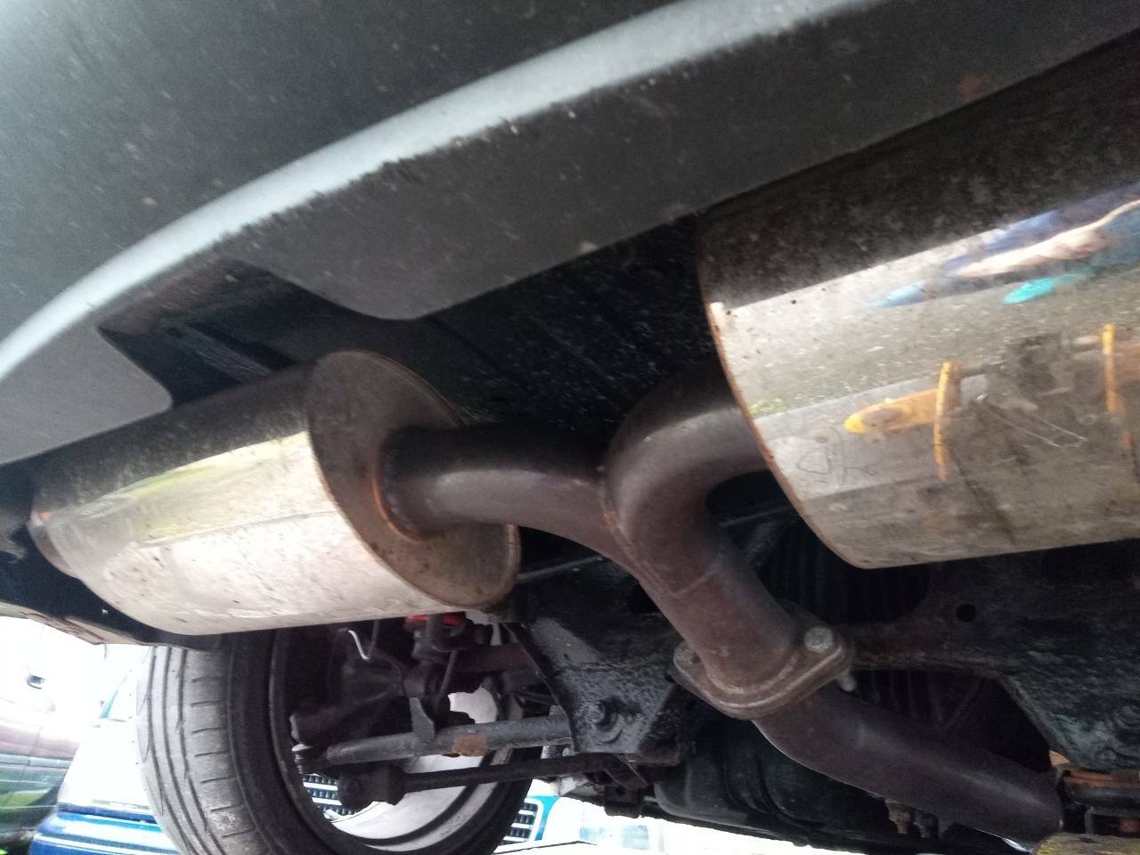

Exhaust is noice...

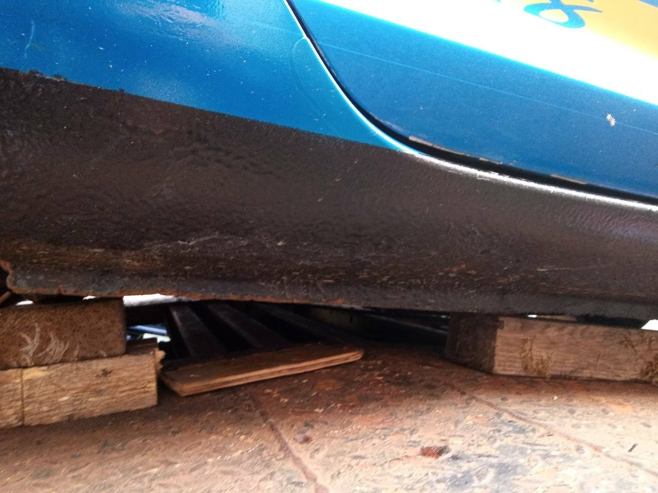

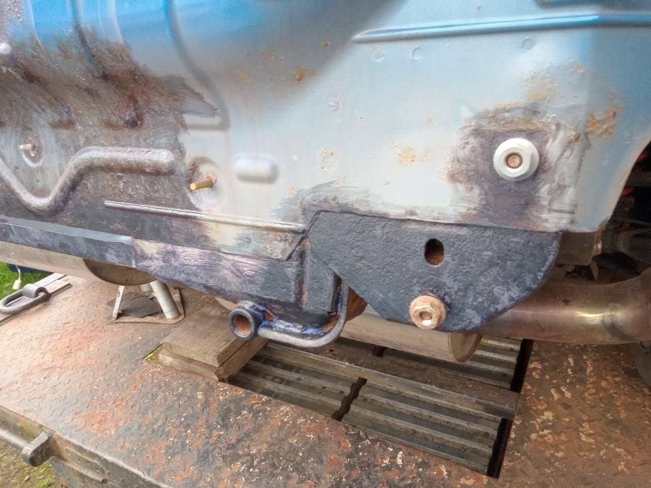

And this sill feels solid...

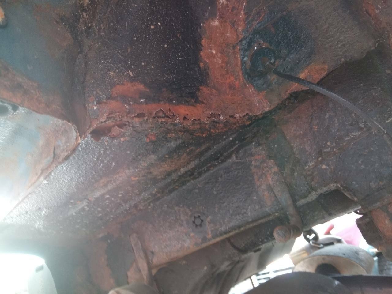

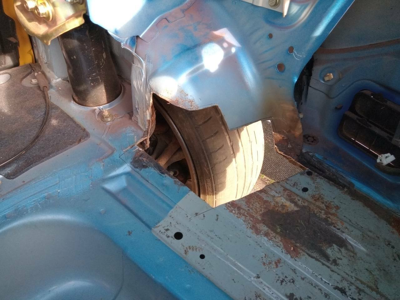

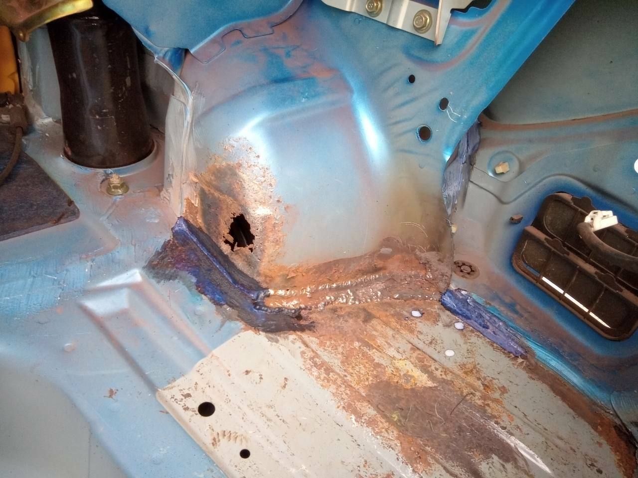

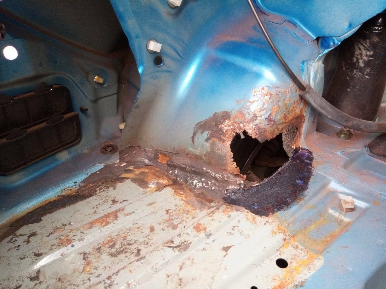

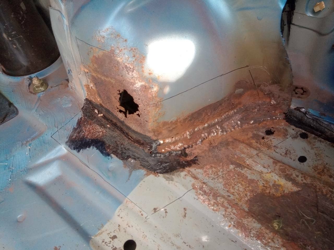

Anyway, prodding has produced holes...
This is where the boot floor meets the wheel well, it has been repaired before (covered in that rubbery black stuff), but is no longer joined (other side more or less the same).
Looking from inside the boot, you can see it's stared to creep up the way, but not too bad...
Across the back of the car, there are multiple layers, the outermost of which has succumbed, although the chassis rail ends are fine...
The hole you can see in the centre of the pic above leads into the boot, the sheet that's rotting isn't actually welded to the boot floor though, just seam-sealed.  Safe to assume it's non structural then.  The chalk lines are my initial thoughts on cutting out and replacing, but I'm tempted to just cut across the whole thing and replace it as a 1-er.
The idea of starting here would be to get my eye in with the welding/get my machine set up nice, on a bit that's ultimately never going to be seen again.  I've welded all my working life, but hardly at all on thin car stuff.  Hopefully by the time I've welded everything out of sight, I can make a decent stab at the wheel arch lip on the nearside.
At this point, I'm still really just assessing things, I've other more pressing work to be getting on with really (jeep needs it's leaky fuel pump sorting for winter etc), but it hard to keep your hands off a new project isn't it?!

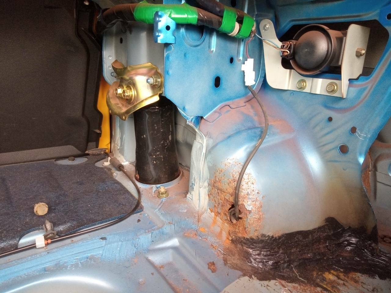

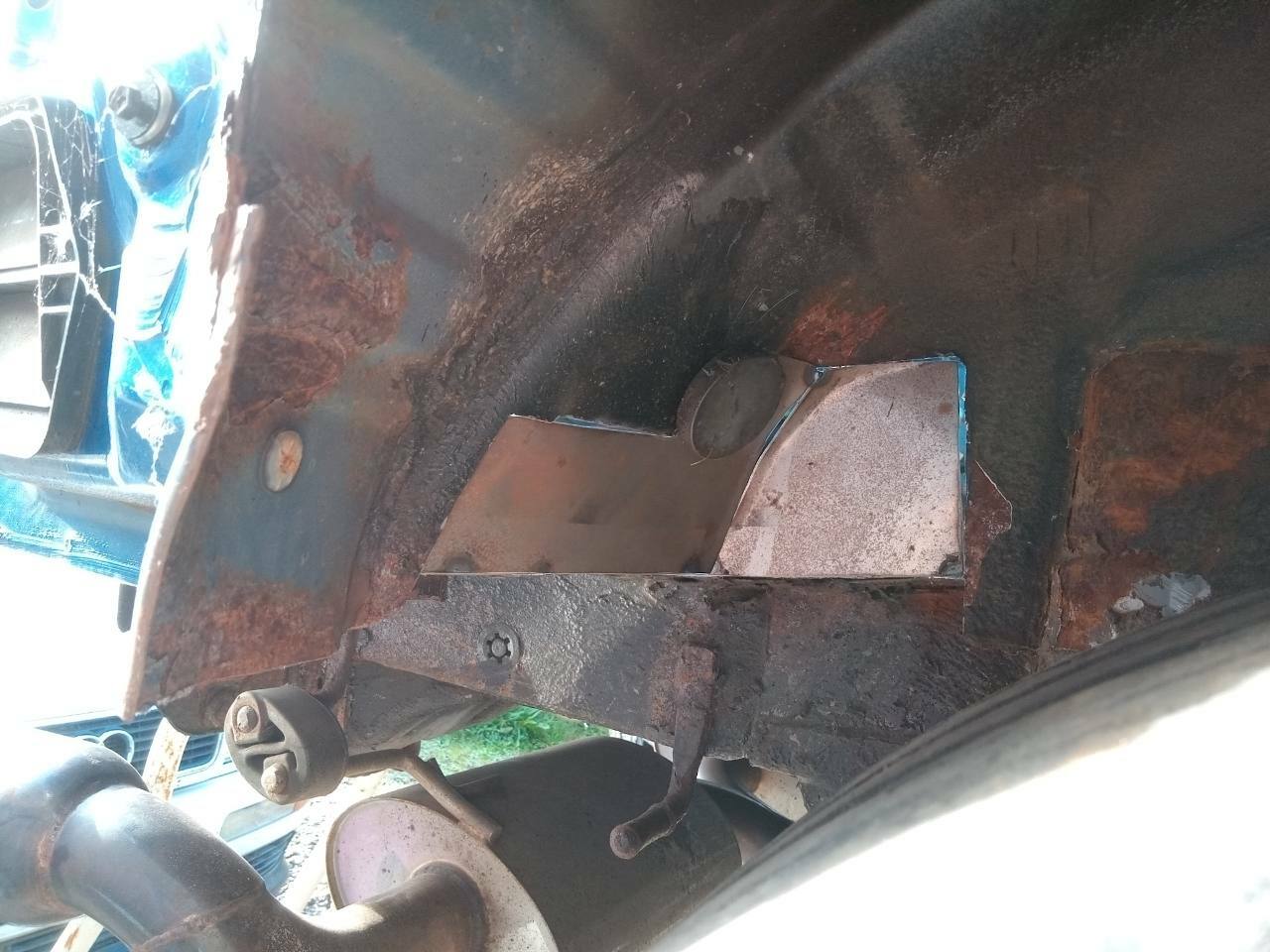

The previous repairs seem to just be weld, no actual sheet metal added I don't think.  I have some thin angle iron, which I'm planning to shape for the bottom edge, and just remake the hole above with a couple of bits bashed into shape.  Be good to see it all cut out, I'll just oil it to death afterwards, hate that  rubber stuff...
Back end's looking better, buzzed off the rotten bits to be left with...
The slit that extends two thirds of the boot width will be repaired (I think again I'll use the 1mm angle iron), with a wee piece to cover the gap on the nearside.  There was another layer over all this, that extended onto the bottom half of the crash bar mounts.  I've cut it off as it was just rusting up between the layers.  Can't really see a need for it, so will just leave that as it now sits.  It's removal has also exposed the wee holes that will allow access for my oil gun down the chassis rails.
So, very much as expected really, for a 17-year old Mazda that has spent all of them in Scotland!  The battery is confirmed as a goner, but it's replacement can wait till next year now.

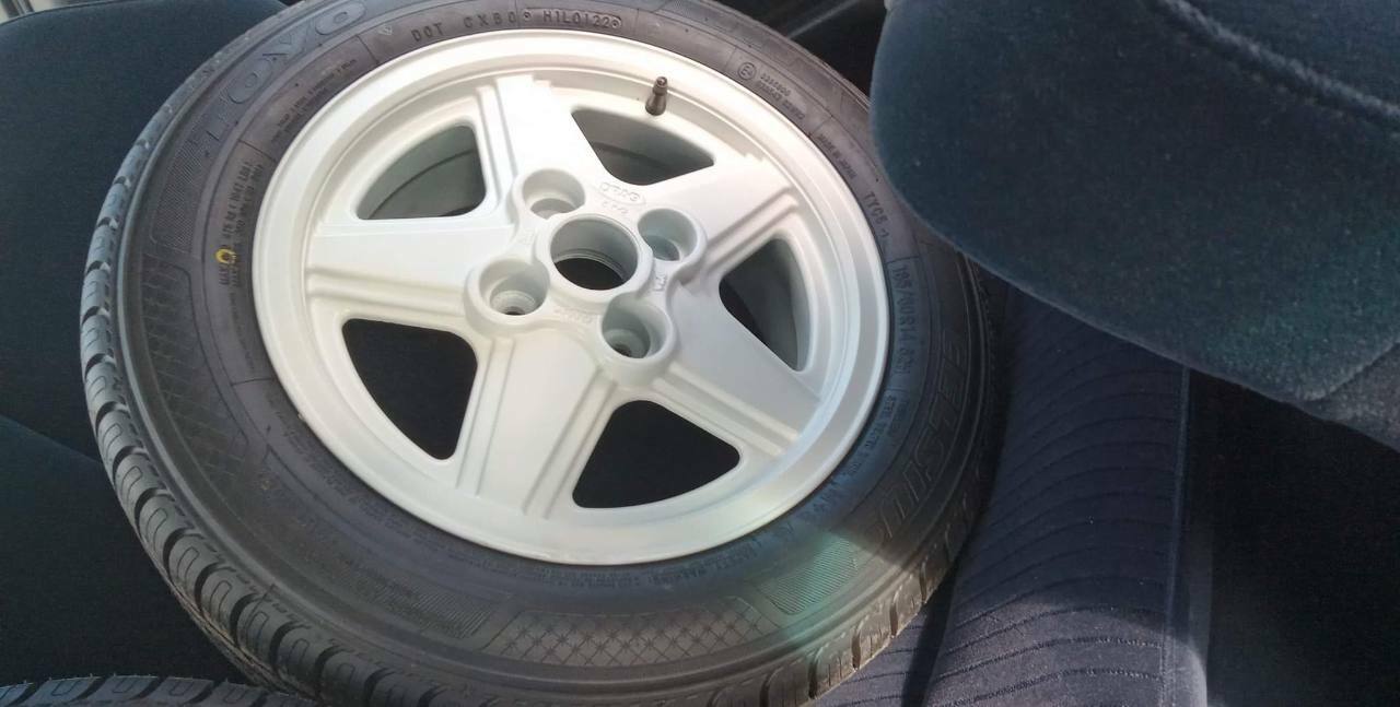

In other news, we finally pulled our finger out and painted the wheels we bought from DB a while back.  Currently researching tyre deals, and these can be fitted to the other (much less rusty!) Mazda...
Black circles has a good offer on the Firestone Multihawks currently fitted, but I'm considering a winter/all season set.  The wee car's so light and slow (bit harsh... gentle we'll say!), that I don't think it'll wear them even if left on permanently.
A change from the planned Ford Solar Gold, this is Audi Alpine White (paint I had mixed for touching in the Coupe).  My eldest was swayed by a 323 rally car I think.  Anyway, should stand out nicely against the Perky Blue, they stick out slightly further too, so should sporty it up a wee bit.  Thing's running spot on, and getting good mpgs on the new-old engine.

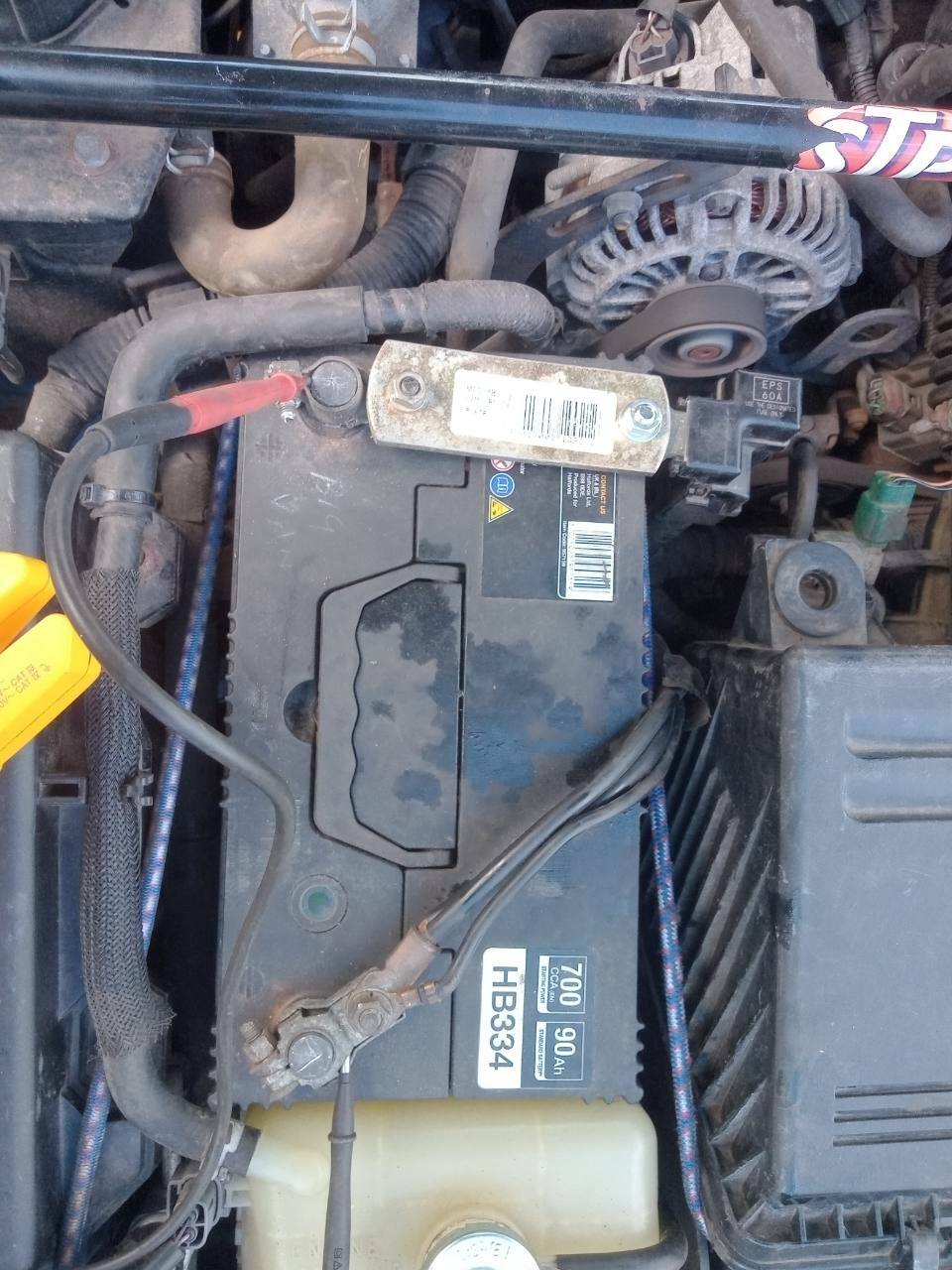

Finally got a decent, fully charged battery in the very tight RX8 engine bay today, for the first time since joining the 'Rotary Club'.
Some modification required as pictured.  In my vast collection of batteries, I have deduced that a few are past their best shall we say.  In particular, of the available (and charge-uppable)  ones, none had the terminals in the right places for this car.
The one I really wanted to use, given its 700cca's, was also too big for the tray, which is now modified (neatly, I hasten to add).  I have extended the positive terminal connection to reach, with a handy bit of bracketry...
Yes, the bottom is about a gnat's cock away from the fan belt...!  Full safety achieved with bungee.
I do not intend to use this battery permanently, but until this point I hadn't actually heard the Mazda start with a decent one, it has always required a jump.
The difference for a cold start was great, fired up instantly and settled into a very quiet Japanese idle, smooth as silk.  Hot start, well... it started!  Not so instantly, turned for maybe 5 seconds before gradually firing up.  I resisted the urge to give it a bit of throttle, which is apparently the worst thing you can do in these.

Toyo Celsius all-weathers on the freshly painted rimz...
323 Rallye?
We likey, feels better on the road too.

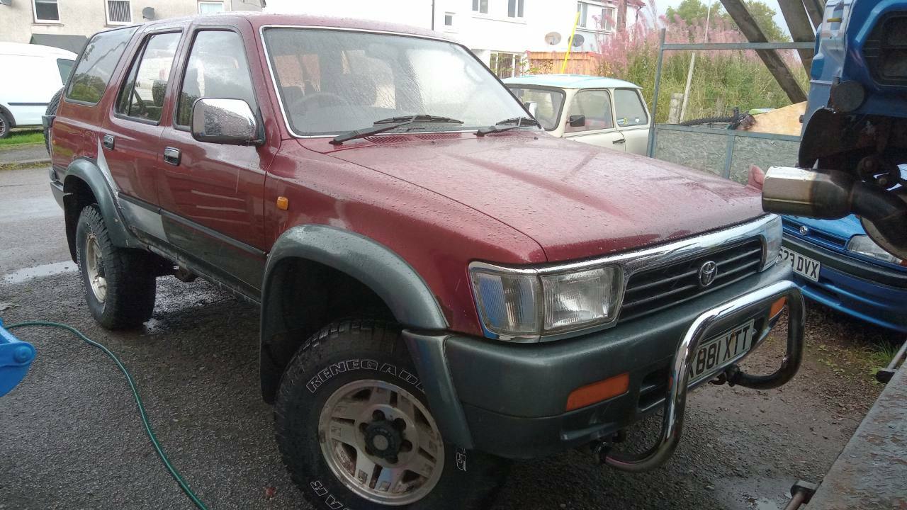

Stripping down various components in the old jeep's engine bay, to access the leaky fuel pump and put in it's new cambelt...
Funny to see my own marks from last time, doesn't seem that long ago!  Bit more to come out on the nearside, and then I'll be at the pump.
Radiator (replaced about five years ago by me), is in a terrible state... you could blow the fins out they're that brittle.  £160 will be required for an all-aluminium eBay replacement.  Coolant was ok though, and she didn't have any symptoms, so hopefully caught in time.

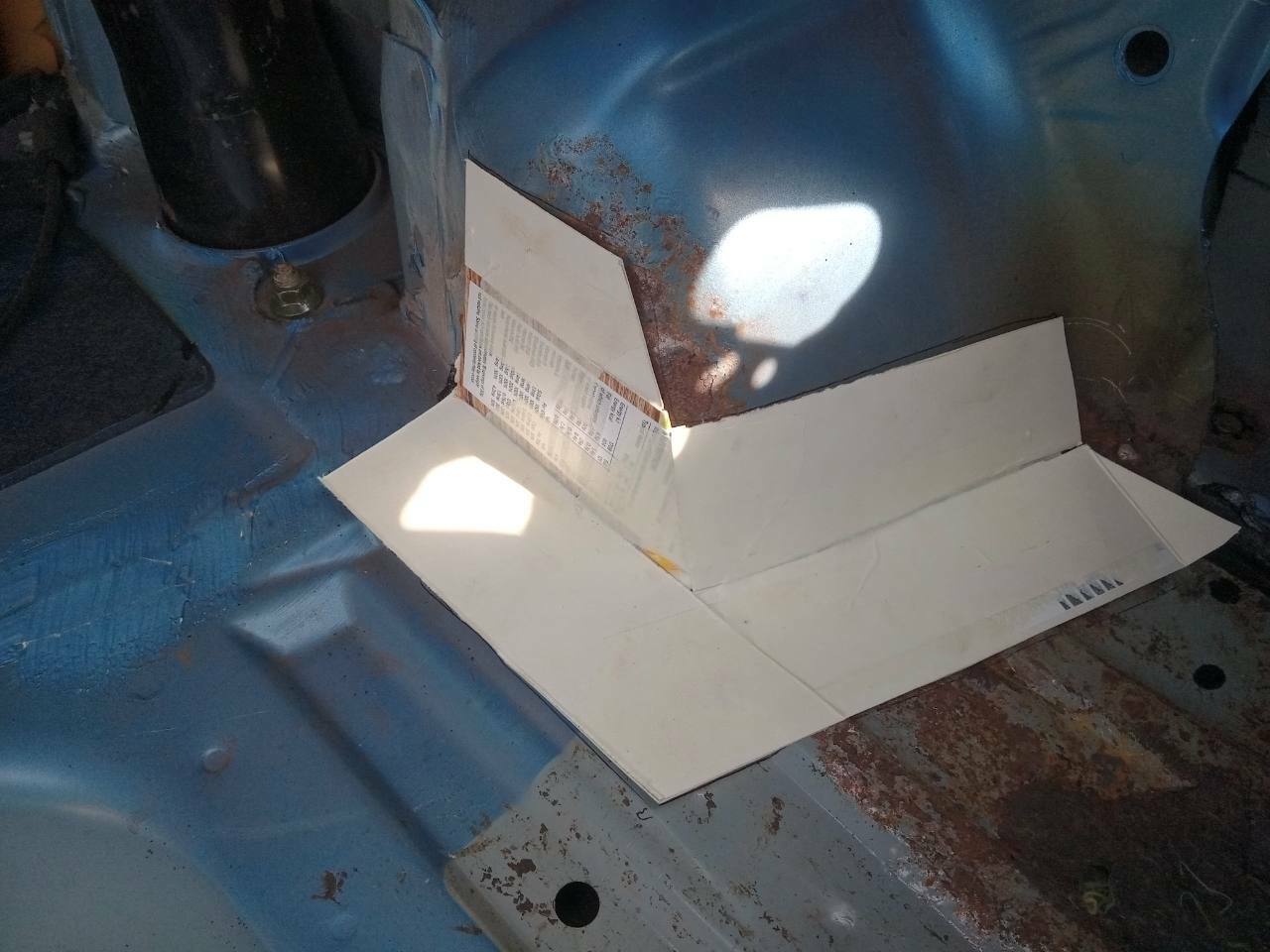

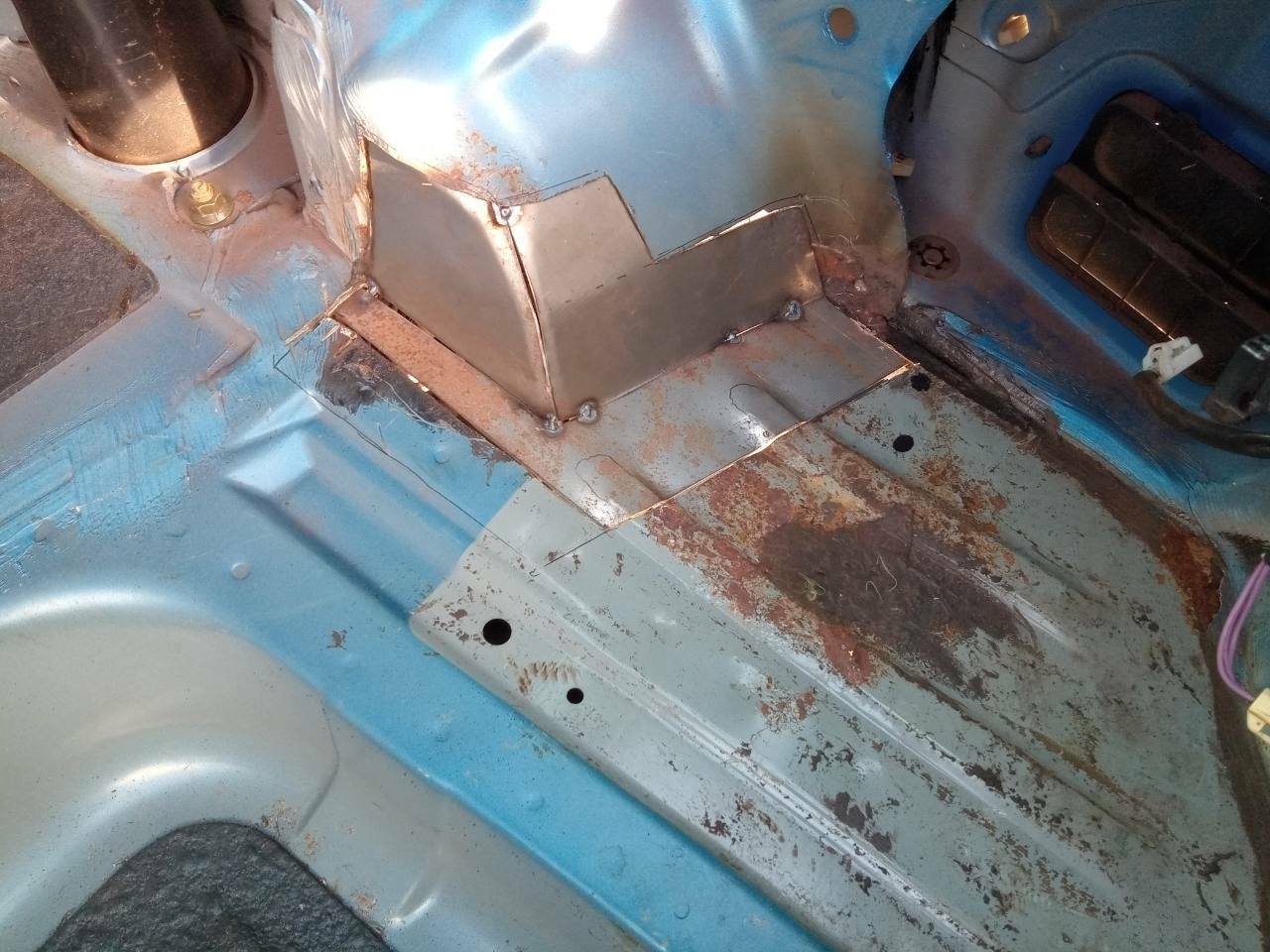

Couldn't help myself then, and turned my attention to the RX8.  I am at the cardboard-aided-design stage...
I want to make up the pieces whole, and weld them in as a oner, avoiding any upside-down welding if I can!  Also, I'd like them to look pretty much the same both sides, so might just make up another one of the above but opposite hand.

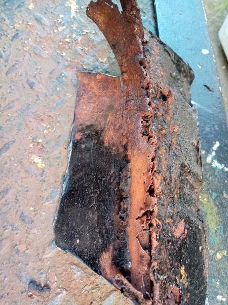

Progress...???

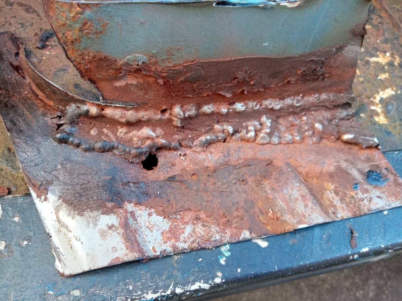

Back to good metal, scary though.  My repair piece doesn't fit too badly, will take a bit of fettling as I start tacking in.
I've cleaned up the edges a bit since taking the pics, but that'll do for today.  My Mig seems to be working nicely, fresh gas acquired today.
Always good to see fresh metal going into a car, and I'm learning as I go already.  It's a bit hard getting the hole cut right to accept the 3d shapes I'd tacked up.  Might try tacking them in separate bits on the other side, got a way to go yet...
This is the bit I cut out...
T'was only £400 remember!

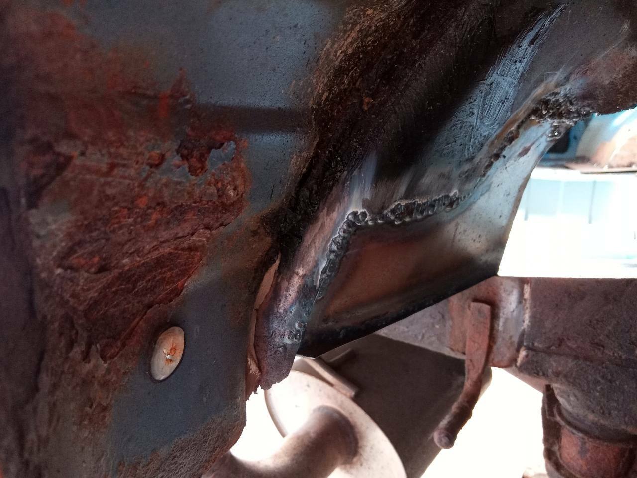

This is hard...  I have learned already that wherever you think the rust stops and good metal begins, it's actually another inch or so until the metal isn't porous/unable to take a weld.
The boot floor edge (closest to camera) needs to be cut further back, what I thought was surface rust isn't.  My plan is to liberate some more steel from work tomorrow, I'm basically out just now.
I think I've got a Dremel thing in the garage somewhere, that'll let me get a neater finish in the hard to reach corners, as the welds aren't gonna be good enough to leave eau naturale for a while yet!!!
What is welded is strong though, with decent penetration to the other side...

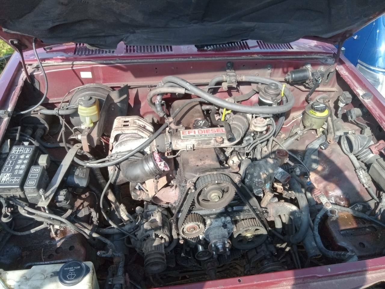

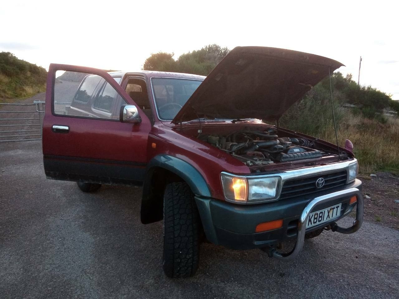

Hi all...

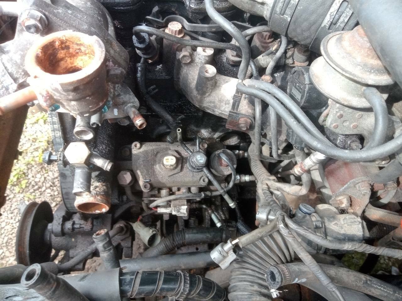

Got the jeep's fuel pump out and resealed today, what a handy, maintenance-friendly design that is!
Pics...
With the last of the umbilicals disconnected, I set about the pulley on the other side of the front cover...
It actually came off pretty easy, I tightened some bolts through the pulley up against the engine (did the same on the cam pulley), which held everything enough to undo the above nut.
Then, after an awful lot of wiggling/swearing out it popped...

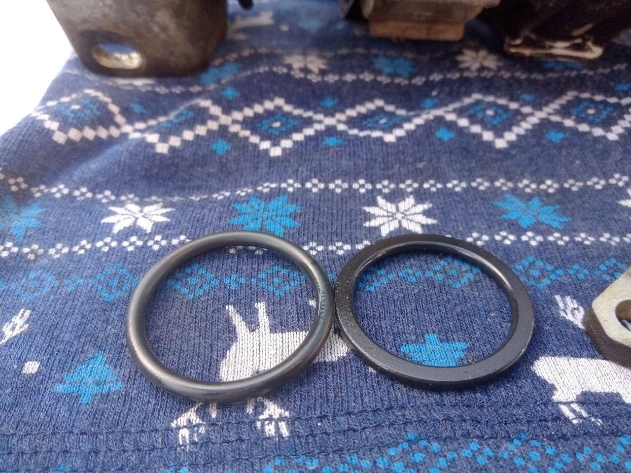

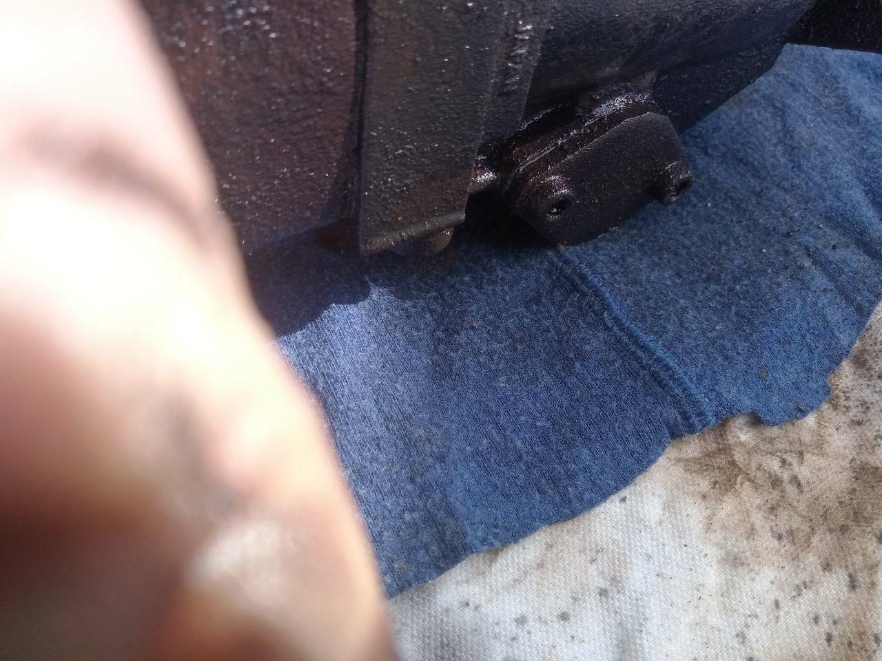

These are the plates (one each side) that are leaking...
They are covers for some shaft/spring arrangement, the o-rings within were hard and well flattened...
That's the old next to the new, not the best but after 30 years what can you expect?!

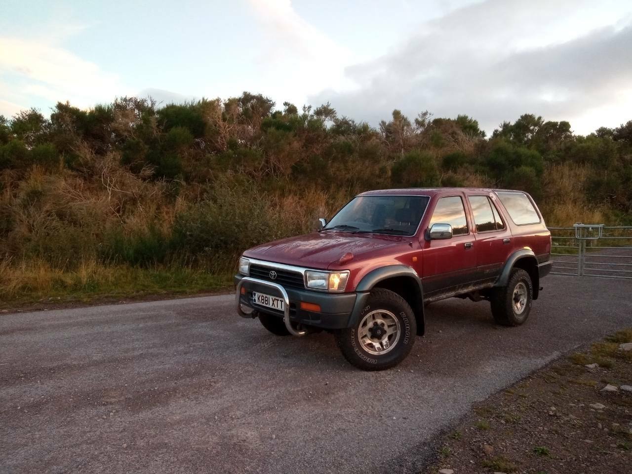

Anyway, it's back under the bonnet for the night, I'm knackered.  My plan is to refit the pump, replace the cambelt and then start oiling up the knooks and crannies of the bay while I can get to them.  Tomorrow.
Be good to have the old girl back, and in fine fettle for the winter.  She's really getting on now I suppose, but we still love her!

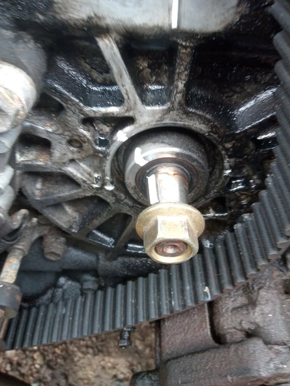

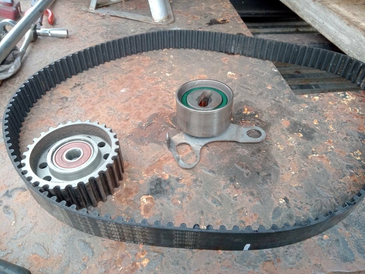

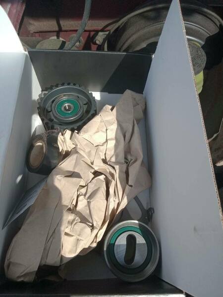

Today saw the refit of the fuel pump, and changing of the cambelt...
All marked up and 'bolted' in position.  Fuel pump pulley went back on fine, and torqued up pretty tight with just the cambelt pulley held.  Witness line on the nut will allow a final check following a good run.
Roughtrax kit bought many moons ago, required retrieval from the loft (my'garage' stock is slowly spreading everywhere!)...
The belt is a Gates item, the other bits are no brand I recognise, but the same as the last ones which show no discernible wear...
Old gear...
Belt looks new!
Anyway, that's it for another 100kms hopefully, I've still to build up the cooling system (new thermostat on order, as I couldn't get the old one to open in a pan, she's never even got close to overheating afaik, perhaps it seized up with sitting?  Anyway, close call!).  I couldn't therefore run her for long, but she started and died, then started and ran as usual, with good throttle response and no leaks as yet!  I pumped the filter primer for a minute before trying, but never actually bled the lines or anything, bloody great engines these.
I've oiled the engine bay up so another session of spannering should see us back on 't road again.  I'd carry on now, but am off to the pub!

All buttoned up and running well...
No leaks thus far, and real pulling power... it's been a while but I'm sure it's getting up to speed easier.  Maybe the pump had been struggling for a while.
We're running without a stat just now (old one fitted but non-functioning innards removed), eBay assures me the new one is on the way.  No discernible difference in operation tbh...
She's absolutely filthy, full of cobwebs, so tomorrow will see a good scrub, and a grease of all the various nipples.  We couldn't resist a wee run out though...
I just refitted the old radiator, it's a bit crusty but whole, and flushed out lovely.  I'll acquire an ally one I think after payday, and maybe a separate gearbox oil cooler too.
Feel a bit more ready for winter now, rain was pretty biblical yesterday too.

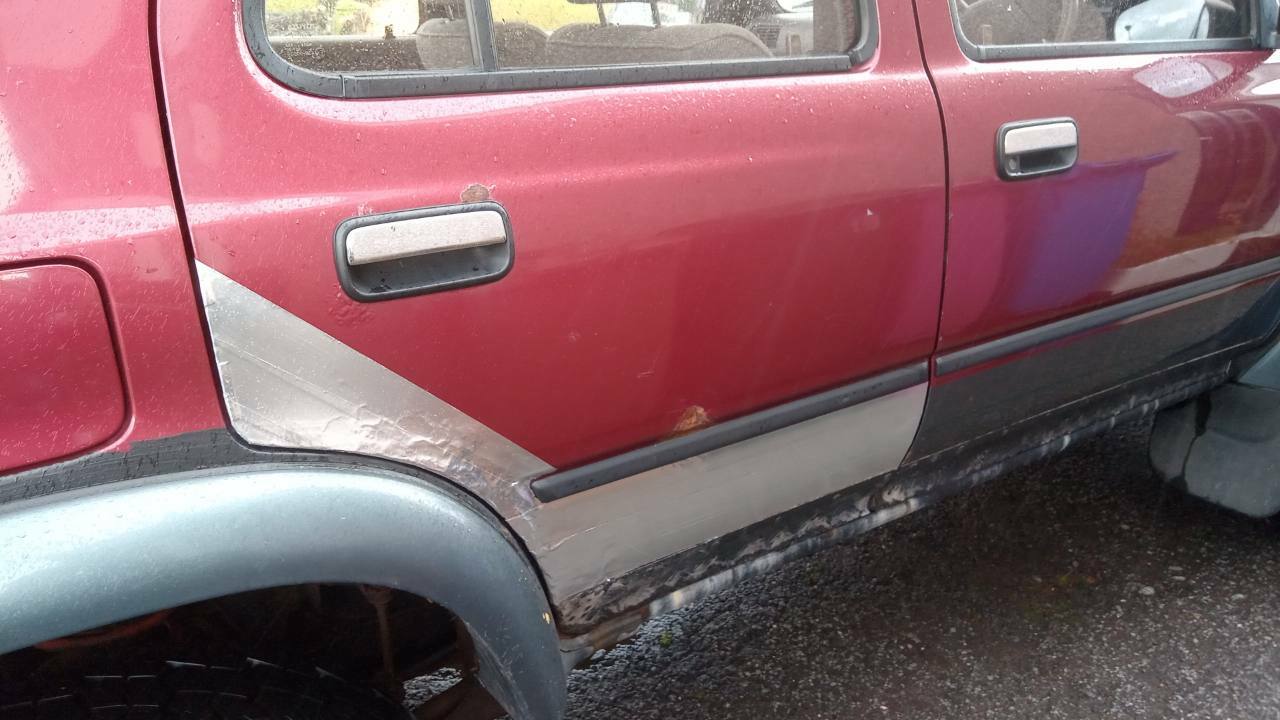

All scrubbed, which has served to show the rampant corrosion quite well!  Nothing chassis-wise, but the body is starting to show its age.
This back door skin is the worst bit, so I have 'repaired' it whilst I start the search for a better door...
Not good I know, but at least there's no jagged edges now.  The white staining on the sills is from the ally chequerplate on the doors corroding.  A rub down and repaint of the black bits is in order.
