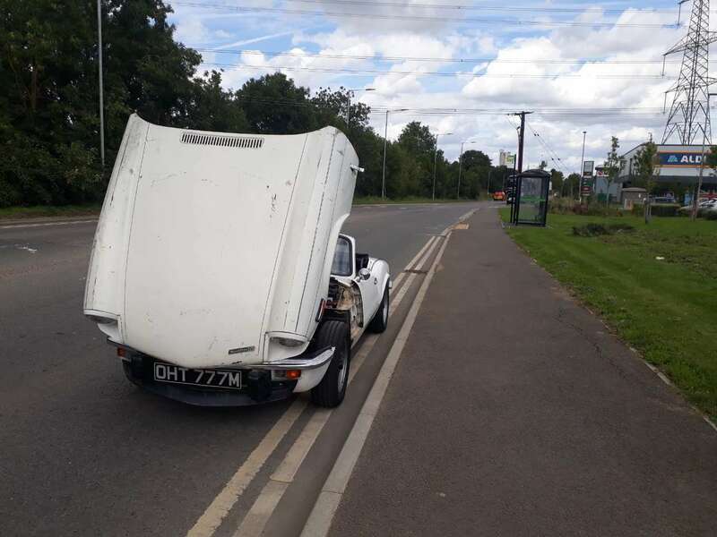

Andyrew Posted August 7, 2023 Author Posted August 7, 2023 Day 7, Been a more interesting one this one. I had the day off and with a dead freelander on the plan with some time inbetween the new alt turning up with the owner in my astra and some spannering i figured id have a tinker as the shitfire had coughed and spluttered on the way home last night. Id changed the very grim fuel filter up front. Id popped the floats open and sure enough some crud swilling about at the bottom. This was given a quick clean out aswell. Time for a test drive. id pop out to get some new nuts and bolts from browns and a few bits from the shop which would only kill a few mins . . As we can see above above this didnt go as planned. As i pushed the little shite up the rather busy road A helpful passer by (who he and his wife were both mechanics) dived out to lend a hand. With a random old plug that was in the boot he could see spark for me and after i popped open the carbs to find 2 very empty floats he was looking at the pump and with some cranking the pump pushed nothing out and didnt seem to have any suction .With this the helpers left me too it. I sucked on the fuel filter and while fuel came up it soon started to bubble. I check the dial and sure enough its showing about 3rd of a tank. Using a quarter inch extension and an old spark plug i beater the sender retainer out and had a peak inside. it was what appears exceptionally low. I buy some juice and a can and wander back lob it in and suck on the filter to help the pump out just incase the pump is a bit weak. A gob full of fuel later im happy we have a good supply. Tickman, Mrs6C, Coprolalia and 1 other 4
Andyrew Posted August 7, 2023 Author Posted August 7, 2023 The pump then, i strip it appart and its pretty grim inside but i was expecting a split or tear internally but nothing. Just alot of crud. I clean this out with a filthy rag that was in the engine bay. Re assembled and with my mate now at the scene he cranked it over while i blocked the pump untill it fired fuel out. We then done this a couple of time untill it was at the carbs. A few cranks and the old turd fired into life. We left for the steady trundle to the workshop. Well thats not true, i trundled a few hundred yard got bored and then just went full onions as it was running alright. Got home with out a hitch. Theres two inline fuel filters one in the boot and one in the bay. The boot one is very clean. The engine bay one however grim. Id say the hard line is rotten internally and this crud giving these issues. Time for a new hardline and a good clean throughout. Coprolalia, Floatylight, Tickman and 4 others 7
