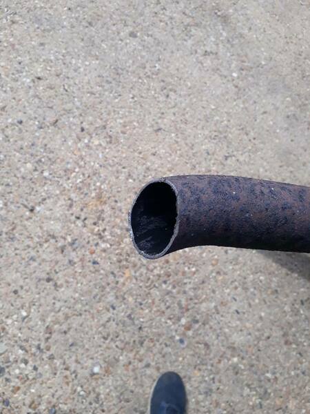

Blowing exhaust with rattle.

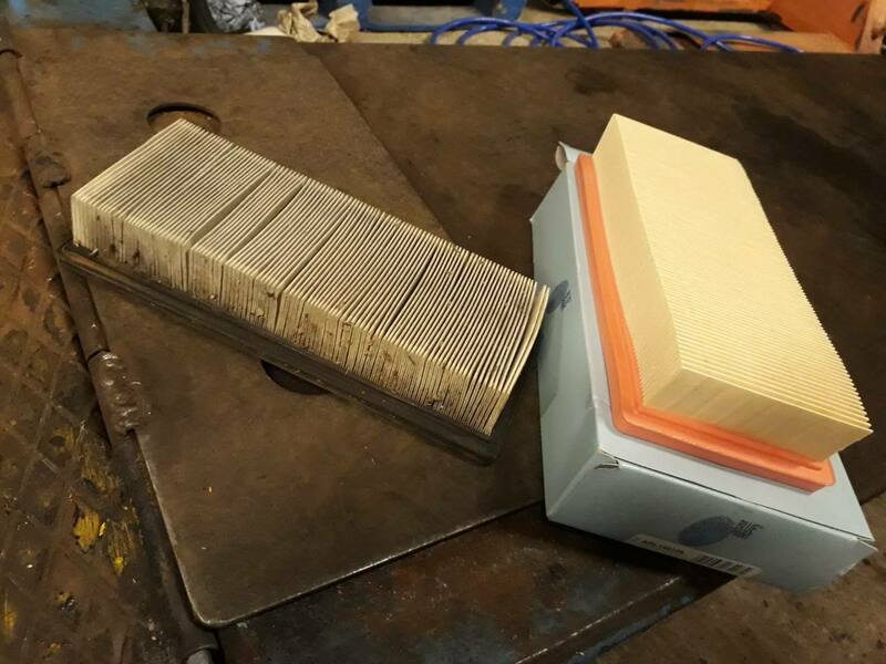

Just because everybody loves a new filter old filter shot.
2.8 ish litres of the finest 10w40 sloshed down its neck and that one job ticked off.

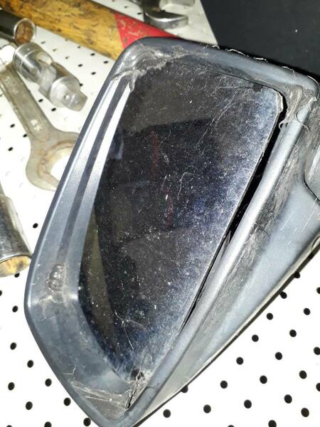

The N.s mirror was tacked in place with 4 blobs of RTV silicone. The casing wasnt busted so it hadnt taken a wallop. Maybe just broken inside. Lets sort that out.
First thing was the little toggles holder had unclipped itself. Probably from trying to be adjusted, this clipped back in. The mirror is a very low end pattern part so the overall quality is shite and very creaky.
Carefully uncliping the glass revealed the centre hub. The  3 adjustment cables push through from the back and the little nipple on the end clips comes though a larger hole and moves inwards to clip in place so all three keep tension one each other.  The black one had ripped through as the plastic had failed.
I wrapped a small cable tie around the metal cable and wedged it down into the void. The now ment the metal cable stuck up too far out of the hole.  Using a 'jet' lighter (that id actually found under the carpet in the 107) i heated the nipple untill it was cherry red then pushed it down into the cable tie, melting it and essentially glueing the little cable in place.
A bit of grease around the swivel mech of the mirror. Cleaned off the old silicone and wacked it back on the car.  The mirror glass quality is laughable.
