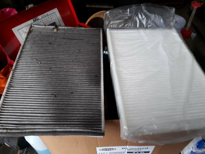

Cabin filter was certainly due.
Expand
GOOD GRIEF!

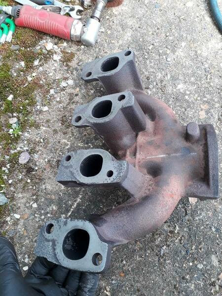

With the manifold gasket dropped off, along with a new gasket for between the manifold and downpipe.
Whilst waiting i needle scaled the larger chucks of rust off the flanges, a wizz with a scotch pad on the die grinder and as i had the time i put some 240 grit paper on a flat surface and with a bit of oil attempted a quick re surface.
Back on the car, horrible ticking noise and blowing is gone. Sorted.
Expand
Fuck me that's filthier than a black cat in a coal cellar
Expand
Once, my WVM job had me running about in an old loaner Combo. The ventilation was miserable and had no good airflow.....
Pulled over to side of road, popped top off cabin filter slot >> slipped the black doormat out = cut a beermat sized hole through it with my stanley knife >> slotted back in (not going to be chased about for dumping a piece of someone elses van).....
Ahhh ..... Feel Da Breeze ;)

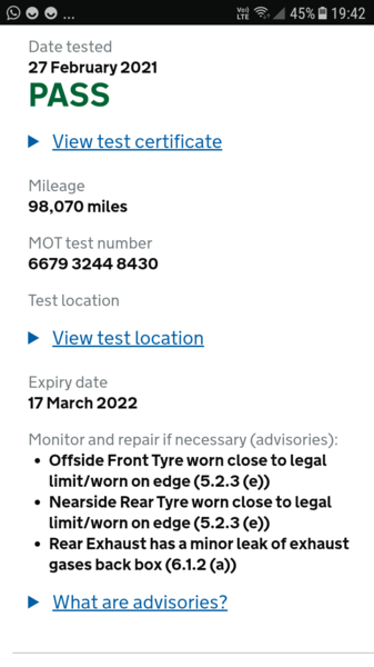

Parts total £120 and MOT £30

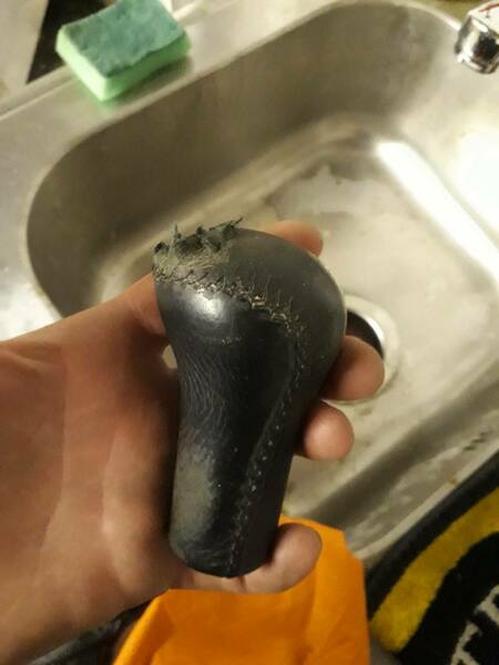

When cleaning the car inside the rather sorry looking gearknob was bothering me . The top leather and shift patern long since worn through.
Peeling at the leather i could see a texture underneath. I wonder . . .
Some tearing and swearing later, a bit of thinners to get the glue remains off and we have one new knob!

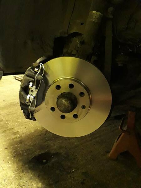

Having had the n.s wheel bearing replace previously i wasnt surprised at fact the o.s needed doing even with such little miles
Right then, wheel off, big nut off, drum off.
Circlip to come out then into the janky press. Out with the old.
In with the new. The drum was given a clean and a lick of black paint to freshen it up. The suspension was given a quick brush up and blown out with the airline. Then a splash of supertrol.
As i was waiting for pads, before leaving the workshop i gave the centre of the discs a lick of paint. Why not eh?
