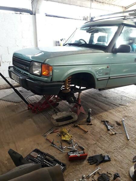

The disco, is still about and getting a bit grim. Wet inside, rot and a high clutch being to name a few, it also now features less indictor lens and headlight trim after a slight interface with a suzuki samurai when towing it from the other workshop.
The astra of desire was lent to a friend for a few weeks so the disco was put into regular service, the front swivels leaked, the balls are pitted and the kingpins made a rather loud knock occasionally.
N.s Swivel stripped down, the swivel balls get pitted and this causes the seal to leak, the replacement housings are rather pricey at around the 100 quid each range,  so i brake cleaned it and then skimmed it with chemical metal to fill the pitting ,sanded smooth, it was then lobbed back together. So far it seems to be working fine, with fresh one shot grease and new seals its leak free, I attempted to sort the other side but found that the swivel bolts heads had dissolved so that put a stop to that. Untill the new bolts arrive.

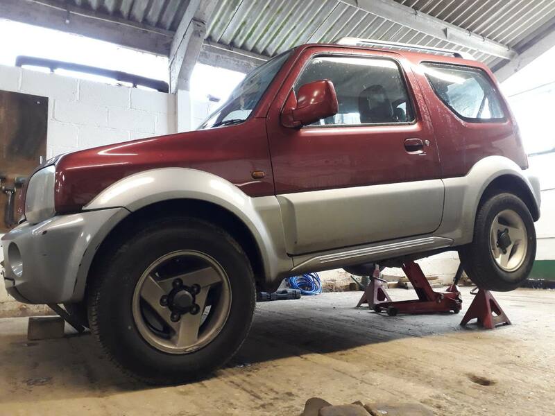

My good ladys jimny was bought in to have a look at the rear brakes, on the  last mot it just managed the rear brake test as there was a fair difference in the rear braking balance, a perfectly even balance on the handbrake tho, but the foot brake it just passed so assumed sticky cylinder.  With the Rear drums off, revealed all is well in the drums, no cyclinder leaks,  loads of meat on the pads and the cylinder pistons  i could move them in with 1 finger.  Maybe its fixed itself, the test is due soon so ill see if i can get in on some rollers beforehand.

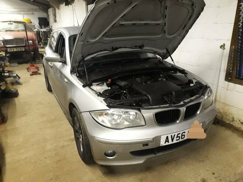

Yesterday a good friend had dropped a message regarding his daughters car which had decided to have an FTP on the school run with a dead starter. I ordered him one at work an we arranged to attempt to fetch the car.
A dead starter, easy a simple push start right?
Well, it would be if it wasnt a push button ingnition that needs the clutch down. A quick google suggests that if the vehicle is traveling over 10mph the car will bump start.  A strap and the gentle pull from the disco on the other end and it bumped into life easily.  His plan was to repair it at the weekend so i said we should drop it at my workshop and he can do it there in the dry should it be pissing down.

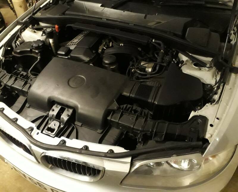

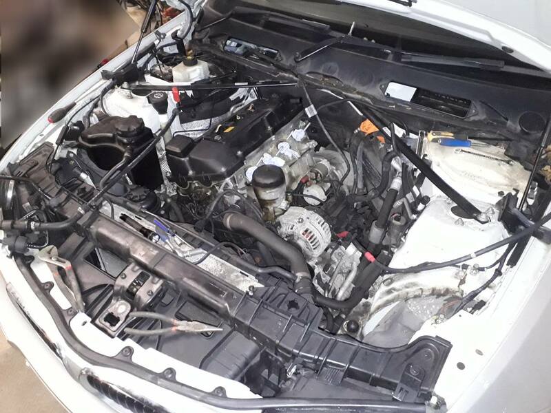

Here we have then a rather knocked about 140k bmw 116i of 4 pot wheezyness. Unserviced for 4 or more years and unloved. I honestly dont see the appeal of these things but its made it thus far so they cant be that bad and its a shame this ones as neglected and knocked about as it is now, because when purchased it was dealer maintained as the previous keeper worked for bmw iirc.
My friend is a very busy chap and we always help each other out so i decided id change the starter over tonight.
Wheres the starter on this thing then?
The carrot highlights the issue of access.
What needs to come off to get access to the tiny starter then?
Scuttle panel/cabin filter housing thing, , air filter, all ducting, breather pipes, intake manifold with injector rail, with throttle body. Etc etc etc.
It looks like a right mare, and some of it is a bit fiddly but in all honesty from complete to having the old starter out was just under an hour and that was with a cup of coffee on the go.
Head cleaned up and as i couldnt get new inlet manifold seals today i opted to put a light smear  of reinzosil on the old ones and hope for the best. Seems they sealed up just fine.
Inlet back on, dropped socket down gap, inlet back off,  find socket, inlet back on everything else plugged and bolted on and ready to go back to its owner for the hard life of a mum car.
It will be back at some point for an attempt at a service (rusty sump and no dipstick for the suction pump) and to cure some oil leaks and investigate an EML thats been on for a while apparently.

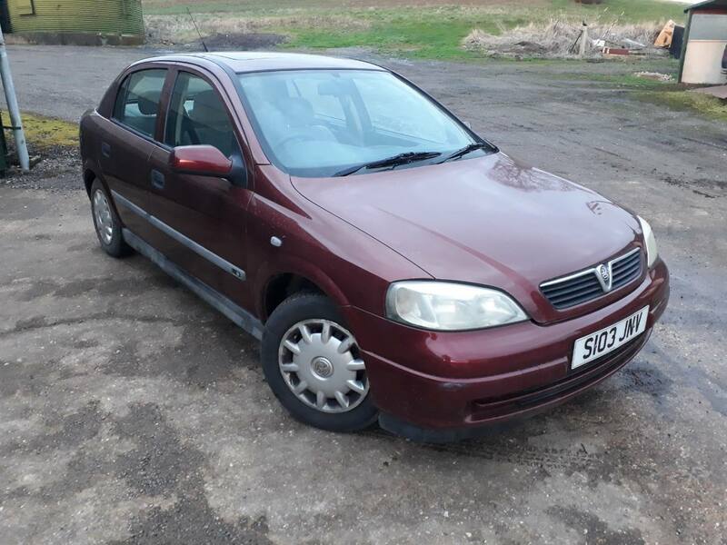

A free car is making its way the workshop for repair / some loving, ive already found it a home with a best mate.
His  next door neighbour appeared to be offended by my car when he was borrowing it as it "didnt look as nice" as my mates wifes car (a swanky new lexus) so hes going to love this.
A few clues,
22 years old
Maroon with beige
1.6
Auto
Been used for tip runs.

The backstory of the car from what i know.
Workmate does vehicle repairs at evenings and weekends. He had done the odd job on this car but when the giffer owner passed away the widow asked if workmate could take it and do whatever he liked with it or help her scrap it.
Workmate put it up for sale for a couple of hundred with zero interest.
My boss had always had shitters and in a conversation about the car not selling it was discussed and i understand 25 quid exchanged hands.
Car was used for a good while by my boss ,but his wife dissaproved of the car and when one of their daughters car packed up and they needed some wheels she was begged to take it and get it off the mothers driveway.
Daughters had the car a year or so now and has no love for it, tax is high because old and she just doesnt like it enough to spend out on the repairs it needs which is nothing major but theres no love for it.
So the poor unloved little car is coming to the workshop for a few evenings worth of  full on pampering.  Service, new brakes, exhaust repair and a full on deep clean and machine polish before its MOT in a couple of weeks and it goes to live with its new custodian.

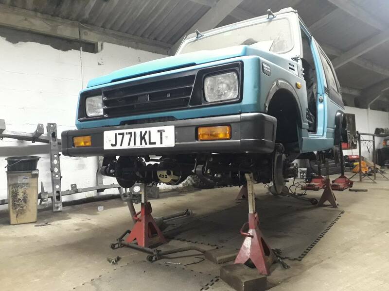

A shimmy around today and the lwb is now in a better place for access to all 4 corners whilst i assemble all the brakes and set the kingpins and wheel bearing up front.  Up in the air and wheels off!  The wiring loom to the rear of the car was run to the back instead of being bundled under the front and the exhaust removed to be re fitted properly.
The joy of 4x4s on high lift axle stands! Loads of room for activities.
The brakes need stripping down and cleaning up, one rear needs building into another housing as ive got two Of one side.
Up front is lwb vitara vented discs and calipers and the rear is sj discs and vitara swb calipers on a rob storr conversion kit,  Its being converted to run an early sj transferbox drum brake for the hand brake as samurais had rear drum handbrakes.  The SJs all had drums on the t box.

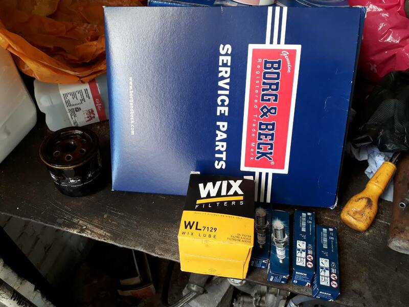

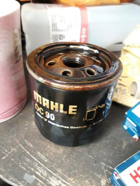

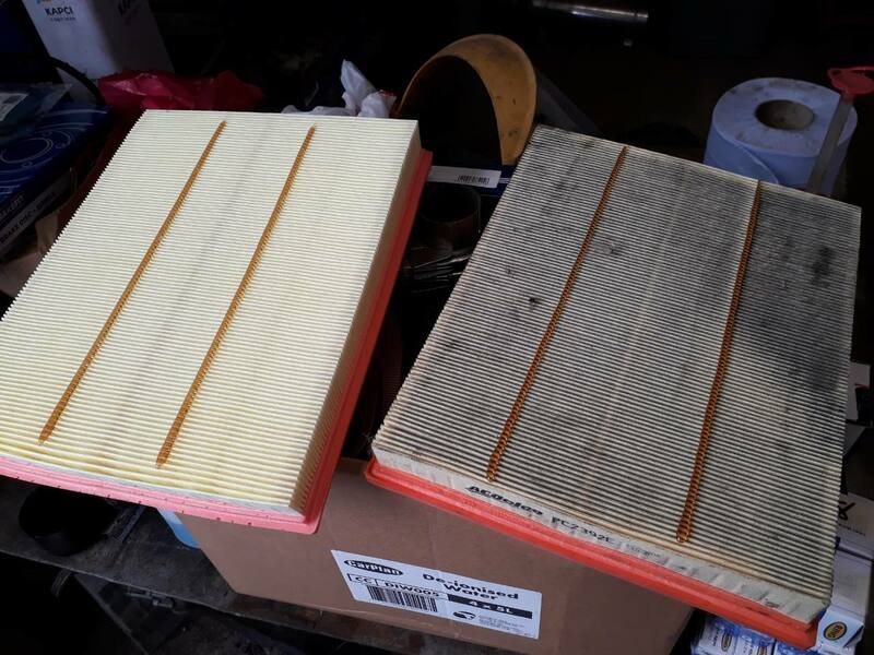

Going to stick a cam belt kit on as unknown history.  Due to how old the 8v design is this makes the kit brilliantly cheap.
And INA belt with tensioner £21+vat.
Oil filter, wix brand £1.00+ vat.

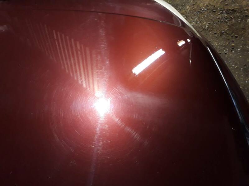

2 mins with the rotary polisher  reveals that theres potential under those horrific swirls and ingrained crud.

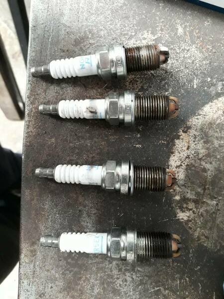

Service underway.
Plugs needed nursing out. Tho not as bad as id expected. But whilst out they habe been replaced with some cheap bosch plugs. Oil wasnt too bad, some mayo in the rocker but will do another change within the next 1k miles to give it a clear out.

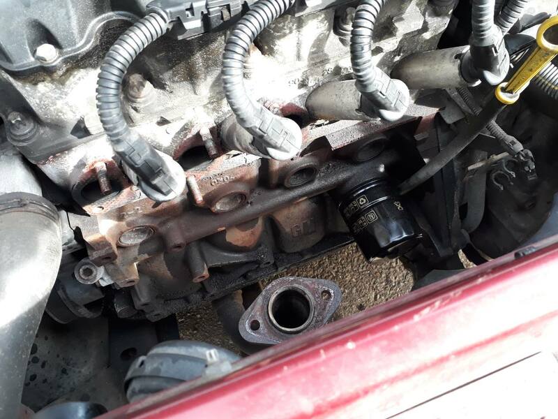

The exhaust had a blowing ticking noise, i suspected the front flex joint but the mot advisory suggested it was from the manifold.
With the heat sheild of it certainly sounded like a failed gasket.
A wire brush and a splash of lube on the stud and would you believe it the all bloody came out aswell!  Had to get some heat on the bolts to the down pipe  but even they came out.
Gasket on order now to arrive here after 2.
Looks to have blown at the sides. The lower studs were very loose/easy to undo.
