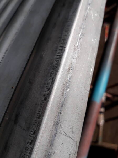

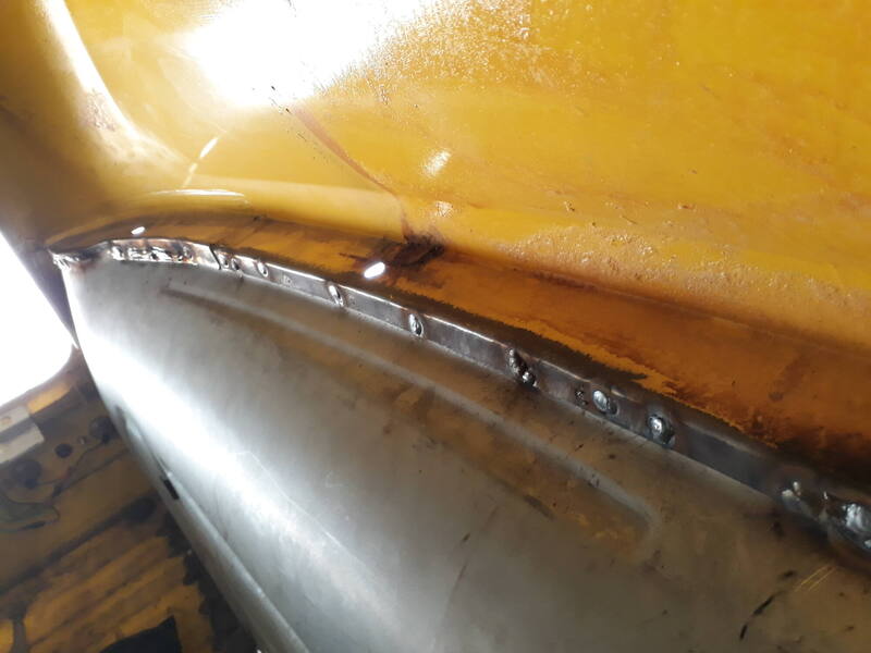

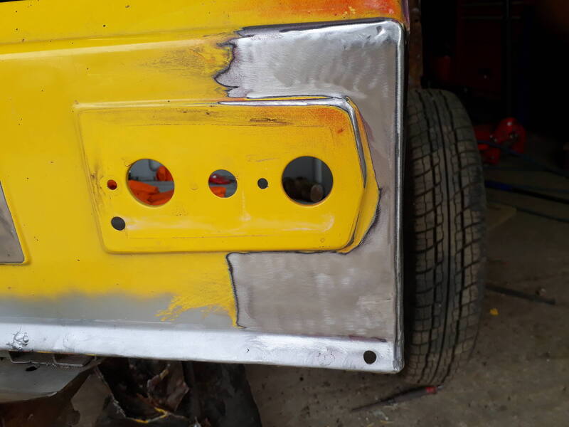

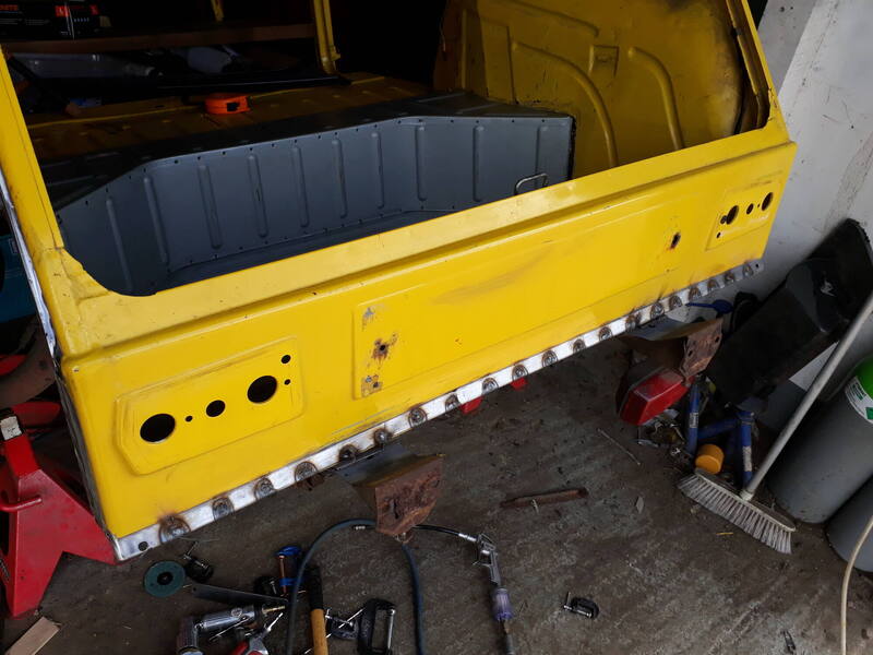

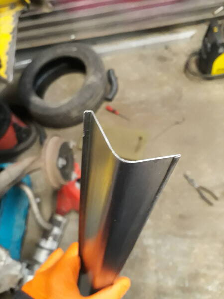

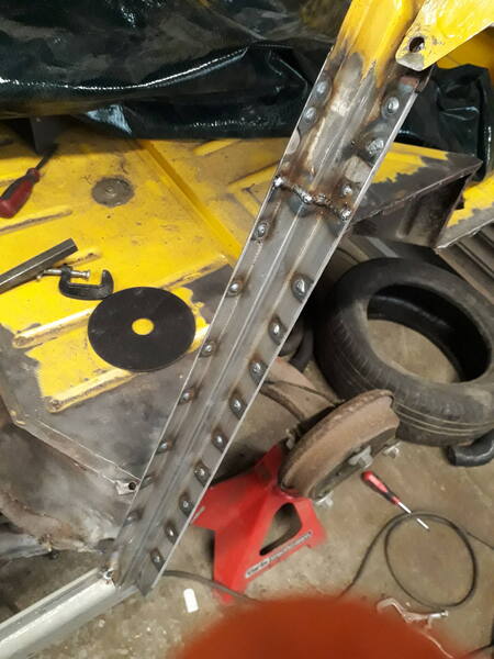

With the pan and sill in place I could re-do the C post. The main bends were done on the bender but the folded lip and the small return was tediously the old way.
The basic bits done and cut oversized.
Small fold to match the original and a Bend on the other side where the inner wing panel goes upto

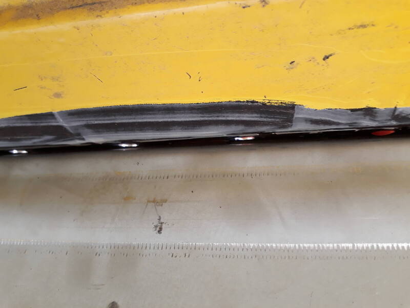

In place with all of the clamps, the two but weld joints on both skins are staggered for a bit of strength
And zapped in.
No wing mounts yet, will probably weld nuts on captive, and the joint to the sill need a curve panel making up.

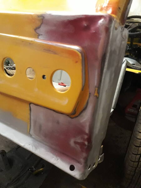

The photos below don't show it very well but under the shite it's heavily pitted.  The inner wing it's all over it. When I un picked the n.s inner the joint flange from the boot floor was very flimsy and need localised repairs. I could either spend ages repairing and still have all the SHULTZ shit on it or just spend the money and replace it. So Ecas got the call and a boot door and the floor to seat box panel was ordered.

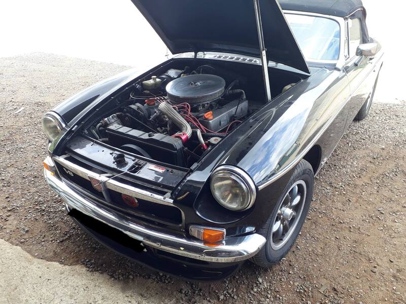

Some random shite then, this time it was to weld a bonnet latch on this MG , the bonnet pin had ripped out and someone had badly  mig welded a nut in place and fitted a new pin and spring. The welds failed. This would be because it had and Ali  bonnet!
No pics of the repair but as i cant weld ali I ended up folding  a 2mm steel plate with a 3/8 nut welded on, that was then panel bonded aswell as some rivets to mount it. I made it the same shape as the destroyed original ally part and once it was painted you'd never have noticed it. These aren't my cup of tea to be honest but it sounded rather lovely.

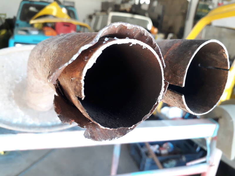

Along with this I also fixed the exhaust on the painters own E30 cabrio, only used in the sun, 40mm drop on some white bbs splits. Lovely.

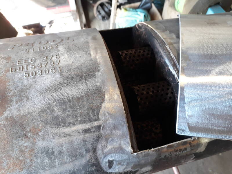

The exhaust had been caught on a ferry ramp years ago, so a leak at the front joints, the middle joints had rotted and cracked and the back box had a large blow. Ruining that sweet 6 purr.
Whilst a new system would be ideal, most new stuff is shite and if it isn't shit it's expensive so I patched it up for him. The back box was after market but must be old as the steel on the box was 1.5mm thick! The joints had rusted together so took some beating to get appart. The joints were long and one pipe had a crack as it had gone very thin. so luckily I could trim back some of the bad bits to fresh steel. The bit that had cracked was cut off
With this cut I then managed to remove the last part. I neatened it up and flipped it round to weld it back on after sanding back back the other part to thick steel.
The back box then, I marked up where to cut and would you believe it was right on the bloody inner structure parts. I cleaned them back but the shit kept contaminating the weld so I had to do one pass then grind back and go over any crappy bits
Good enough, new clamps obtained via work, refitted using a blob of gungum repair past on the joints. As I've found this helps take up any gaps when fitting a wallered out exhaust or just a crap one.

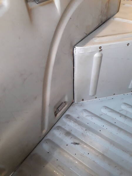

With one old and one new inner wing it was time to fit the boot floor, this was if I had alignment issues I'd be able to compare between original and replacement.
Out of the box the part looks nice but I could see some tweakage would be needed.
The upright part of the wheel well,
That's about 5mm off with the floor section
N.s was alot better
Clamped in the car,
Below is under the rear lights where the panels  have a angle on them and spot weld together, the curve on the panel seemed a bit soft and needed pulling in alot
The panel opens out as it goes towards the rear seat.  The floor panel seem to be too far forward. Same both sides.

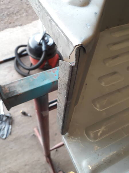

I spent a good while putting in and out, shaking it all about and I concluded that some trimming was needed.

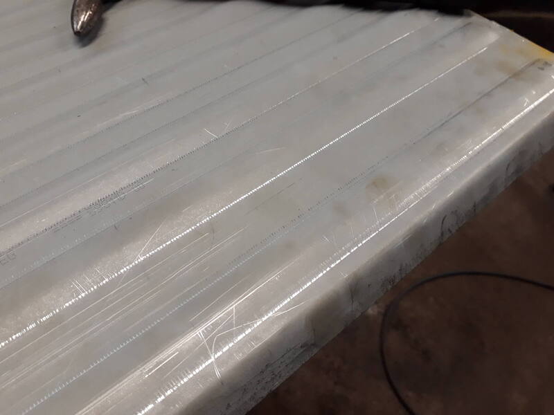

With the panel back out, and my fingers still attached, I needed to straighten, re fold and trim this flange. Which is 1 metre wide.
I want the start of the new fold from the very edge of that bead / pressing round 10mm further back and make it a Sharp fold.
Starting from one end I started to flatten out the old bend, then chucked some clamps on working along it.
 clamped a bit of bar stock and box section either side using all of the clamps again and into the vice it went. Another pair of hands was needed at this point but I just struggled and swore at it a bit.
In the vice I needed some pressure on the panel whilst I worked along it end to end with a block of wood and hammer.  My shite broom was deployed, the end crushed and clamped to a bandstand
Sucess! You can see below the amount the fold has mover back
The issue of the the two bends lining up on the inner wings had got smaller but not completely perfect.  Close enough for clamps to pull the gaps up tho. The issue is if you make this right somewhere else will have a bigger problem.

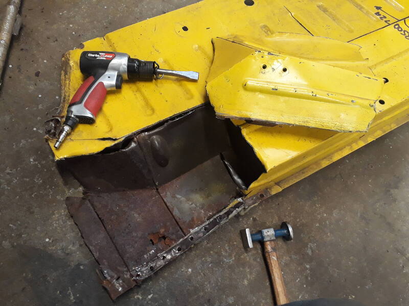

Boot floor now in, I was happy that the offside inner wing could come out. For the most part I used the air chisel like a barbarian. Then the remainkng sections get the spot welds drilled off and cleaned  up.

Yesterday was spent ripping out the old seat box again like a savage with Brutus the air chisel and on the joint to the floor I drilled out the welds as the drivers side floor is fine.
Around 6 hours Yesterday, getting them where I wanted and 20mins today zapping them in. We have a floor again!
