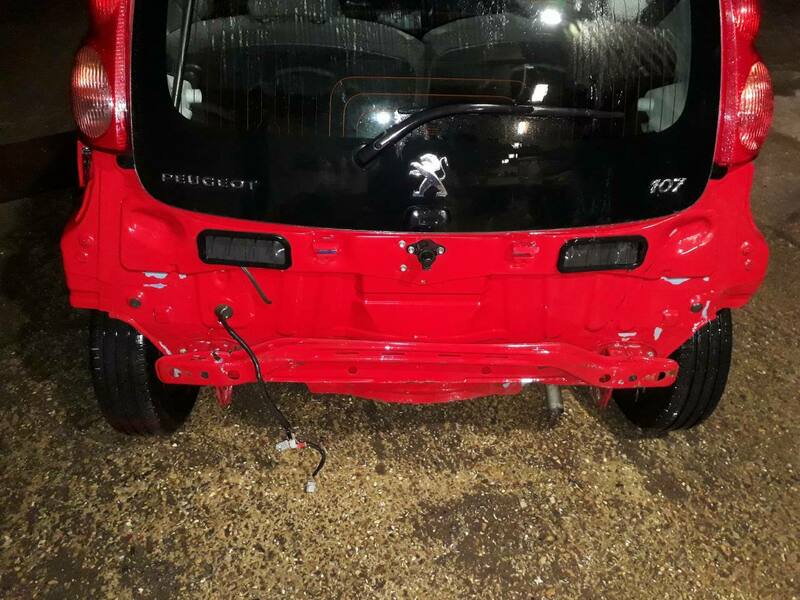

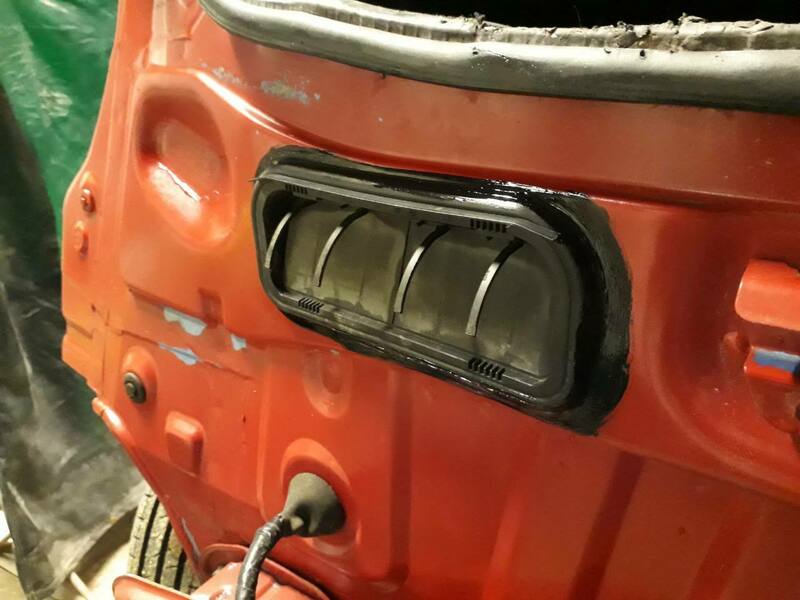

The rear bumper was popped off for some paint, with that off i rinsce off the masses of crud that had built up behind.
In the pic about you can see the foam seal around the vents has degraded and failed. I pulled these off cleaned them up and bonded them in with some polyurethane sealer/ adhesive
They are not coming out anytime soon!

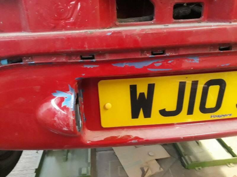

Being a bit of a stickler for a tidy plate, the damaged and crazed front one was bothering me. So this morning i knocked some up at work.
Who doesnt Love a fresh plate?

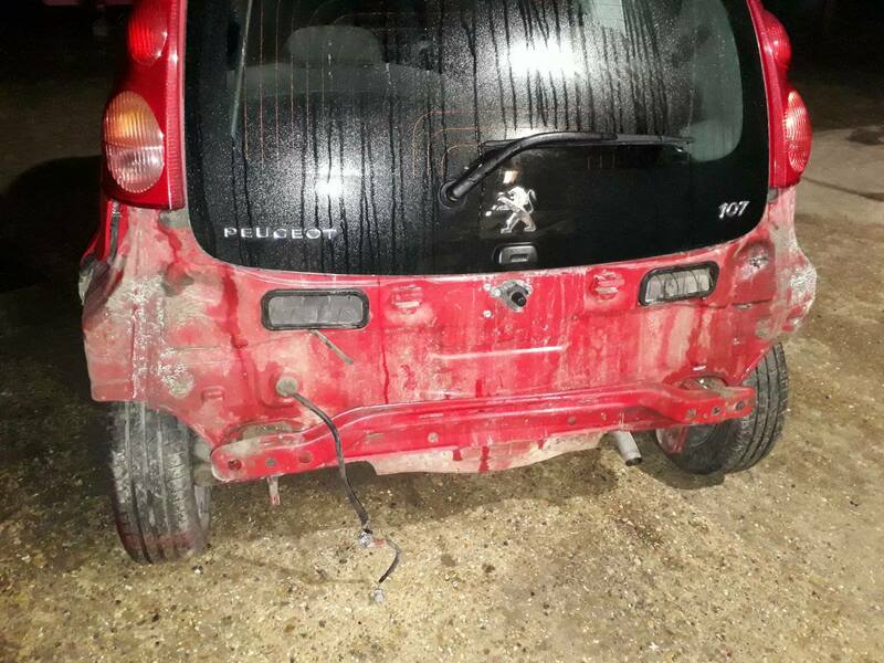

Again a used replacement seems to start around 30 quid with less damage and the prices creep anywhere towards 80  quid for a tidy one! Do i look like jeff bezos?
Guess im fixing it.

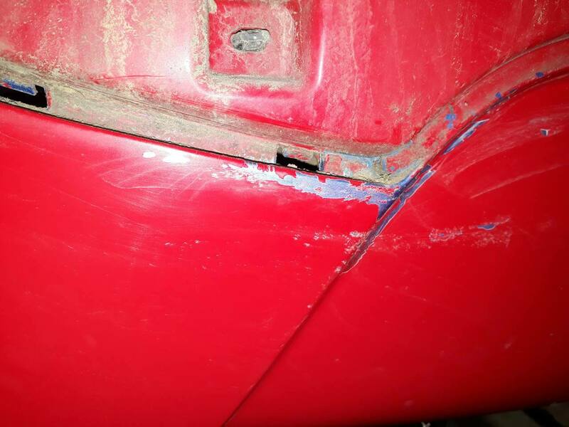

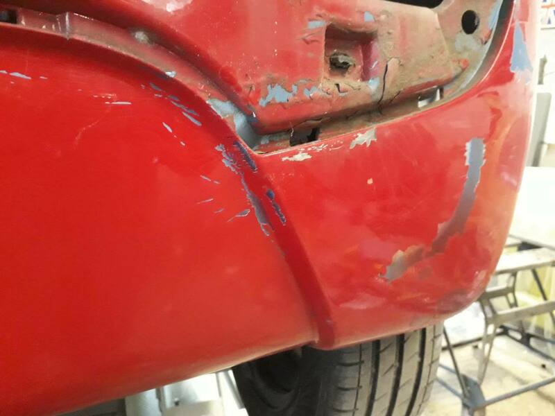

I think we can all agree these are fugly little things. The rear bumper is a very awkward design to my eyes.  The "peugeot" and "107" letters look too busy and as i wanted to add a detail i felt they needed to gtf.  The flatness of the bumper makes it look awkward.
Filled smoothes and painted red, The rear lower plate area was then painted with the same dark ish satin silver used at the front bumper and door mirrors to give an almost OEM option look. Well i think it does. Maybe just me tho!

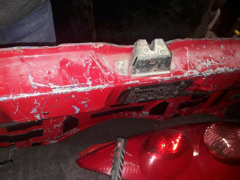

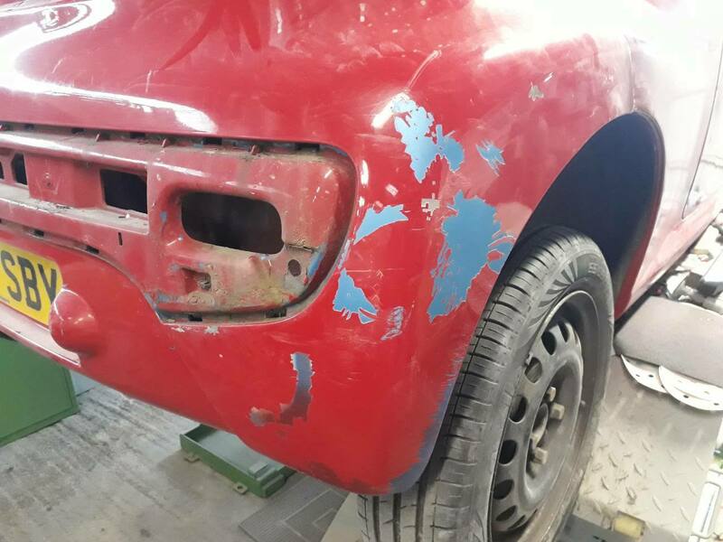

Over the crimbo hols i did a quick repair on the damage that had been sustained on the n.s, but i was running low of the basecoat paint and used another brand we hand in stock. This didnt match nor didnt it mix well with the clear and sagged like an old tomato. Thankfully the damaged sill came out okay. This side was scrapped and is slightly dented. No pics as it was a bit of a mojo killer tbh,

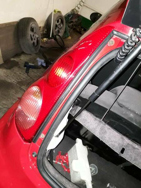

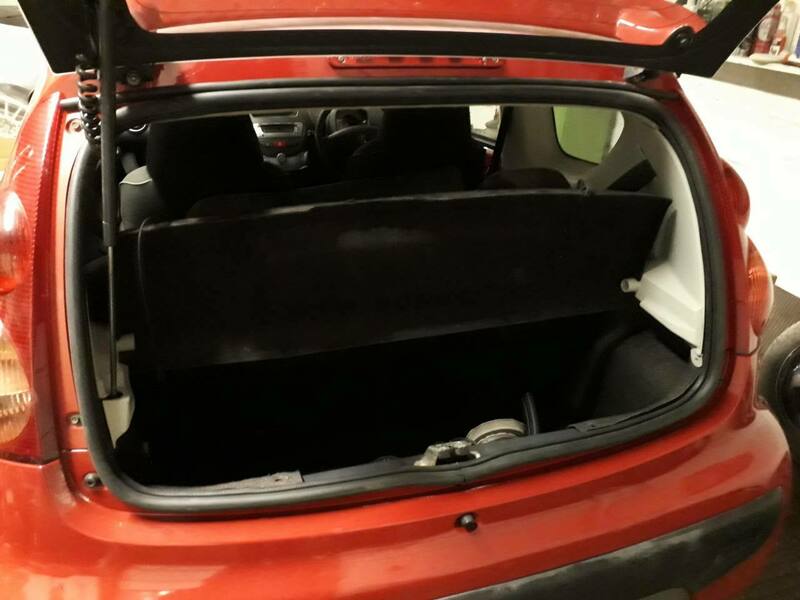

Anyway, these things are know for water leaks and i wanted to address them now rather than find what does leak. Like the lower vents i already sealed up before, with so poly sealer i gooped up grommes and seams.the foam seal is known for letting water in so i ran so bead on the panel (more after this pic) that would in theory guide water away from and around the seal area. I also smeared the same sealer around the foam gasket sides to seal it up again the the mating face was smothered in silicone grease hopefully creating a nice seal but not bonding the light inplace.

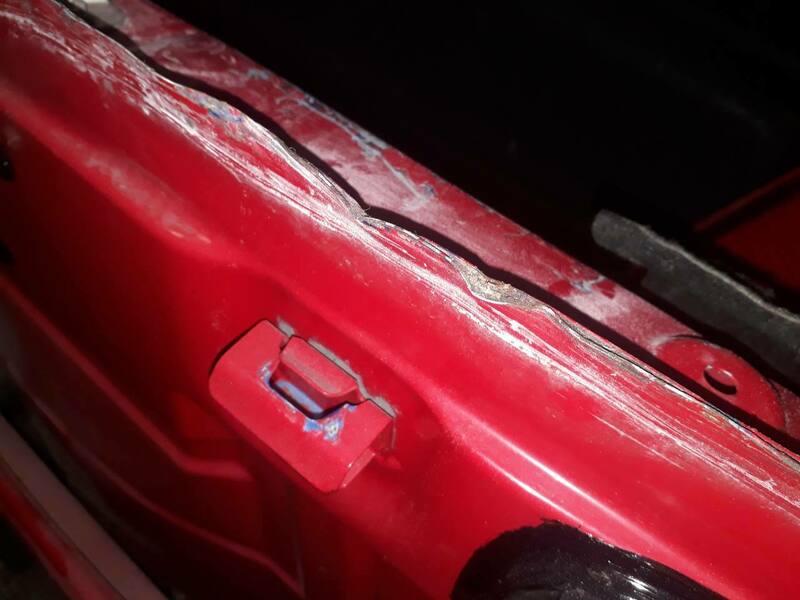

While in the boot area the seal on this was badly damaged. Like it been hauling rubble or something at some point. The rubber seal was destroyed. So i had ordered the x8r seal upgrade kit that is ment to help with water leaks.  Some oversized seal and some D shape foam.
Seam edges dollied straight enough, panel was knocked back with 80grit and then a quick spray of stone chip went on.
Tailgate now needs a proper slam to sqaush that seal down. I ran the addition seal accross from light to light above.the last inch or so is slice so the light unit tucks into the foam.
  • Like 10
With the tailgate shut the foam seal fills the void so maybe water will go over and down  the glass or at least some of it will. Maybe.
I had some left over so opted to go down the lights to fill that void, my hope is that any water from the top of the seal goes down the centre of the downward seal if that makes sense.

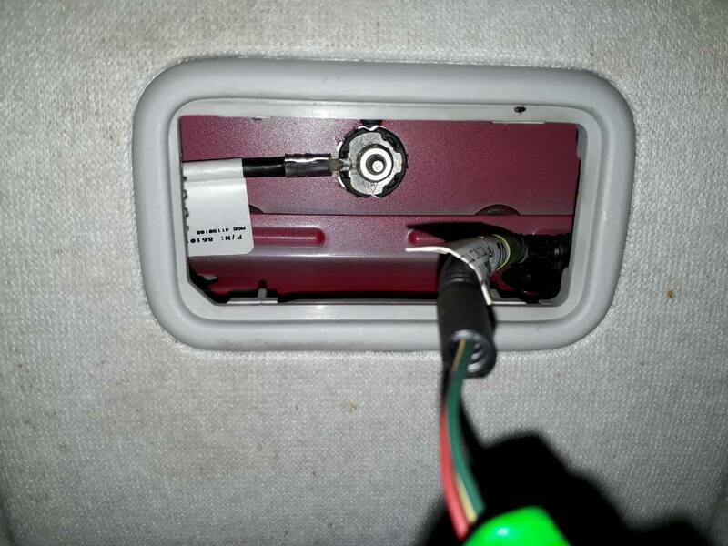

While i had the goop out i popped the ariel out and sealed that, no signs of a leak here but no harm in doing it as it is also a common complaint.

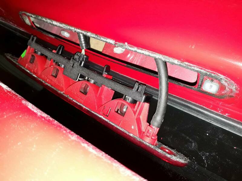

The high level brake light is also a well known leak spot. Shitty foam seal degrades and fails. New seal kits online but to pricey for my already blown budget. Boo!
Old Seal cleaned off, 4 new bulbs chuck in to be on the safe side. I then bolted the lamp back in situ, most people seam to clagg these in sealant then fit it, i didnt like that as its a right mess should it need to come off. I masked the lamp and roof area and ran a bead round, then a little wipe and im calling good enough. To remove the lamp it should peel away easy enough.

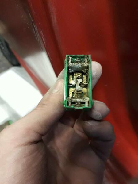

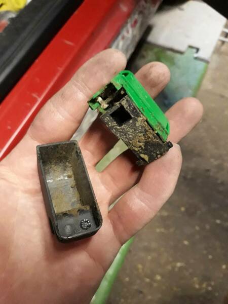

I discovered the N.S window didnt work, being a cheaper car there is no dual switch on the drivers door so while i had the switch out i tried it on the door and the window came back to life thankfully. A new switch is a cheap fix so thats a good start.
But id rather not spend any money, so lets pop the switch appart. Maybe just rain water has corroded the contacts and a bit of a clean will bring it back around.
Well fuck a duck,
I pulled it to bits, cleaned the corrosion, mud and pubes of the contacts and stuck it back together.
Woop! Love a free fix me!

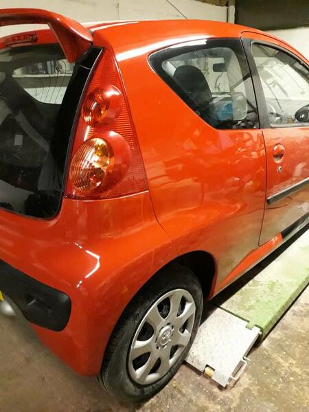

Only a Quick tinker tonight (and a cheeky beer that the owner had made) tonight. He had been getting a fumey smell coming in the cabin and it was occasionally running a really high idle on a cold start.
Quick noisey around, popped the airbox off to check for any knackered vac pipes, found a pipe from the cam cover to the inlet manifold had failed, snipped off the bad bit,refitted, let it idle with the blower on and my mate gave the big thumbs up so we are calling that fixed.
New headlight and numberplate bulbs, fluid check and top up, tyres pumped up.
Overall still going good, sump gasket needs doing as its leaking quite a bit, its due a oil change in a few hundred so we will do it then.
Only issue to report is the tax has gone up its £280 now, that stings for a 1.6 auto!  It is offset by the overall lack of money this thing costs maintain,

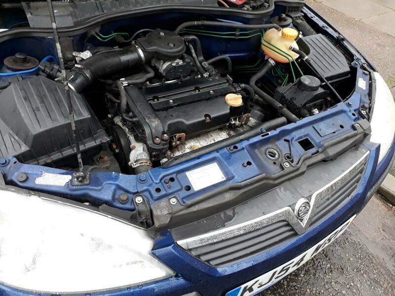

Its been mentioned before but no pics, this was the one that the young lady drove 20miles with no oil, did it survive that?
Kinda, its still alive but its using 1.5ltrs of oil in twos weeks. She comutes 5 days a week 40miles plus general useage miles so its doing maybe 250miles a week.  We cured the external leaks and its bone dry underneath so its burning it, assume ring damage?  i guess it could be worse but as shes not very financially well off its not helping.
Swapped the 5w30 out for fresh 10w40, just to see if that will get her a few more miles before a top up, ive got a  few motors that get maintained here running 10w40 / 5w30 and they get serviced regular (4-5k) , if the oil consumption of this stays the same ive offered to bottle up the old stuff from them and she can keep it going with that stuff. Its beyond help now so no point wasting the money on loads more fresh stuff.
While it was here we gave it a bath, wet sand and polish on the headlights (just doing a finish cut in the pic)
The heating was shite, the stat appears to be stuck open but with a gunged up expansion tank the systems had oil in it in the past. The timing cover gasket fails and allows oil into the water. We know the chains been done so this should be old gunk. The gunk however clags up the matrix so heating is shite. Today then we done the same as on the green Corsa featured here when i owned it, pop the pipes off, flush back and forth with hose Then i fill it up with neat APC (g101 or similar will do fine) let it soak for 20-30 mins then repeat the flushing. Then connect it back up, cleaned out the expansion tank and chucked some coolant in.  Heater actually now had heat, sure it could be better with a new stat but a stuck stat on a fucked engine wont be getting fixed.
Its got a misfire and the coil pack is a bodged up mess. We may try and fix this, maybe a scrappy coil or even just a new plug boot and spring.
We Also Found a knackered rear wheel bearing thats howling its tits off, this will of course be fixed ASAP, because safety.

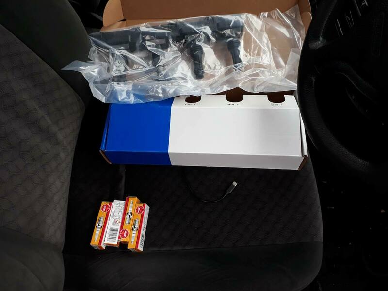

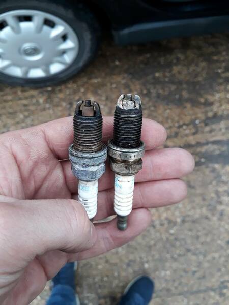

That misfire came back with a vengance. My mate was working so i popped out today on my day off and chucked a new coil pack on, and only two plugs! Two didnt want to budge and the cars needed to be used at 3 today so the quickest fix is the only fix
Cyclinder twos looks to have got mighty hot. Cylinder 1 was the misfiring one.  20220111_131832.thumb.jpg.7f5d907f1430f6856578575fdddde35c.jpg
Sorted, for now, we will have a look at the other two plugs when it comes back to change the fucked wheel bearing.
