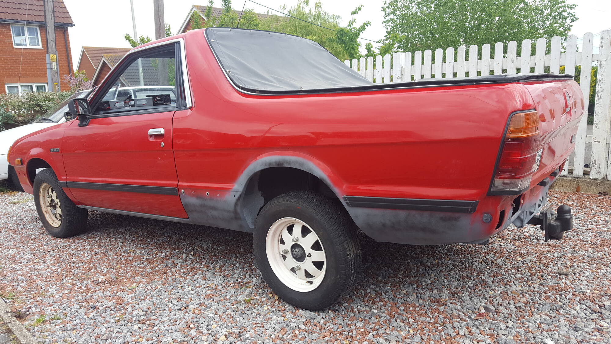

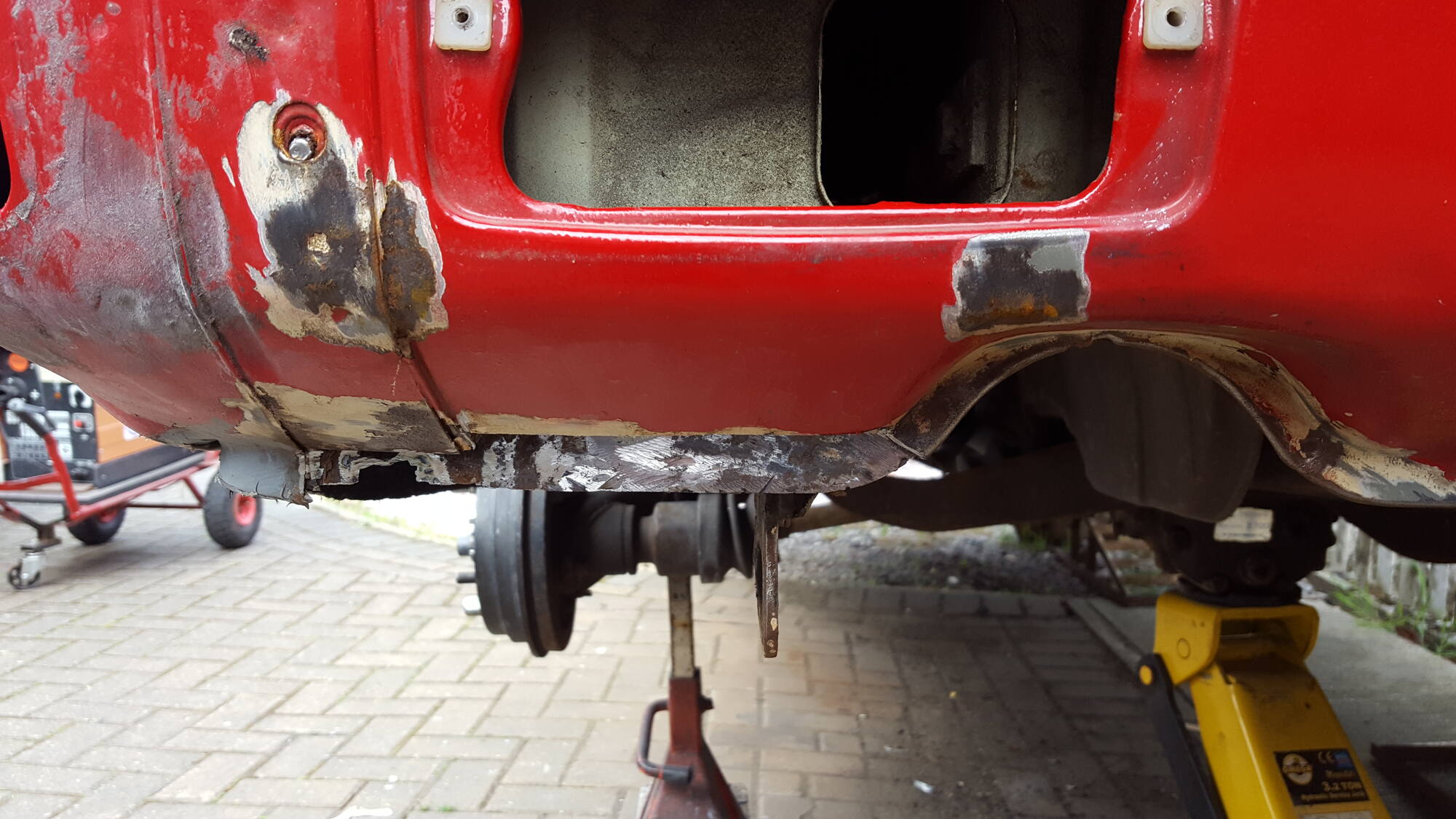

So this holed bit on the back panel had also rusted out from the inside due to water ingress and so i cut away the paper thin section and made a patch to weld in.
When i had the truck painted in 2013 i had its lower extremities all stone chipped before having the top coat applied the hope being it would stay rot free for longer and i guess it would have had i correctly sealed the rear lamps and made sure any drain holes were clear.
Derusted,painted and stone chipped again,i am going to make sure the inside of this rear panel is swimming in wax before the truck goes back on the road.

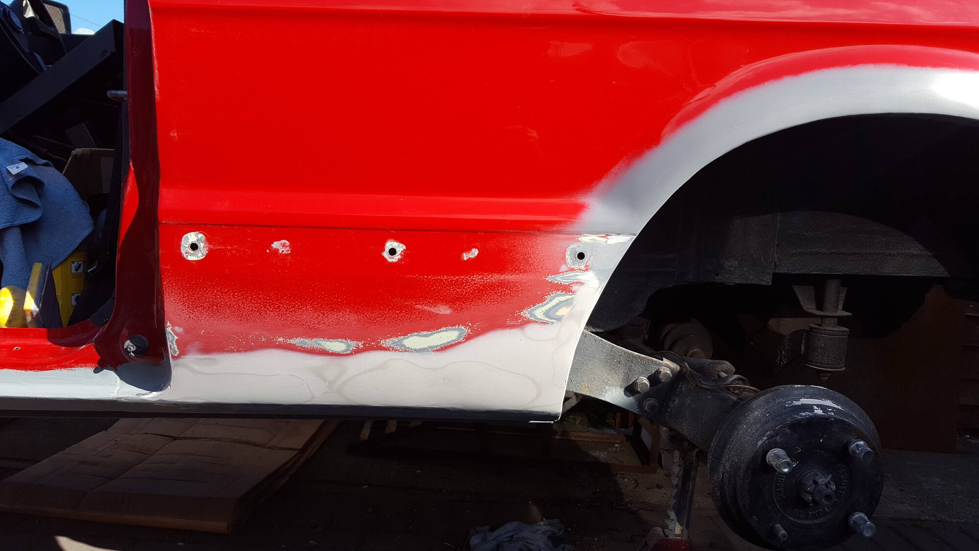

Today has also been "crack open that fresh tin of P38 day."
I really detest filler and trying to get good results,i get there eventually but i always end up putting way too much on and spend forever sanding the stuff off again.
The lower rear quarter used up half of my 600g tin to get looking and feeling right,not really sure why i spent so long tarting about as no one is going to look there anyway.
The arch has been a slag too,it's either to high or to low.
And the blending of the sill to the quarter panel took way more filler and effort than my patience allowed for.
But once i splurged some high build primer over everything it doesn't look too bad.
It's  80% there and i will guide coat it and do the final 20% when i decide how to paint it.

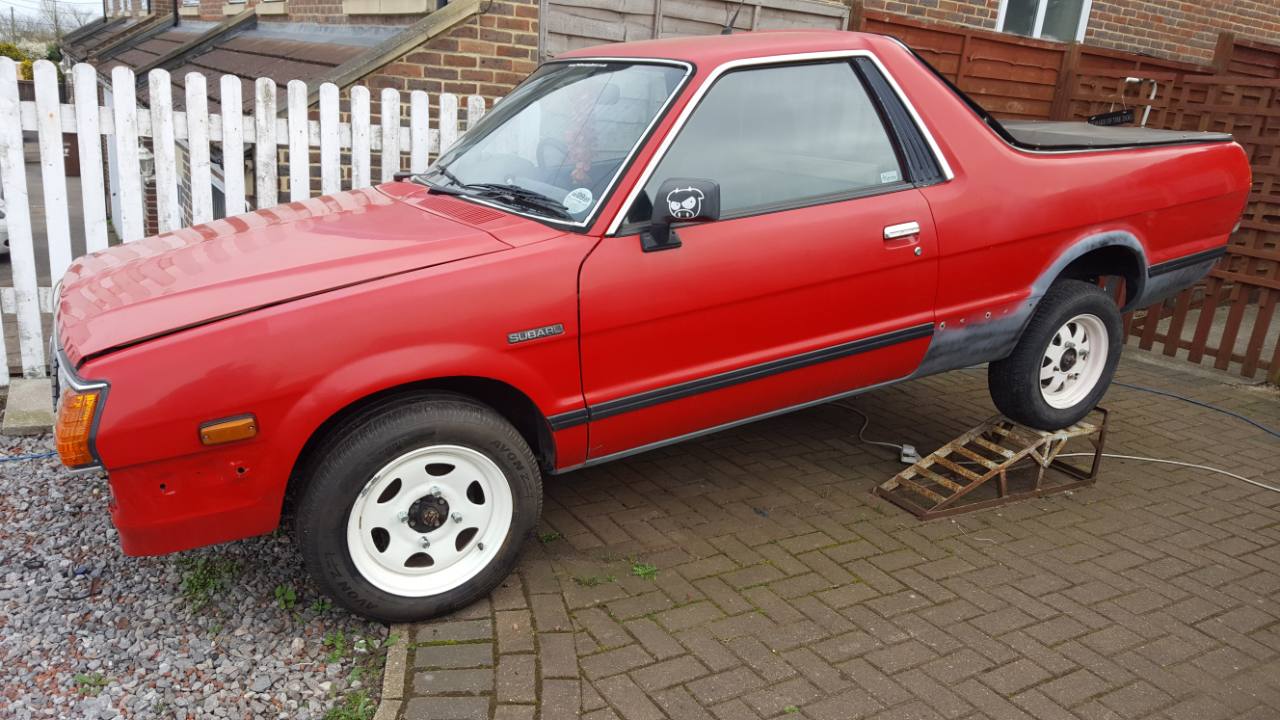

Well this is a bit of a mile stone for me,the near side of the Subaru is welded up and solid.
As i have said previously i should of replaced the full sills and rebuilt the rear arches before i painted it back in 2013.
So instead of replacing the fence today as i promised Mrs Spud i span the truck around and started on the drivers side...
I found these homemade ramps in the brambles behind the shed when i moved here back in 2008 and they are actually quite good and with the truck being two or four wheel drive it's just a case of pulling a lever to select all four wheels and straight up the ramp she goes without them shooting off into next doors garden.

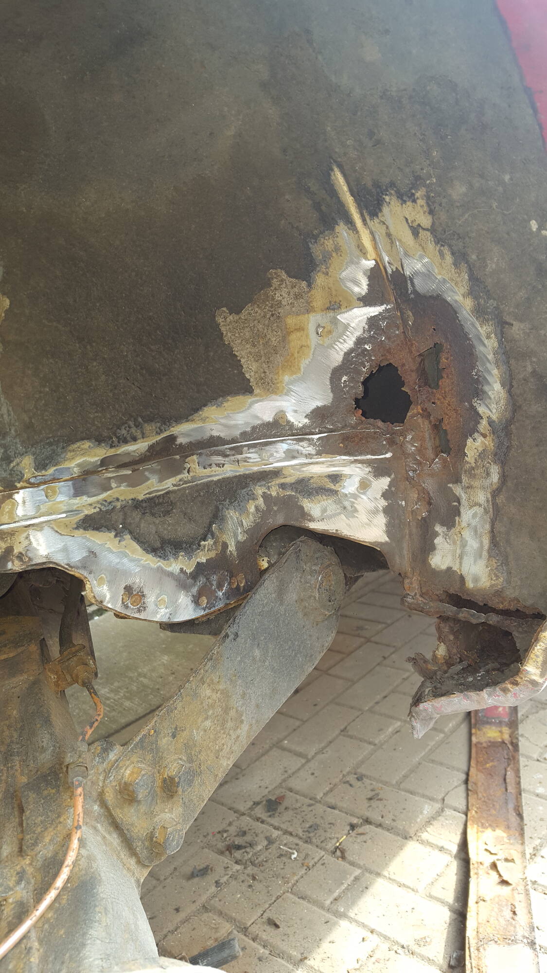

This hole in the rear of the floor was a suprise as the nearside floor was perfect.
The whole length of the inner sill was fine apart from this bit,i am 99% certain this rot was caused by a leaking windscreen seal that let rainwater pass down the A post and collect here unable to drain away.

The rear lower quarter is a bit better than the n/s though.
I cut away some of the outter sill (note previous patch repairs made from a spare red bonnet had held up ok) to have a look inside.
Well to be fair it's no worse than the other side was.

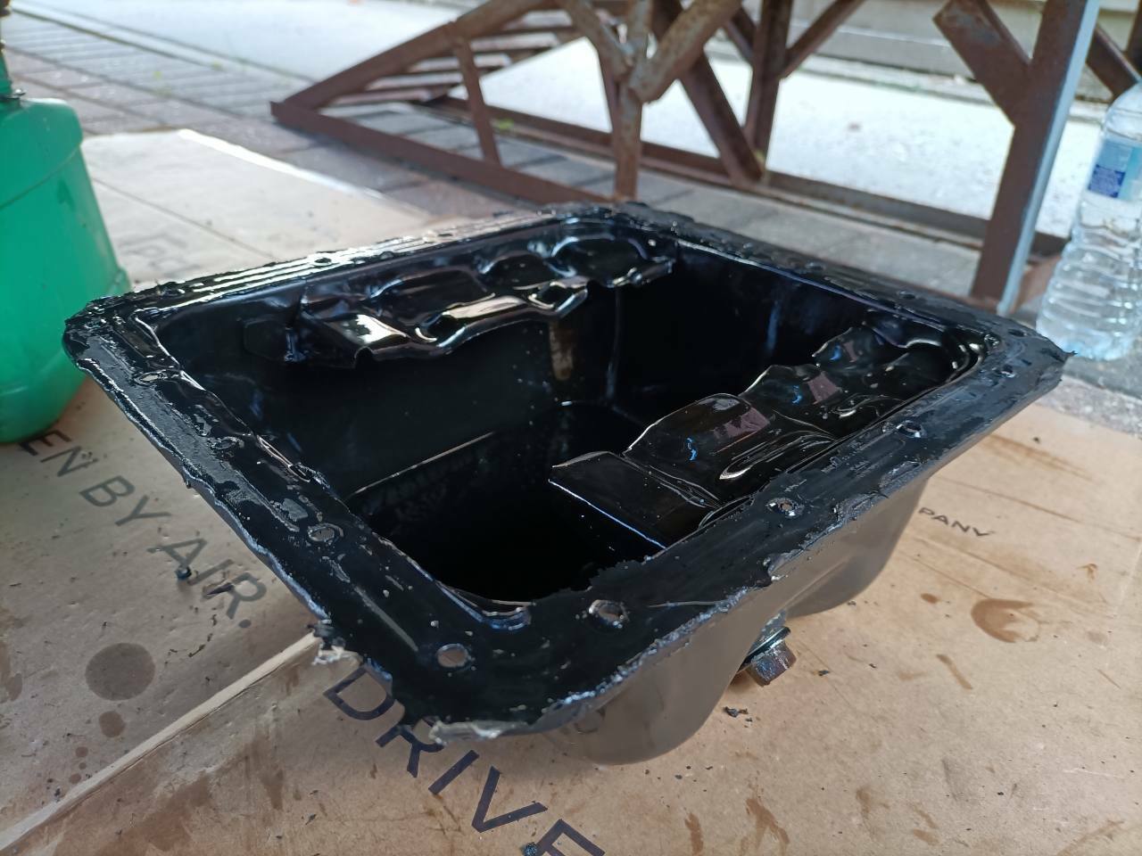

The sump has been leaking ever since I used tiger seal as a gasket as the new cork gasket I had intended to use was very wrong.
Being 80's Japanese the sump could be easily removed without any need to lift the engine or drop the cross member.
I had a clean spare sump so didn't have to fanny about scraping the tiger seal off the original one and used a smear of good quality silicone to hold the gasket in place.
It all bolted back on easily enough and I'll leave it overnight for the joint to fully cure before adding the oil again and running it up.
