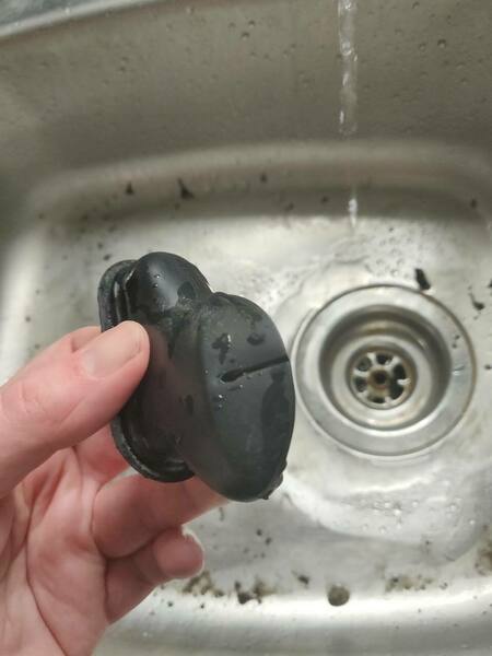

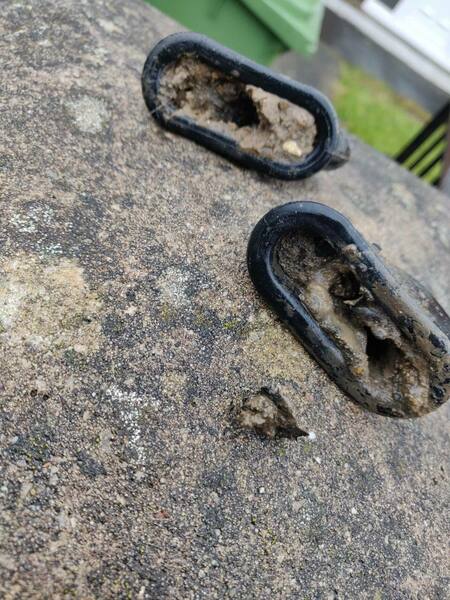

There are two holes in the scuttle panel like this. They are hard to access without taking the wipers and top scuttle plastics off.
In these holes should sit two plastic drain bastards, that drain through a stupid slit, that can be blocked by one leaf.
They are meant to function thus.
If they've never been cleaned or cleared, they may be blocked.
To access them without dismantling shit in the rain, you will need a selection of random improvised tools.
And if you were any good at HOOK A DUCK (bill) you might be able to fish and dig them out.
It helps if they are absolutely backed solid with matter because then you can stab them with an old flatblade.
So yeah. If you have a Fiat and your carpets are wet, check these mothers.
I don't see any requirement to reinstall them, they're a shit design imo. A hole functions much better with no maintenance.
So I just popped them through next doors letter box.
Manufacturers install them to prevent fumes entering the cabin as they're often around intake vents for the cabin fans. They wouldn't install them if they didn't have to as they can save a lot of money on a production line - especially important to someone like Fiat.
That being said, most chuck them away on their cars (not just on the Panda) when they get clogged up like this and people haven't died...

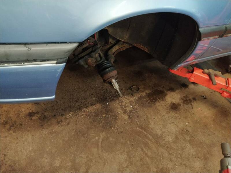

The old bird has  been treated to:
Some welding to the bottom of the front arches,
Near rear wheel cylinders,
New master cylinder.
Handbrake cables.
Clean up, free up and lube of brakes all round.
New front shocks.
New front top mounts.
A new rear spring.
A CV boot.
An engine mount.
A new front section of exhaust.
And he hit the horns with a hammer till one of them started to work.

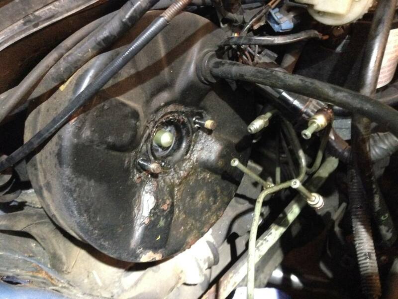

In for the cylinder.
1073992843_signal-2021-03-09-213909(5).thumb.jpg.6ea76e3db9c64e0dea3f7e3588156a82.jpg
1766736793_signal-2021-03-09-213909(3).thumb.jpg.5cad35a882d4212e5b08f93ae643d255.jpg
1236861417_signal-2021-03-09-213909(2).thumb.jpg.03291fae2899d733f808d5c7cf223a60.jpg
1456903354_signal-2021-03-09-213909(1).thumb.jpg.cd87d630b59ed9f711e2afc1898d75b6.jpg
Brakes far more brakey now.
