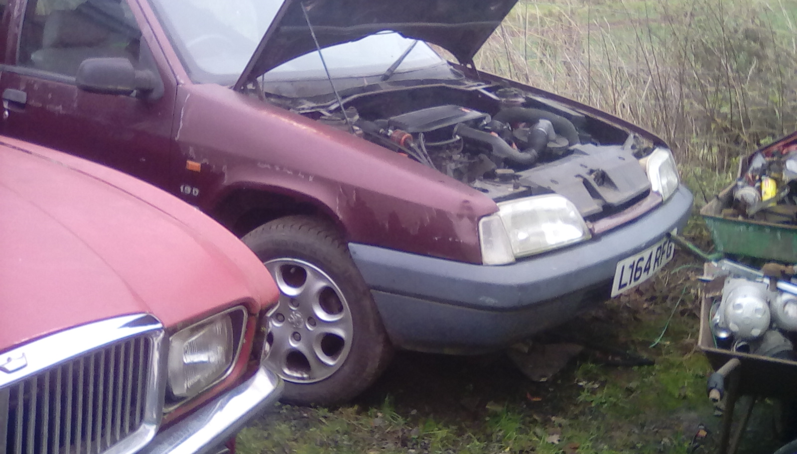

Just a couple of pictures of some of the crap round the backpost-19511-0-58131800-1544125329_thumb.jpgpost-19511-0-57844000-1544125365_thumb.jpg
There is loads more
