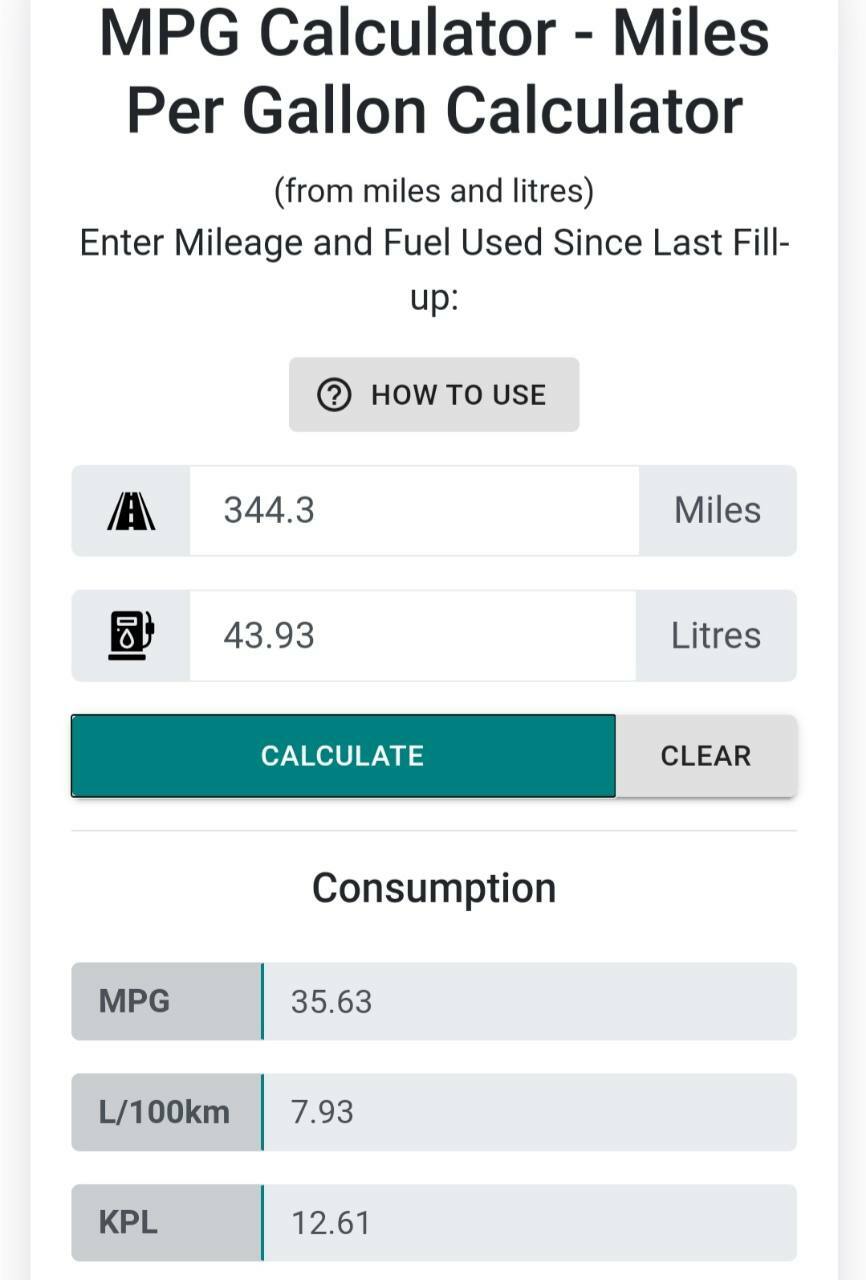

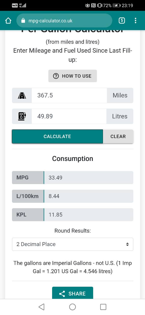

8 minutes ago, jaypee said:
MOAR MPGSESESES!

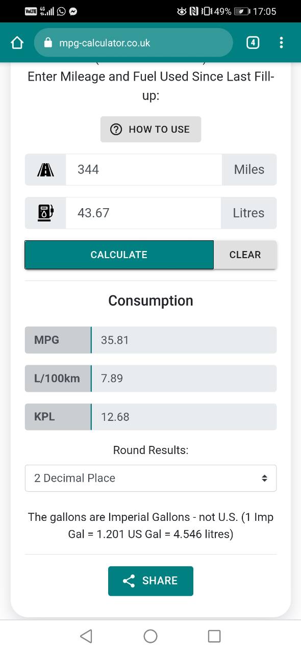

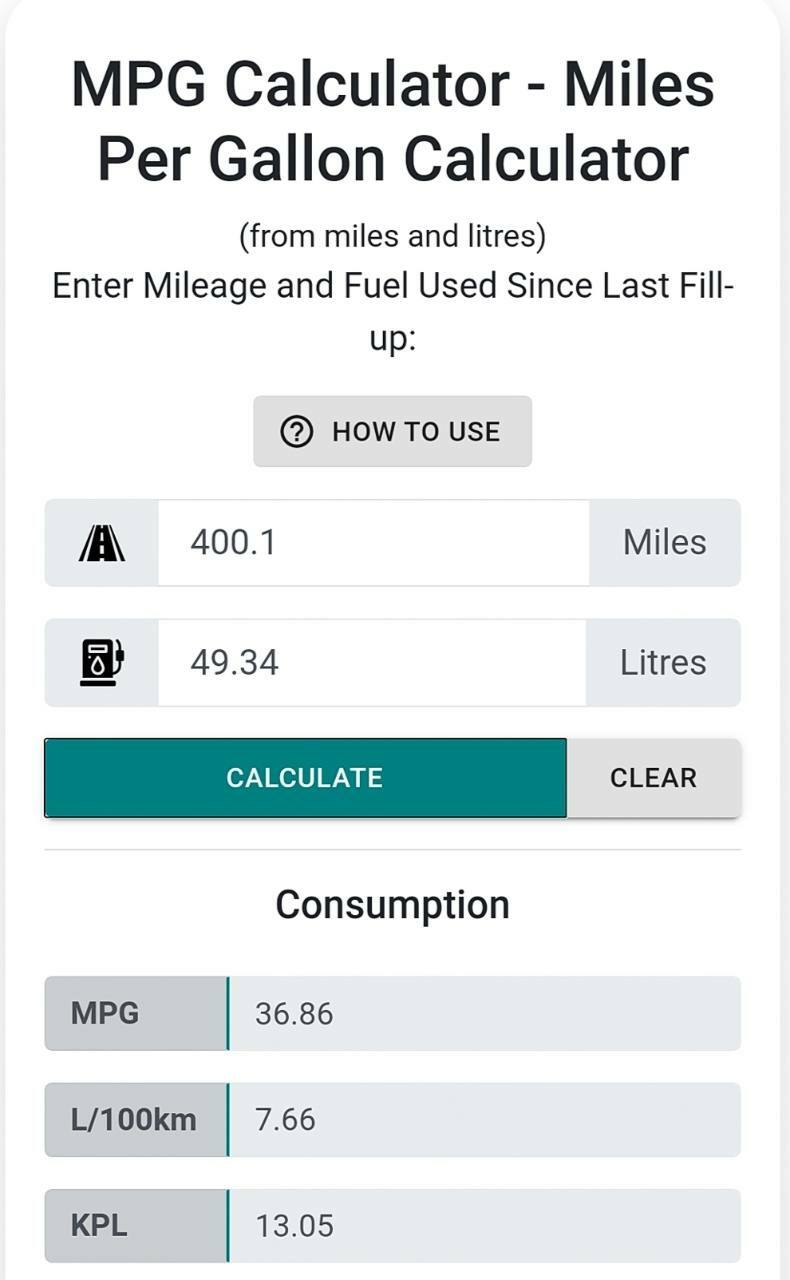

Screenshot_20210619_170536_com.android.chrome.thumb.jpg.3a67662a33126b5a7db3313e9cfbc68e.jpg
No way? That's mega MPG!
WAY! Aye, it's been getting shoed as well.

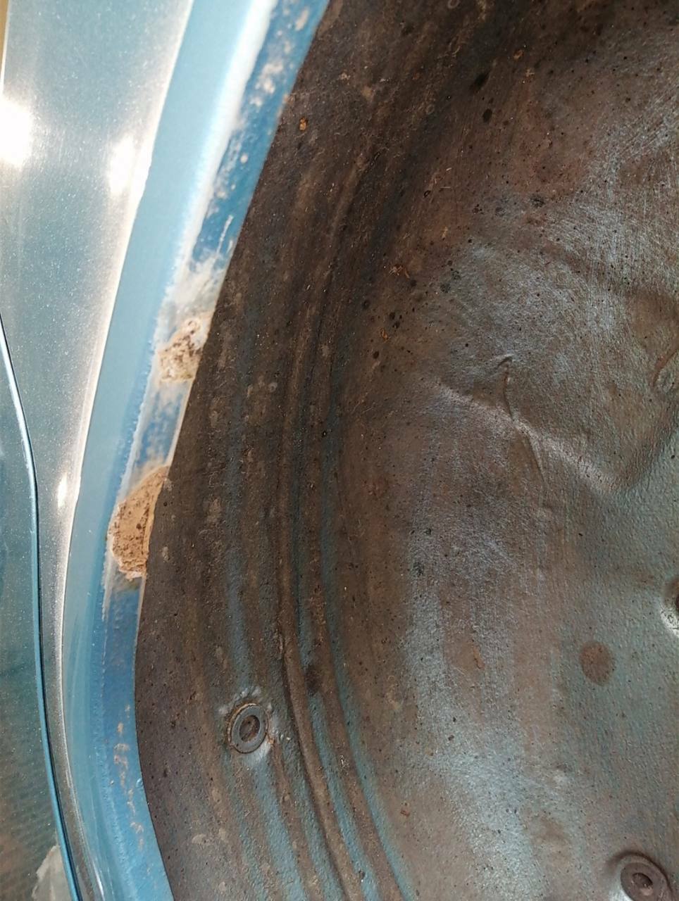

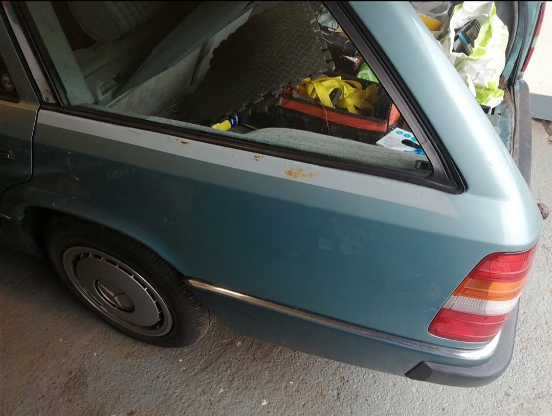

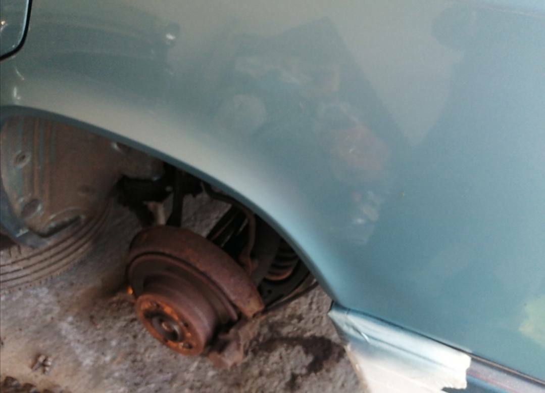

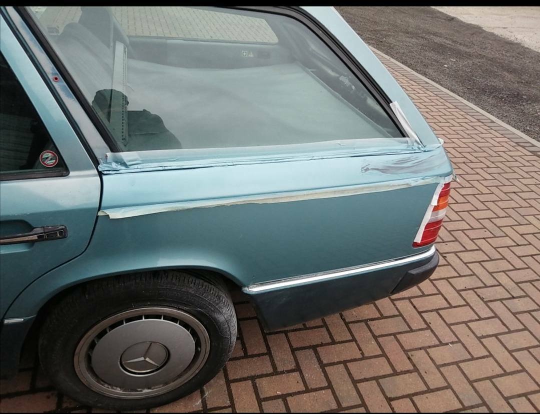

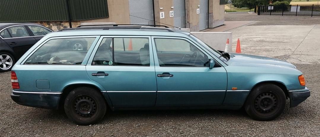

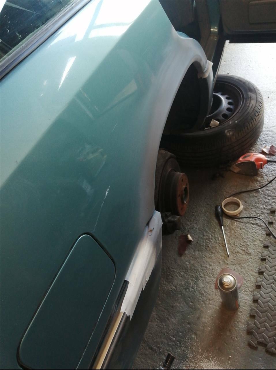

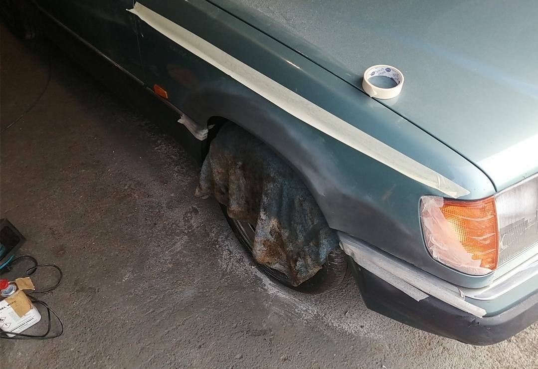

I did some more work on the paint on Saturday, after a stern word with myself, I promised to take my time and not rush things.
First off, the primered area under the passenger rear window,
Sanded down
A bit of filler and some new primer was added, then the first application of base coat.
Nice! Colour wasn't a million miles away but the car has definitely faded over the years. Was looking good, best not rush the second coat of base.........
Arses. It had a run, I thought, 'I'll leave that to dry and then sand it back', then I thought... 'nah, I'll just catch it with a rag and paint it back in' suffice to say, neither of those worked, the above is what was left, at this point, I paused for lunch and let the paint dry. After lunch it was sanded and re-primed, and painted. From that point on, I set a timer on my phone after each application, and solemnly stuck to it!

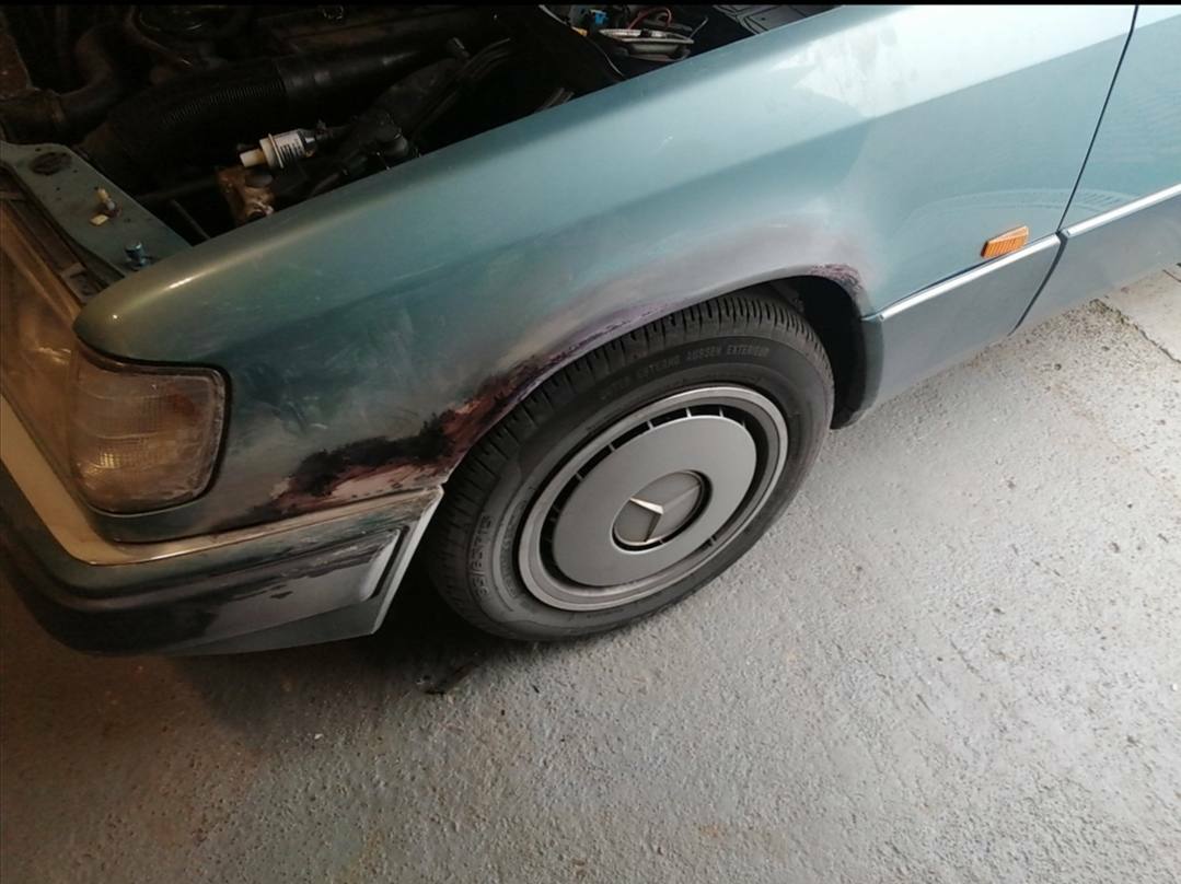

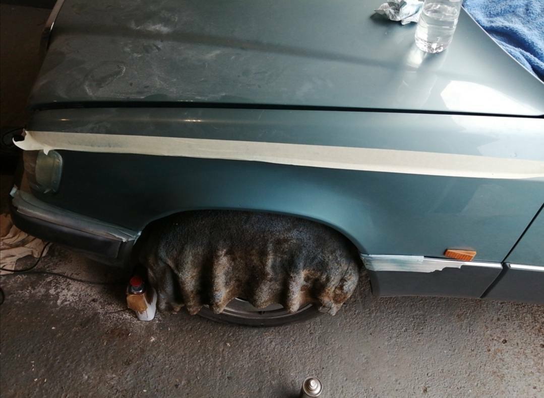

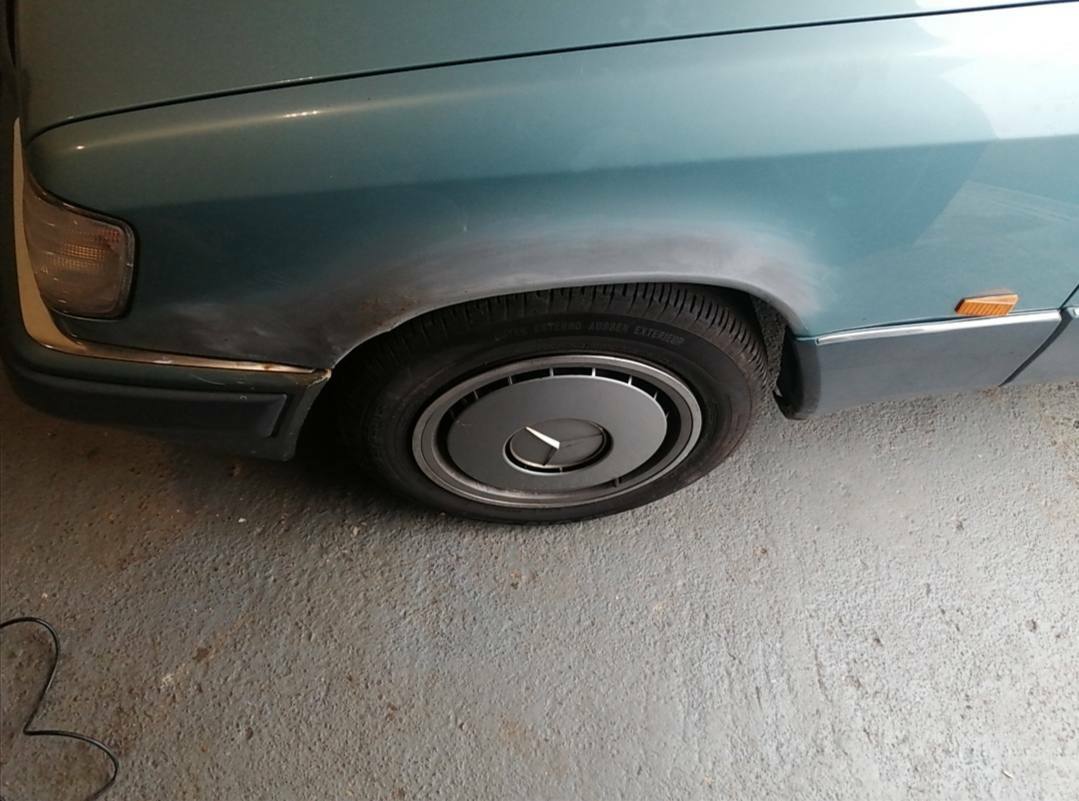

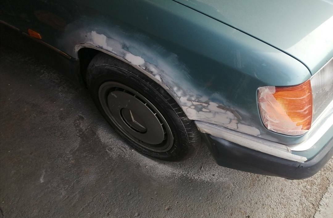

Next, it was onto the front wings, seen earlier in the thread. Now that I had access to the grinder and sander, I did some tidying up, and filling, and sanding, oh god, the sanding!
Time for some colour...
You can see on these the slight mismatch of the colour, but it's certainly a lot better than it was!
Some 'final' (or, that's it, I am going home) pics. Just got the feathering in/blending and lacquer to put on.
Again, as I say, a metric fuck tonne better than it was, almost looks 'decent'* from 10 yards.
After a full 11 hours of paint and sand and fill and wait and sand and fill and wait and sand......
.. Etc I called it quits and headed for home

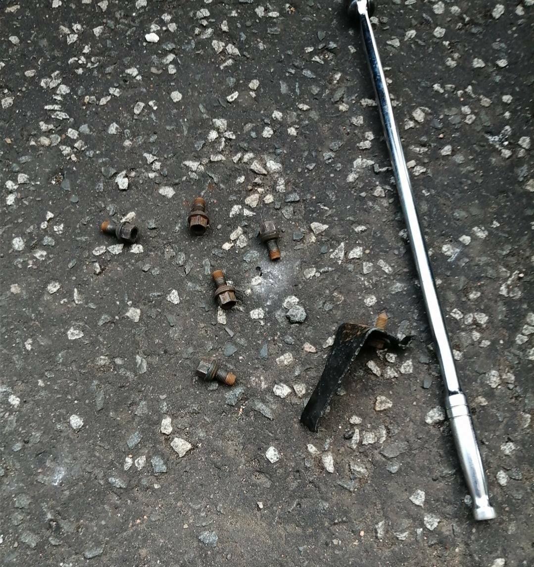

In preparation for the visit, I carried out the idiot check and confirmed all wheels were indeed bolted on correctly. My suspicion was, either a fubarred bush, a broken spring or an 'ARB drop link' even although it does not technically have any at the front.
When Neil arrived, we went out a recon mission, the noise was pin pointed at the front right. Suggestions were made that a top mount may also be a culprit.
A quick jack up, and wheel removal allowed us to discover.
This bracket...
Which should be attached to, this arb bush
Which, it wasn't, so with the bracket removed, we put it back together and took it a test drive over the splendid* road surfaces of Pollokshields.
SUCCESS! The clunk was away!
You may note, that I replaced this bracket as part of the front suspension refresh, obviously it was a great* quality* part.
Anyhow, a new one has been ordered for this ungrateful thing!
Cheers to @320touringfor the assistance

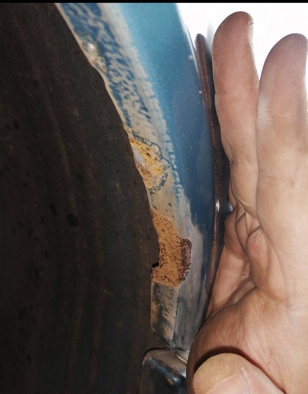

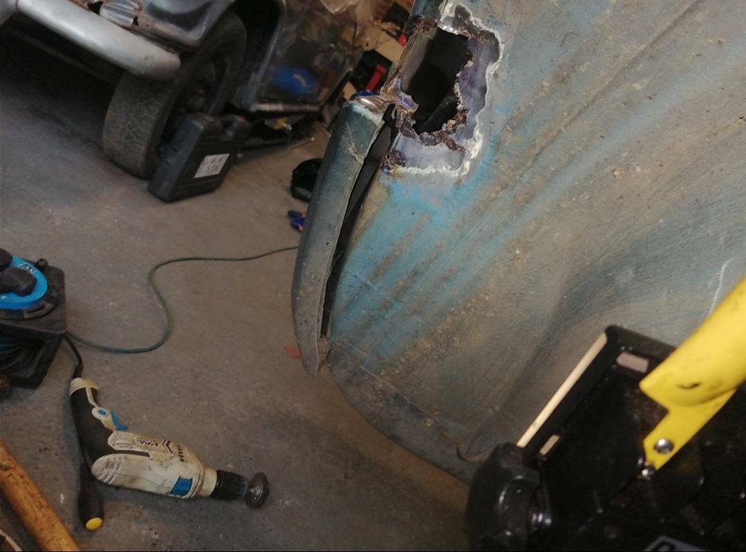

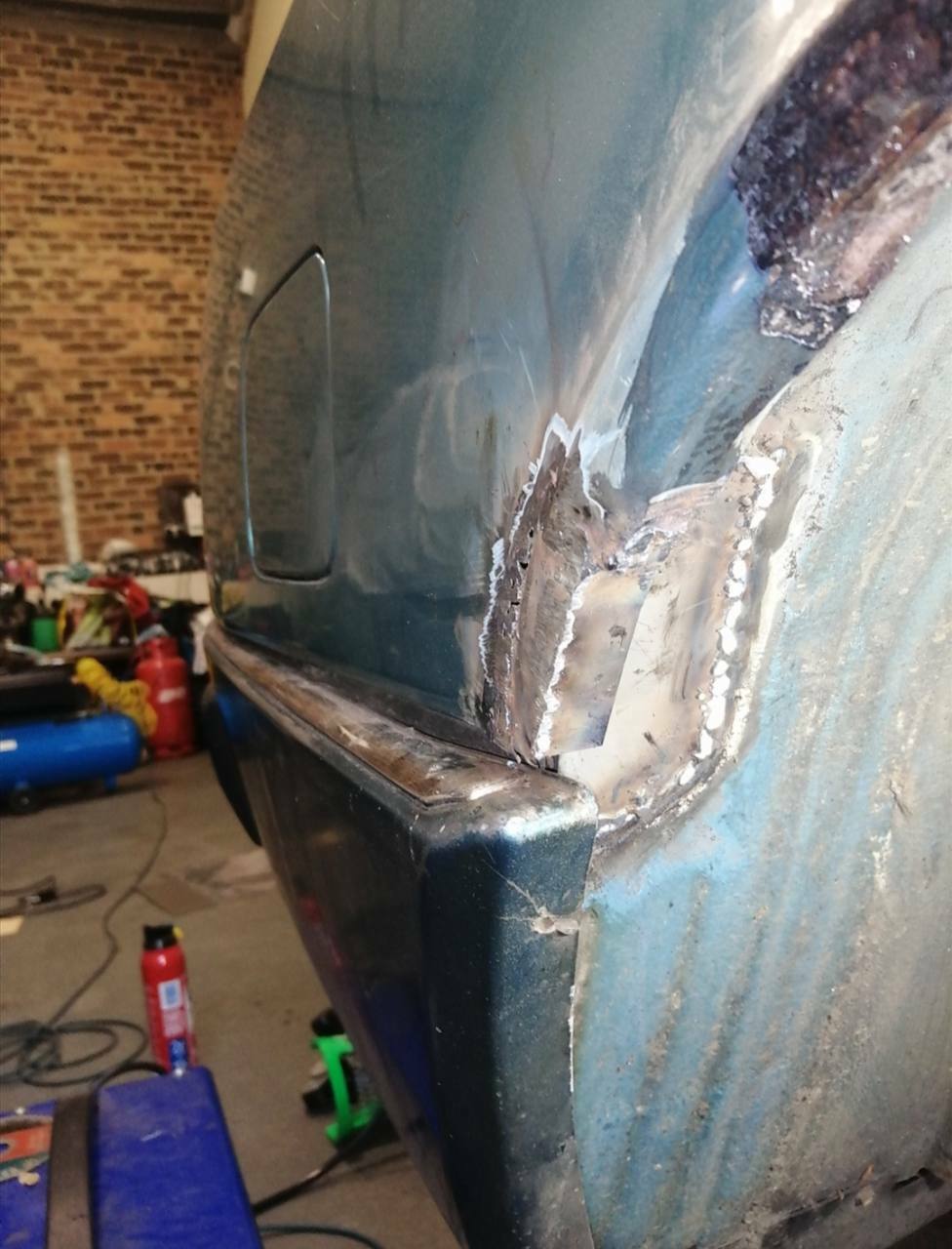

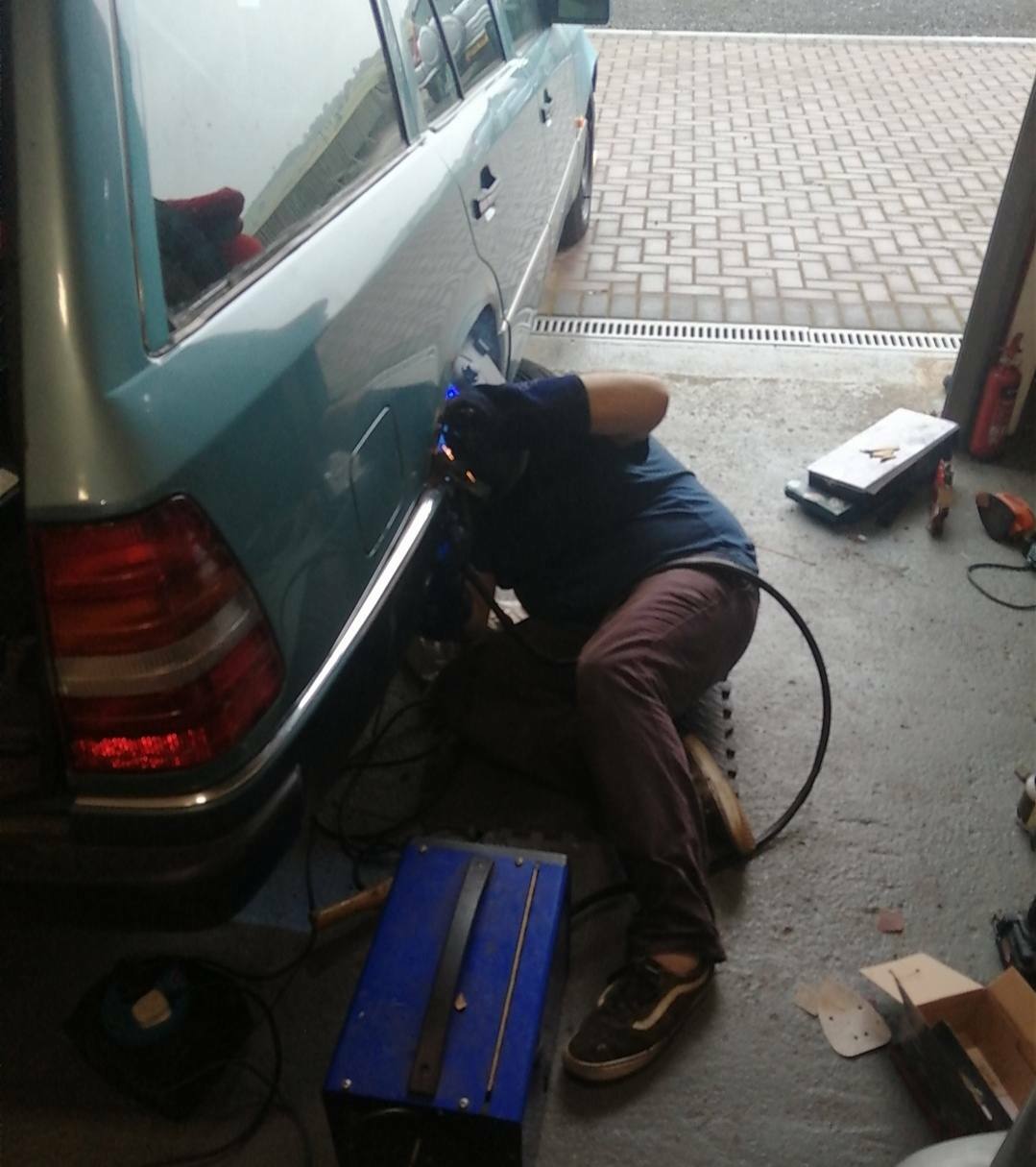

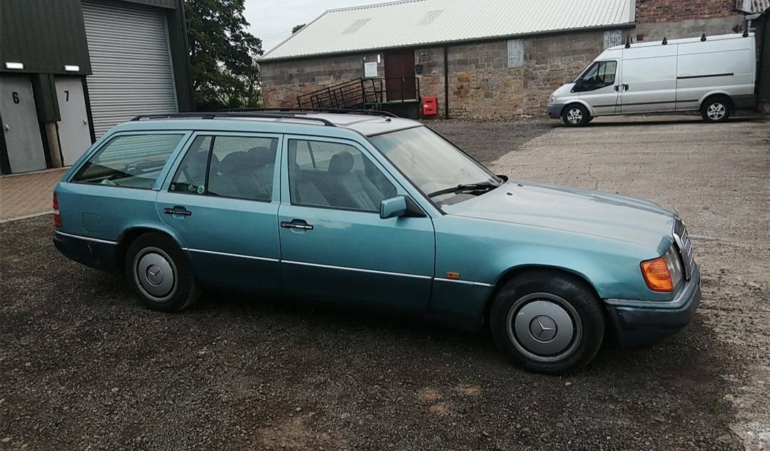

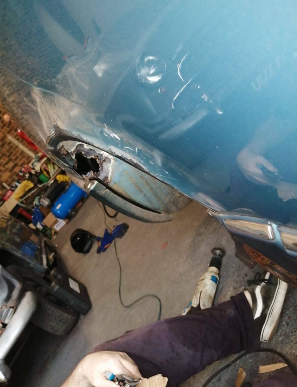

Some more progress on the merc this week, a quick* filler job turned out to not be possible.... Hopefully the pics will cover it off.
Many thanks for the assistance to @320touring who kept an eye on me whilst I did a great job of making a mess of welding 😂
Also a special thanks to S_PEWGS.. ( @Split_PinEmergency Welding Gas Services) who kindly got us out of a tight spot!
Again, it's not factory fresh, but it at least has metal in it, another wee skim of filler and sanding should see it ready for paint. The other rear arch looks fine from straight on, however is a little bit bubbly on the lower lip, so that's next!
I'm really glad you decided to weld it up - you're making a grand job of making this into a much better car that it would have been if I had kept it!
Getting there with the welding too!

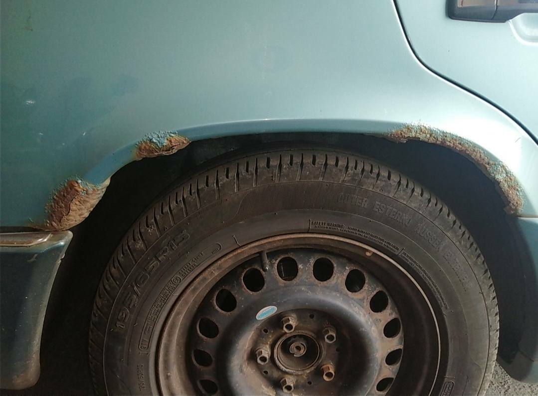

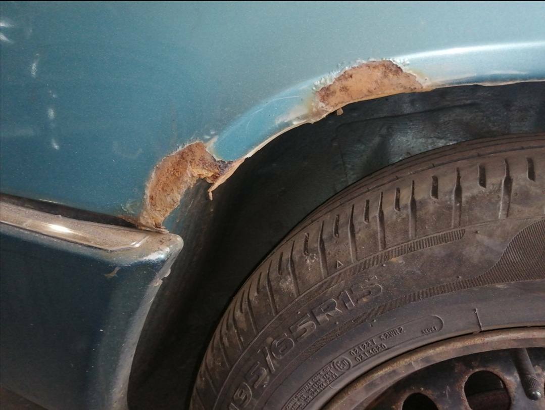

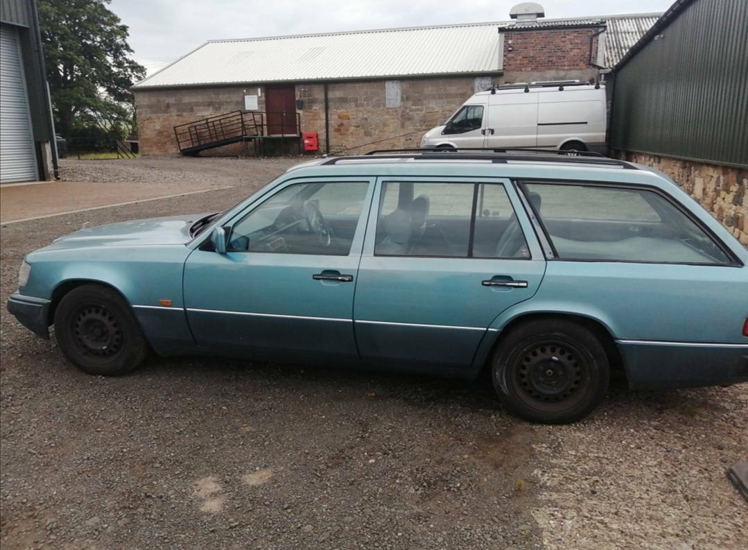

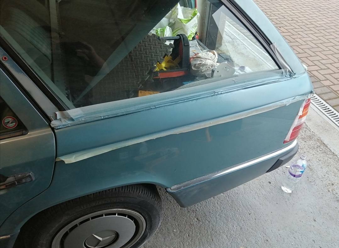

Did some more work on the Merc this weekend.
Finished off the driver side rear arch and did the passenger side rear arch too!
Driver side done, just needs blending and lacquer.
Passenger side rear arch wasn't too bad.
Again, not too bad, certainly looking a lot better than previous!

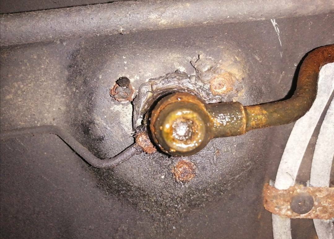

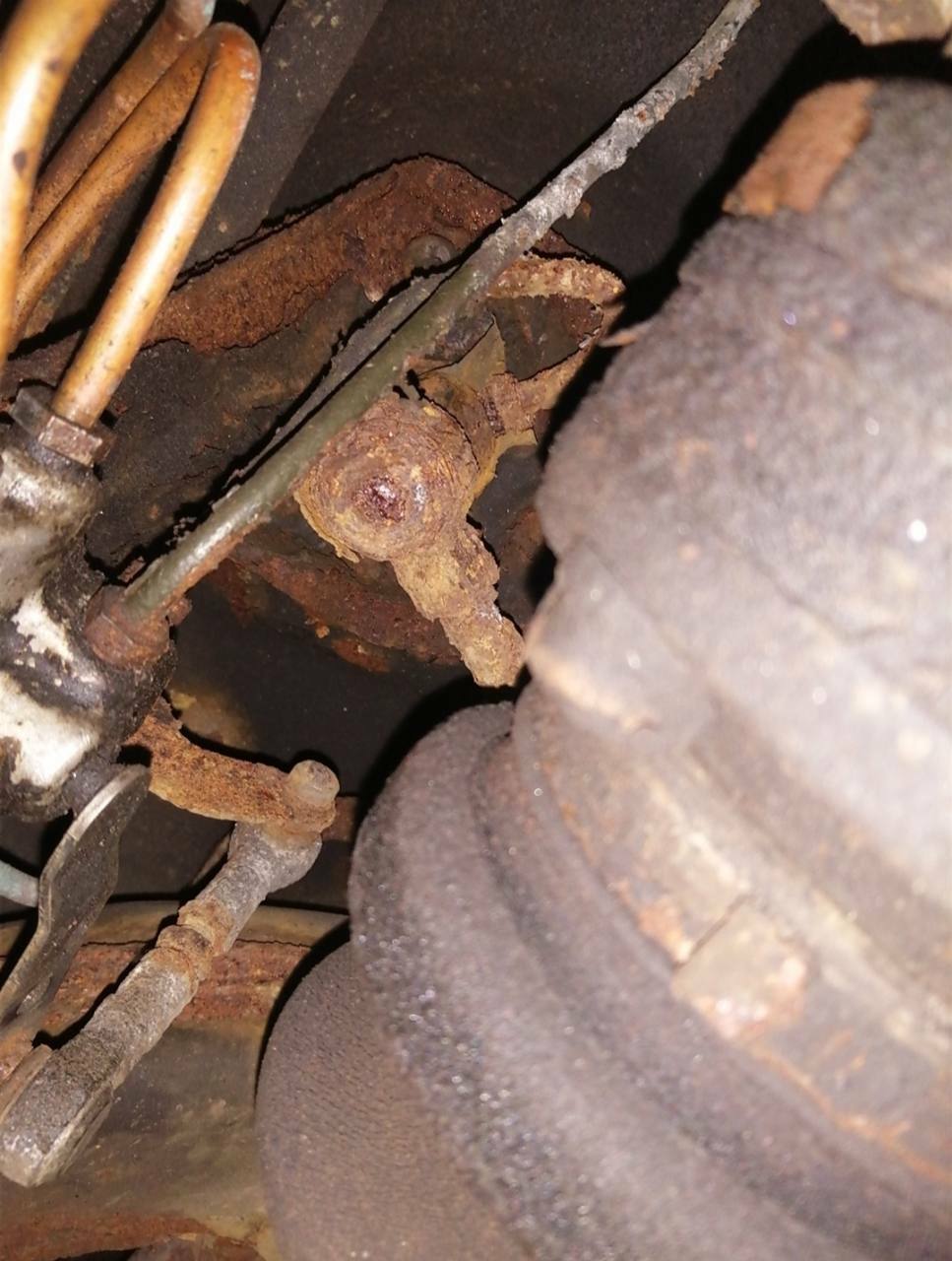

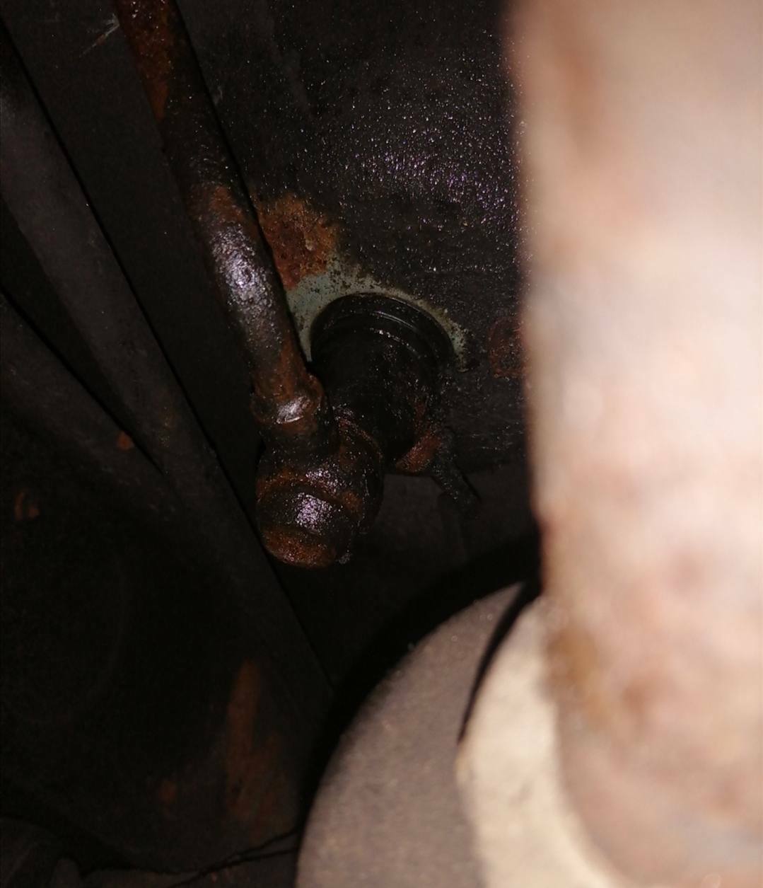

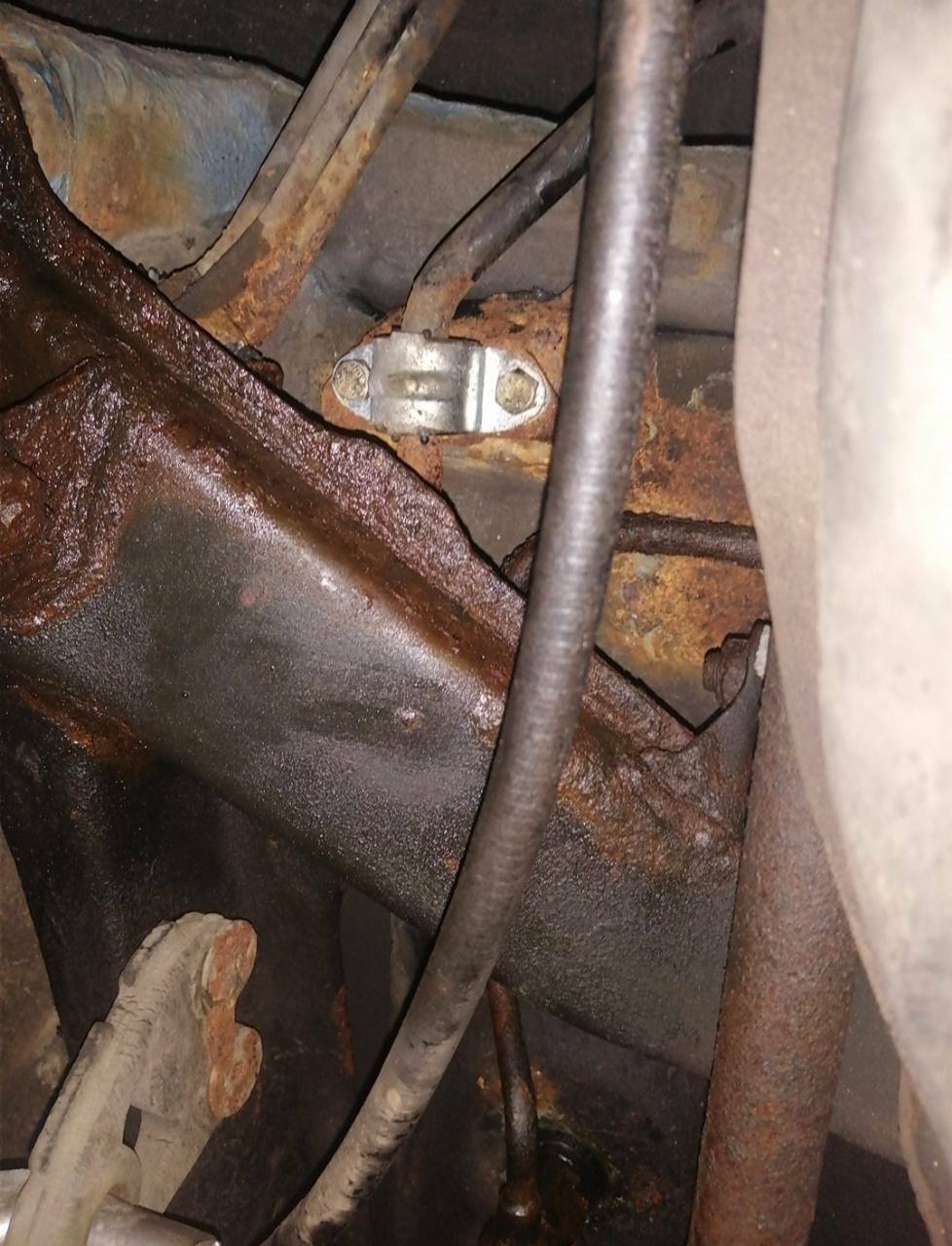

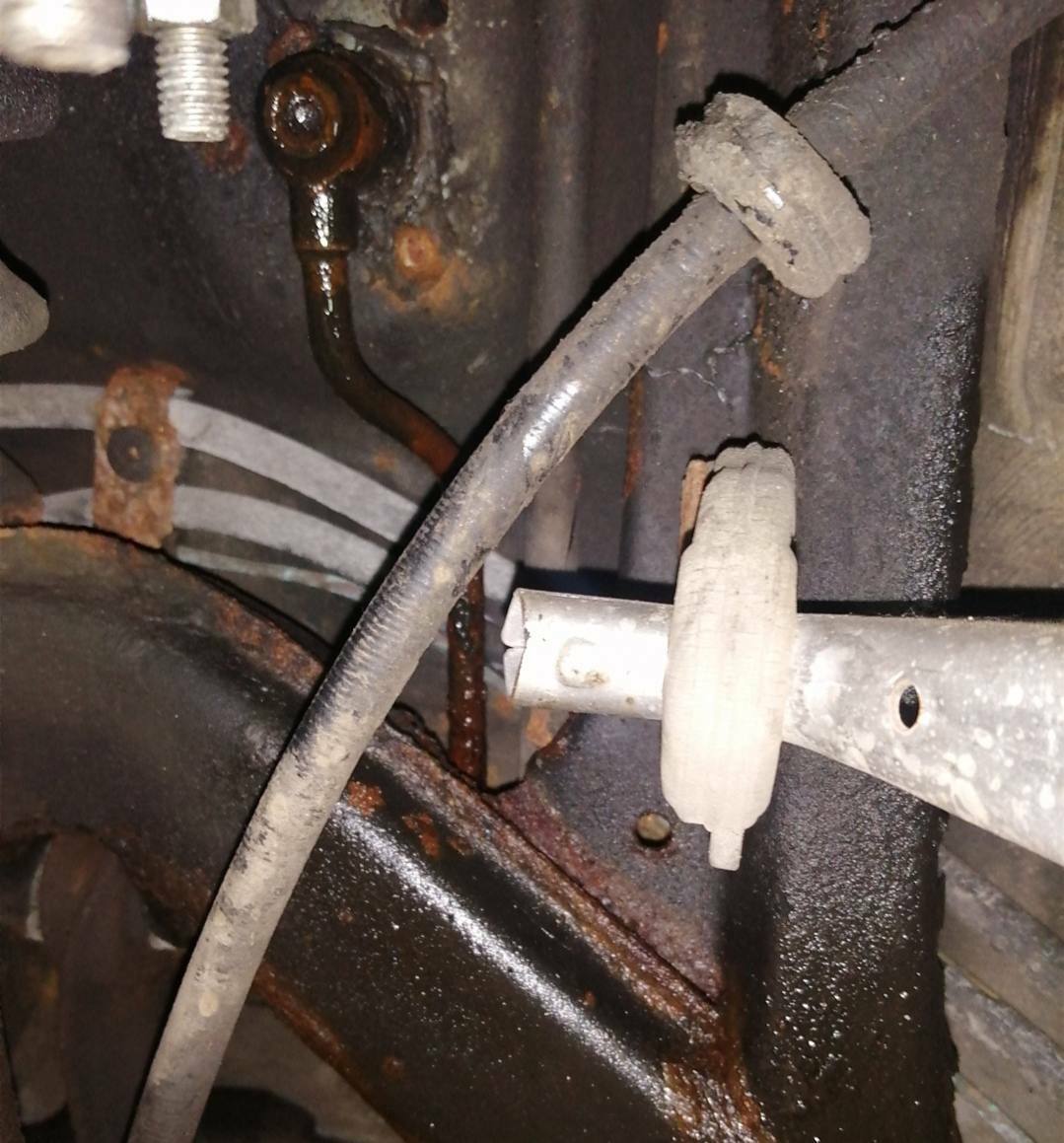

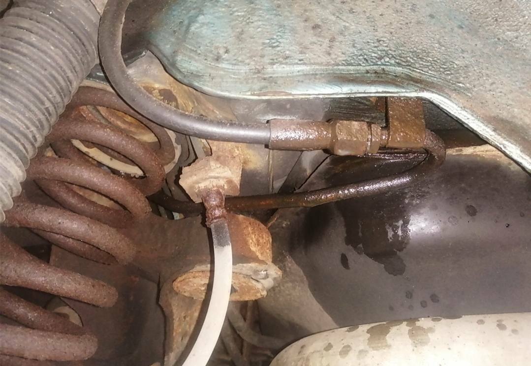

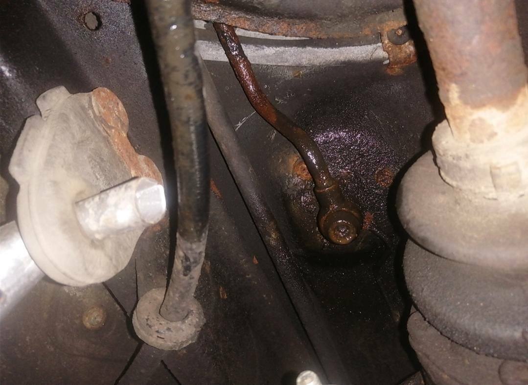

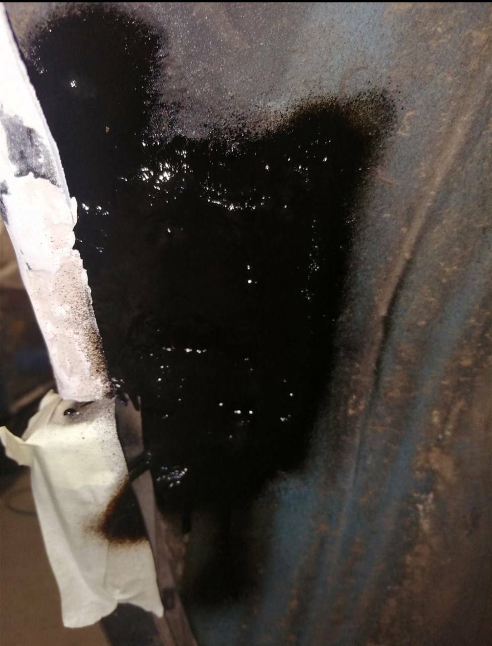

Did some more investigation tonight, couldn't get it to replicate the leak/fault, however, I do have my suspension suspicions!!  (car was on ramps so suspension was loaded)
Up in the air, like she just don't care.
Might be a leak here

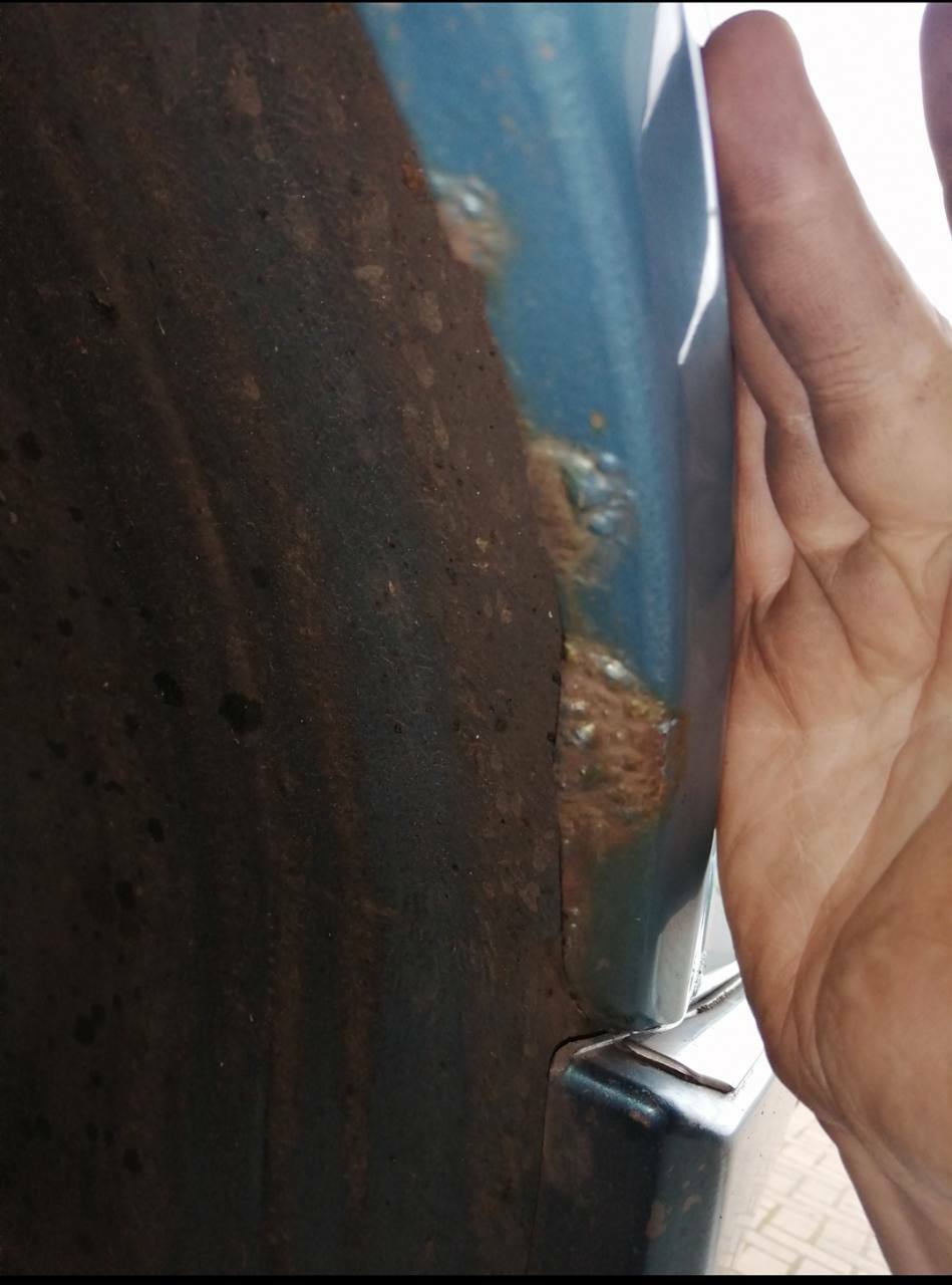

None here, but Ho Lee Fark, its a bit crusty.

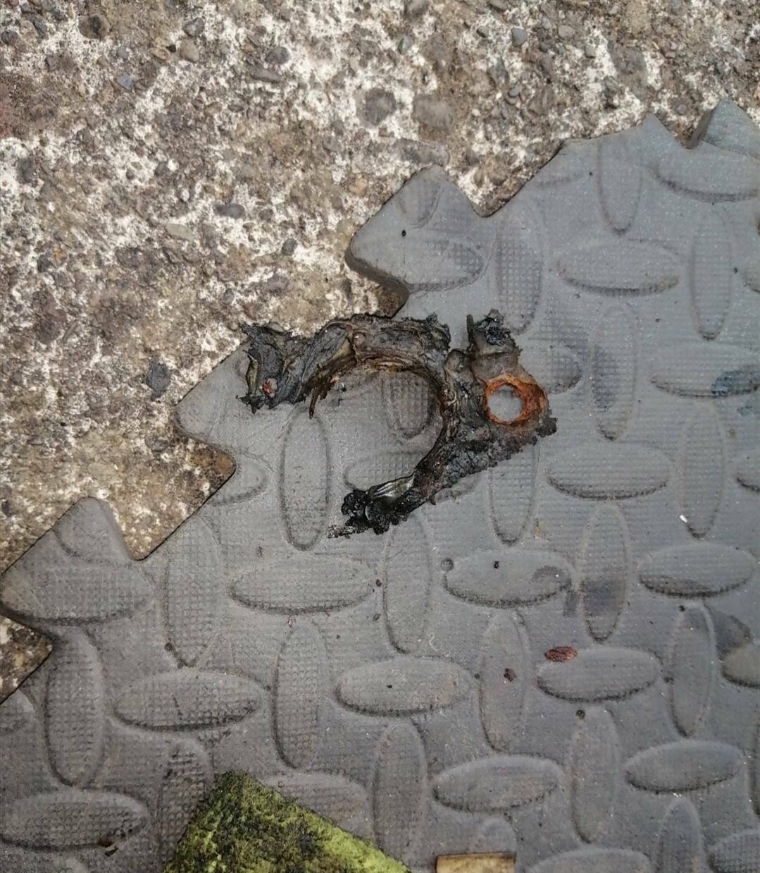

This came off the bottom of the accumulator on the passenger side.
I reckon here is the most likely place for the leak, seems to be seeping out.
Oh good...
Best get the parts catalogue fired up. Just as well it's pay day tomorrow. (technically today)
