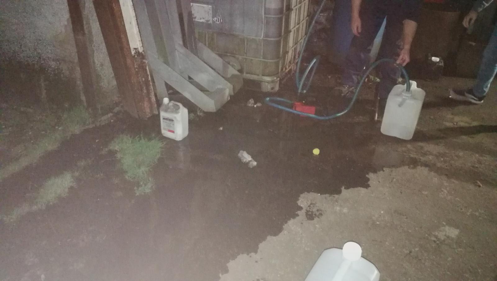

Tonight my Brother, Davehedgehog31 and I went see JimH for the first installment of "Vegshite:heavy haul edition"
Jim had made an excellent start by setting up the pump, then forgetting it would siphon..
Oh how we laughed:)

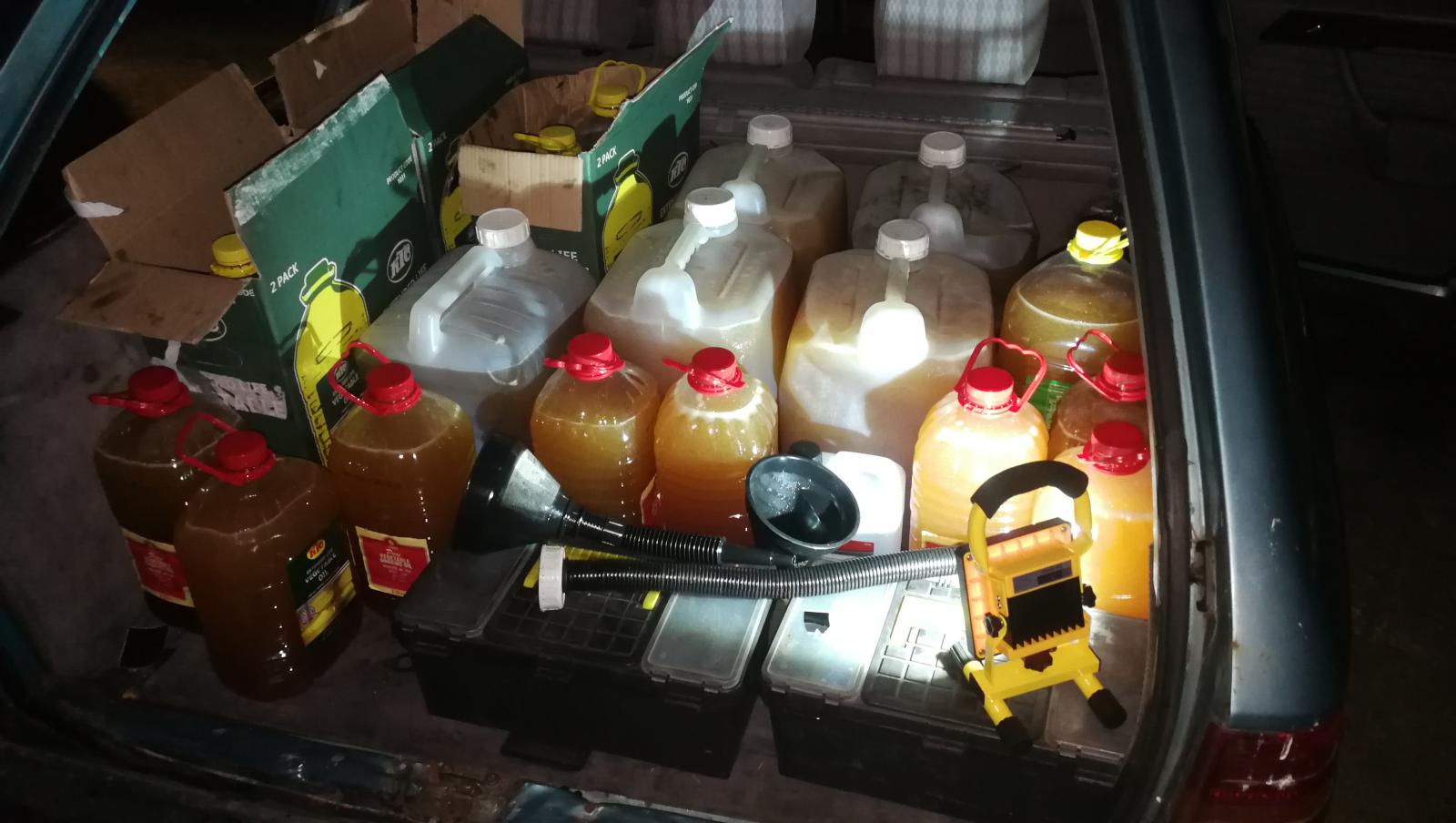

Next up was to start pulling the containers out the back of the car and get filling.
The pump was heavily aerating the veg ( you can see it on the 20L tubs on the LHS of the above picture), so we watched it settle as we continued to fill.
It rapidly cleared to a lovely looking liquid, so we just boshed 20L in the tank:)
In fairly short order 230L was pumped. 210 in containers and 20L in the tank. We'll likely filter the 210L unless the Merc ain't grumbly on what's in it:)
Thanks again to Jim for the assistance and oil - top shiter:)

That's a lot of oil!
You need to get a Will kind of setup with proper fuel pump.
Nah, got a holeshot tube that screws right onto the 20L tubs, and the 10/5L can just get fucked down the funnel with no filter in..

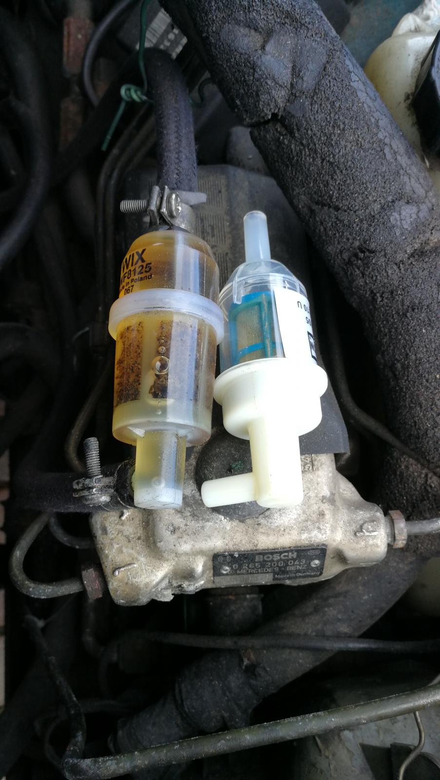

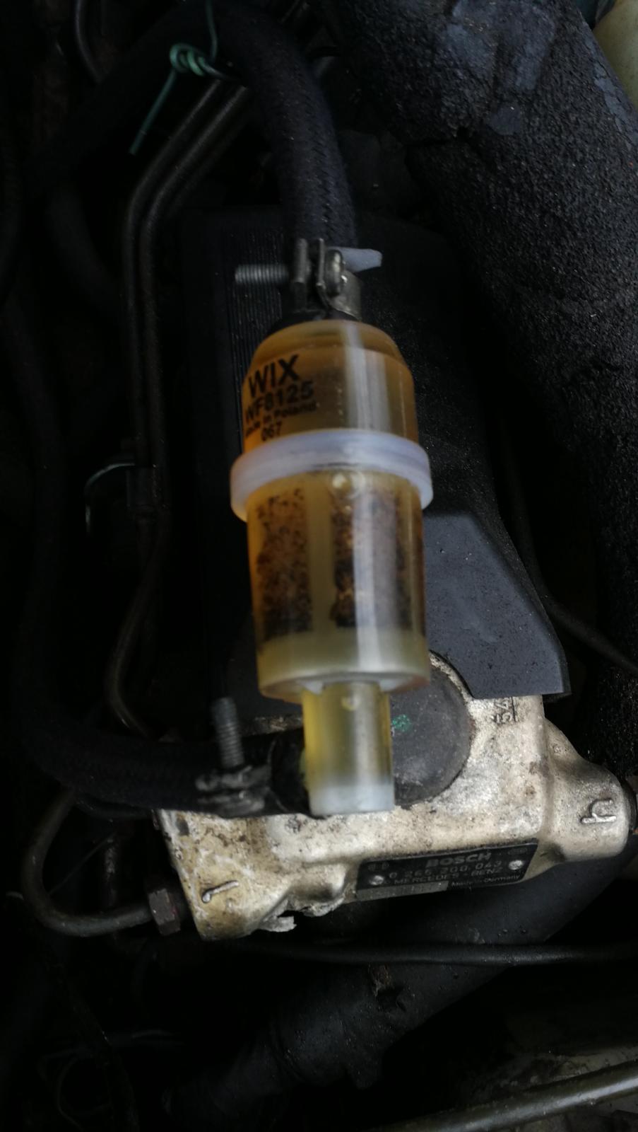

Went out to this in the morning, and she just wound over and over and over. Battery got drained and not even a cough.
Luckily, my neighbour was performing a thorough* check of his Disco 2 before heading to Skye for the weekend.
He discovered a need for 2L of oil, but only had one. I swapped him a litre for a jumpstart.
Leads connected and away it went no bother.
This suggested to me that it was struggling to pull fuel through with just the battery in the car. The filters on the car had been on it since I got it, so no doubt overdue a swap.
Anyways, with it running, it was time to head to the unit.
Once there, I had a look at the pre-filter
Definitely got my monies worth out of it!
A new one was swapped on
Then it was time to check the main filter:
Fuck knows how this ever ran..
Anyways, a new Main filter was sorted, and the car fired up and taken for a test drive. All well, and possibly a slightly perceptible increase in performance..

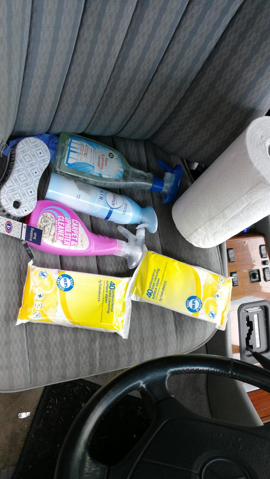

The plan was simple - a £10 valet
The attack was thus:
Hoover
Upholstery cleaners plus scrubby brush for seats and doorcards
Hoover again
Wipes for all the plastic/trim
Windows cleaned.
I used no less than 9 half buckets of water (changing it when dirty) and about 40 wipes.

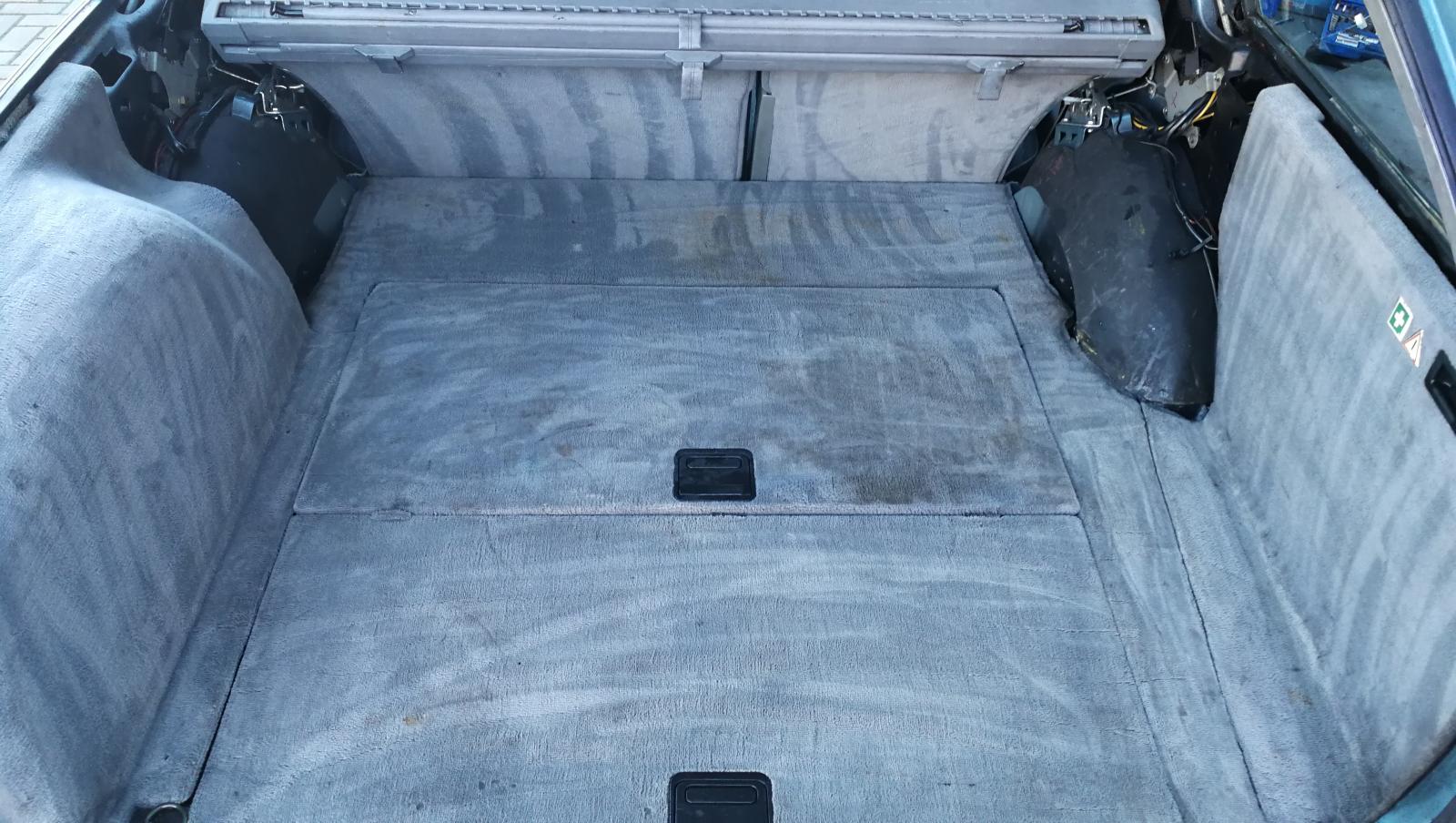

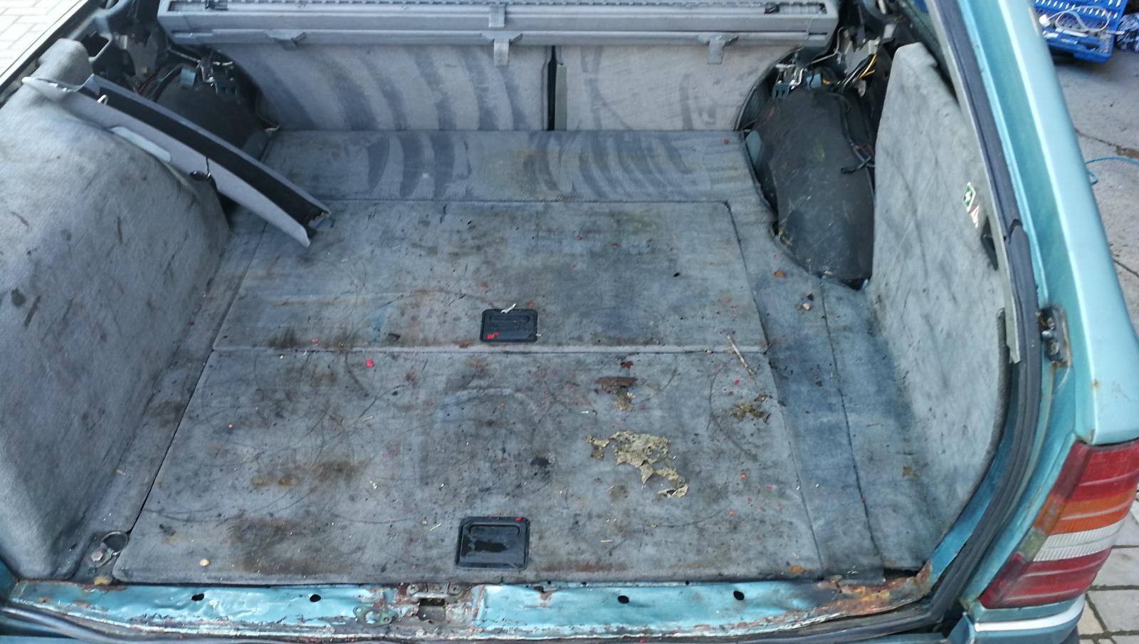

An example - the back of the boot prior
And after
In total this took about 5 hours. It felt like I removed about 100kg or utter crud from it.

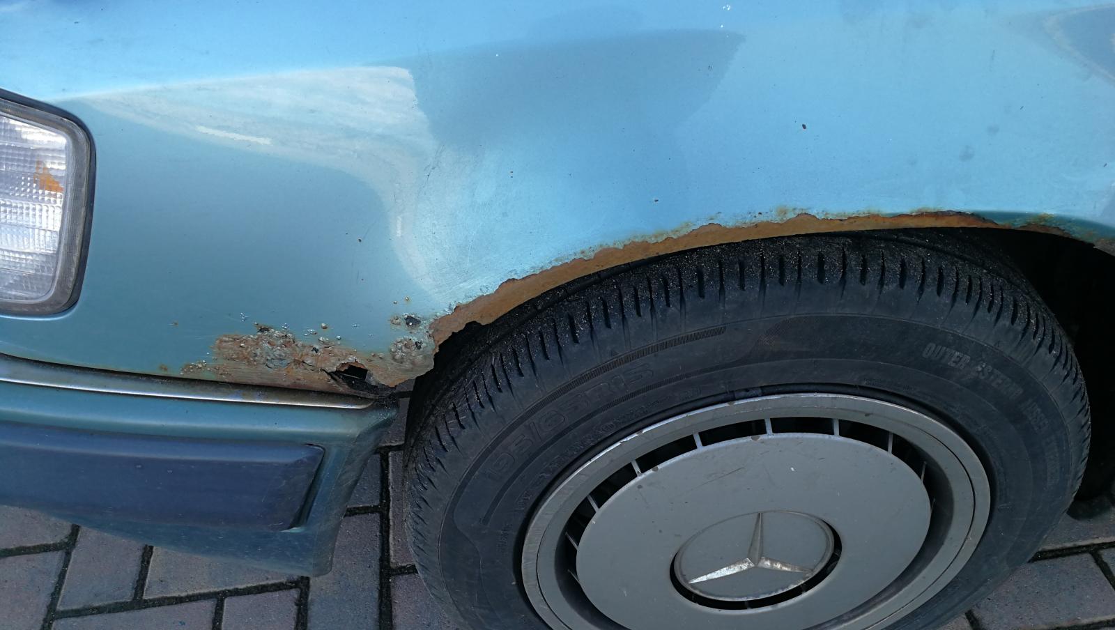

One crusty arch:
Exceptional surface preparation (handheld wire brush held somewhere near the panel)
Seamless
It'll do until I can be arsed.

Seamless .... I would have just driven south ... On veg ... Parked near beko and sent him pics. He would have got bucket wrong un on it
That's mega work in the load bay man. Are you gonna whack a load liner down to protect it in the future?
Gaffer tape wings are for winners. That looks mot standard to me.
Cheers! There's some stains that remain, but short of a proper wet vac shift, its as good as I can get it..
Good shout re the load liner, about £35 gets one from the Fatherland..
