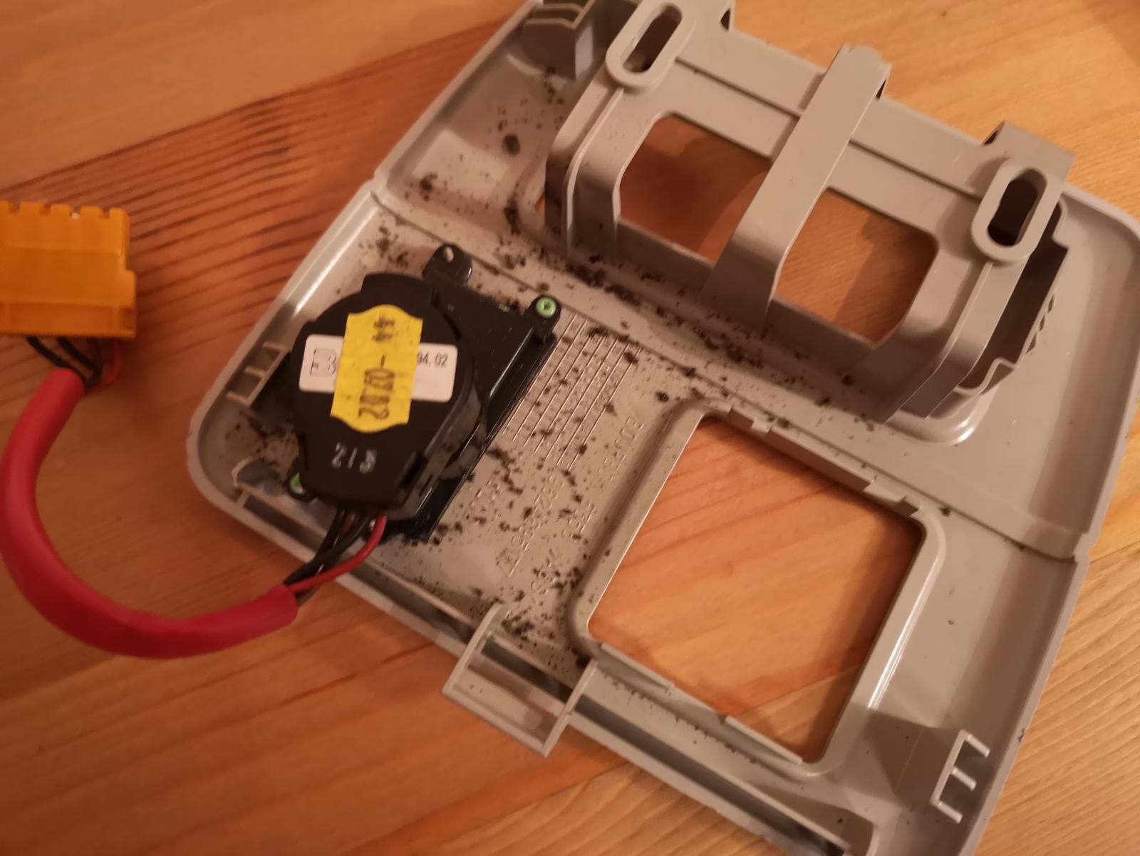

I cleaned the contacts, lenses and bulbs of the interior lights
Washed the fan
and once re-assembled and re fitted we have a silent fan and MUCH brighter lighting, it's amazing how much of a film of shit bulbs get in their life
I only lost one clip which vanished down by the handbrake, the small vanity light is now wedged in with a bit of card which works quite well.

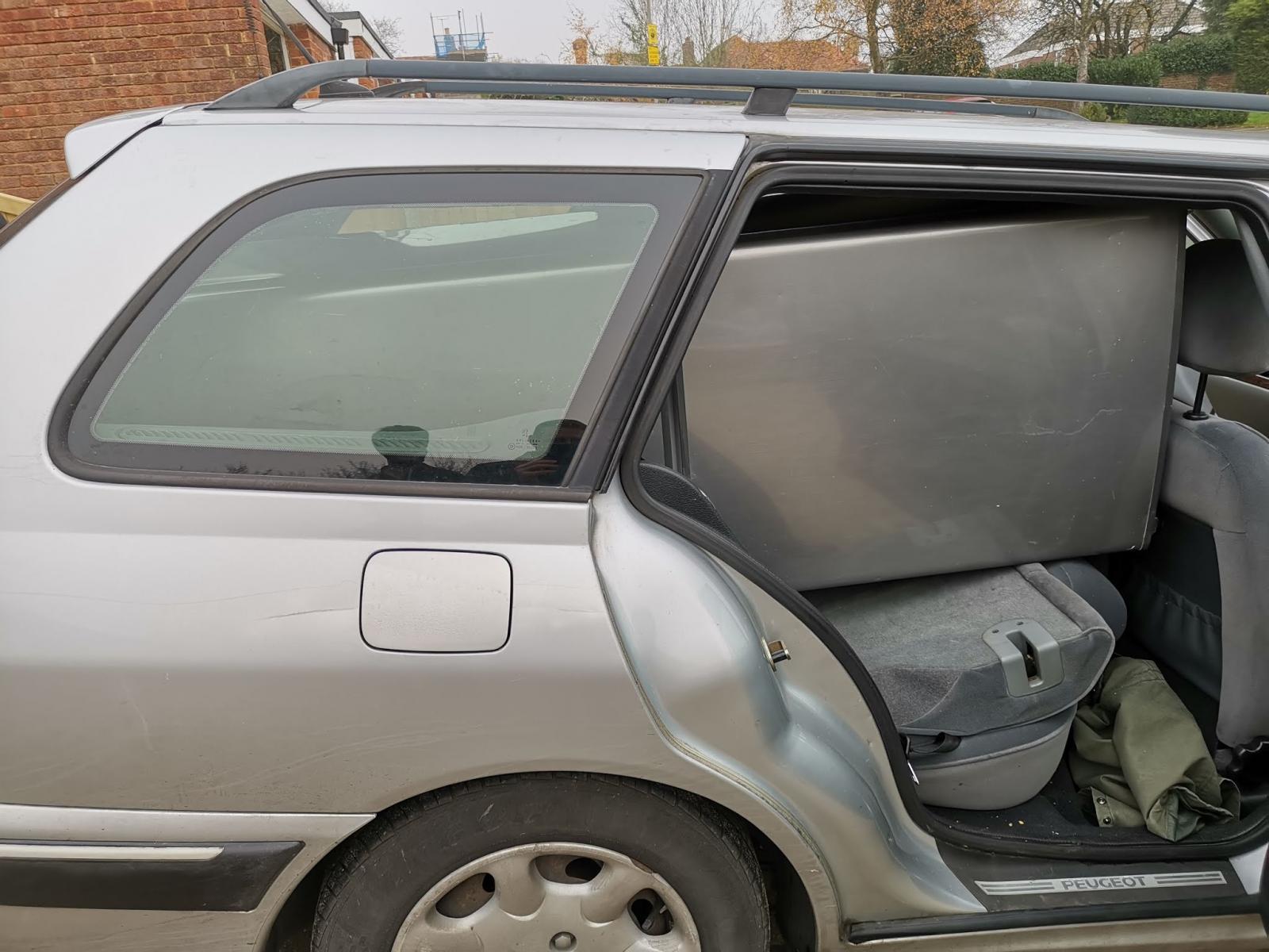

If anything the boot is too big, Henry rolled around during cornering...
it just about squeezes onto mums driveway leaving enough space for my stepdad to get on as well if he comes home early from work

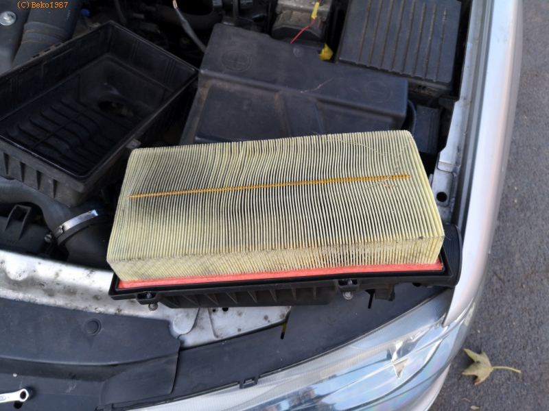

Had a peek at the air filter and that's fine, not changing that. Oddly, after wiping some oily shit off the MAF and making a note to get some brake cleaner on it, and unplugging it and plugging it in during the process, the idle went up a tad which is good as it almost pulls itself away on the clutch now!

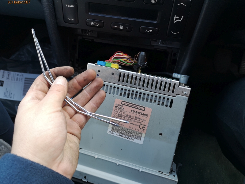

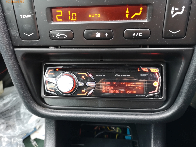

I then made a start on replacing the headunit. The fascia kit came with keys, which saved me digging out the ones I have
The steering wheel controls plug couldn't be more different (more on that in a sec) which is a bit of an annoyance but im not that sad...
This is as far as I got before Charlie woke up. I had to go out that night so I wedged the unit into the hole roughly and had my USB stick back!
Then, to this morning! Where I ran the microphone for the handsfree kit
And the DAB aerial, and was just as lazy as with the last 2 cars it's been fitted to and it's tucked in the lip of all the door seals and A B and C pillar trims before going behind the dash!

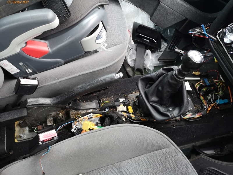

and it's now much nicer! Pieced together 2 of the broken plugs, the airbag switch (fucking luckily as it bought up a massive AIRBAG FAULT on the MFD with it unplugged) and the fag lighter. The alarm button (to turn the internal sensors off I think) ripped the little PCB from the pins so it now doesnt work, but since it's a button in all the cars I've owned I've never pushed, I don't really care. Bought the coin holder in for a good soak and a go with the brush, and bolted the 1 rear bolt in tightly, it's much better!

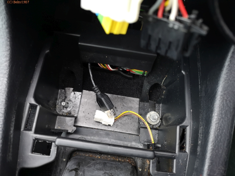

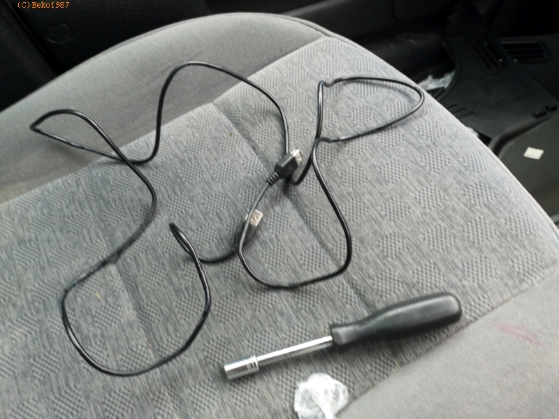

Time to run the USB cable! One of the big reasons I chose my headunit was the rear USB's, allowing for a less cluttered fascia! I just bought a £3 extension lead so I didnt have to remove the headunit whenever I got bored of music! I could use the SD card slot behind the front, but I forget its there, plus the USB mode is right next to DAB... SD is 4 pushes away...
Ended up bundling most of it up and putting it under the ashtray, which is piss easy to remove to get at it
Talking of the ashtray, the whole area is shit to put stuff as it rolls around. The ashtray itself is useless as you cant get your fingers in. Until I noticed the metal top just popped off...
Much better! Can stick my fags in there and hide them away AND get them back out
Found much fluff under the seats with them reclined right back to get the centre console in. Ended up pulling no end of fluff out of the Velour, their softer now! Had to bodge a Dyson tangle free turbine tool onto a 32mm end.
Someone on the 406 facebook group told me my radio lead ran to the back of the steering wheel directly. I took the cowling off and had a look
2 plugs have the same size connector, but no one told me quickly enough which one it was, so I battled the cowling back on and found that the wire unplugs from the wiring box, which makes it a bit neater for now. The wiring box IS needed to turn the stereo off when you turn the car off, plugged straight into the pug wiring it stays on unless you turn it off, the BSI doesnt see it and kill the power or something
Here we go. Forgot to take the FM adapter off the gooner before it went, but then I thought back to all the times I actually used the FM in the 2 years I've had the radio and just stuffed the FM aerial right down the back out of the way forever
Yes we do
Checked the DAB
Checked the USB
Then set the colour, turned off the animations it does and fettled the sound. After this I found some trim clips and used the centres to really badly stick the door seal back on as I catch it with my leg all the time

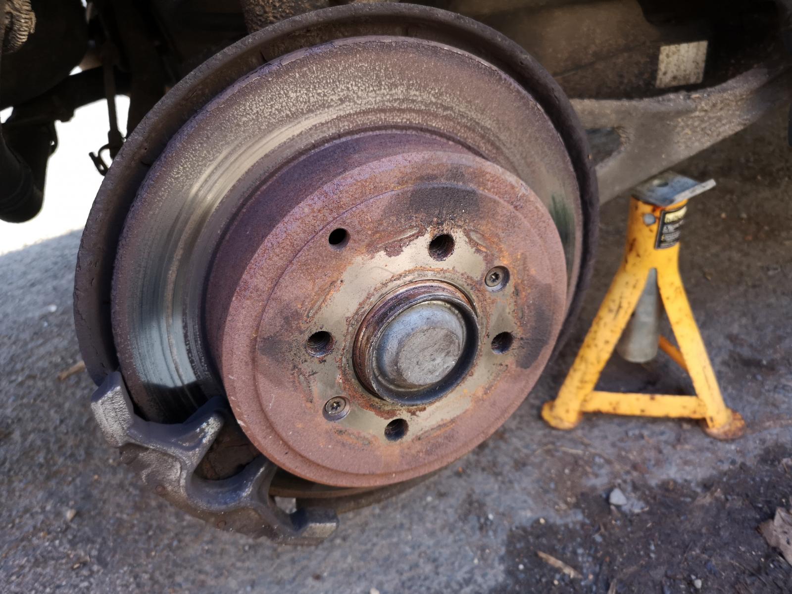

So, that fixed, I had the rear wheels off the 406
Passenger side isn't bad. I adjusted the handbrakes and it went well. The backing plate is rusty as fuck, and I pulled a bit off...
It all turns fine, but the brake disc isn't seeing full contact... Adjusted the handbrake anyway, and made a note to return with a bottle of dot4 and bleed the brakes. I really don't want to strip them down this close to the mot, last time I did that to the blue laguna it seized it caliper the bastard
