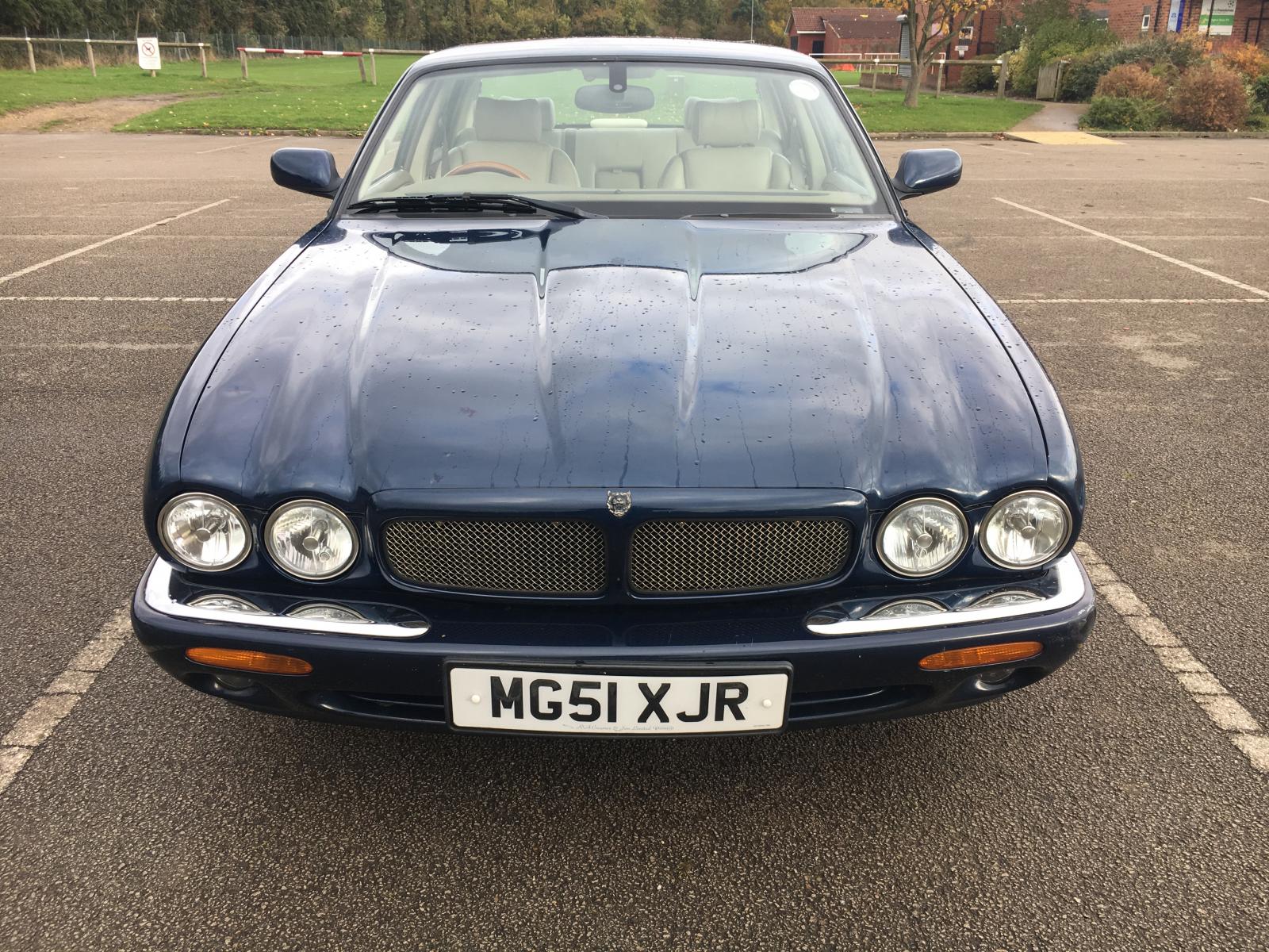

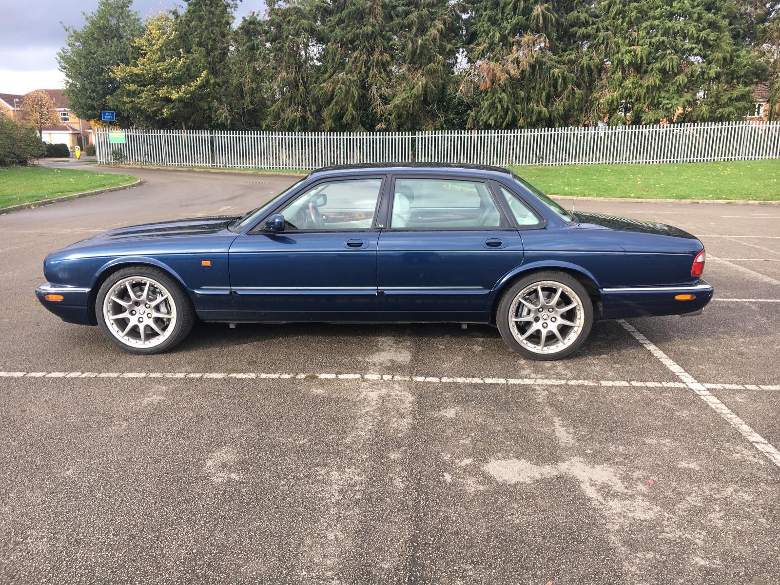

Broadsword Posted November 7, 2018 Author Posted November 7, 2018 While I was writing this post, I got the V5 for the car. The new registration is RX51 VYG. It is now in my name so it's nearly ready to go. I'll get plates ordered immediately and job jobbed. Superchargers make everything* better. Don't delay. Buy now! Maybe some photos will help. Sorry I'm keeping the shag pile rugs forever! I have boxed myself into a bit of a corner here. I have already indicated my intent to buy a up a replacement, which puts me under pressure to get rid of a car soon. To expedite matters somewhat, I am willing to deliver the car if someone wanted to buy and lives not too far from York. Engine sounds really nice at tickover and gentle driving up to full operating temp. It is when you put serious heat into the engine you get the noise. I also might just bung it on auction and see what happens. Photos below:  Coprolalia and oldcars 2
